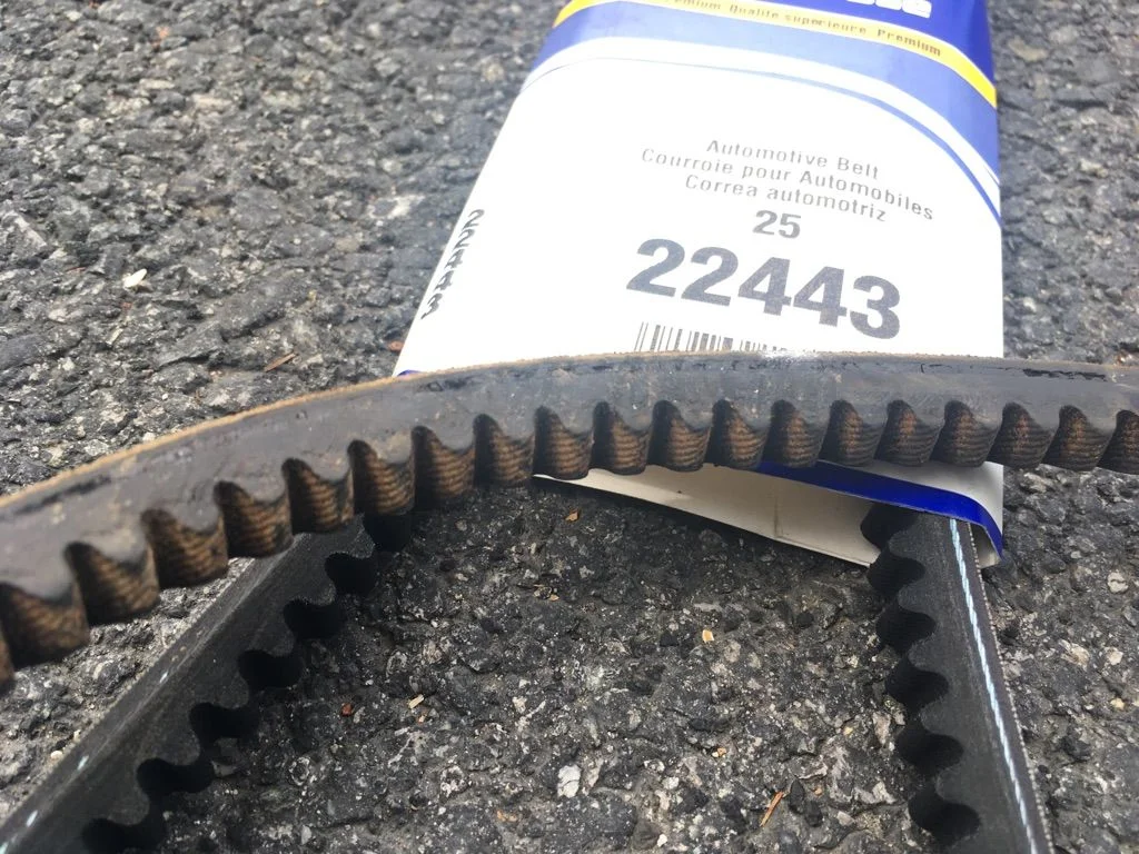

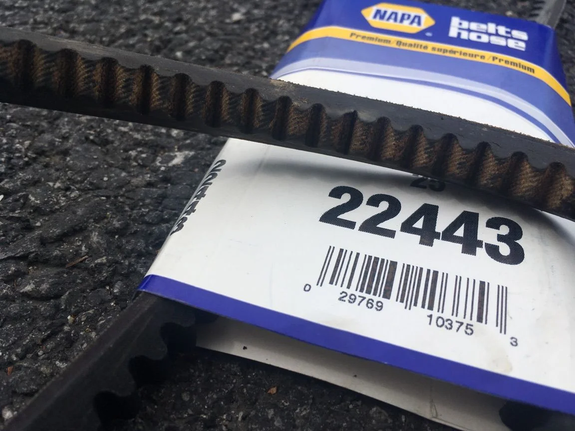

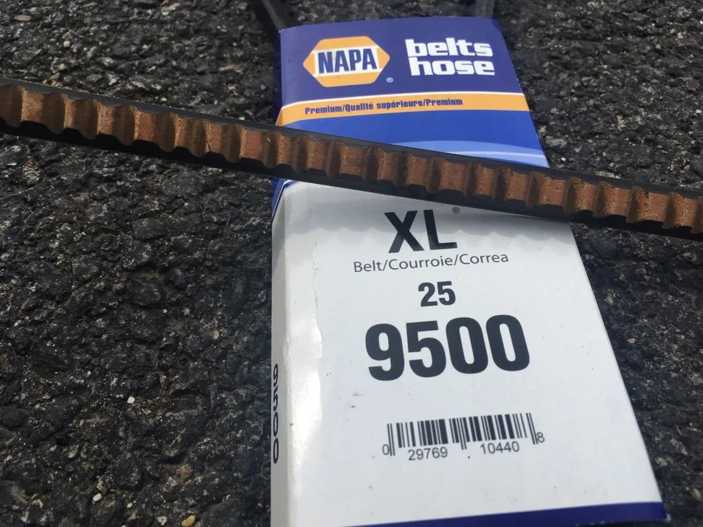

I checked out NAPA as recommended and it was much easier. I ended up ordering 4 belts instead of 3 because I couldn't tell if I needed w/ or w/ out california emissions--dont laugh. I picked up the belts last night and tried to start working before it got dark and was able to get the alternator belt off but the other 2 drove me crazy.
I need tips on the "simplest" way to get the other 2 belts off.
So I got my hands dirty today and replaced the belts only to see that only one really needed to be replaced. The belts however weren't the culprit. I'm still glad I changed them since that starts my baseline.

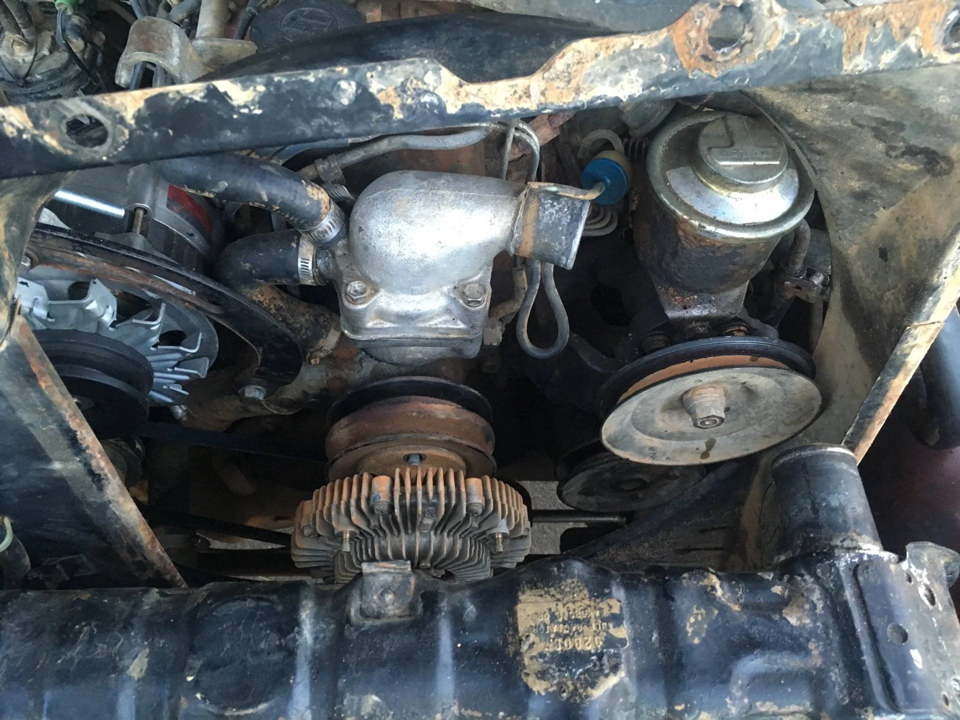

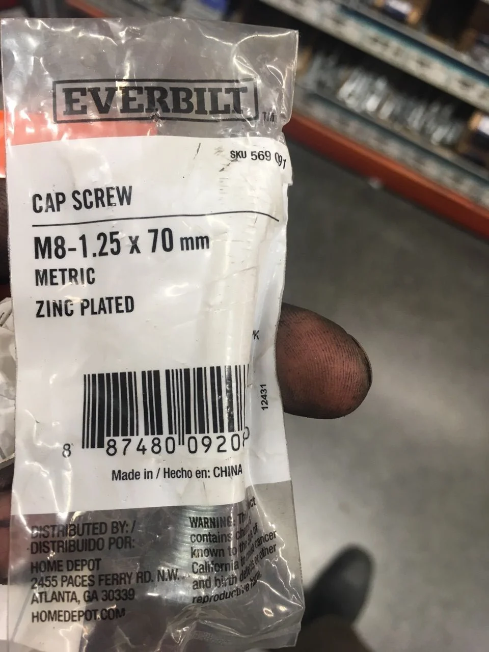

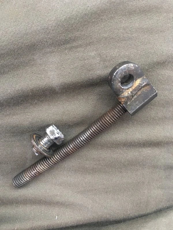

After putting the belts on I got everything tightened up and saved the alternator for last. I don't if I'm an idiot or not but I had taken the bottom bolt out so I fought to get that back in. Once that was in I started tightening the belt and ended up breaking the tensioner bolt. Home Depot was nearby so i hopped in my insight. The bolt was an m8 which was hidden in a drawer not readily accessible but I managed to track one down. Its much shorter than the one I broke but it worked just fine.

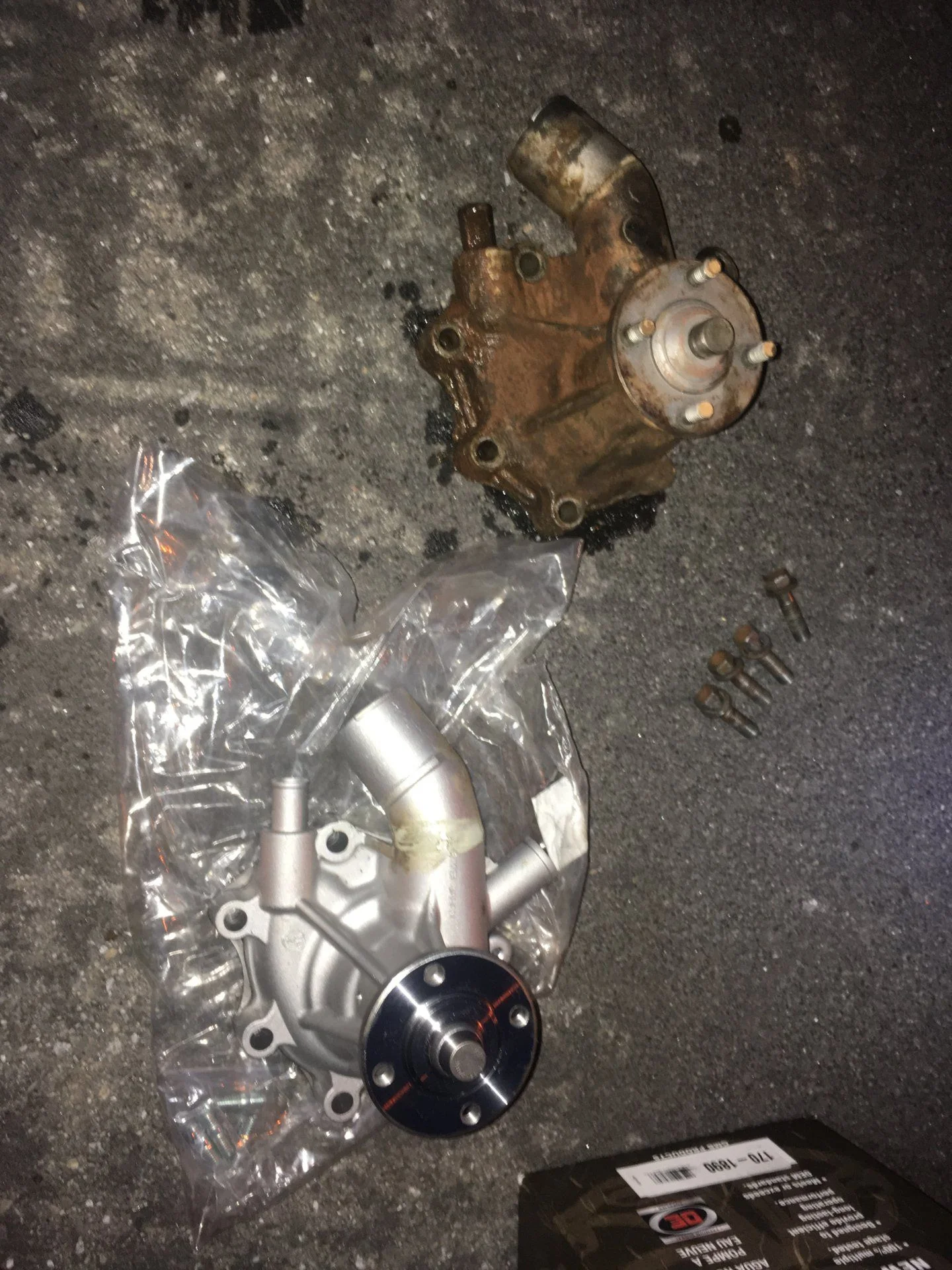

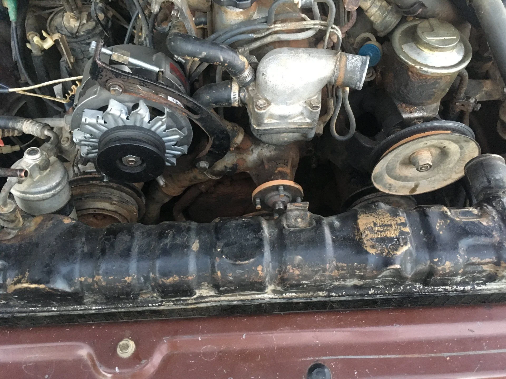

I got the car started and heard the same loud screech for a few seconds then it turned in to a very faint sound so I took it for a test drive. I got stuck at a light and observed smoke. The temp gauge was only half way but I pulled over. This time it was coming from the water pump area. I shut off the car and touched the belt. The belt was really hot. I started the car back up to observe and noticed that the segment of the belt from the crank to the water pump was really wobbly. I shut the car off again and poked at the belt and it was still tight. So I looked around some more. I stared at the water pump as if it was magically going to start talking. I decided that if I couldn't figure out this time around I would take it to my mechanic. I then started the car up one last time and stared at the water pump and finally realized that the water pump pulley wasn't spinning and the friction was causing the smoke.
Can I replace the pulley alone or do i need to replace the water pump too or do they come together as one unit?

The water pump I got from napa said I needed a gasket dealer but not what kind. I got anxious and called mudrak. We texted back and forth and the end result was no sealer. The cruiser is alive again and the fever is gone.

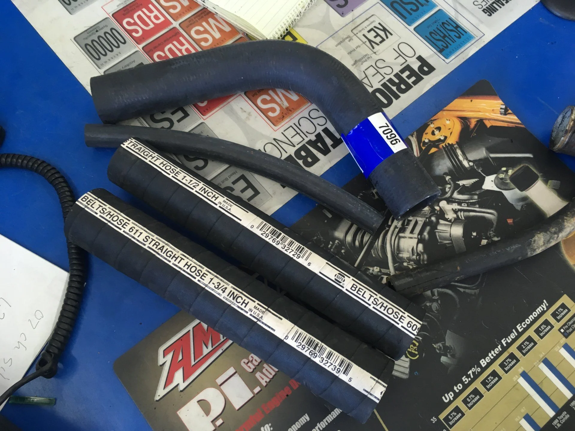

Once I knew the water pump was working and the it was ok longer overheating I changed out the upper and lower radiator hoses along with one other that connects to the water pump. I bought a t stat but got tired and never installed it.

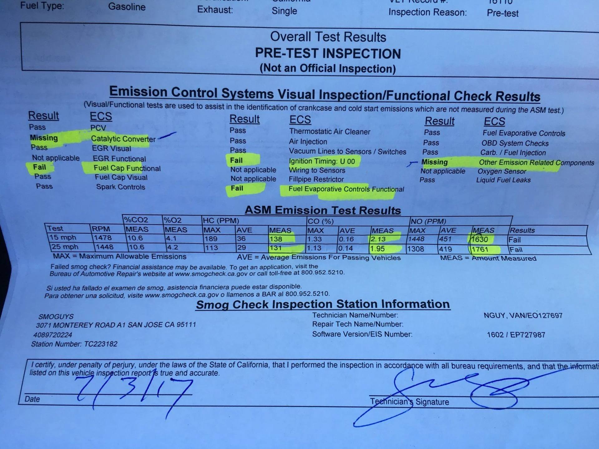

I took it in for a smog pretest and it failed. Fuel cap was the easy fix. The guy said the cat is missing but I checked when I got home and it's definitely there so I'm assuming he meant it's bad. As for the numbers, he said it's running rich and a new cat would probably fix that issue.
Any advice?

The cat could be missing. It would be up closer to the engine though if the truck has been desmogged then it probably won't pass in your home state. Here in Utah they do a visual as well and I had to point out the EGR valve, smog pump and etc to get the visual passed.
Though looking over (I might be reading it wrong) it looks like it is running rich due to the unbrunt fuel.

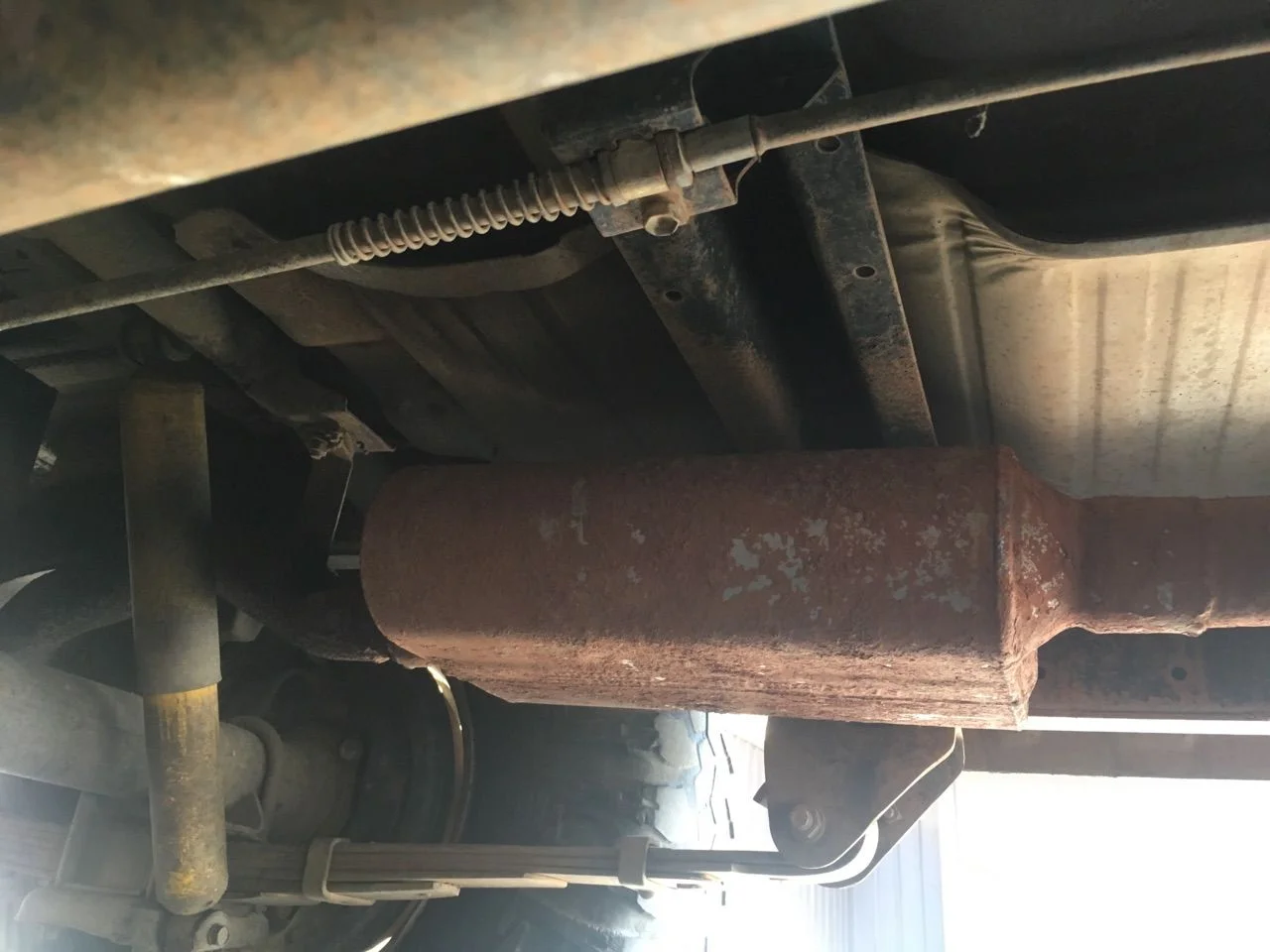

Might sound dumb but Im not sure if I have a cat or a muffler.
You'll have to find a cat and have it installed.
These guys are supposed to be prett good and direct bolt up (if you OEM) was replaced with a test pipe. (Factory flange mounting)
6 Cylinder 1987 TOYOTA Catalytic Converters

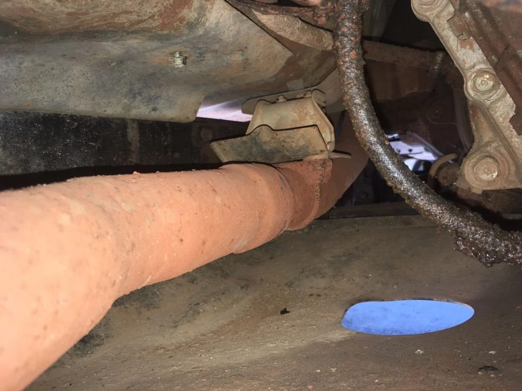

The Cat on your truck would be or would have been roughly right under your butt/feet (drives side floorboard). Can you get a photo of that area and post it?
It sounds like your vehicle has been desmogged. The question is if you can get it to pass in your state.
Desmogged means they took of the catalytic converter, egr valve and smog pump. Here in Utah it still has to have all those to pass the emissions inspection. If it doesn't they are supposed to fail you right away. Now if your truck has been then you will probably need to get it back to original before they will test it.

Don't one of the pulleys on the right belong to the smog pump?
Thats the best pic I could get.
