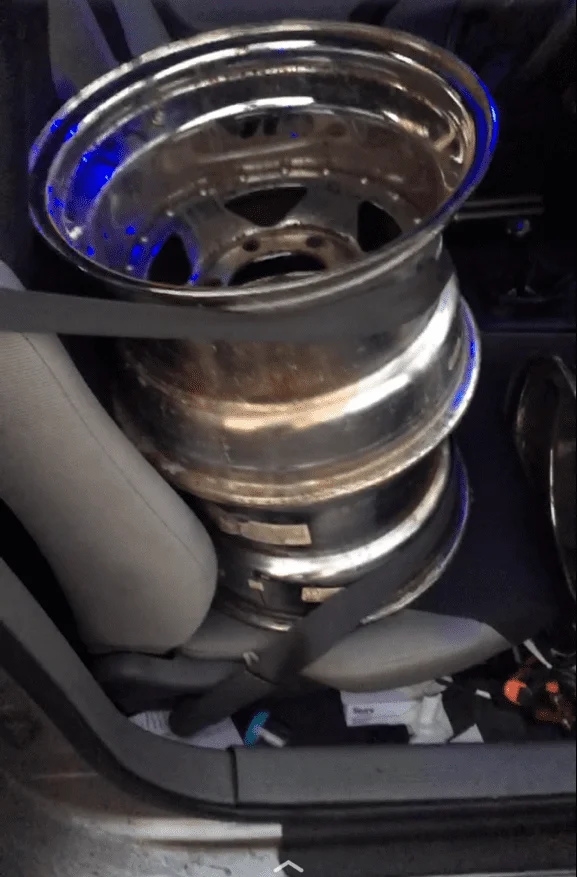

In one of my first few posts I mentioned having an extra set of 15x10 inch wheels; they came with the car. I posted them on craigslist and the letgo app and got a few offers. Someone in sacramento offered me $150 and said he'd send someone but that never happened. A kid out in modesto asked me to deliver for $220 but didn't have the money yet. Then on Tuesday right before class i got a text asking if I'd be willing to take $300. Instead of countering, I jumped and said sure thinking he'd flake too. As we chatted he said ASAP. I then offered to deliver that night at no extra charge. So right after class I sped to my storage, loaded up, and drove from San Jose to Madera. As soon as i exited I texted the guy and no reply. I pulled up to the house and texted "I'm here" and again, no reply. Then after a few minutes on a creepy street with not a single street light the guys mom came out. She handed me the cash and I was on my way.
That $300 has covered the starter and belts I swapped out, and will possibly cover the water pump, hoses and other fluids; I hope.

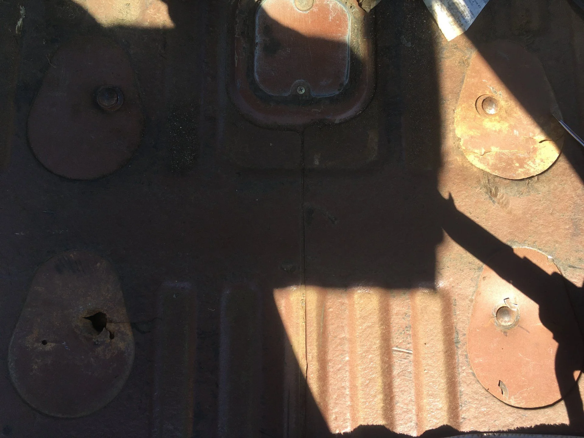

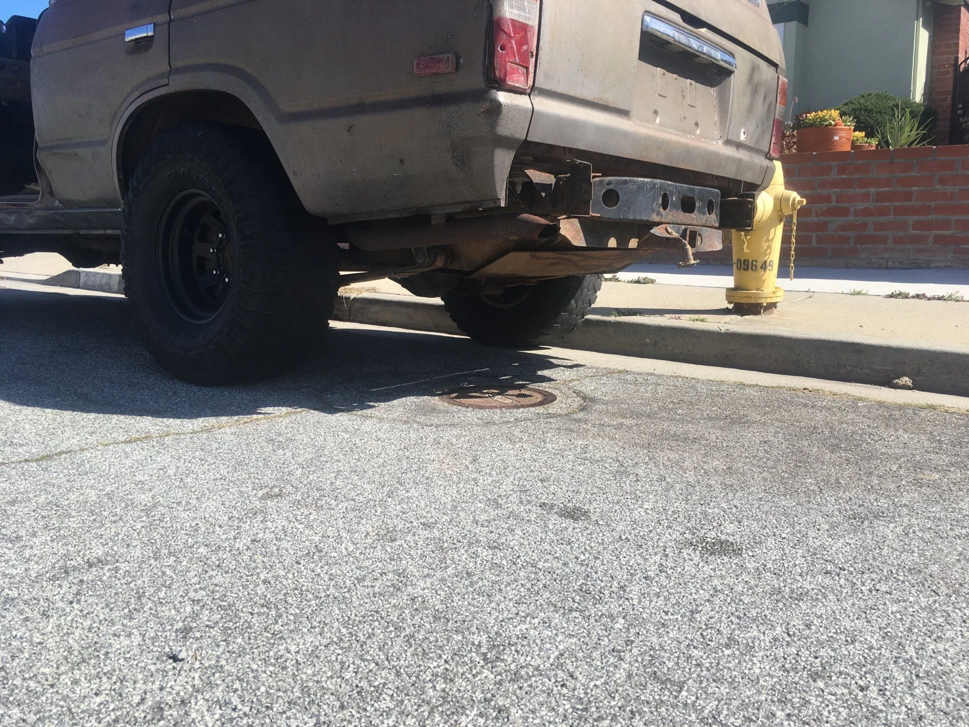

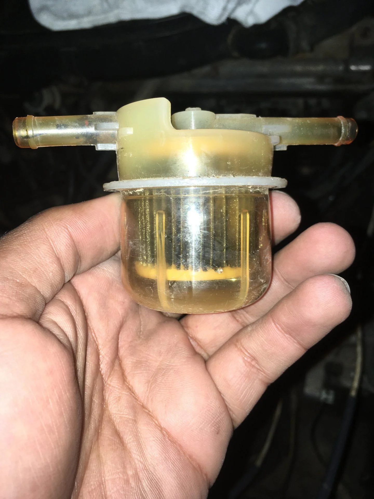

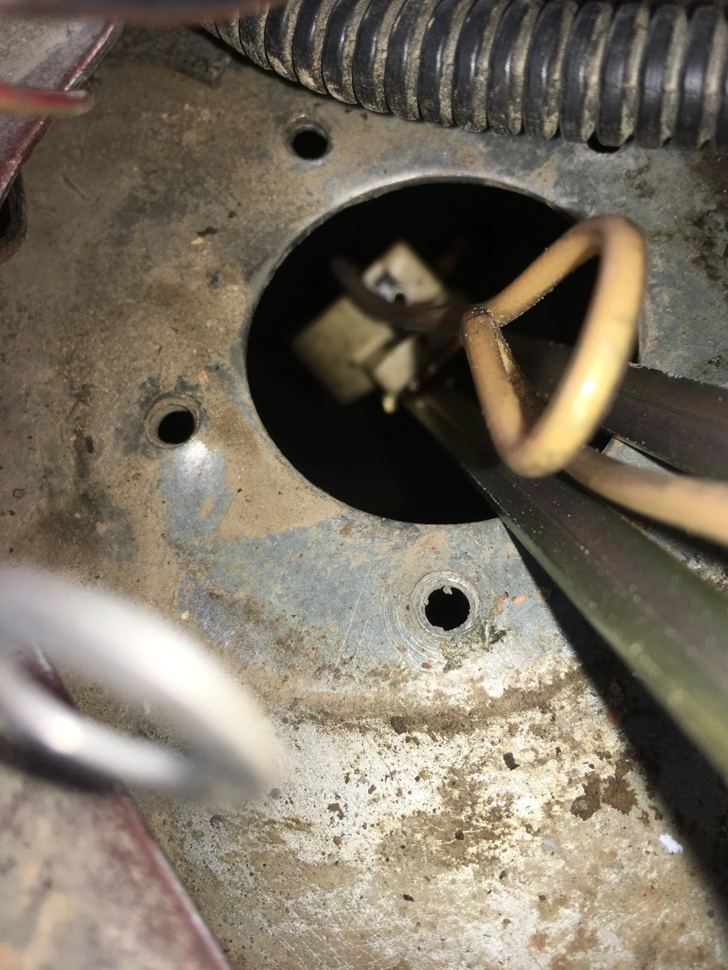

Someone on here once pointed out the my fuel tank looked like it was sagging. I checked it and agreed but it wasn't a priority but after the tanks leaked, and the filters clogged I know why it sags and its starting to irk me. I've attached an exterior pic and one of the cargo area wheres its bolted. One of the bolts broke through so thats probably a simple fix but Im trying to figure out what kind of tank I have. The bolts seem to run through the tank and out at the bottom and a few are slightly bent.
Looks like you have a long range tank! With a skid plate.
Which is not the factory tank.
From what I see on that floor board pic those are the bolts to hold up that tank.
You may want to drop that tank and have it cleaned out or replace it with an original tank and have that cleaned out.
Especially seeing your plugs and fuel filter.
So would you say the bolts run thru sleeves in the tank and come out the bottom and do you know of any companies that sell a tank similar to this? Ive only seen a few long range tanks and they are all different from mine. Thanks.

Yes, I do think the bolts run through the tank and bolted the other end.

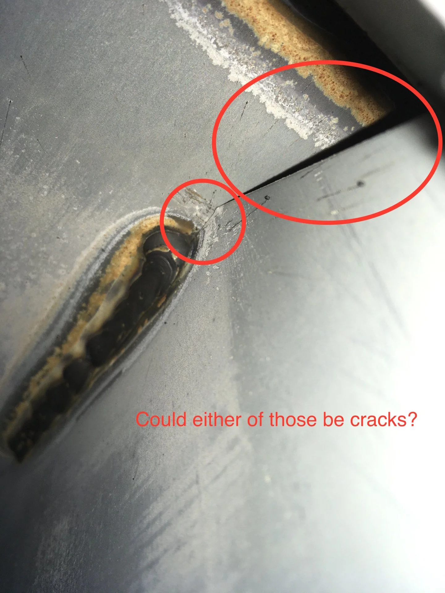

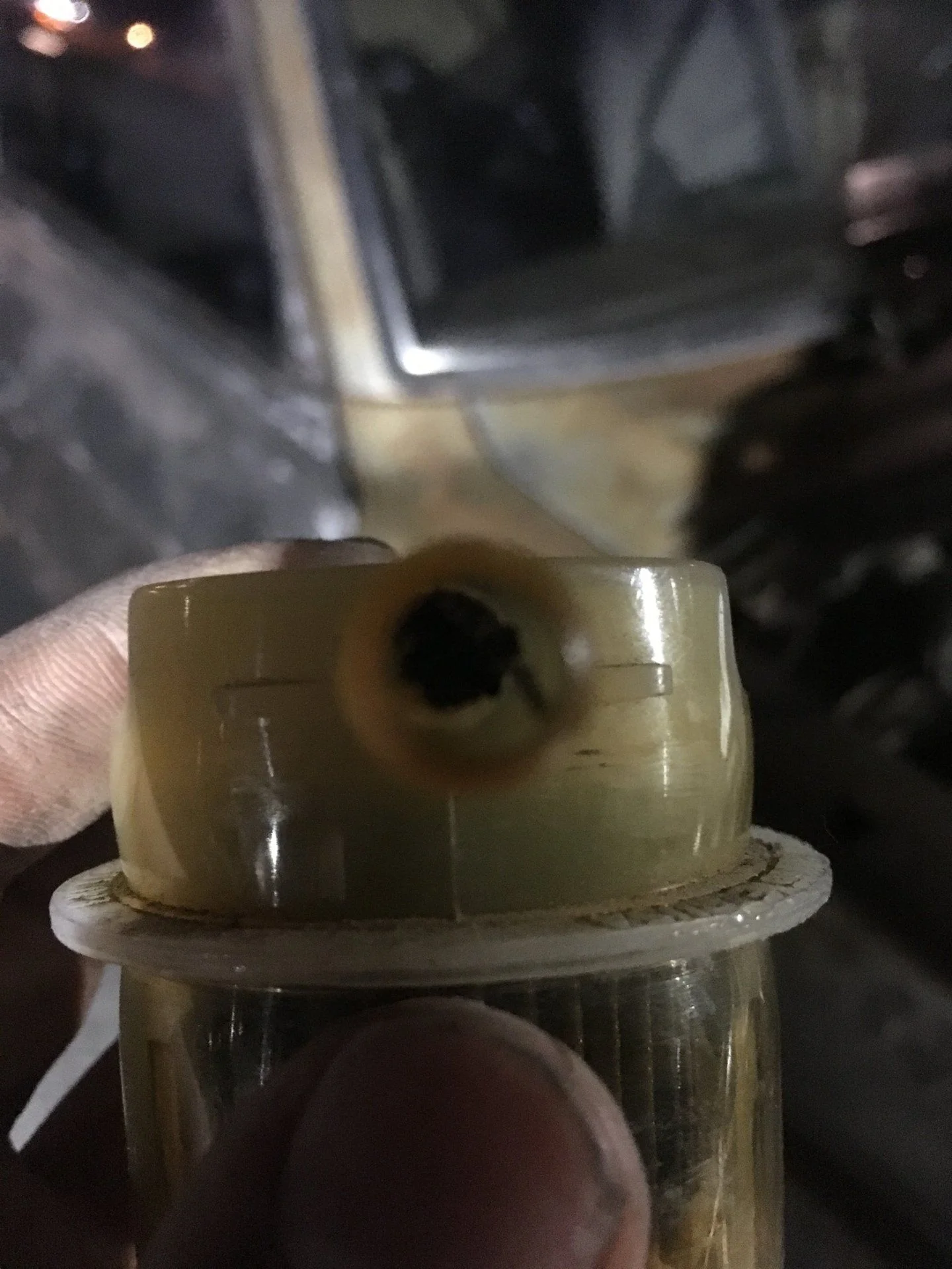

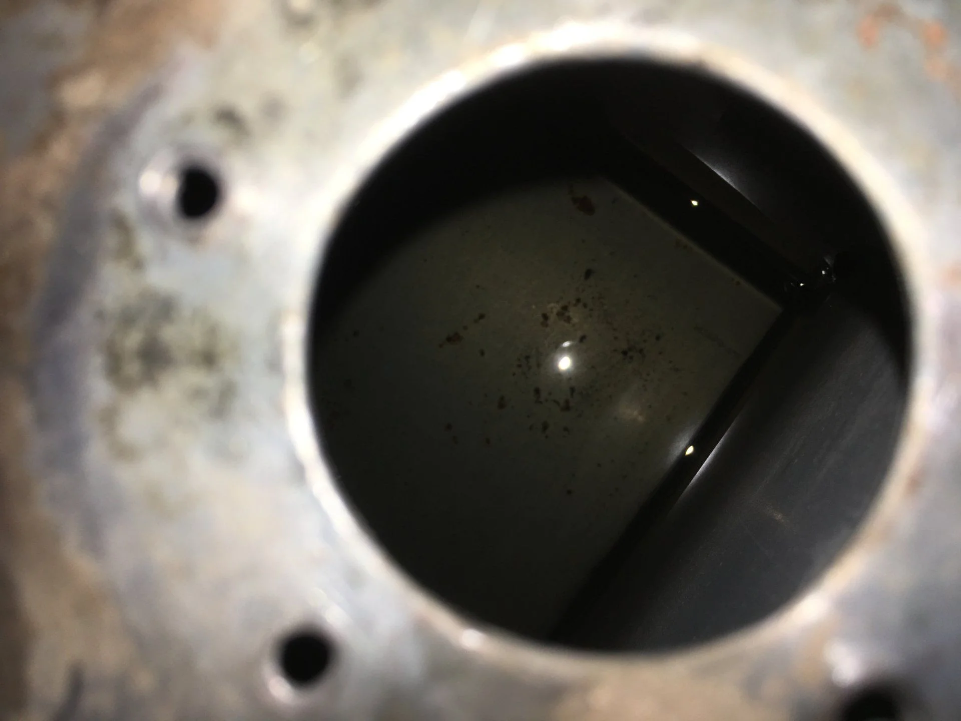

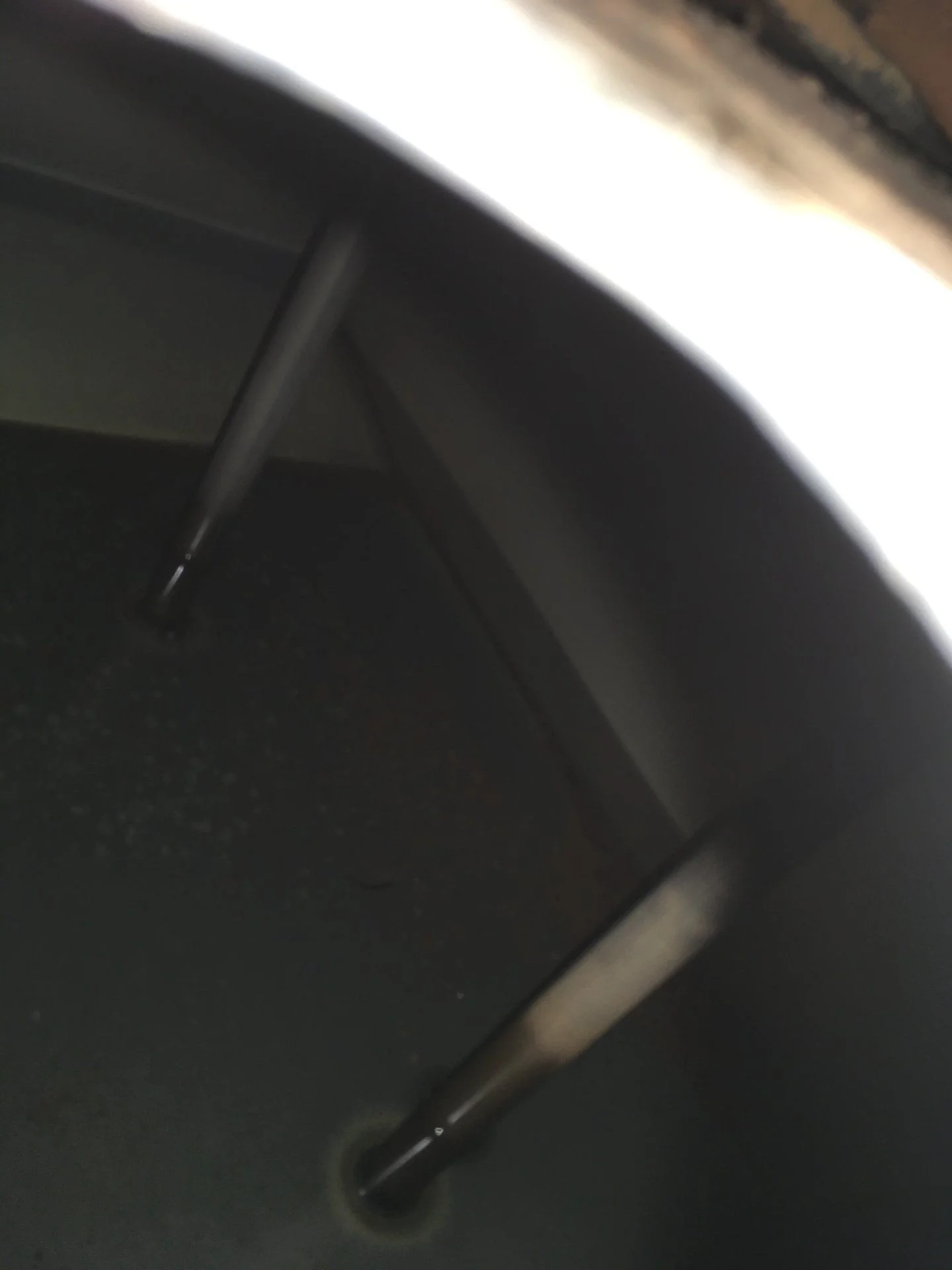

So I cut one bolt off from the bottom of the tank and it did nothing since its bent inside BUT, I realized that since that bolt broke thru the cargo area I can unbolt the others and the tank should still come down. However, Im headed to Pismo Beach and will tackle that job as soon as I get back. I did cut a new gasket for the sending unit and I'm hoping the gasket was the problem. I took some pics of the inside of the tank and didn't see any pine needles or twigs which are what clogged up my fuel filter both times but I did see what I thought could be a crack but its only visible inside.
