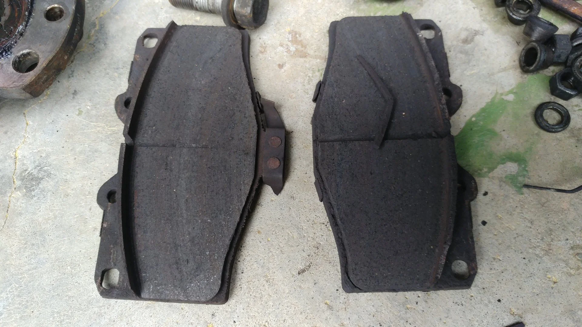

Never seen brakes like mine!!! Big thanks to the previous owner(s).

I knew they were bad, but I had no idea they were this bad. Owned it for 7 months. I should have changed them out within the first month.

Yikes! Looks like that front end rebuild may have just moved up the schedule. If the rotor is coming off might as well go all in. OEM rotors are my preference and reasonably priced, don’t want any Chinese garbage on such a heavy pig. I would also inspect the worn side for a possible sticky caliper piston.

Yeah, I already have new rotors and pads ready to be installed. Got the Power Stop kit from RockAuto. They aren't OEM, because this was an unexpected expense. So, I couldn't afford the good stuff. Next time.
And yup. That one side of the caliper is definitely stuck. I borrowed my friend's caliper piston tool. Hopefully, that will work.

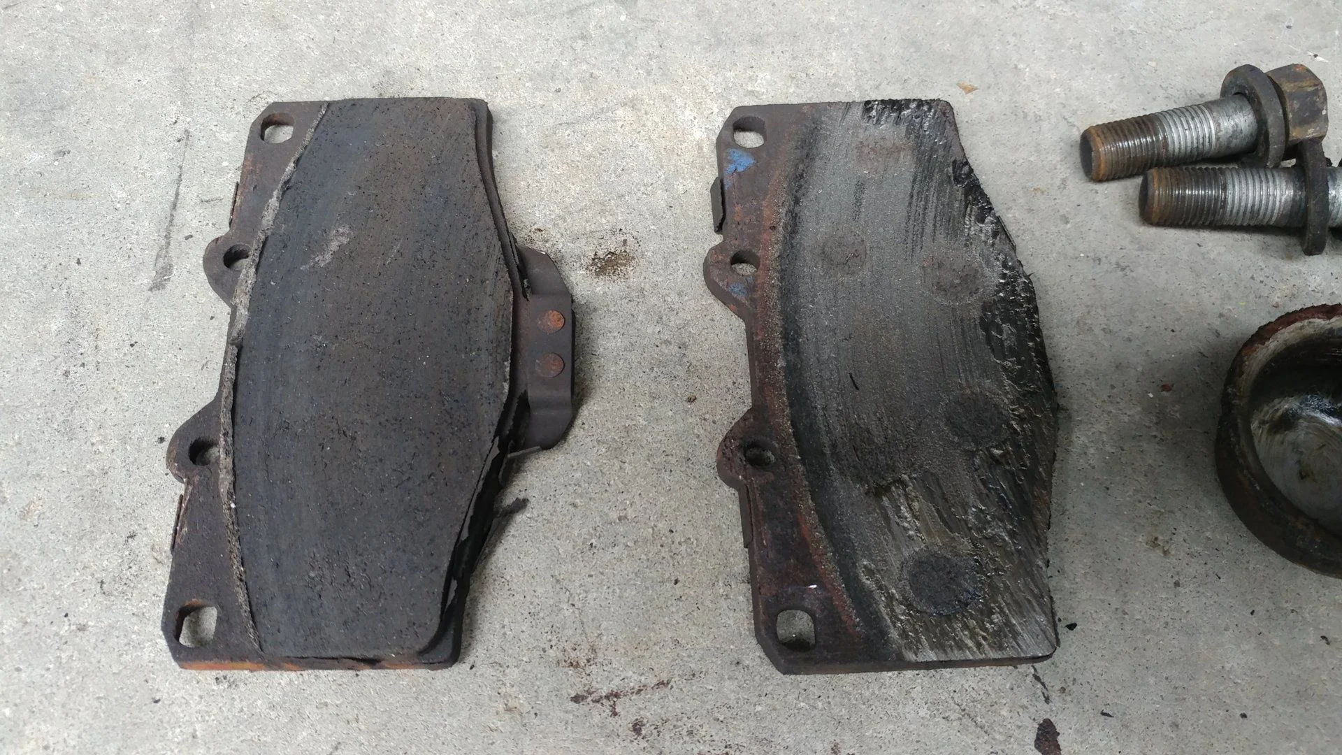

did you check your piston movement? it looks like one or both of the inside pistons are sticking/dragging causing extreme wear on one side.
if they are sticking they will eat the new rotor up as well.

you would have had to push the inside pistons in a good bit further then the outters if you put it back togeather. if you did were they harder to move then the other pistons?

the inner nut should come off almost as easy as the outer. i wonder if the bearing got hot from the heat of the pads rubbing and it is just being a little stubborn.
