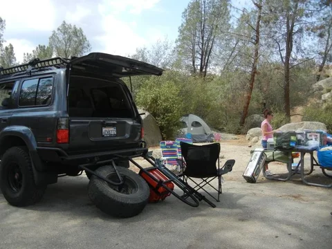

My Rear Bumper Build with Swing Down Carrier
That came out really good!
This truck doesn't see offroad on a regular basis. So the swing down was setup for temp use. Most of the time I do not need the carrier. It will only go on when I go camping or out on a trail.
It's heavy as it is without having to lug a spare and extra gear around all the time.
Not really sure if there is a market for it unless I design the lower bar to work on any truck with any bumper as long as it has a receiver on it. Not sure if it will be profitable either. How much will someone pay for something like this. Material only cost less than $90 but a lot of testing had to happen to get it to fit just right.

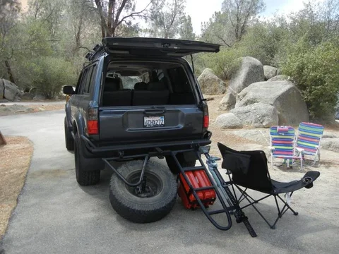

Got a chance to actually use the swing down and it worked out great at Kern River a couple weeks back. What came in really handy was the fact that I used the tire as a step and was able to climb in the back very easily for loading and unloading gear.
Yup. They were filled to the rim. I just removed the carrier last week and filled up the 240z with the fuel I did not have to use. Surprisingly got about 14mpg with the truck loaded and doing uphill a good amount of the trip with A/C blasting since temps were topping 100.
