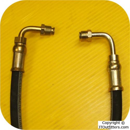

I've got the High Pressure PS Line that came with my JT Outfitters Mini Truck PS Kit and it's leaking.
The conversion line that comes with the kit suggests it is metric on one end and standard on the other. So my SQOD is how do I know which end is which?
Others have suggested it doesn't matter, then I've read others had to put a "nipple" on end to seal properly?
power-steering-conversion-line-toyota-gearbox-saginaw-pump-high-pressure-hose-pi-4774.html
The threads look similar and are close but are different. The pump gets the 5/8 fitting and power steering get 16mm threaded end. After a couple years my rag joint disintegrated on a hill, not good trust me. This is what I added from Flaming River, it has the correct splines for power steering interface and a .750 bore for stock steering shaft. You will have to pin it to your shaft but no play and very solid. One of the best mods I’ve done, power steering
