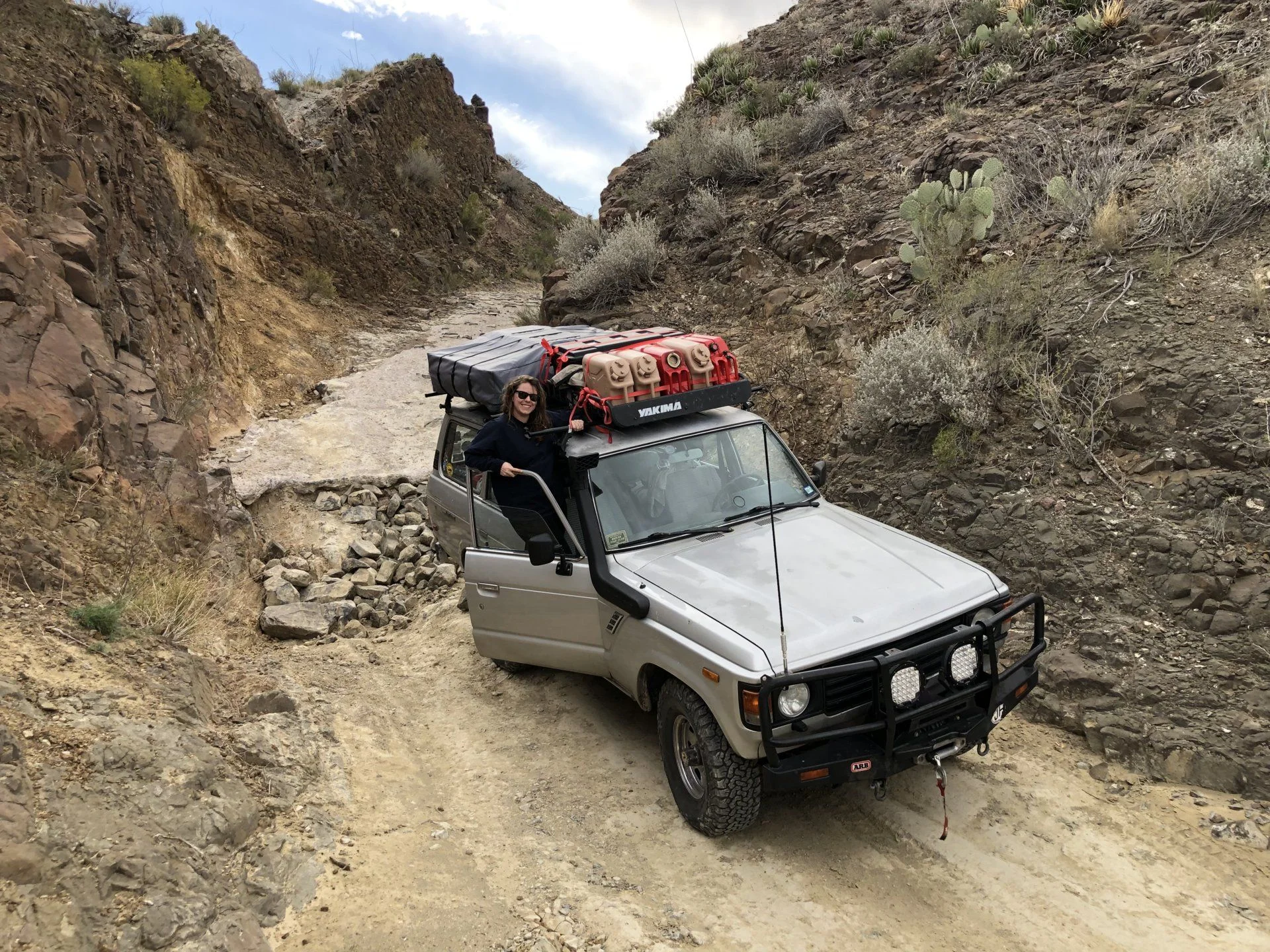

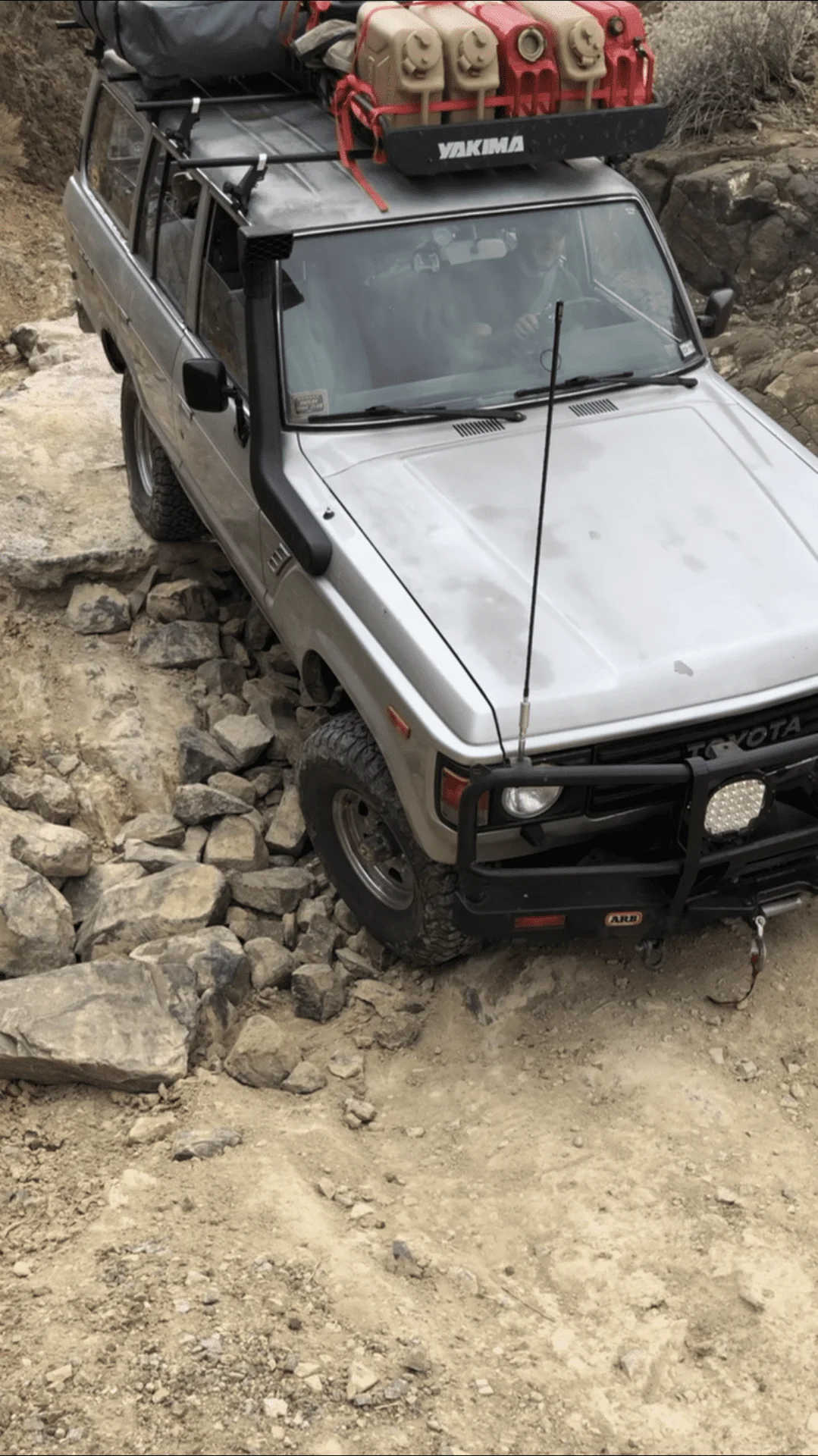

Moved some rocks with the bumper(s) and the wife had fun spotting. Also loving the on board air.
Makes starting a fire easier when you can blow compressed air air it.

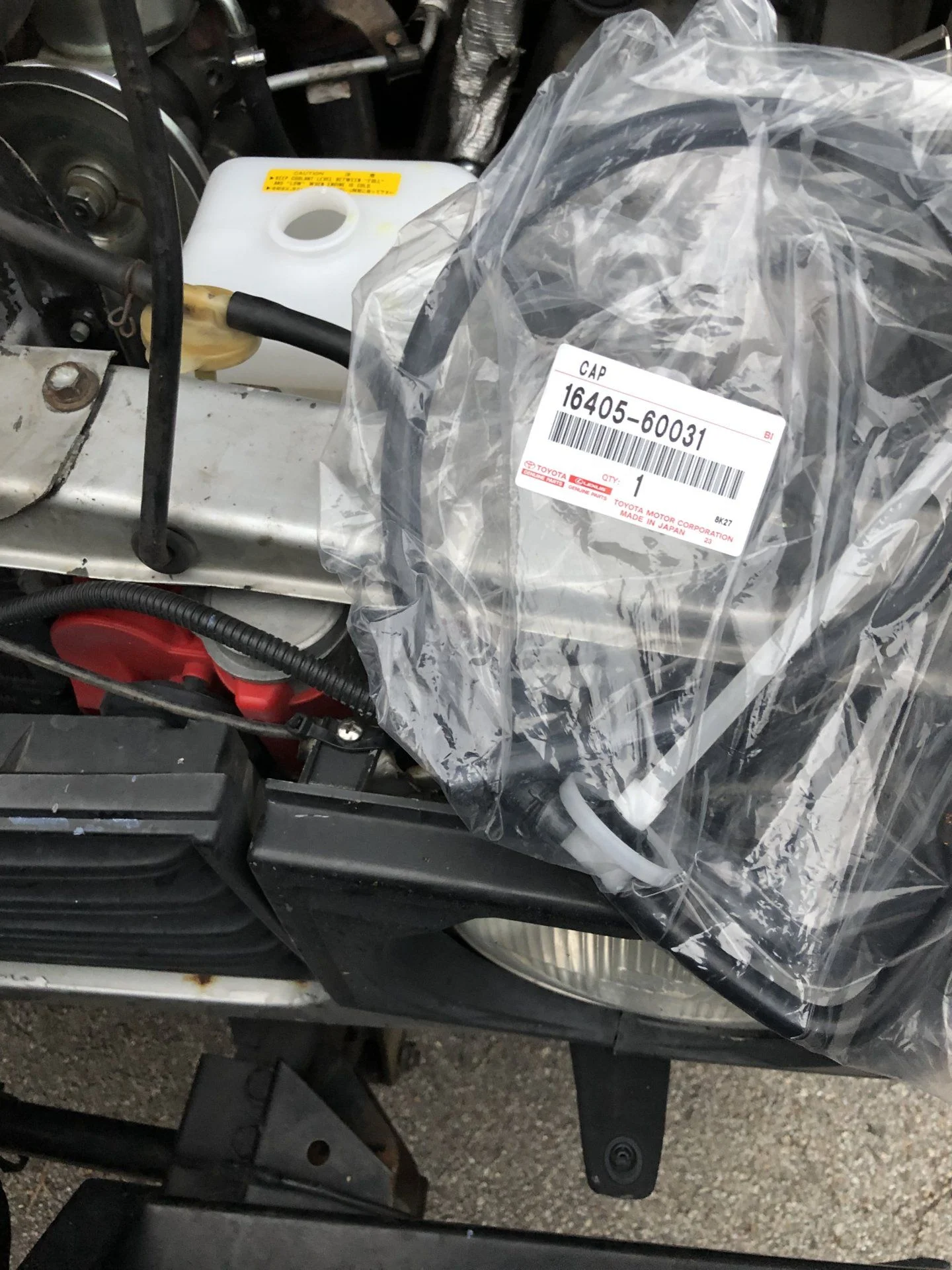

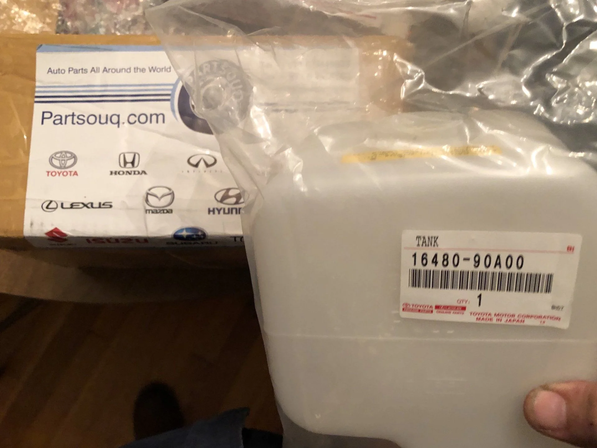

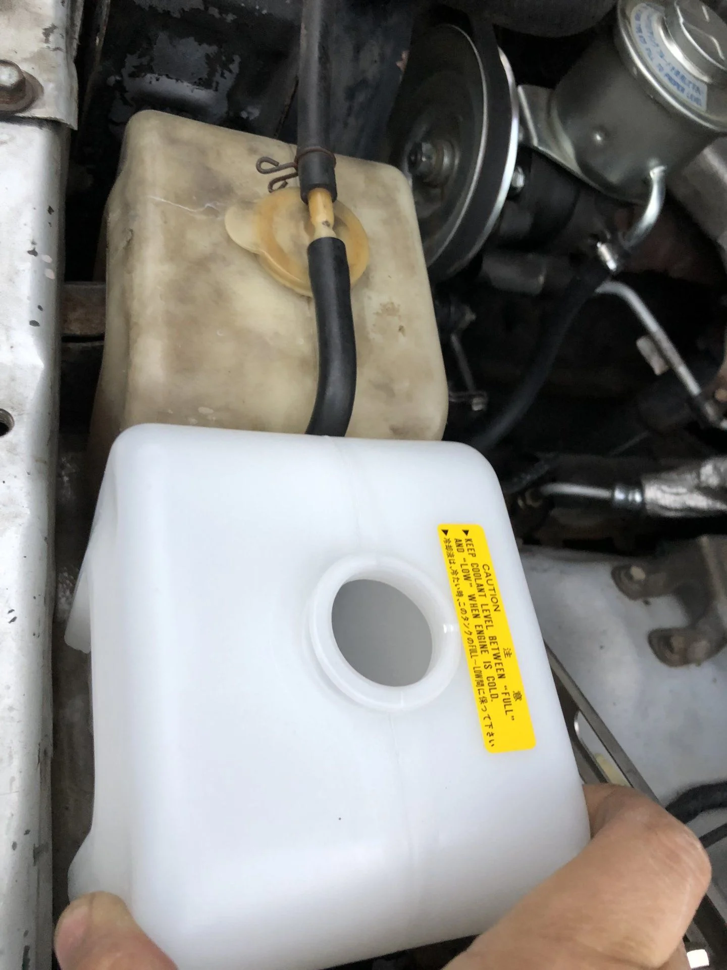

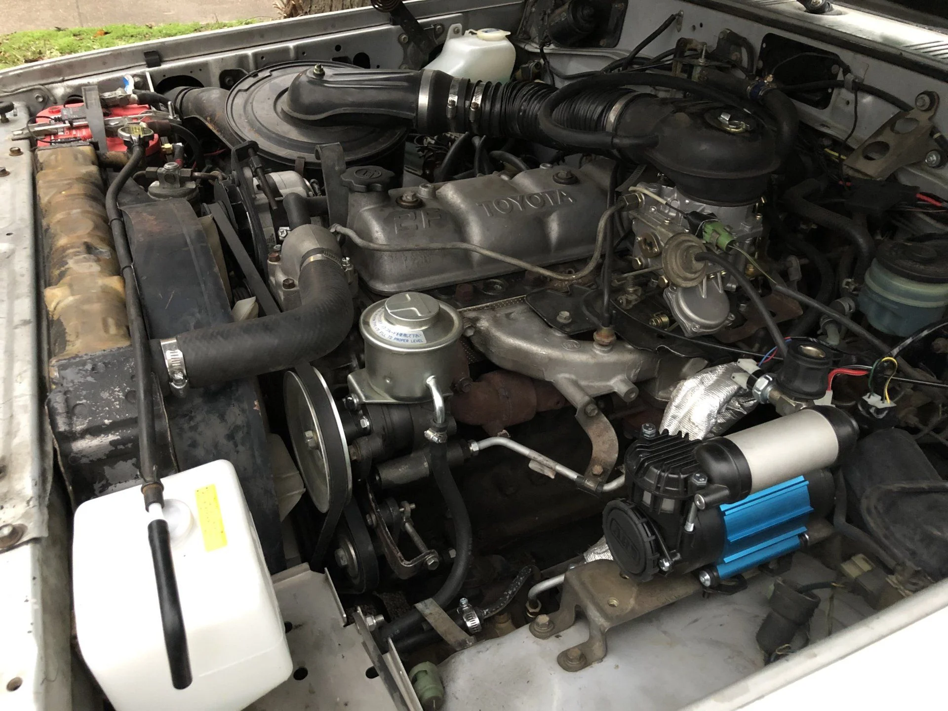

Had my coolant reservoir crack on this trip. I bought a backup from O’reillys, but this time around I was able to order a coolant reservoir from partssouq, and a cap and line from city racer. @Racer65
The hose on the cap is a little short, and I had to cut the siphon straw a little to match the old one. Works perfectly.
I’ll top it off tomorrow and re-bleed the system.

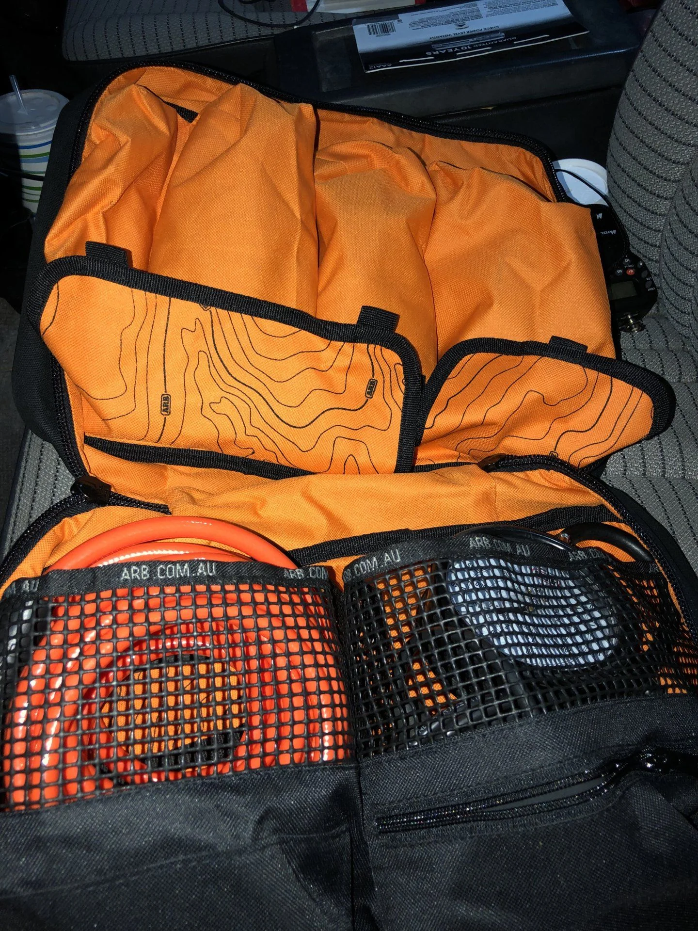

Also picked up this nifty arb case to fit the following:
Tire deflator
Large arb tire gauge
Air compressor hose
Road flares
Winch remote
Hi lift repair kit
hi lift bumper adapter.
All fits under the drivers seat.

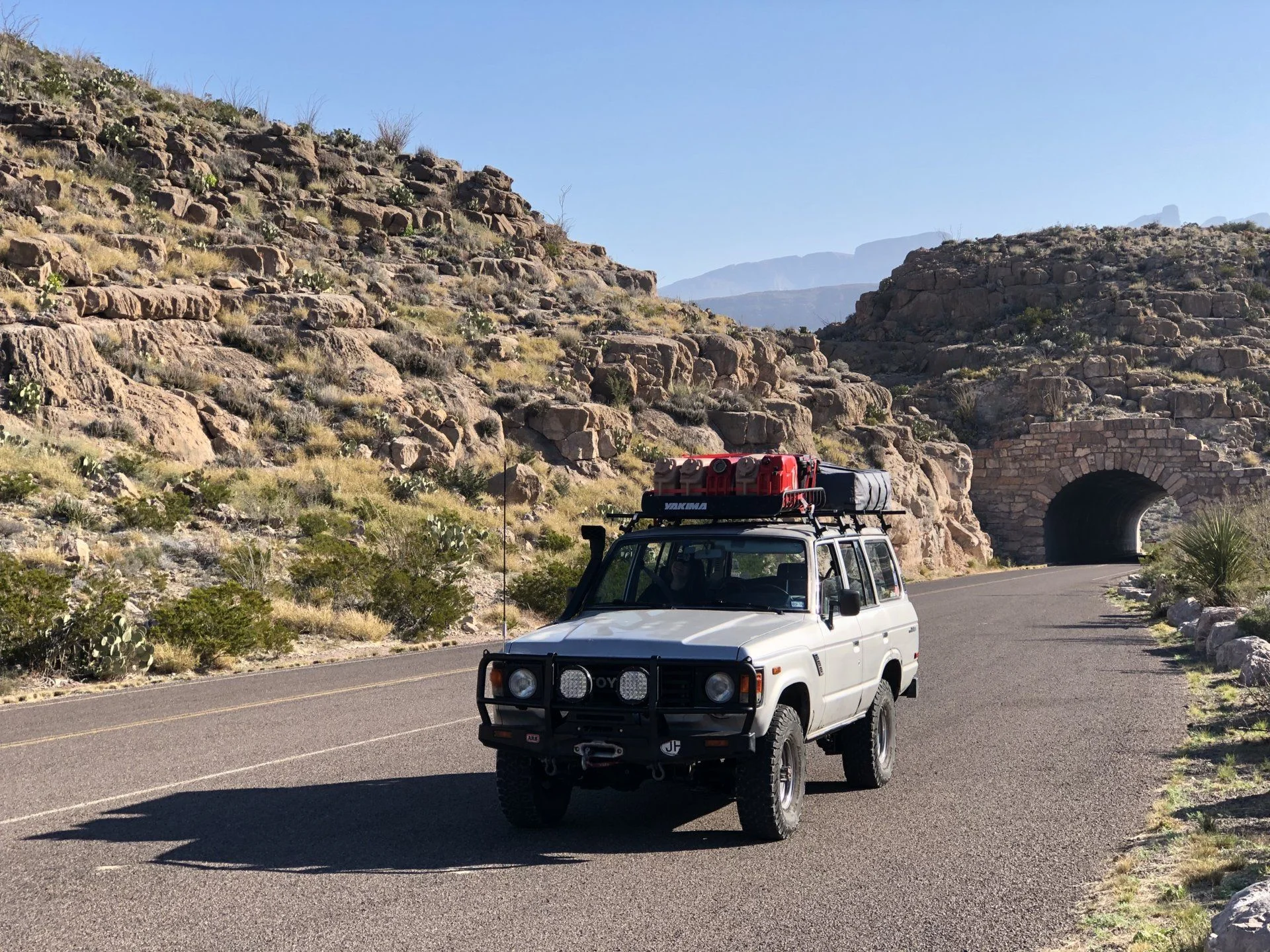

More of our trip. I’m happy to even have a place like BBNP in my state.

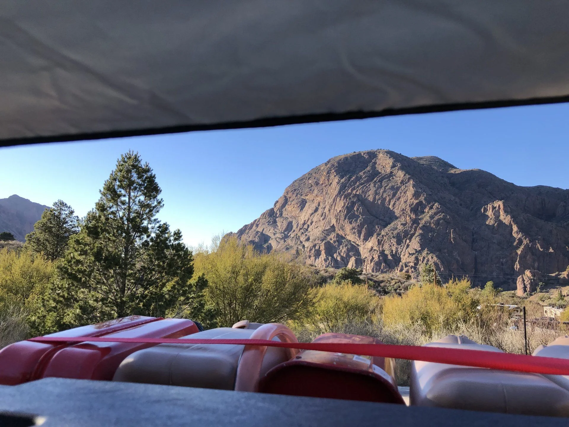

Hey Alex, I see a combo of metal and plastic jerry cans. Which for which?
Red are metal for fuel. One has a nice nato style metal cap and the other has a gas station special cap that tore circumfrentially and almost leaked on my truck. 10 gallons was a good amount and it got me out of the park to the next town over when the local station ran out.
The beige are water jugs from grainger that I got for $26 each. A great deal and they worked perfectly. You can find the posting in the camping section about them.
They suggest bringing several gallons to big bend per person per day due to the the fact that it is a desert. I had 20 total and I’m glad I brought what I did. I couldn’t imagine how quickly it would be used in the summer.

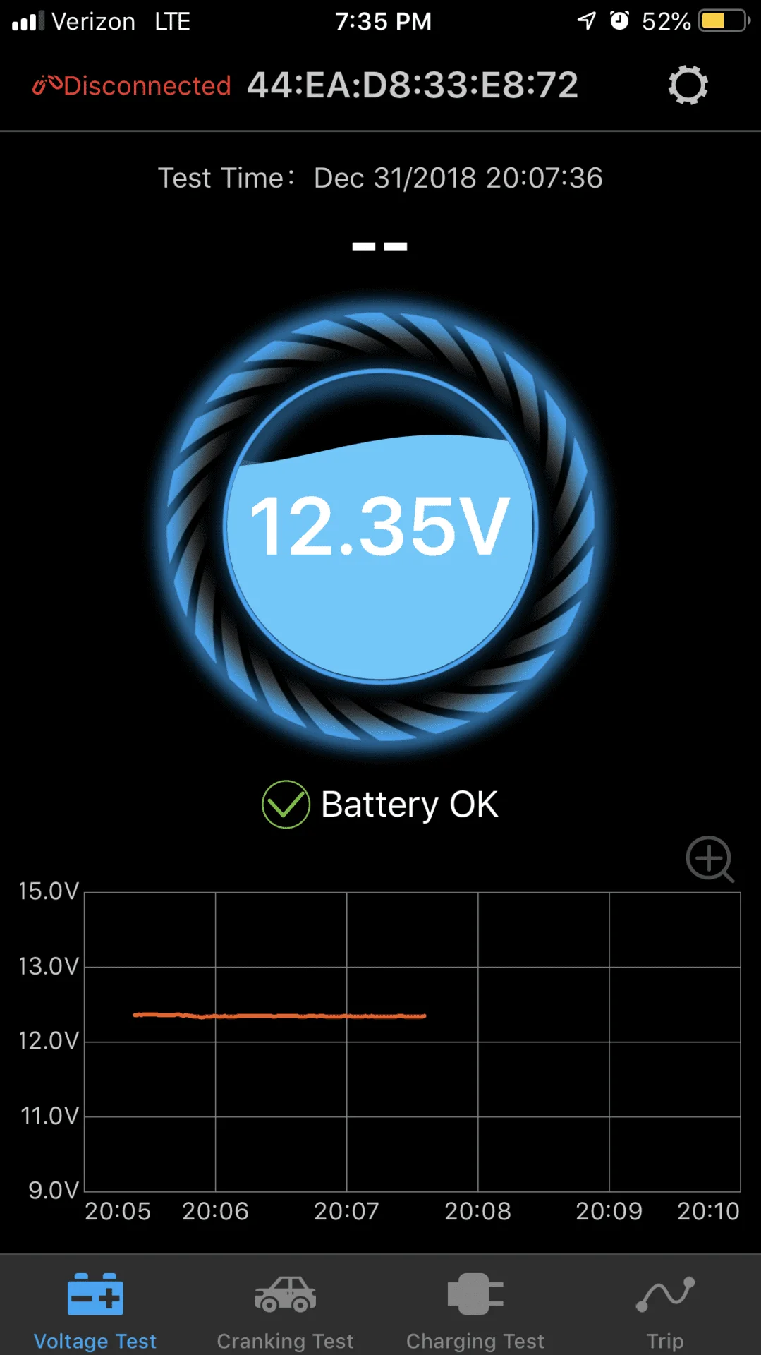

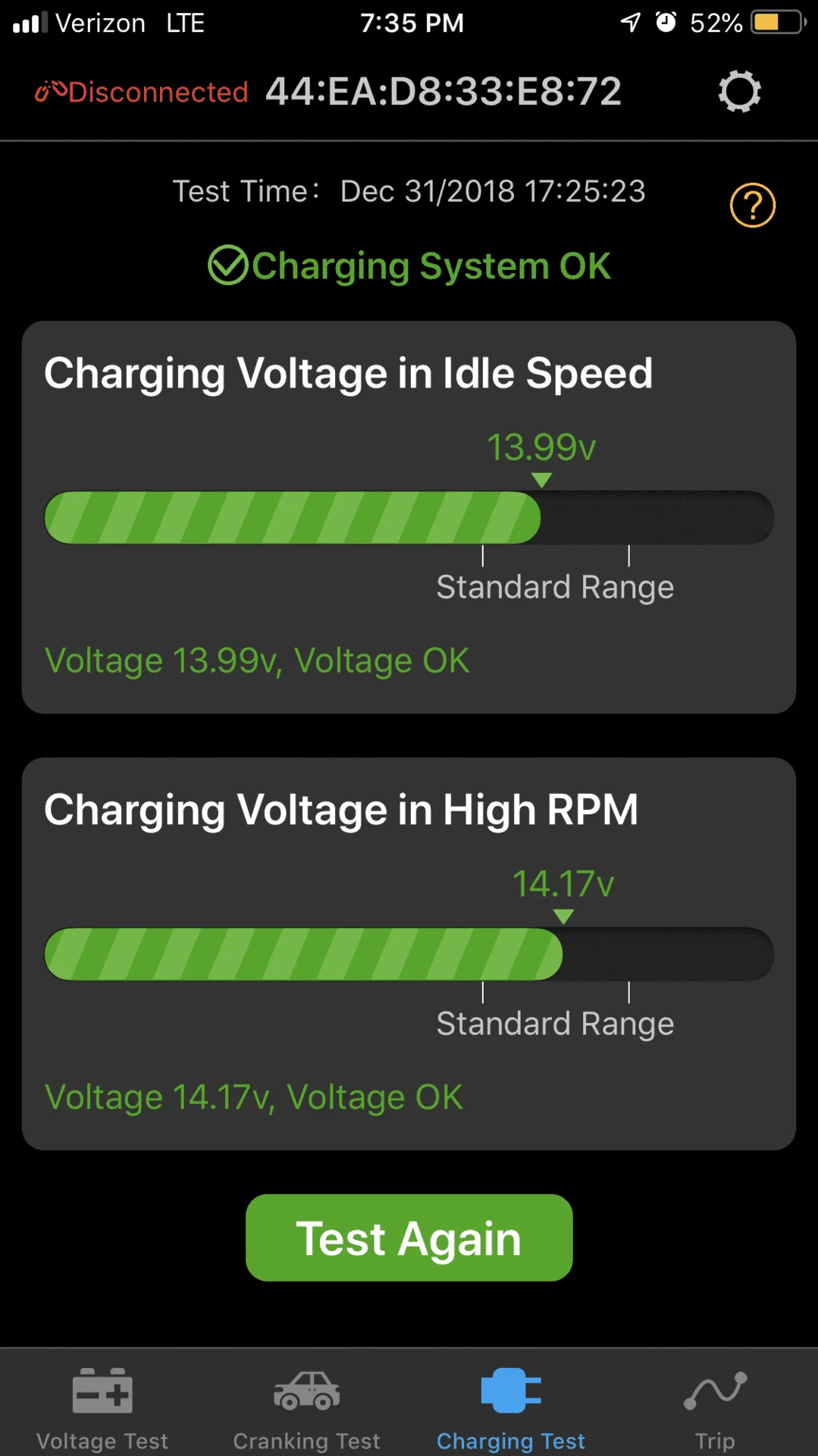

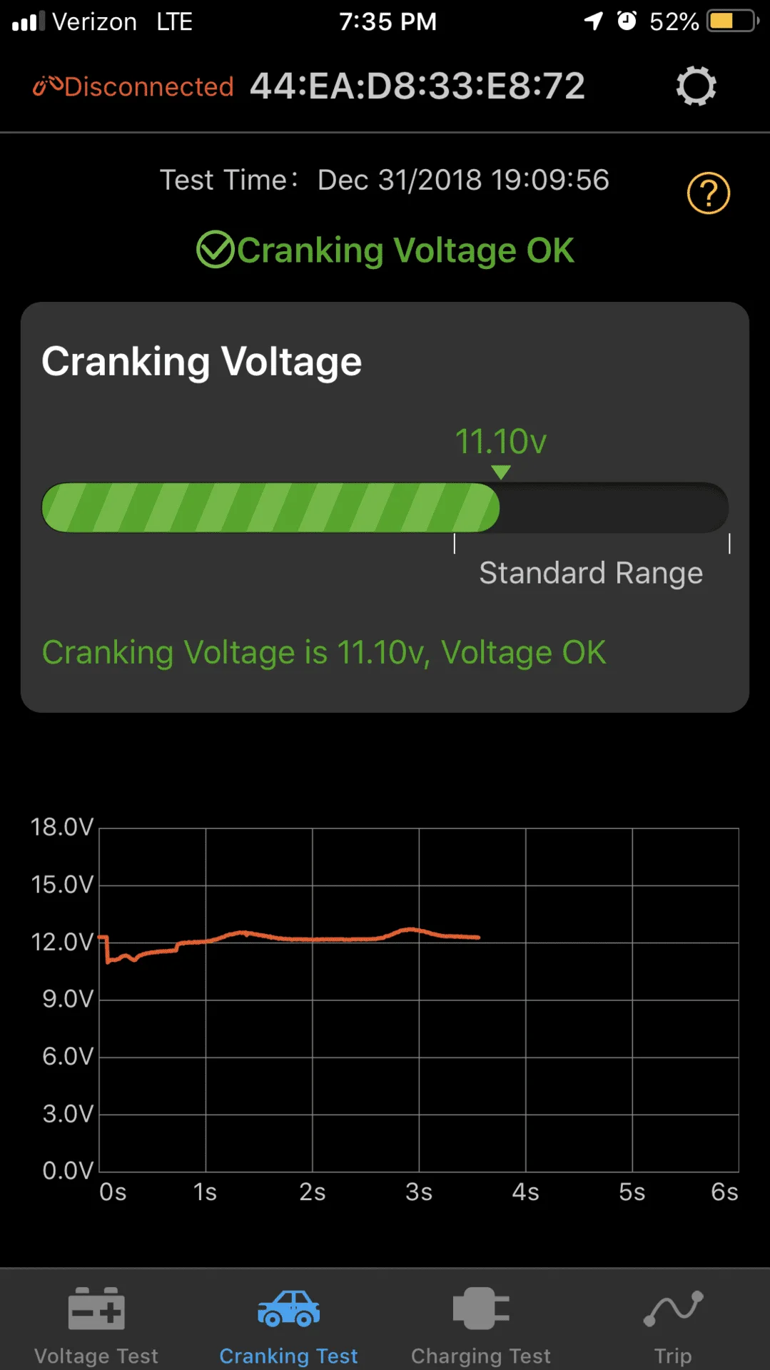

Alex - did you end up doing the Bluetooth voltage monitor? And if so any feedback on that one?
It’s working great actually. It syncs quickly, doesn’t have any glitches and really gives me insight into what the charging system is doing.
The main thing that it told me is that the gauge is wrong on the dash. No big surprises there.
12v on the gauge is really 13.1v. So my charging system wasn’t as unhealthy as I thought. Even with the arb air compressor running at a 690rpm idle, it’s still a strong system. It holds a stready voltage and doesn’t discharge. I will likely have it running more when I winch and install the extra wiring for the 2nd battery. I’ll buy another instead of running a fancy monitoring system. If that one does, I’ll move the main battery monitor onto that.
A really good $30 spent. Almost as good as my little motorcycle temp gauge.
