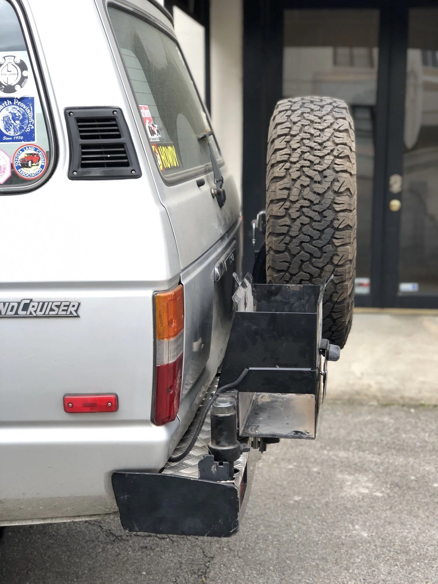

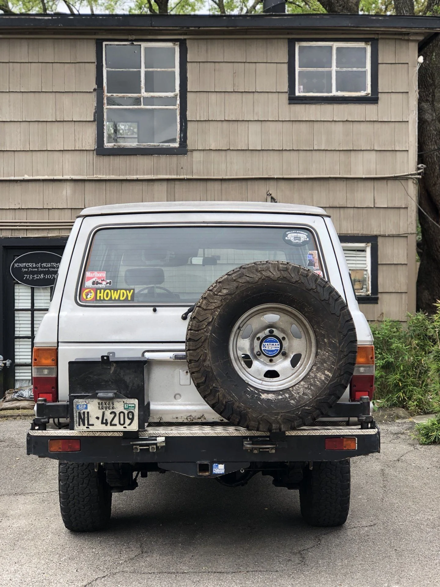

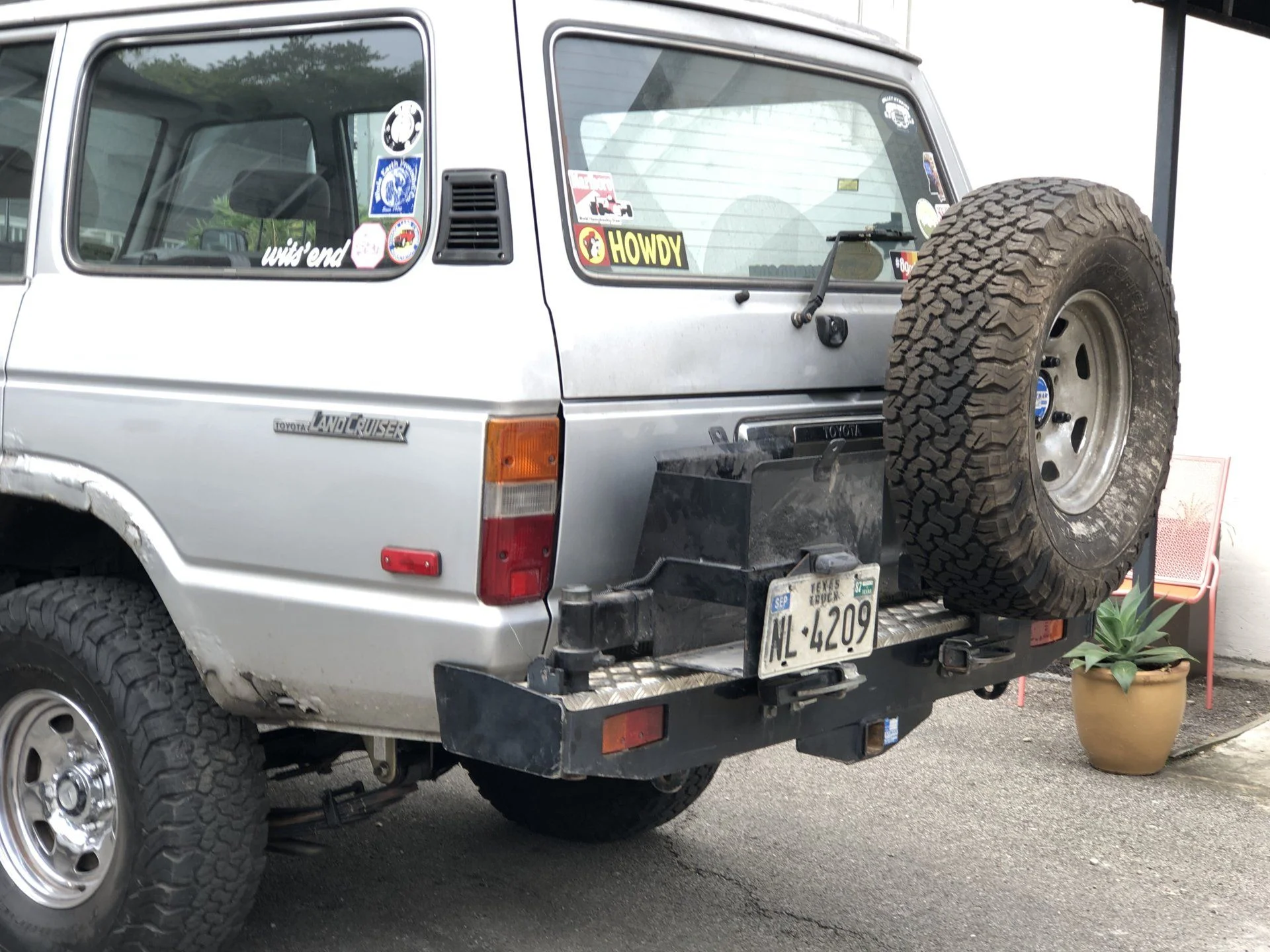

Added a used kaymar bumper from 1996. Super happy with the build and look of it. Fits the theme perfectly. Thanks to @DickM for working with me.
Also, cleaned it out. And removed the rear heater. Because Texas.
Looks just right on your truck, Alex. Glad it went to a good home.
I was originally a bit upset about installing this bumper. It really made the cs005 springs ride like hell. After a week, the suspension has settled and it got accustomed to them and I don’t feel it back there. Plus it got rid of a bit of the rake. It sits level now.
I’m really happy with this bumper choice now that it’s settled.

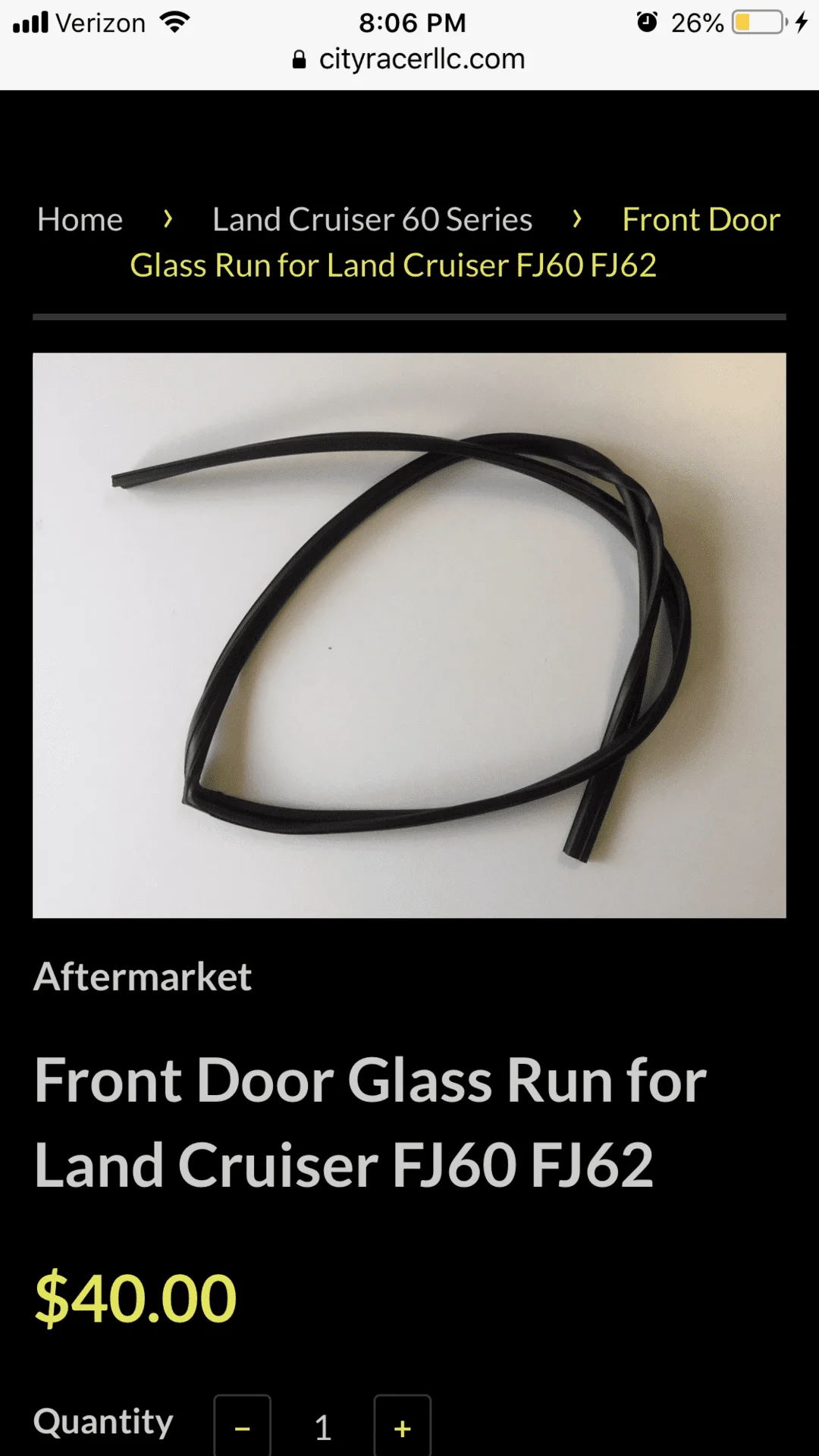

I installed the aftermarket city racer window weather stripping.
The piece was seriously hard and was not allowing my front windows to seal, letting water and wind noise in.
I’d call it a half banana job that really helped improve the civility of the truck. I’ll start doing all the door weather stripping from him now.
I’m really happy with the products and roger will get more of my money!

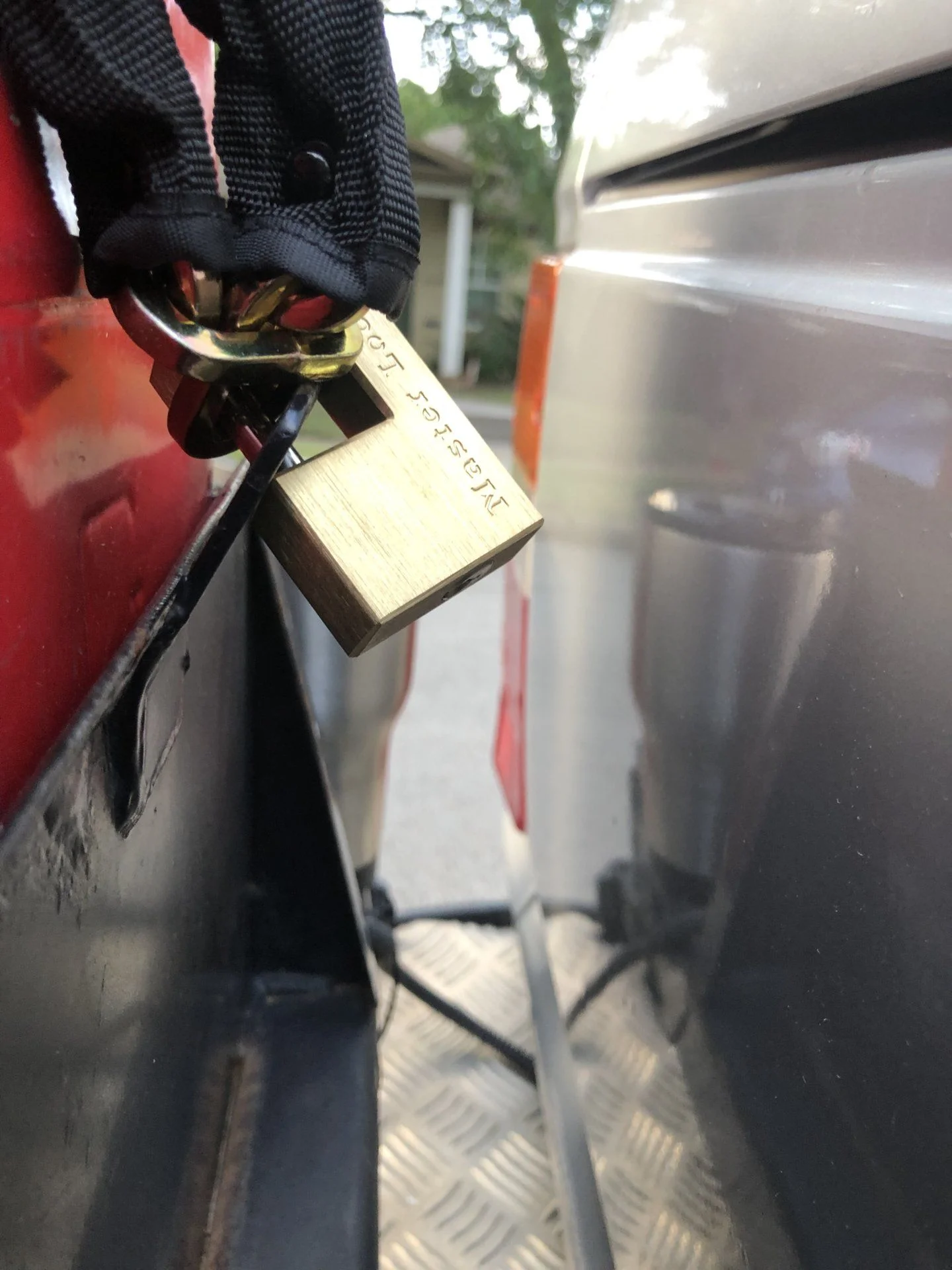

I just ended up finally locking down my Jerry can with a abus sheathed security Chain and a hitch lock. Nice and secure, and I’ll end up leaving some NEG 93 in there for a rainy day.
