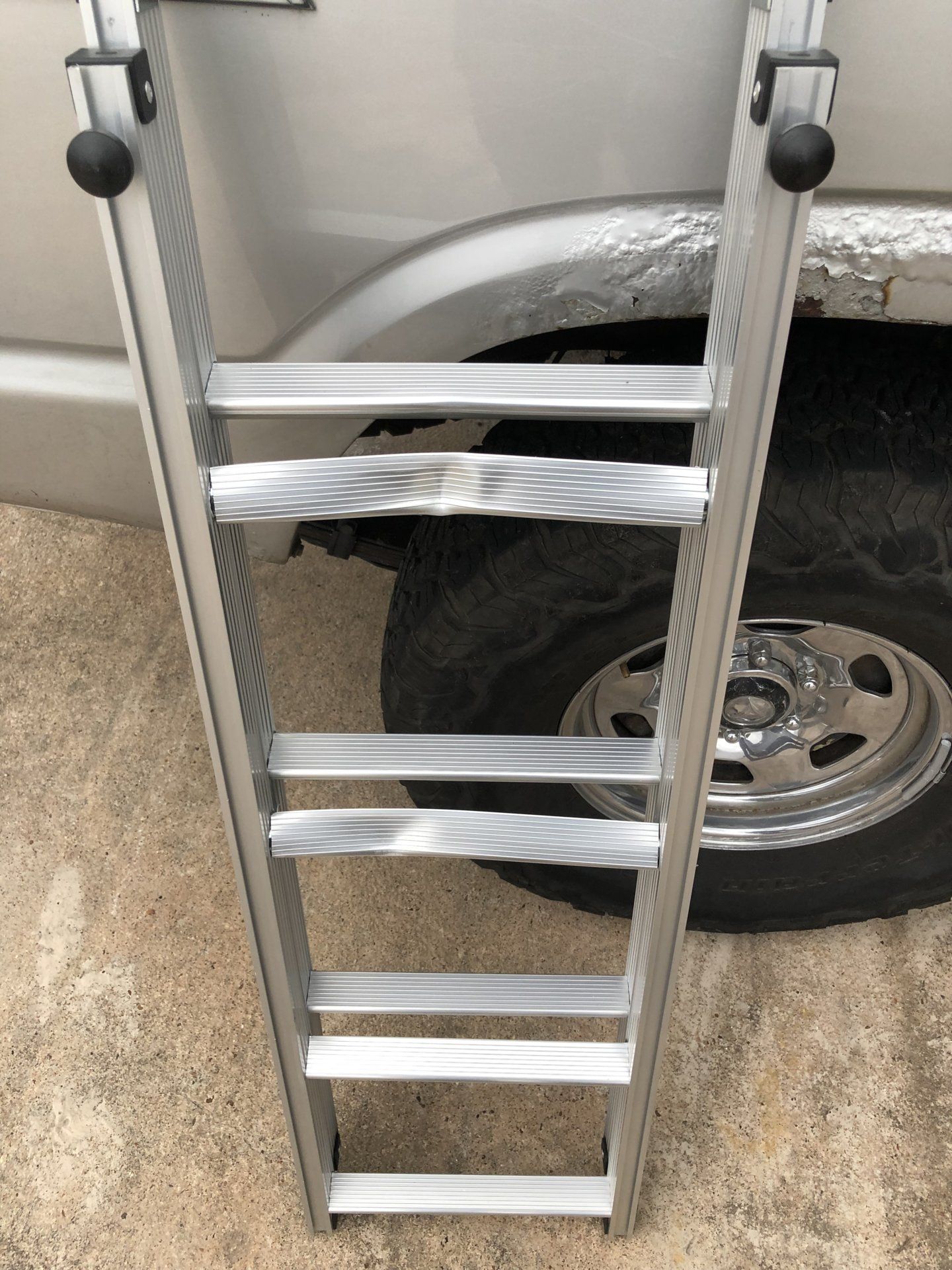

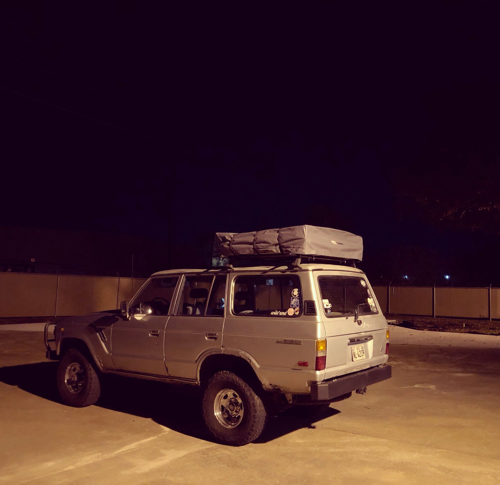

Tent is on, ladder was damaged in shipping from autoplicity. @orangefj45 helped me out on two major issues with nothing more than a few texts.
-I called arb before the vendor that I bought the RTT from to make sure they had replacement ladders in stock. They had two on the shelf. I couldn’t buy direct so I called georg and he will drop shop it before I go to big bend next week. Autoplicity will refund me the cost of the new ladder.

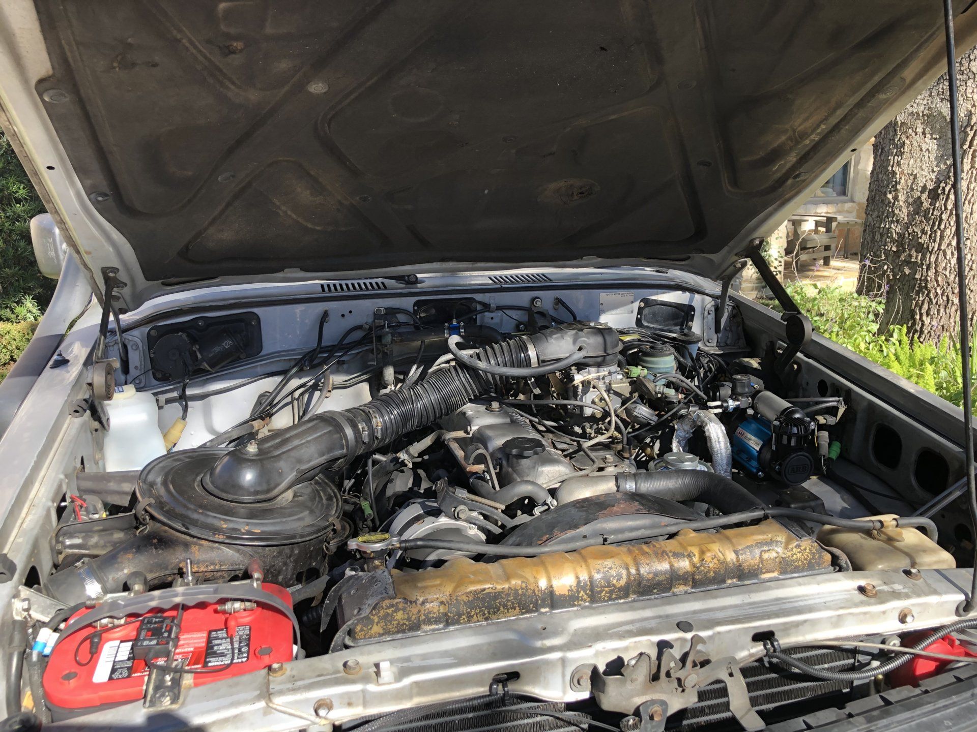

Also, I threw on a new voltage regulator and an optima group 34 red top battery. I had the truck not start for the first time ever last week and I went through the paces of diagnosing it. 3 year old battery and the failing voltage regulator causing not enough charge. The truck has never started this quickly. Feels great.
I’m not thrilled about the optima battery, I’ve heard some not so great things. But I do know that I’m pretty much always going to be close to an O’reilly auto parts if it fails. I wanted the x2 or odyssey but I couldn’t get one in the timeframe I needed. We will see how this goes.

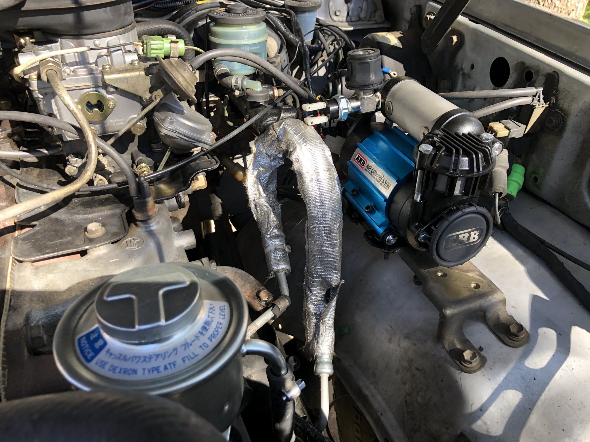

ARB compressor and power steering tomorrow.
And my ladder will arrive tomorrow. We’re almost ready for a this long trip.

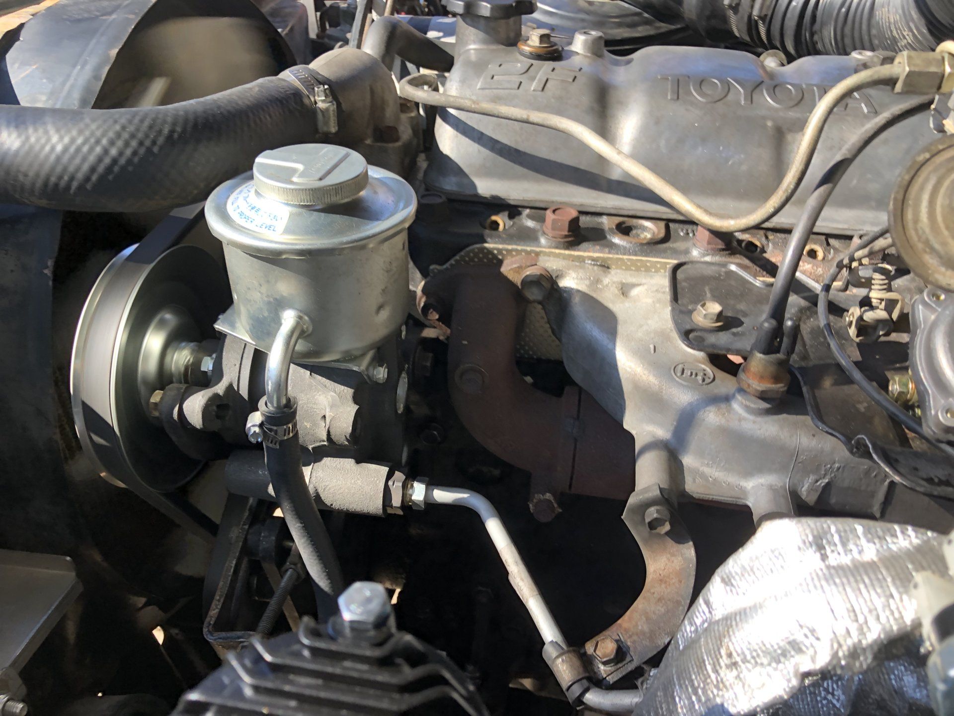

That power steering pump is a thing of beauty. I went the Saginaw route on my rig - works great, but doesn't have the same cache as an OEM unit.
The Saginaw makes perfect sense, don’t get me wrong. But when something lasts 30 years while leaking and being beaten, you buy one before you never get the chance to again.
I’ll keep a Saginaw bracket for when this one dies, but for now I’m leak free!
