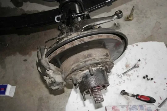

As for the axles, one of my friends made a really stupid mistake....when we were putting together the front axle, he fogot to put in one of the axle shafts...got as far as finishing up the day and having both tires on, he left, and then later that day when I went to put on the new warn hubs, I noticed on one side he had put it all together minus the shaft. lol. So we went back and fixed that and tonight I got both of the hubs on.

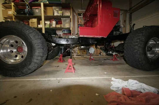

35 MTR's On...
"the warzone" who knows how I get anything acheived in this garage...

Napa, as usual, failed to get my rear bearings in time. I recieved them last week, but with finals in school, I didnt actually get to them until yesterday. The rear axle is now sealed, and the rear brakes were also put on yesterday. I couldnt finish the brakes and put the tires on though, because I was missing the brake retaining clips and pins. I ordered them though and they should be here tonight...$12.50, not bad compared to SOR's $89.00 for the whole kit. Today my cone washers, and bolts came in so I can finish the front and put on the other tire. I am still in the process of hunting down a porportioning valve and all of the necissary fittings, and once that is done the brake lines will be run. In the mean time, this weekend I plan to start the wiring....oh and shooting my painter. At this rate its going to be the prep/painting that prohibits this project from being done in time to go to college with me.
