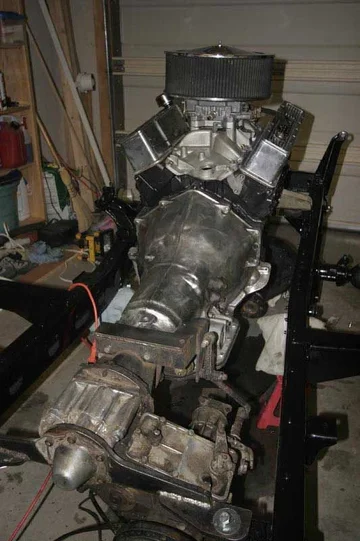

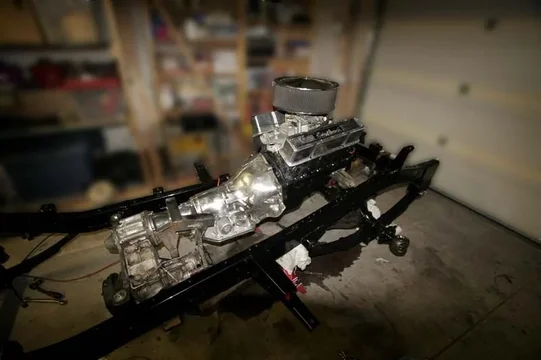

An update- Its halfway through Saturday and as of now; Glass bead blasted the intake manifold, resealed it and polished up the carb, etc. Basically the top of the 350 is all set up. Also I put a wire brush on my grinder and took the transmission back down to bare metal. It actually looks pretty cool so I think im going to polish it and put a clear coat over it. We also sprayed the intake manifold with a clear coat so that it would clean up in the future much more efficiently. All of the remaining engine parts have also been painted. Tonight the transmission will go on and the rest of the engine parts. Ill post more pictures in a bit.
progress...
DAMN TORQUE CONVERTER BOLTS!!! well everthing was on schedual and ready to bolt up the tranny when---we discovered we were missing the torque converter bolts. All the parts stores closed at nine, so it has to be pushed back to tmrow.

Cool pics Eli!! They look almost surreal
Keep 'em coming
That looks really clean....nice work.
Just a question...Is that air cleaner going to fit under the hood? Looks like it sticks up kinda high? I guess you've got a little time to figure that one out :)
It does appear to be quite high, somehow it manages to fit under the hood though. Same setup as the PO had, only new.
The bell housing has been polished and clear coated...but the transfer case is gonna need alot of TLC and some good engine degreaser before its ready for paint.

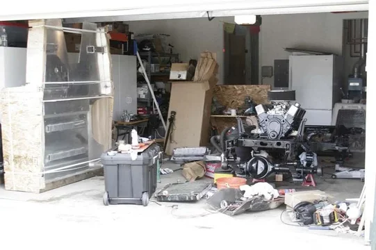

Im not sure how anything is accomplished in the mess...but whenever I go to clean it up I somehow get distracted.
