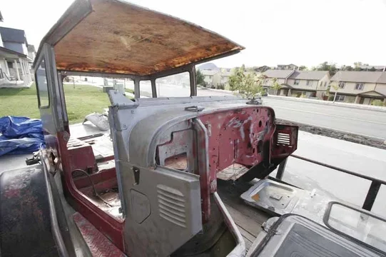

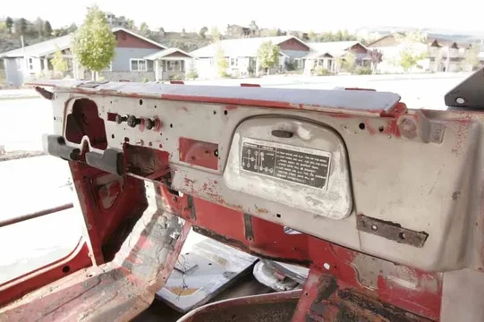

Alright. Time for more pics. I just brought back the trailer full of body parts fresh from the soda blaster. (Specifically told him only to blast body parts, and from the cowl forward, since I will be installing the Aqualu tub.)
Soon to chop up the tub to make rooom for the new portion, but in the mean time we have several things schedualed. On thursday it will be back to the garage to finish the front and rear axles, and get the thing on tires. From that point most of the attenttion will be focused on the brakes and steering assembly.
Alot of body filler on some of those panels! And better get some sort of paint on the bare metal or you are going to be getting them blasted again! I was surprised to see you had them blasted with the windows in.
yea I guess the soda blasting doesnt hurt the windows/seals. My two door windows shattered just from moving them around!. Its been raining tons here which is not characteristic of our weather...Nothing seems to be reacting to the moisture, and its been bare for several weeks now. The hood actually got rained on when one of the tarps came loose, so it does have some rust drops...but merely surface stuff that should come of really easily. Im leaning away from putting anything on it in regards to a primer or somthing to protect it, so that the painter can make all of those calls, but I was considering taking it down to the painter to have him do all of the prep/priming he wanted to do before the paint goes on, and then taking it back to my garage and putting it together. That way I wouldnt have to worry. Either way I need to get ahold of him and figure out the best way to address the situation. My Warn hubs arrived this evening from MAF and man do they look nice! Also recieved the seal retainer kit from SOR to finish the axles.
Looks real nice!
When you get around to sand blasting the bottom of the tub, I would suggest using sand (specific for autos) for blasting. The is stock undercoating is a real pain in the ass to get off. You'll go through 300lbs of sand!!!
For some reason the stock undercoating seems to reatain moisture. It's very important that you take it all the way down to the bare metal if you'll be putting all the $$$ into paint.
Looks real nice!
When you get around to sand blasting the bottom of the tub, I would suggest using sand (specific for autos) for blasting. quote]
I am sure Eli isn't going to bother. He has that sweet aluminum tub to put on!
If you don't get something on that bare metal after its blasted moisture can get in the metal and cause paint bubbling later. Been there done that and don't care to repeat it. I'll use rust prep this go round http://zero-rust.com/zero-rust-prep-step.html Just a pointer I would do all your cutting, drilling, and welding on your new tub so that you can send the tub and all the body parts off to be painted. Unless your painting it yourself. While your tub and parts are off to the paint booth it'll give you alot of assembly time for the axles and other things so when the painting is done your ready to plop the tub on the frame and get to the tub assembly. Worked out great for me.
