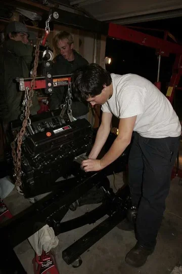

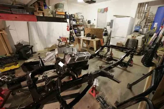

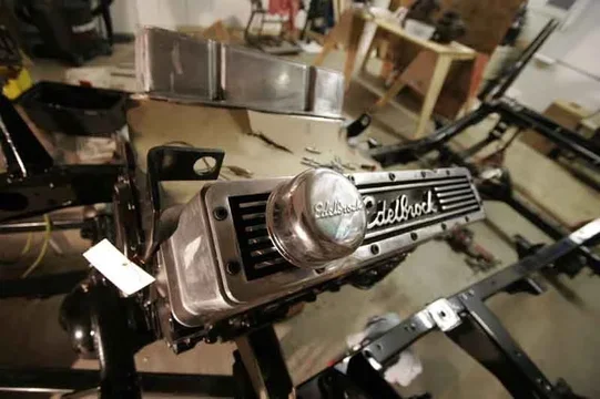

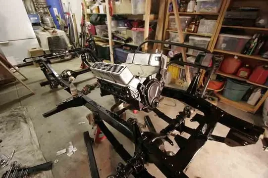

New Pics
Ok so here are some pics from last night... Dropping in the new 350! yesss. Im sportin my MAF shirt.
