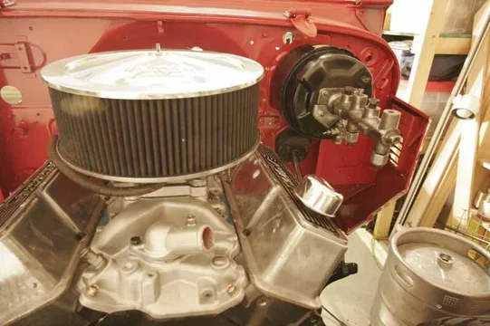

I had a very productive first day away from classes. Today I pulled out my very rusty brake booster, master cyl. etc. and ground everything down to bare metal. As you can see there was a little hitch along the way when my hands got in the way, but things kept moving. After it was down to bare metal, then I put a clear coat over the master cyl. (so it would retain the shine of bare metal without getting rusty) and then painted the main portion black.
Lookin' good!.......Wait thats a understatement, lookin' great!
