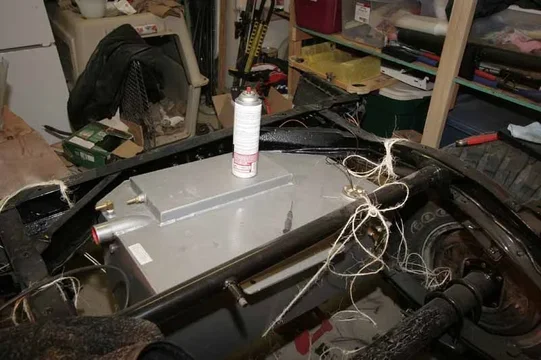

Yesterday we started to set in the gas tank, but ran out of time. Tonight the goal is to get the gas tank in with the lines run.

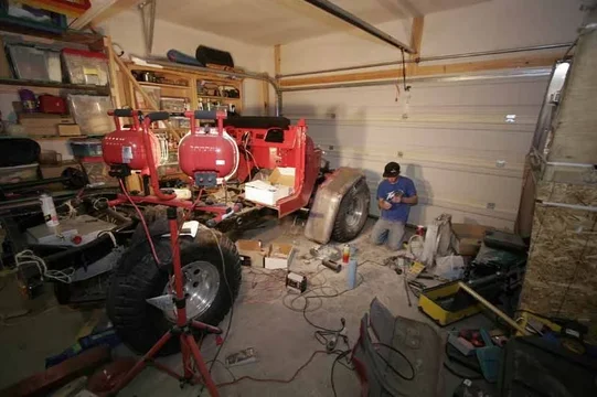

This is why the garage is so dusty...first decent snow of the season...proved to be pretty cold out, so we did all of the sanding, and grinding in the garage.

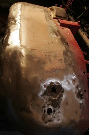

Once all of the old bondo had been stripped down...
One of my buddies Eric, voulenteered to bondo the fenders for me, so that the painter could spend his time makeing sure the body was in show room finish quality.
Nice job. And I know about bondo dust. Just don't breathe to much of that stuff it'll clog you up. With all that hard work why cut it short and fill those fenders full of bondo. Source some decent used ones or order new. With your new tub, using some fenders banged up and full of bondo just don't seem fair to your project.
That rear tank is the one MAF sells right??
I ordered mine about a week or so ago, I think I may be on a waiting list for them.
How do you like it??
It seems to be a really good fit....Obviously I havent fired it up yet, but sofar it seems great. Pretty Heavy. It was kinda a bioch to get in, because we had a tiny jack but if you have a decent floor jack and some good metal bits, it should be cake. I was very pleased with the accessories it came with. Need nothing other than a drill and a jack.
Tru true. At this point the budget has hit and gone way beyond the limit. The thougth behind the bondo is as follows...We can make em look decent, and then within the next year I will be able to afford new ones and just use the leftover paint to have them painted.

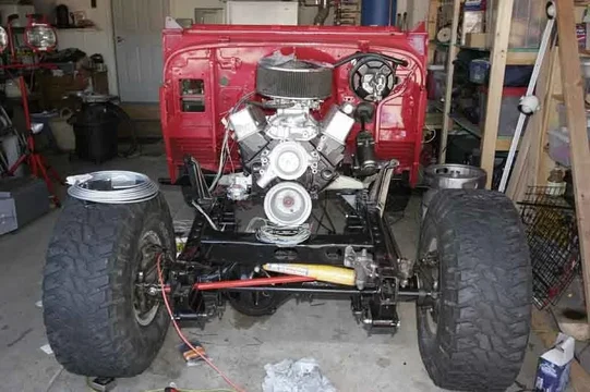

So this last week we have been pushing hard to get it ready to be fired up. Last night that opportunity posed itself....Pressed the start button and......NOTHING everything works...but the engine wont crank....guess wat? The bran spankin new motor Jegs sent me is SEIZED! well.maybe...three options as we see it (three garage mechanics and a certified one) either the new motor came seized, or, the new motor sat for a while so the seals began to set, so we need to pull the plugs and try to see if we can get it to turn manually, or the tranny is seized and we need to get a new one....The tranny is freshly rebuilt as of 1500 miles ago, and worked when we pulled it apart. It has no fluid in it, but that shouldnt have any bearing on if the motor turns over. The starter is working fine, so we figured out it was siezed by tryint to crank on it manually and after full human force was put on it, it doesnt turn...atall.
Im not sure what to hope out of this whole situation, the motor is warrantied through Jegs and GM, and so I called Jegs and they said that my local GM dealer would fix it or make the call if it needed to be replaced.
Im about to start looking into the price of a new tranny...if I have to go that rout, might as well uprgade from the TH350 to a 700R4 with overdrive or something.
Eitherway, Im over budget out of time, and FxxxED.
Ill let you guys know later today once we pull the tranny if its the motor seizing or the tranny seizing it...
Ok so its official, the motor is fxxxed. First off, we have the mystery problem of it being so damn hard to turn over....takes nearly all of my strength to turn the flex plate. Secondly no oil is pumping up to the heads....wierd. Ne how its their problem to fix. Tmrow we will take it down to local GM and beg for them to send in a new one ASAP. :mad::mad::mad:
