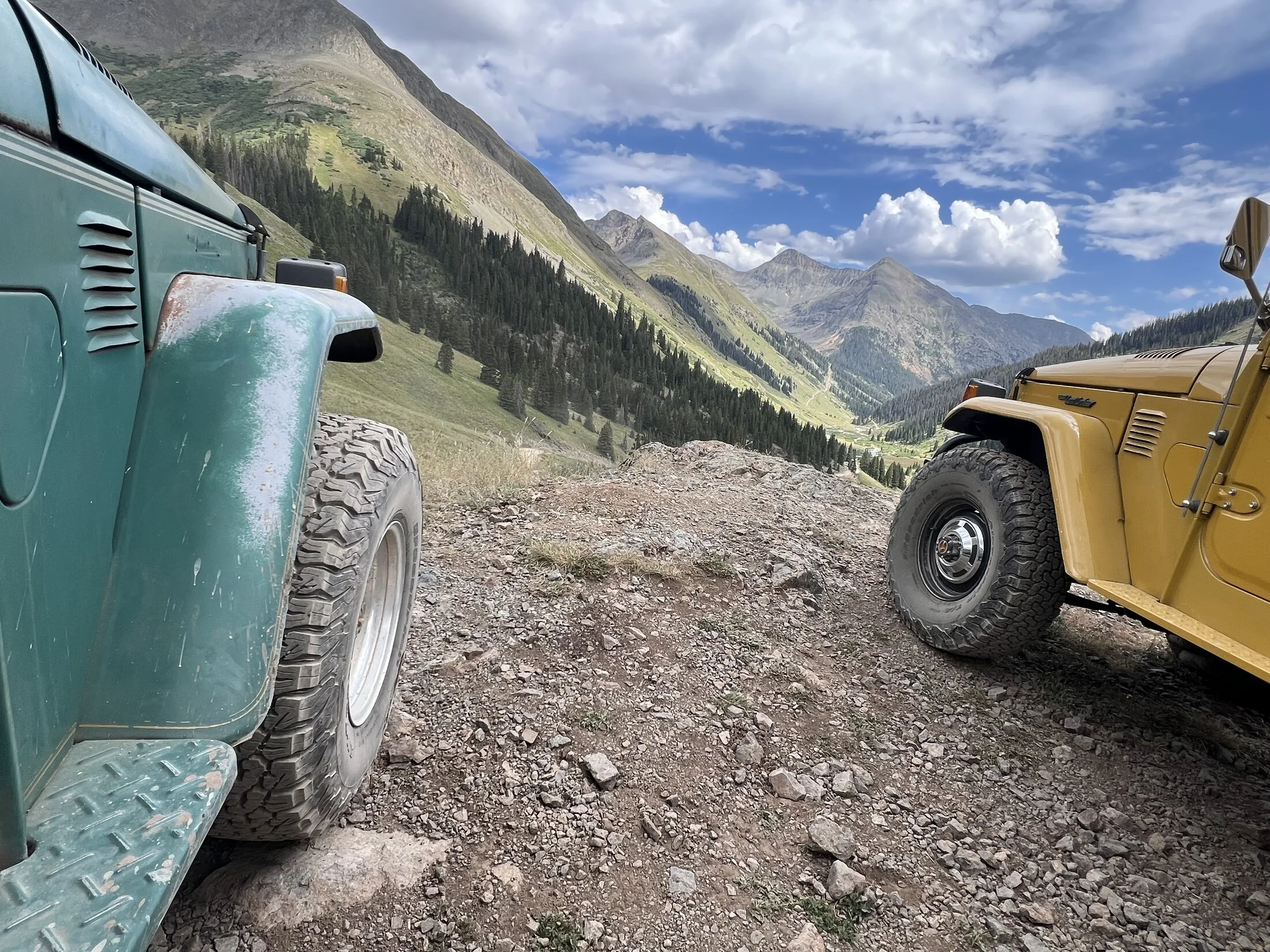

Cinnamon Pass etc shots... we flipped our rigs around here and did the photo to compare with the AI image that a computer created.

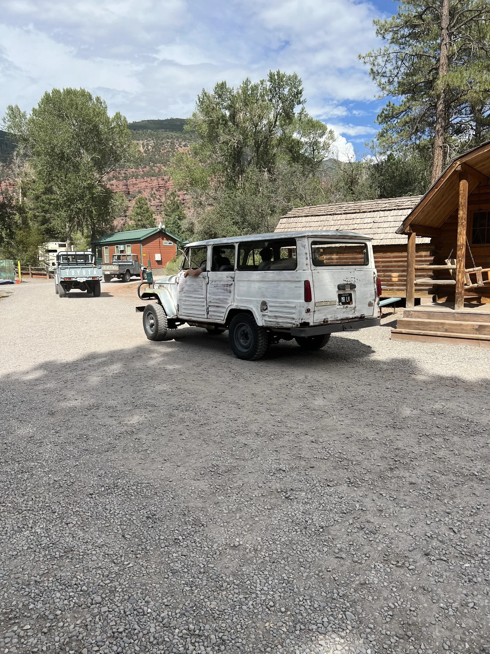

Once in Silverton, saw many more rigs. There was a repair underway on a 60's series. Ian knew them and we were introduce to many people.
Some took off to check in, the duo stayed and grabbed beer & food before we headed up to Ouray. Got unloaded and check in with the event. Got goodies in the SAS bag except a cool magnetic koozie. Ian was kind enough through the week to remind me of that fact he got his - :flipoff2: was the sentiment. I appreciated that.

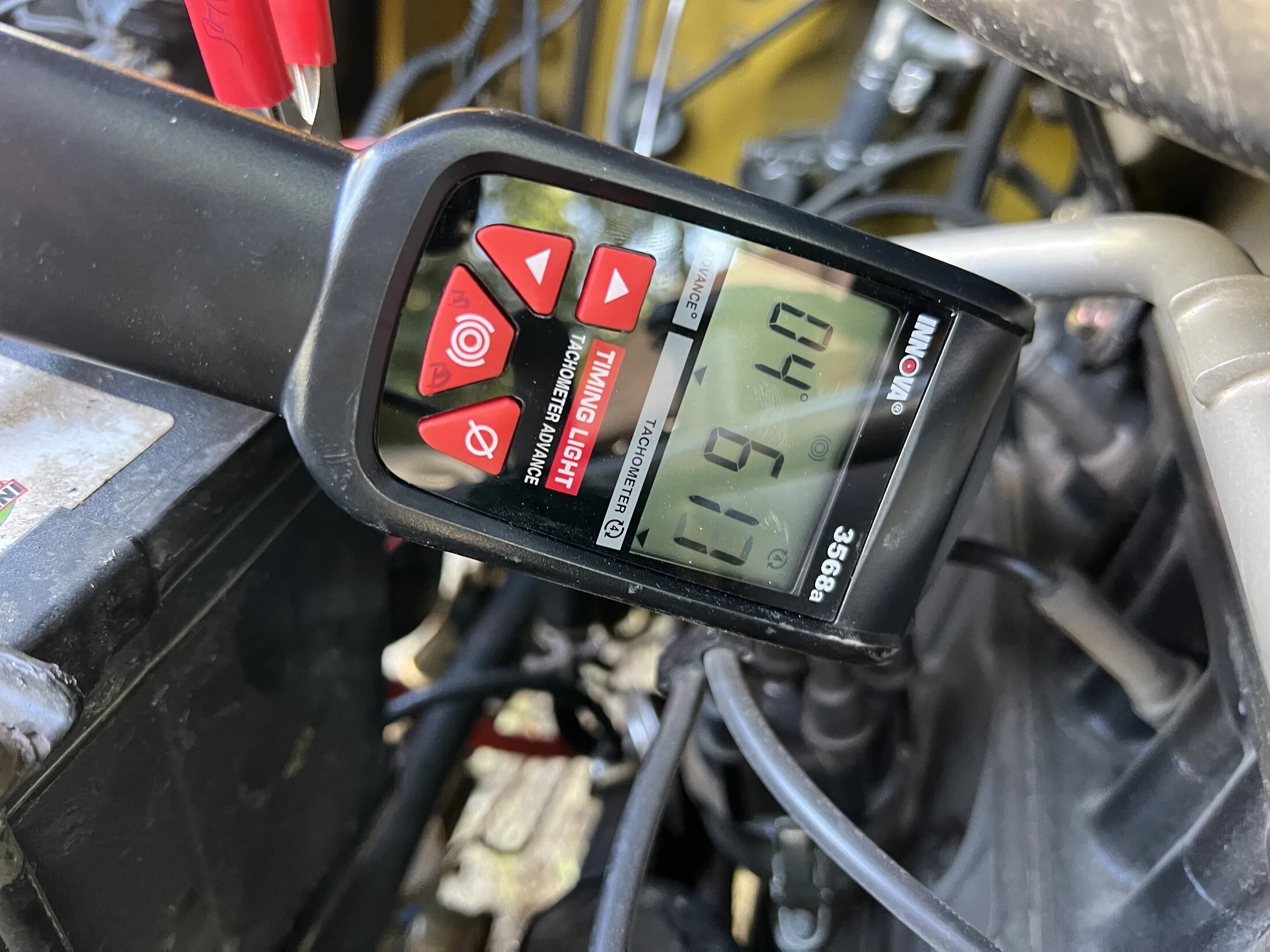

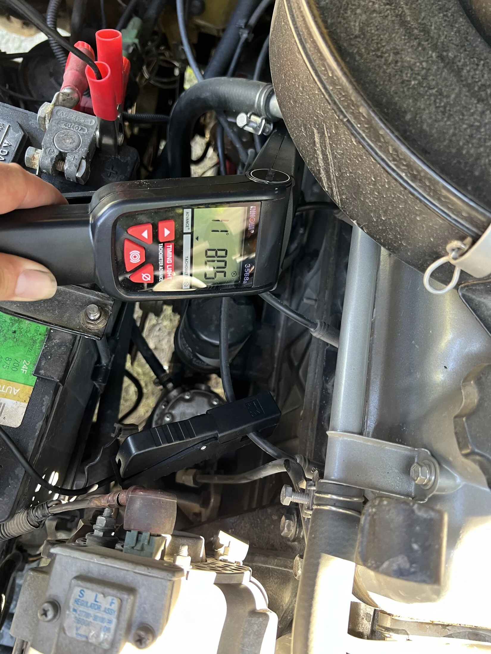

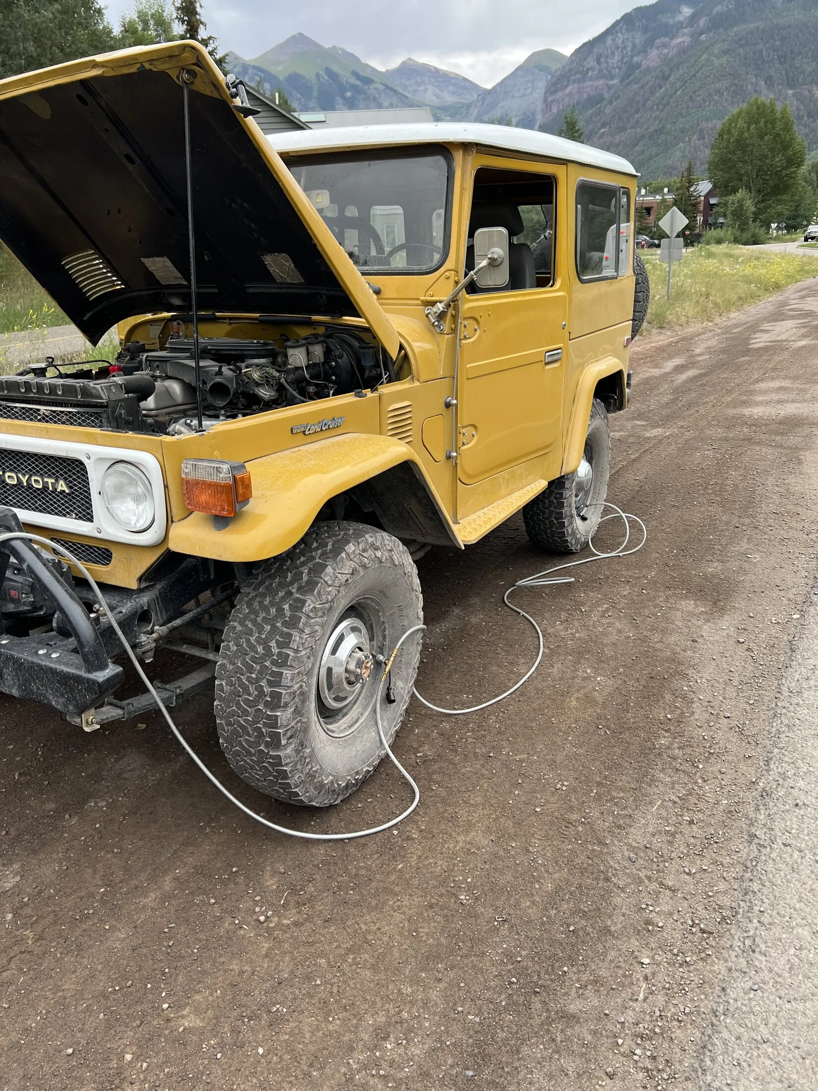

I used Ian's timing light thinking maybe mine was bad/off. Nope. His said 4* (close enough to mine) and rpm were low (older rig 650, newer 40's are 800). Set timing to 11* & quick lean drop to adjusted air/fuel and idle.

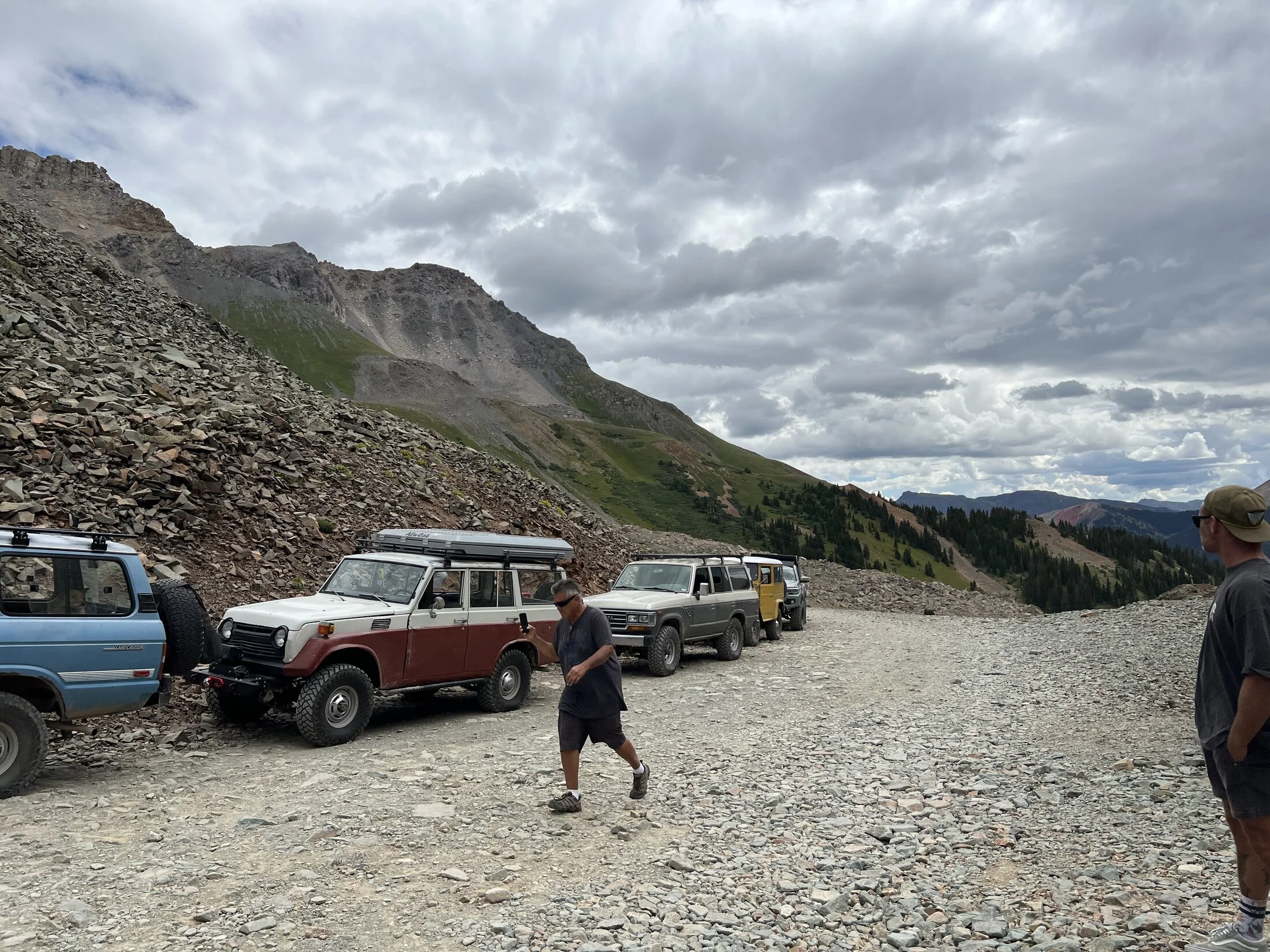

@PuddinsBuddy had sniper issues on Monday. Tuesday am the hood was up and troubleshooting was underway. We watched and help were we could (hand a part, wrench, etc.). Leave no one behind. Finally it was determined one of the injectors was bad and calls made to see where/if some could be secured and how fast to arrive. Since they were down, hunting parts, the trio set out for the day.

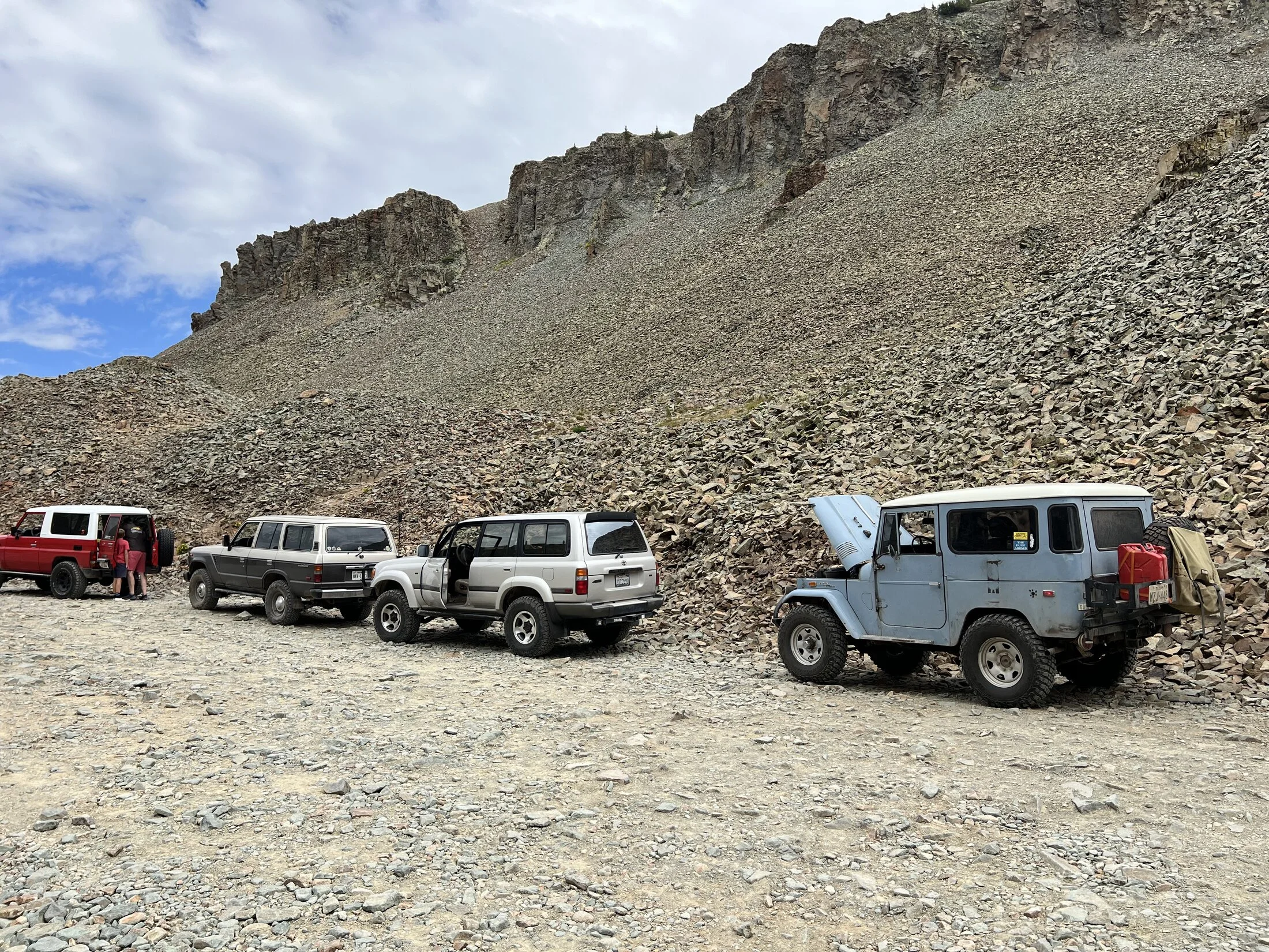

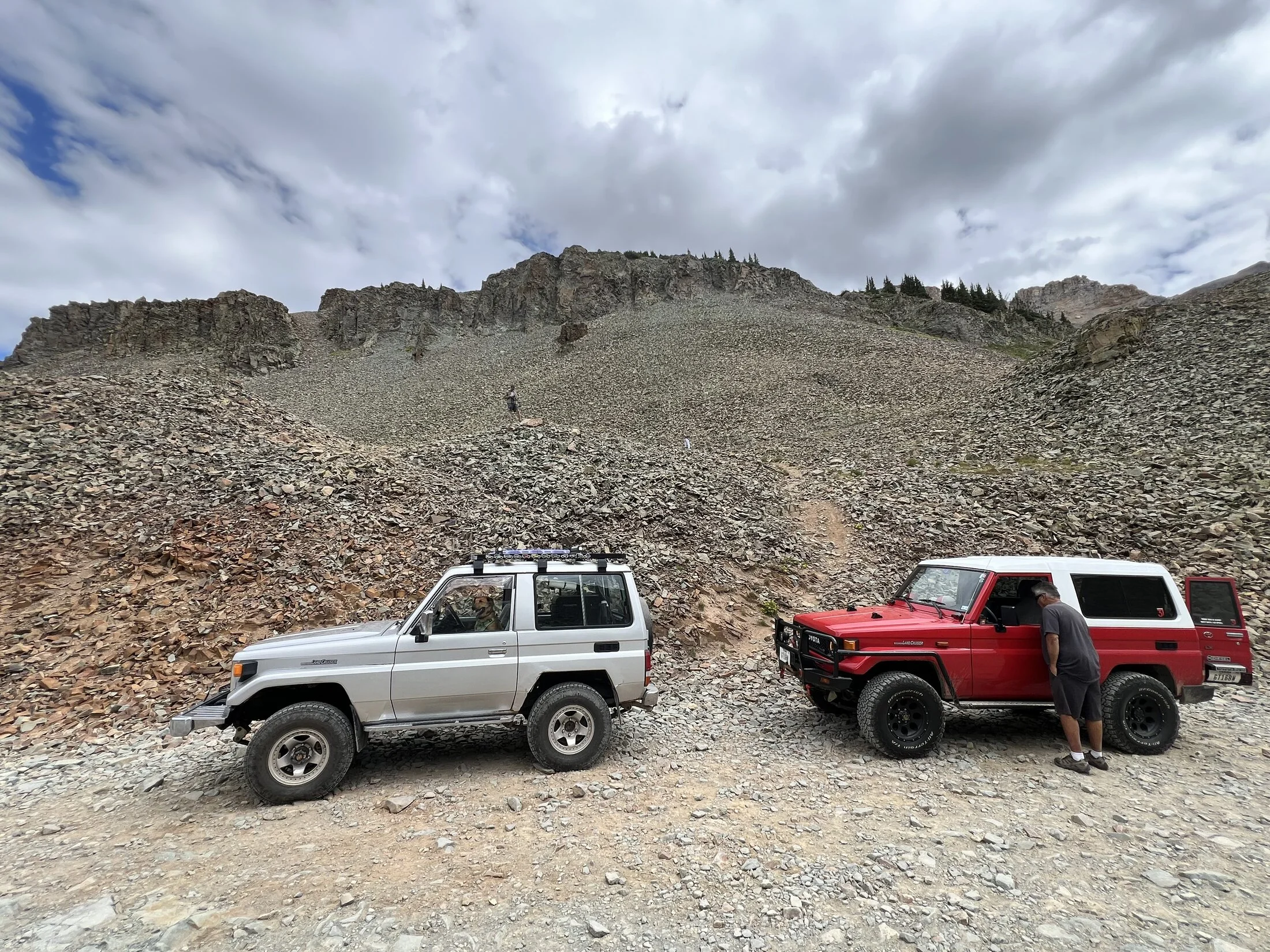

This is the area we got stuck on for over an hour.

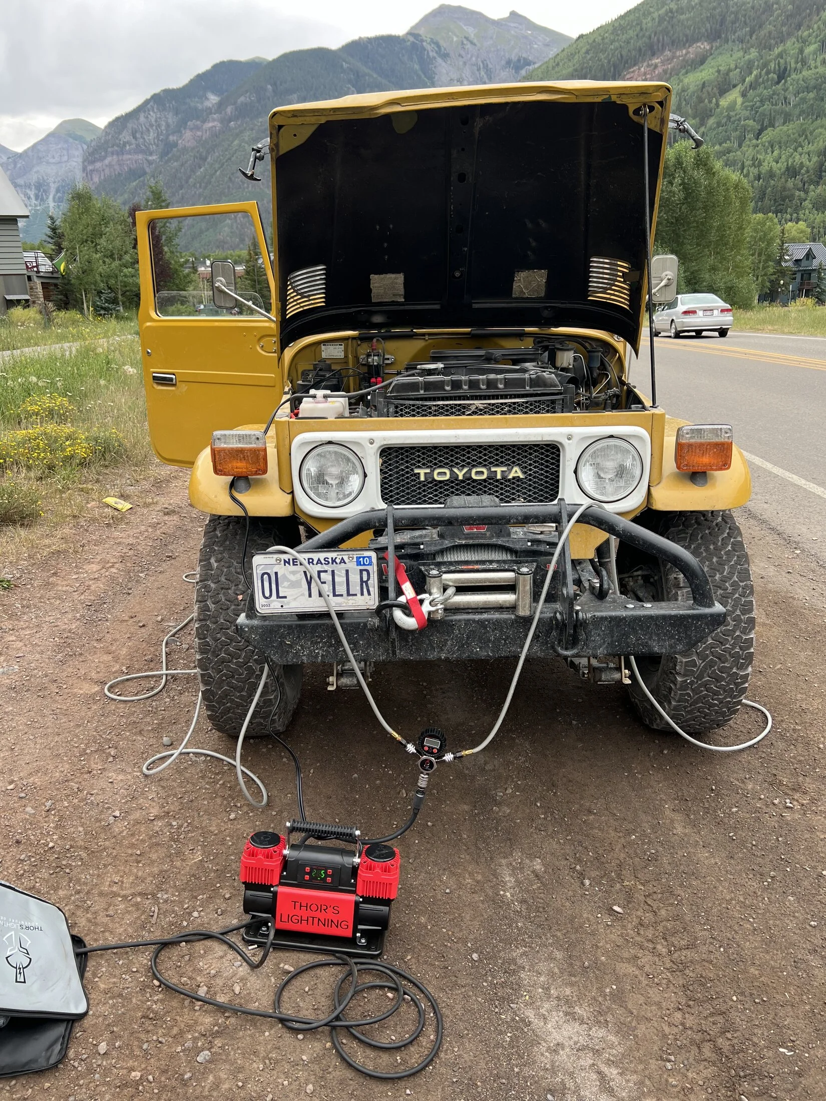

There is a pattern I forgot to explain with filling up in Ouray. There was one place that sold non-corn gas. Pure gas was highly advised, especially for carb engines. The issue is vapor lock at altitude. Corn gas has a lower boiling point vs pure gas. With the elevation, the boiling point is even less. The last thing you want up high like that. Some people even insulated the fuel line to keep heat away. I brought some, never put it on.
Speaking of airing up. I got asked about my setup several times, and people were taking pictures vs just ask.
I got/use Thor's Lightning. Both compressor and hose kit. This hose kit comes with a digital regulator - air down was easy, put hose in regulator (regulator closed) - connect hose to tires. Turn regulator on. Open up to let air out. Close, give it a second and is balances air to all 4 tires, read pressure. Rinse and repeat until desired deflated pressure.
To air up, use the compressor (red thing on ground) just connect to hose kit. I got the model that was select and forget. Hook to battery for power, select desired tire pressure, hit go button. Grab beer and talk to others. It stops automatically when the desired pressure is reached and as all 4 tires are connected, the pressure is equalized. It is a 10 CFM dual compressor. It doesn't take long.
Hose kit regulator is that Y looking thing between hoses and compressor.
Edited - Ian @RevISK taught me a trick to wrap up the hoses. Over-worked and under-paid - is the saying for an over/under loop method.
