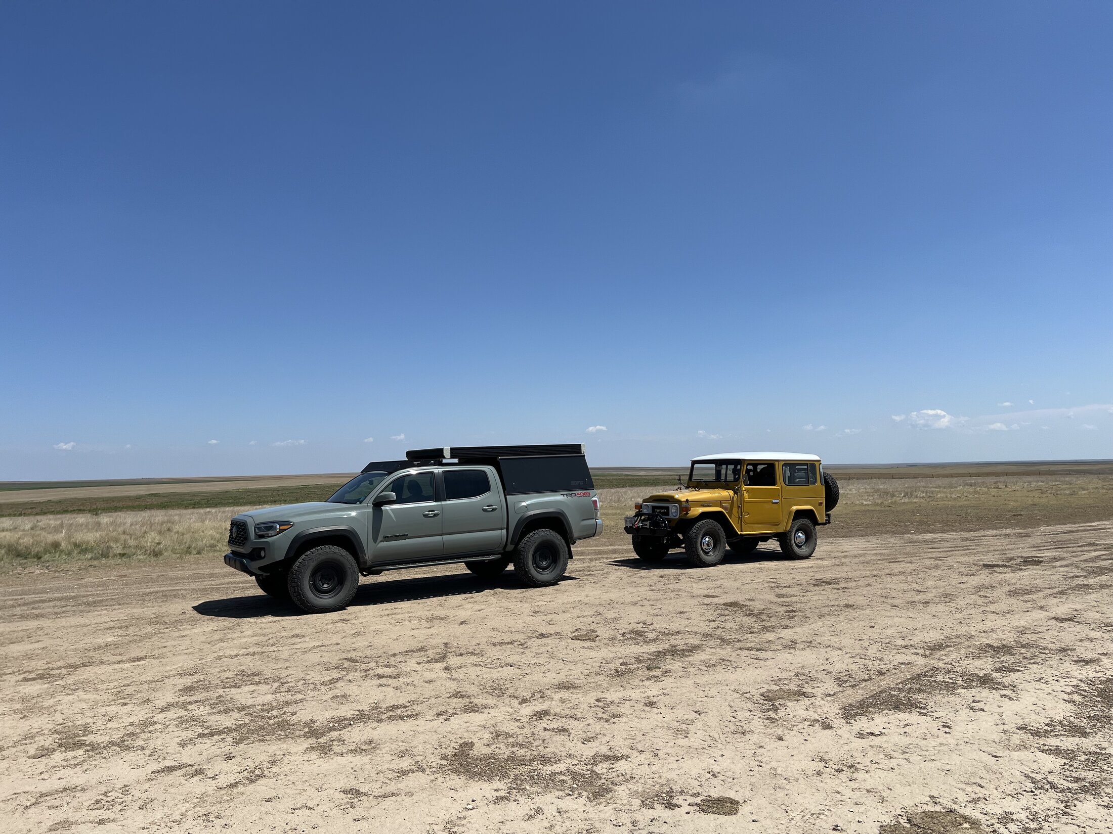

Left for SAS yesterday with @Plains Cruiser to make NE convoy - long day driving. Some pics. Connecting with TX convey this am. Decided to drive. Was hot yet YELLR did great.
Made it to CO

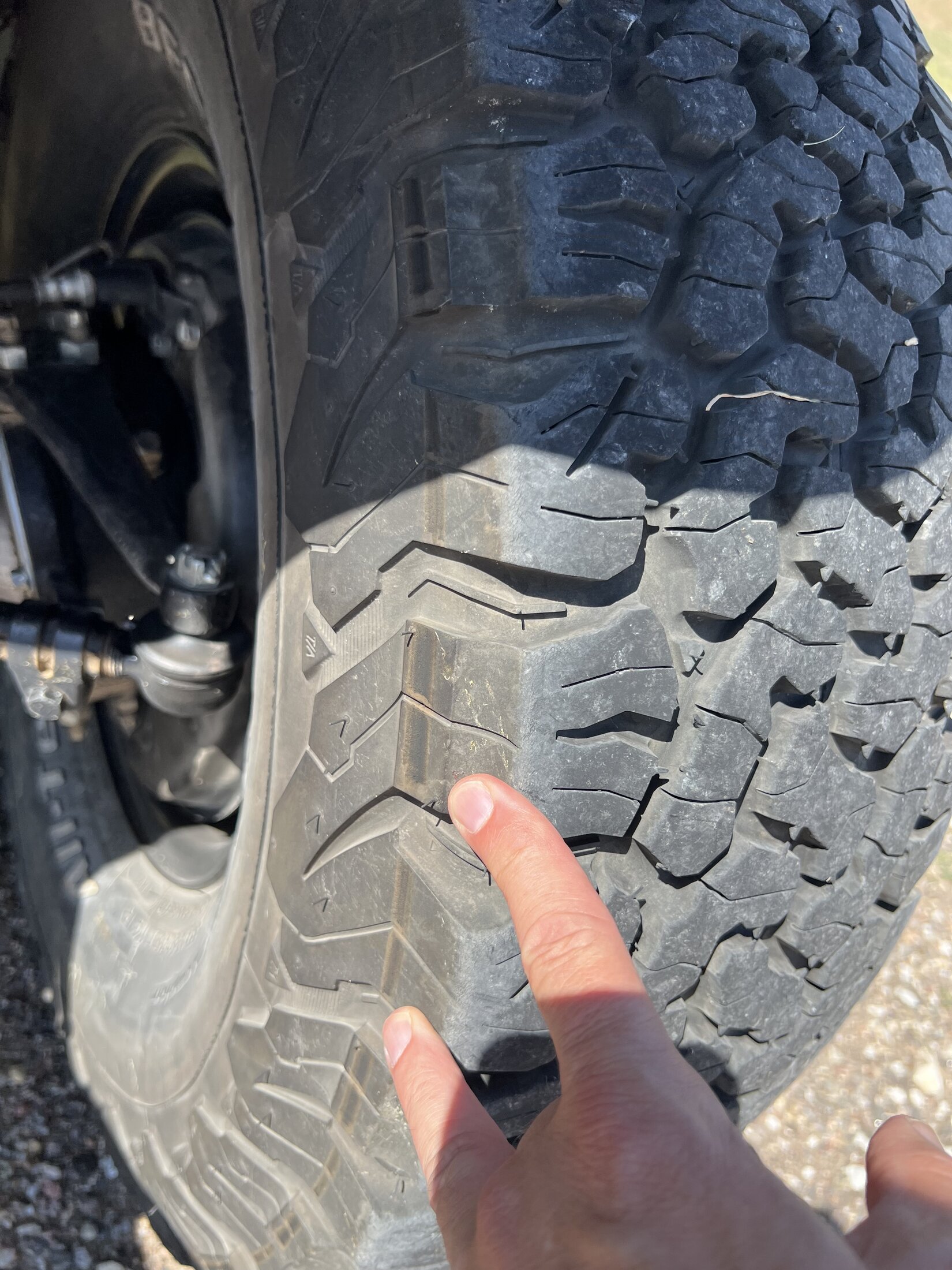

Found tire rub with the CO picture. A hard left makes it. Turns out clamp on rear of drag link needs to spins back more (bolts sticks out just enough to catch when fully cranked). I’m going to do that before we head out to catch Tx crowd.
