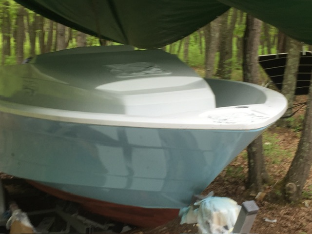

I would love to ride an electric bike for an extended ride to see how the days go. I respect your idea about a professional BUT, it’s not that hard to mask it off and paint. After a few tries, my brother bought a boat and said we can re-build it…here’s proof….
A real PITA..but the end result is still spectacular
Paid $3500 with a used beat up 150 Johnson… Marina told us it’s worth $27-29,000. And it has a new Suzuki 200
Trust me… I am no painter. I squeeze the trigger and paint comes out… this paint was special high endurance commercial stuff and not cheap with epoxy primer. It has been banging against the dock for 6 years and looks the same.

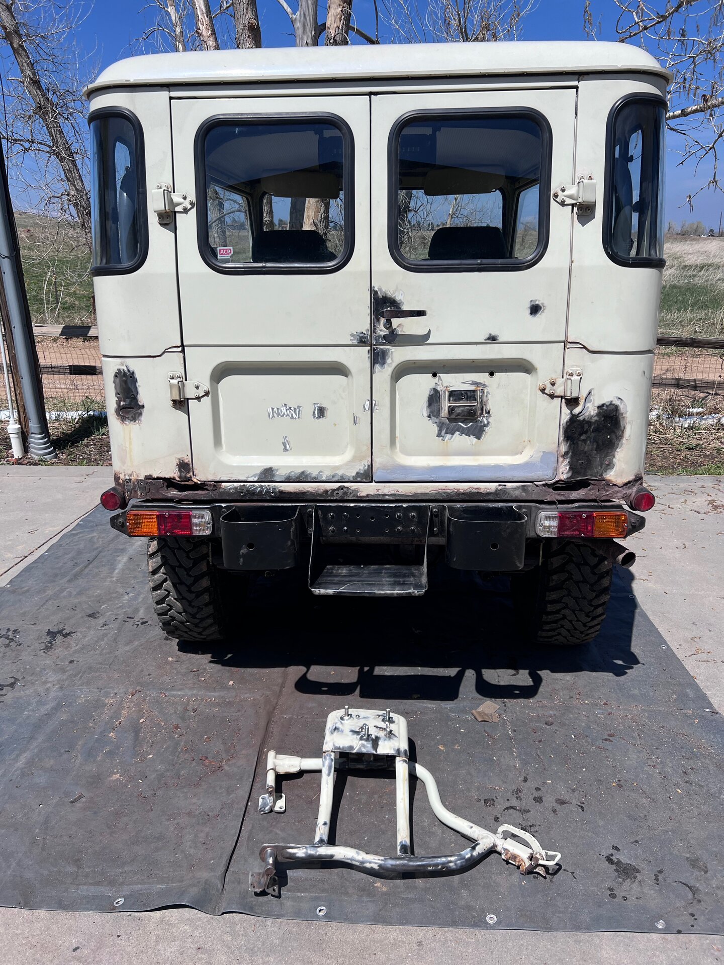

I decided to get after the rust on the rear quarter panels and the rear in general. As I should have expected, it's not something that I could fabricate a patch for myself. So I ordered a pair of rear quarter panel patches from Cruiser Corps (Quarter Panel Corner Patch - Driver / Left Side - FJ40 1979-1984 - https://cruisercorps.com/products/quarter-panel-corner-patch-driver-left-side-79-84?variant=12738054914114 and Quarter Panel Corner Patch - Passenger / Right Side - FJ40 1979-1984 - https://cruisercorps.com/products/quarter-panel-corner-patch-passenger-right-side-79-84?variant=12738054979650).
I also signed up for local welding instruction course, cause boy am I going to need it!!!!
@BrownWolf check out the videos from Lone Wolf Works ( @zerotreedelta )He does a very inspiring repair on these doors. I have spent months enjoying his series. Another of my many favorites
