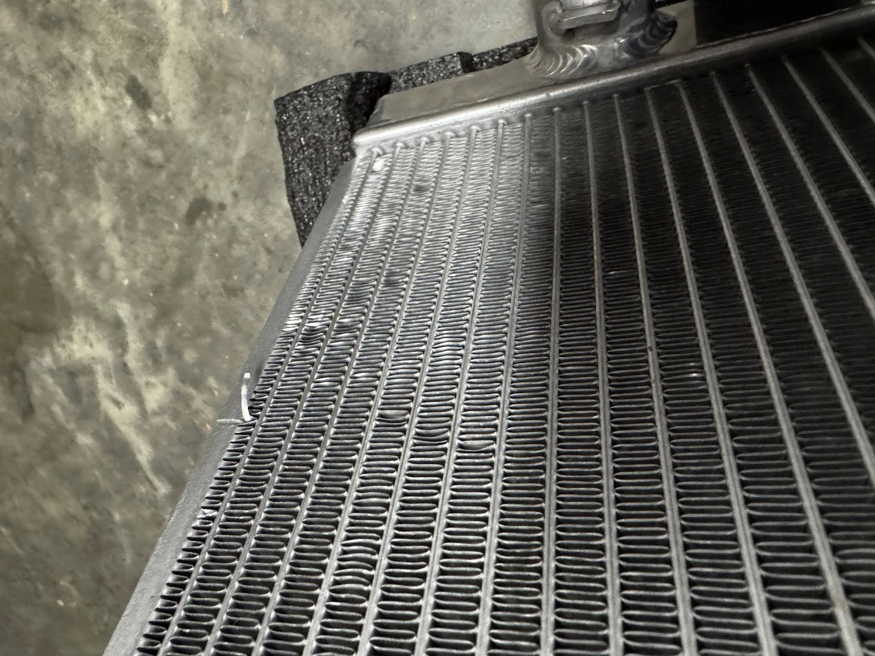

Mishimoto rad came in, opened the box a few days after it arrived since the new radiator hoses took a little longer than the radiator to arrive.
The radiator fins were about 10% damaged. Not too bad, could have bent them back but didn't expect this on a $500 premium product that has a lifetime warranty on it. It also had a tiny piece of aluminium sticking out of one of the fins.
It also looked like a few fins towards the top were slightly curved as if the person welding the tank on realised they have more space than they realised to work with. Almost like spacing out your handwriting a little towards the end of a line after starting off cramped. Looked 'fine' again but didn't want to risk it on something I want to be as reliable as possible. It also didn't have a serial number on the plate (plate was hidden on the bottom unlike in the pictures on the site where it is on the side of the rad). I ordered off of Amazon but double and triple checked if it was the official Mishimoto page and it was.
Decided to return it and just went down to the local Toyota dealer to order an OEM rad. Expensive but worth the peace of mind I figure.

Posting a few pictures just to show everyone what I got with the Mishimoto MMRAD-LCR-99
Those non-aluminum Mishimoto radiators are just the same junk that all the aftermarkets pump out. And the aluminum ones are just more rando Chinese parts.

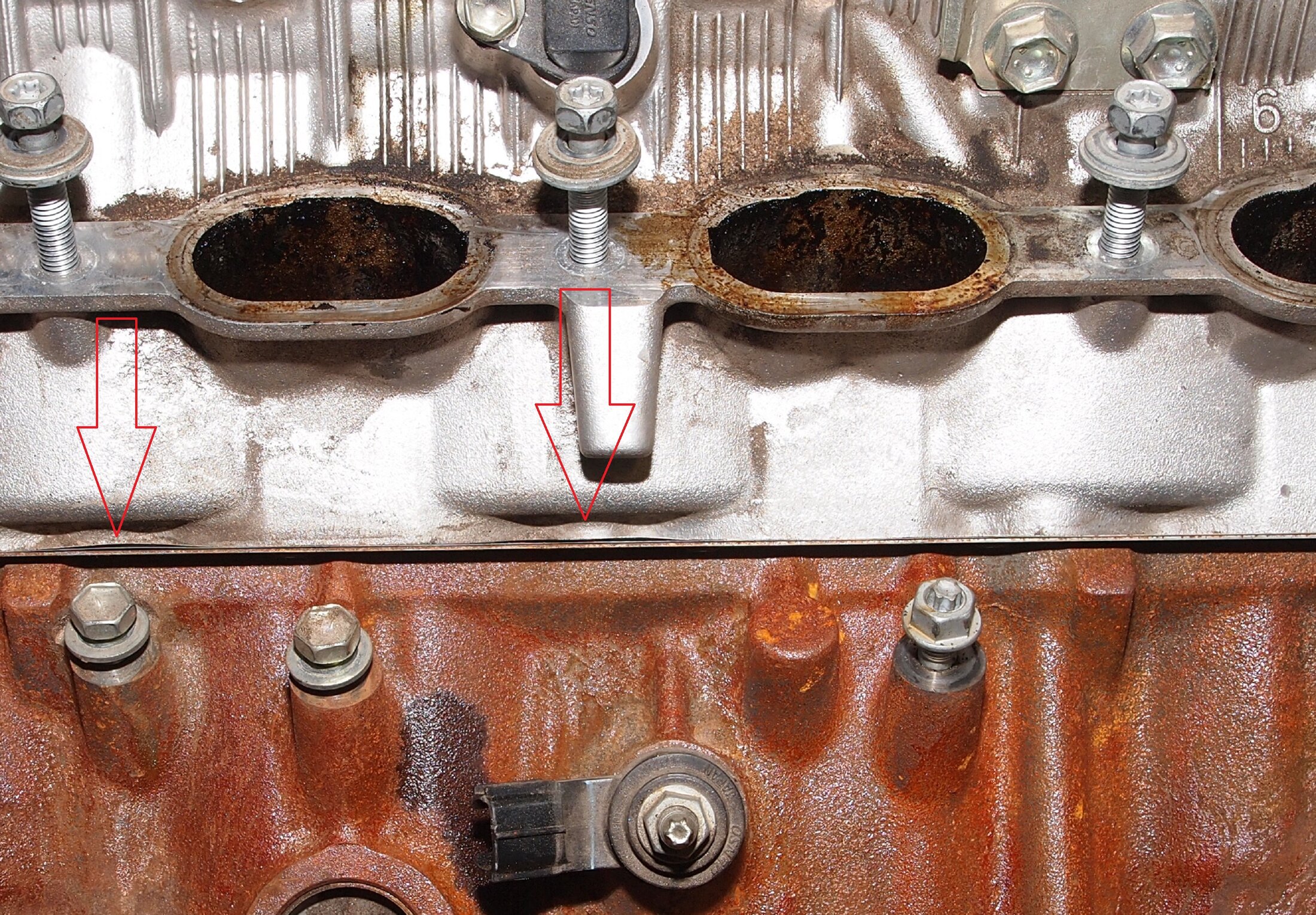

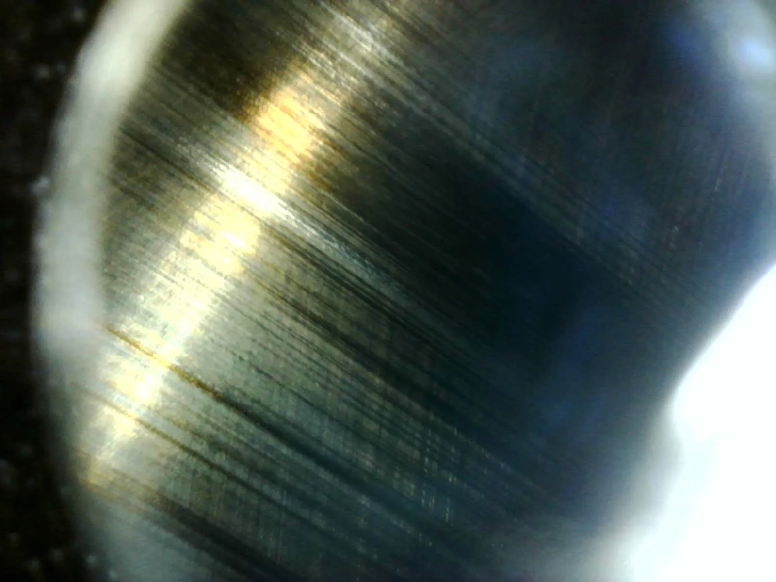

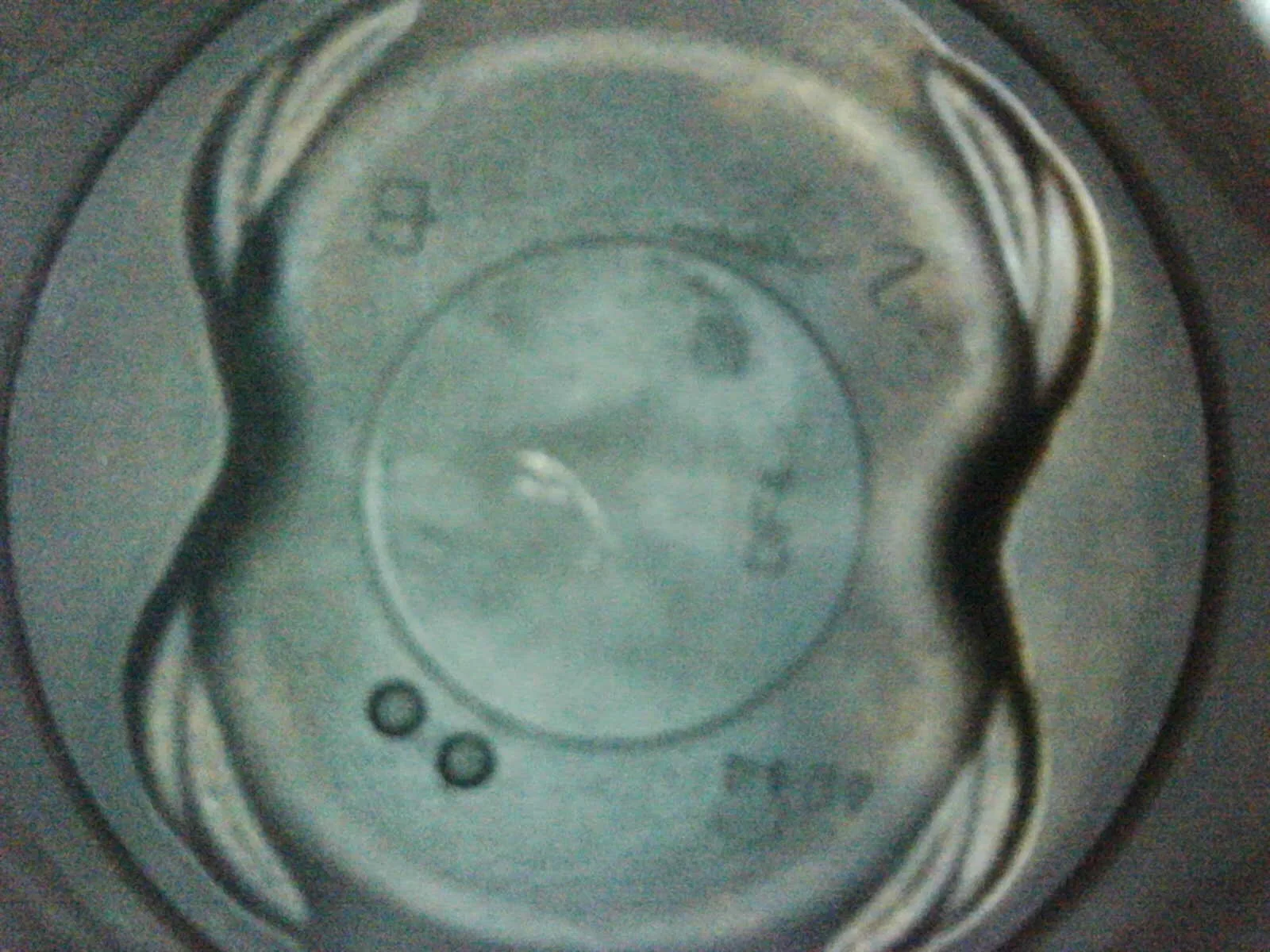

I wouldn't rely solely on the block tester liquid color. I'd get a compression test done and/or a leak down test before condemning the head gasket.
You could also pull the spark plugs out and get a borescope to look into each cylinder to look for a piston(s) that is steamed clean and shiny looking compared to the engine's other pistons.
If it really is confirmed as a blown head gasket some choose to do an engine swap
I second what @rexington14 stated, I would get a leak down test and compression test at a reputable shop.
You could always reach out to Trollhole Cruisers (511 Palmetto Dr #7, Simpsonville, SC 29681), they are about 80-90 mins south of you. He has a very reputable Cruiser shop. Trollhole's Cruisers - https://forum.ih8mud.com/forums/trollholes-cruisers.239/
Here is a list of Cruiser mechanics - CRUISER MECHANICS - Listed by State - https://forum.ih8mud.com/threads/cruiser-mechanics-listed-by-state.349535/
I third, further testing. ^^^^
Compression and borescope. By pulling each spark plug and inspecting them, you can usually see signs on them of which cylinder has the leak.

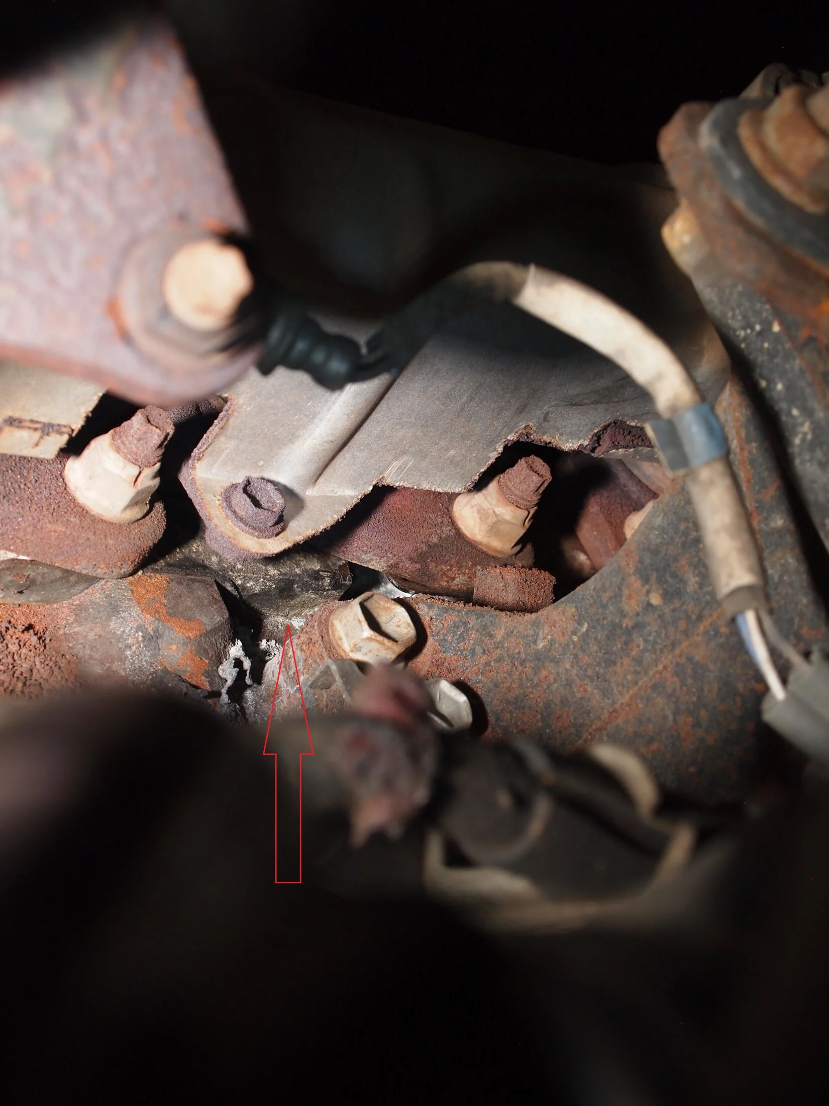

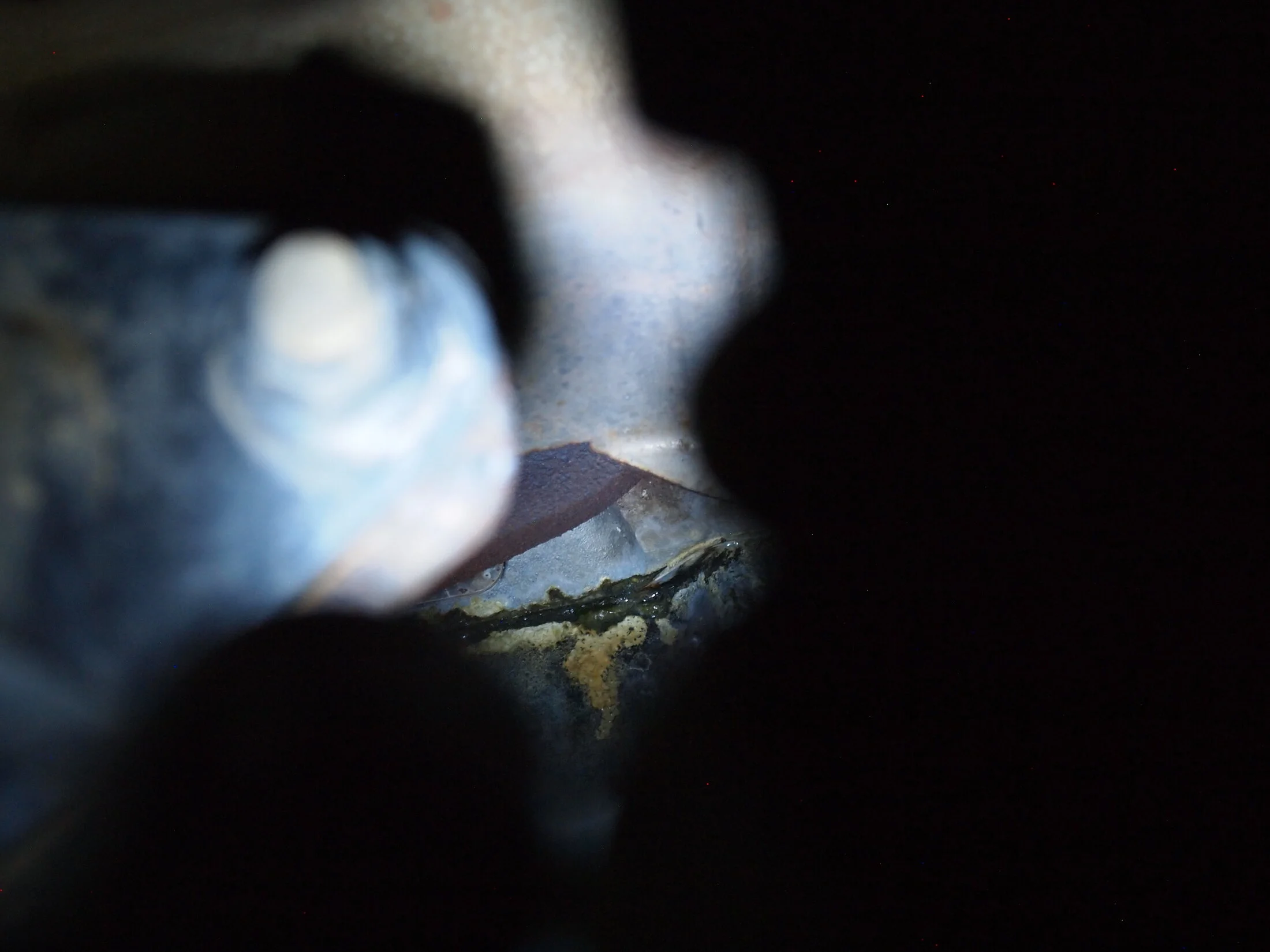

If head gasket leaking, it usually from overheating. Signs of this may be swollen water hoses and discoloration of them and block and/or other parts. Typically I find a signs of leak externally at/around head gasket also. Very often these external leaks, clue of a warped head
Often times the coolant reservoir hose or cap, has a clog. Or curd found in res.
What I'd be looking for, is condition of cylinder(s). If one found bad (excessive scoring), I replace engine.
If cylinders good and doing head gasket job. Head bolts need to be within spec. Even if they are in spec, consider replacing them, if only replacing one banks head gasket. They're stretch to torque bolts. The second time used, they tend to hold tighter (stretch less). So if only one head done, it tends to have higher compression, with reused head bolts. This can result in slight rough idle and can result in variation on fuel trim from bank to bank.
Signs of Warp head and high heat (discoloration of block).
