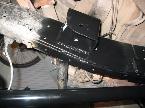

Okay so, here is what the upper link mount looks like. If it weren't raining outside at the moment I would go snap a shot right now.
1) It looks great and I like the cut & turn. Good attention to detail.
2) It's essentially impossible for a 3-link to behave the same as it did with radius arms. I'm sure it drives great, acceptable, whatever - but don't delude others into thinking a 3-link will feel the same as the radius arms. Others (including myself) with linked setups on here will tell you it's a big difference. Not a bad one, mind you, but not transparent.

I honestly got worried when I saw you were reusing the brackets and mounts. Would be nice to see how you sorted out the steering. Did you move the axle forward?
How do you access the nut for the upper mount on the frame?

Now the upper link mount at the frame is nasty, the bolt goes in behind the cats through the frame and the nut is on the outside of the mount. Part of the reason I made new mounts to install. I reassembled the exhaust system with stainless hardware though, so it's not hard to get it out if I need to at the moment. But my new upper mount, aside from being angled is a captive nut design.
As far as steering goes, I sleeved the tie rod and drag links and that's it. Plenty of clearance for the links since I cut and turned the entire housing and knuckles.
