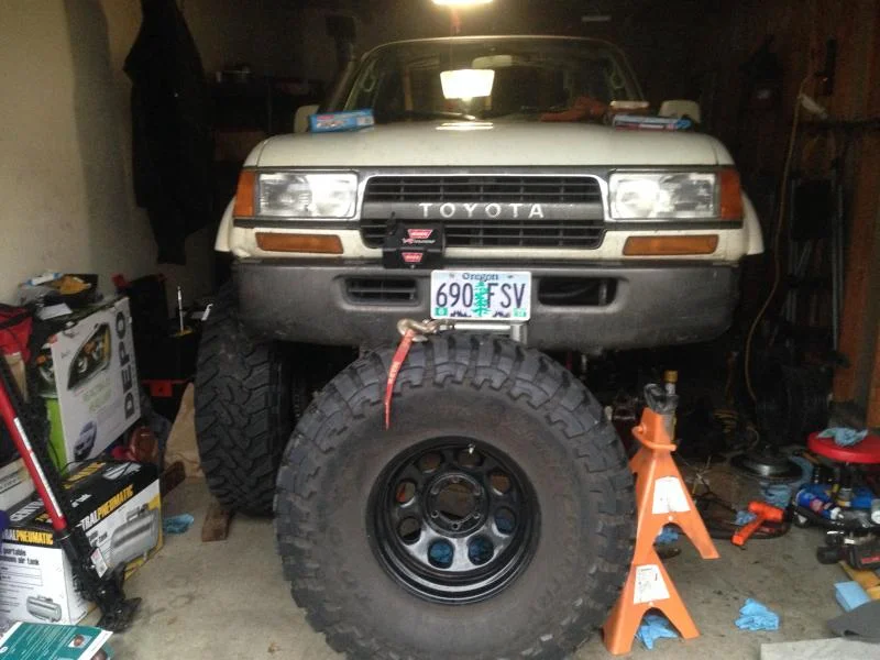

SOOOOO....I got around to removing the ugly A** upper link mount from the frame. I put the new angled mount in place and tack the 4 corners and realize, OH h Sh** I really overthought the construction of my bracket and somewhere in the midst of fabricating it I F-ed up and doubled the outward angle. So now I have to build another one, Im getting to be a pro at making useless bracketry lol! I will post up pic's sometime soon showing where the upper link bracket on the frame is located.

Sorry I didn't see this question before, honestly I didn't look before I cut the bracket off today, but the hole where my bolt came through the frame is still there, I will hopefully get a measure on it tomorrow before I have to go to school. Oh yeah, and in case anyone was wondering, College at 30... blows.
