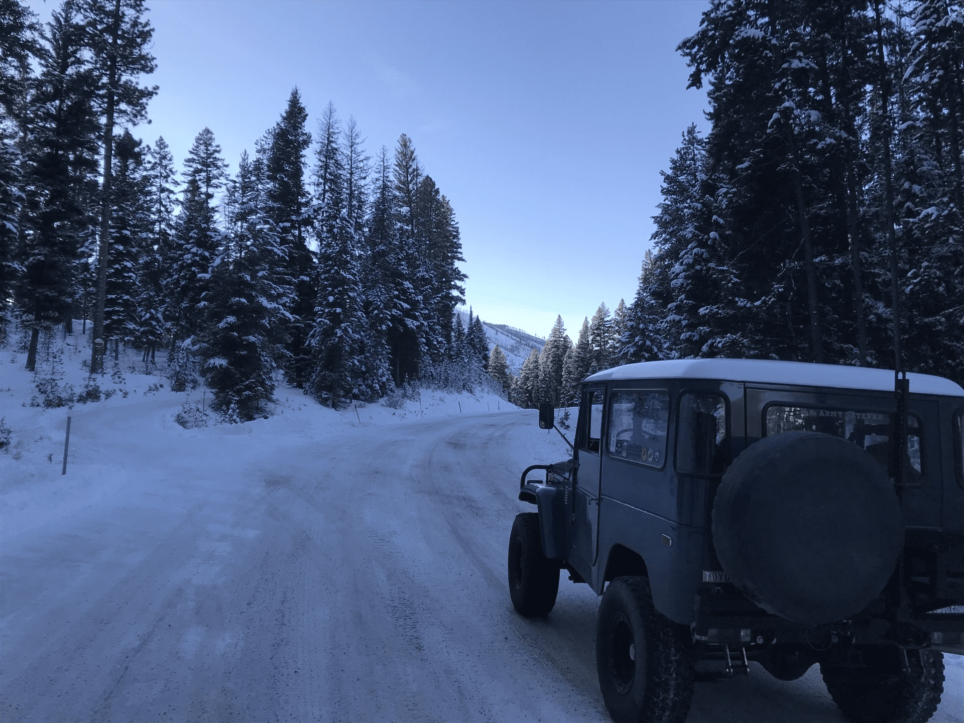

J/K, I have mine mounted on the swing out beer cooler carrier on the rear of my rig.
1921055
That's the best shot of mine that I can find right now.
