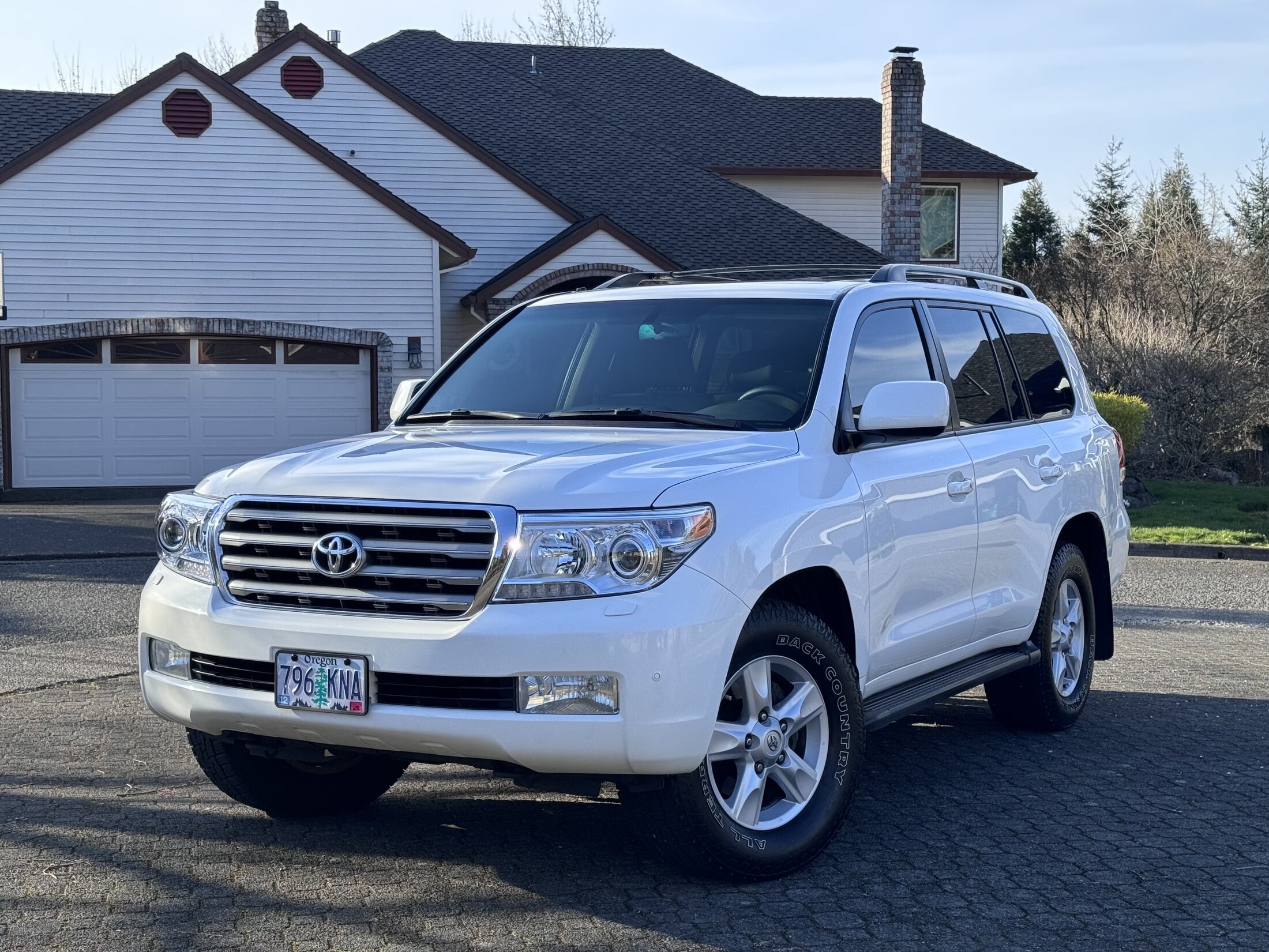

Detailed the car this past weekend after some off road adventuring up the Oregon coast and some OHV trails. The rig is mechanically and cosmetically dialed in. I’ll probably wait to eat through the tires that are there before doing a mild lift and switching out tires and wheels.

Looking sharp! Love it!
