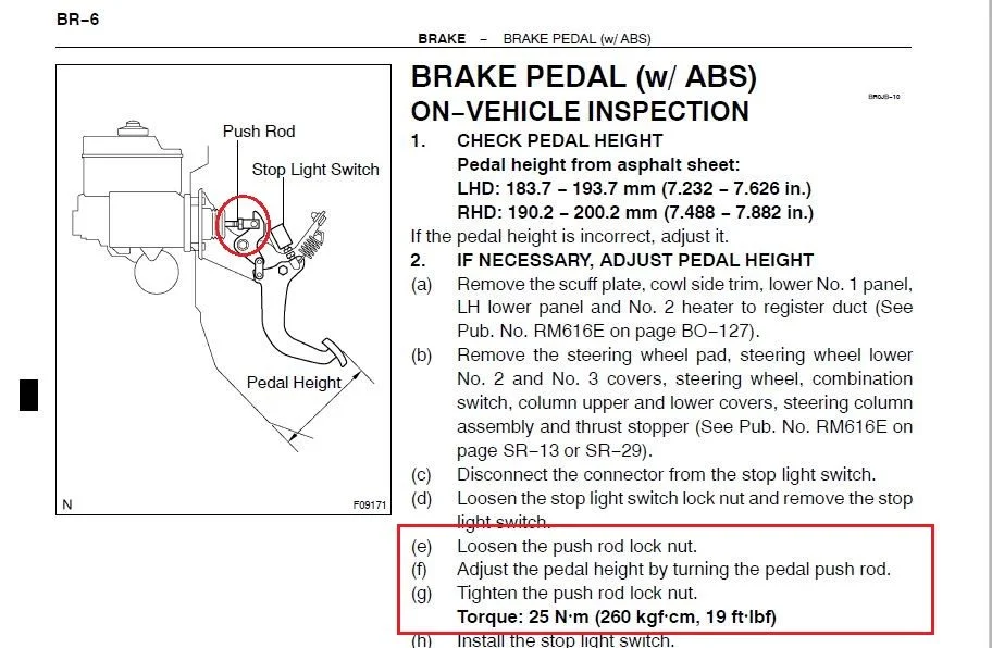

All,
I've rebuilt my Brake master cylinder twice in the last 6 months to still have a spongy pedal. I thought I botched the first job, so attempted it again. After having a spongy pedal again on the 2nd time I'm thinking my master cylinder was fine and I instead should have done the following. This is an adjustment that I found in the FSM and wanted to share with everyone. This is a 10 minute job that requires a 14 mm open ended wrench, needle nose pliers and no dis-assembly of anything. This is a step you should take before attempting a rebuild and it is also a step that needs to be performed if you do rebuild your master cylinder.
Below is a diagram that IDs the brake push rod location. This is where the brake master cylinder connects to the brake pedal. I only performed steps (e) - (g) in the service manual shown in the pic. You can reach the push rod by laying on your back on the drivers side and reaching up past the gas pedal and over the steering shaft.

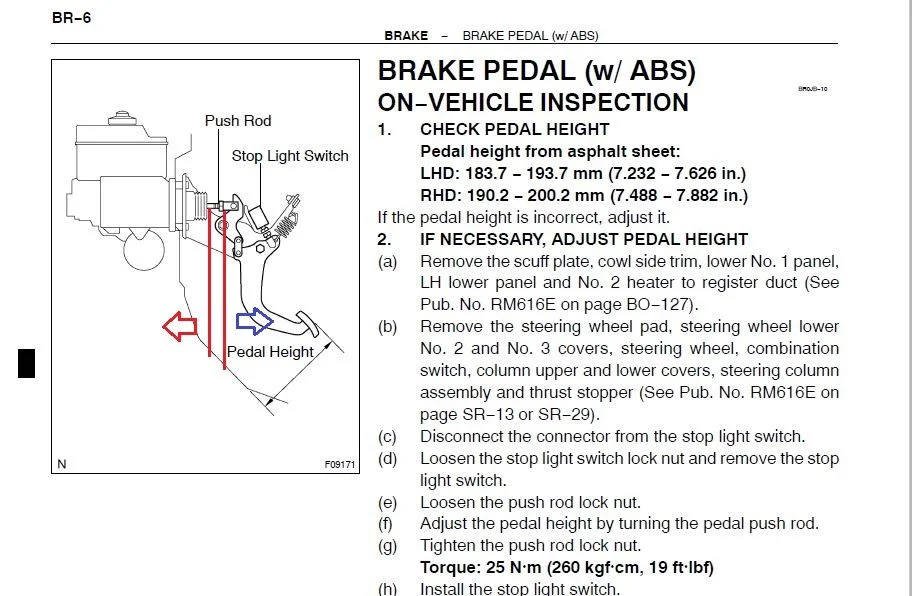

This image shows the measurement of the adjustment you would be making. To adjust this measurement, first, loosen the 14 mm push rod lock nut. Then use the needle nose pliers to turn the pedal push rod (I would describe this as a screw). At the base of the push rod, there is a geared surface that is perfect for grabbing with the needle nose pliers. You may need to push back the rubber boot to see this geared surface.
Adjusting in the red arrow direction will give you a firmer brake pedal. Be careful not to adjust this too much or you will have too much pressure which will cause your brakes to always be applied (ask me how I know). Adjusting the push rod in the blue direction will give you a softer (spongy) pedal.
*Note: The only place that I could see the master cylinder leaking would be in the foot well on the drivers side. If you don't have brake fluid leaking onto the floor in the foot well or if you remove the rubber boot and don't see any brake fluid, then it is most likely not your master cylinder. You likely just need to make this adjustment.
Thought I had adjusted properly because I measured the old masters pushrod length. Well I had to double pump with the new one and this solved the double pump. I’m slightly shorter than spec but I confirmed the shortest length within spec was still applying the brakes ever so slightly.
