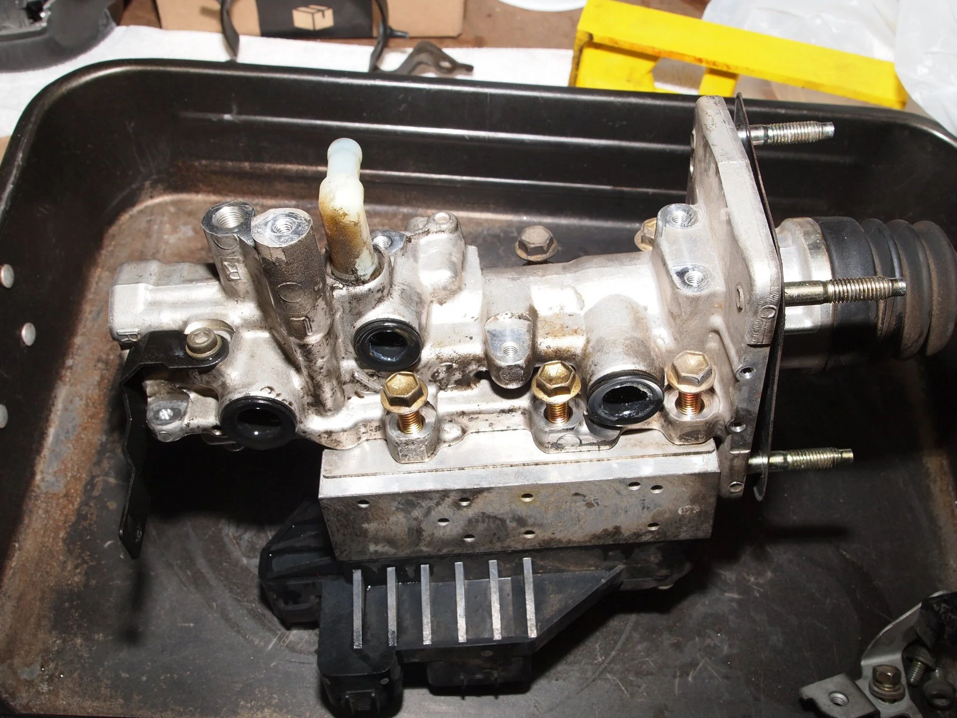

I think (I'll be watching closer for this to make sure) one of the main difference we can see in 00-07 the addition of this pressure sensor. Perhaps someone with 98-99 can confirm
I'll add, if you hear the booster pump running every few minutes with IG (key) on. This could indicate a pressure loss. This is something I'm going to pay closer attention too. As it may be normal to hear this occasionally, but to often may indicate a leak or air in system. So testing booster/accumulator would be a good idea in this event, by evacuating accumulator (key off pump brake pedal 40 times) then time how long booster runs once IG turned on. Spec is 30 to 40 seconds.

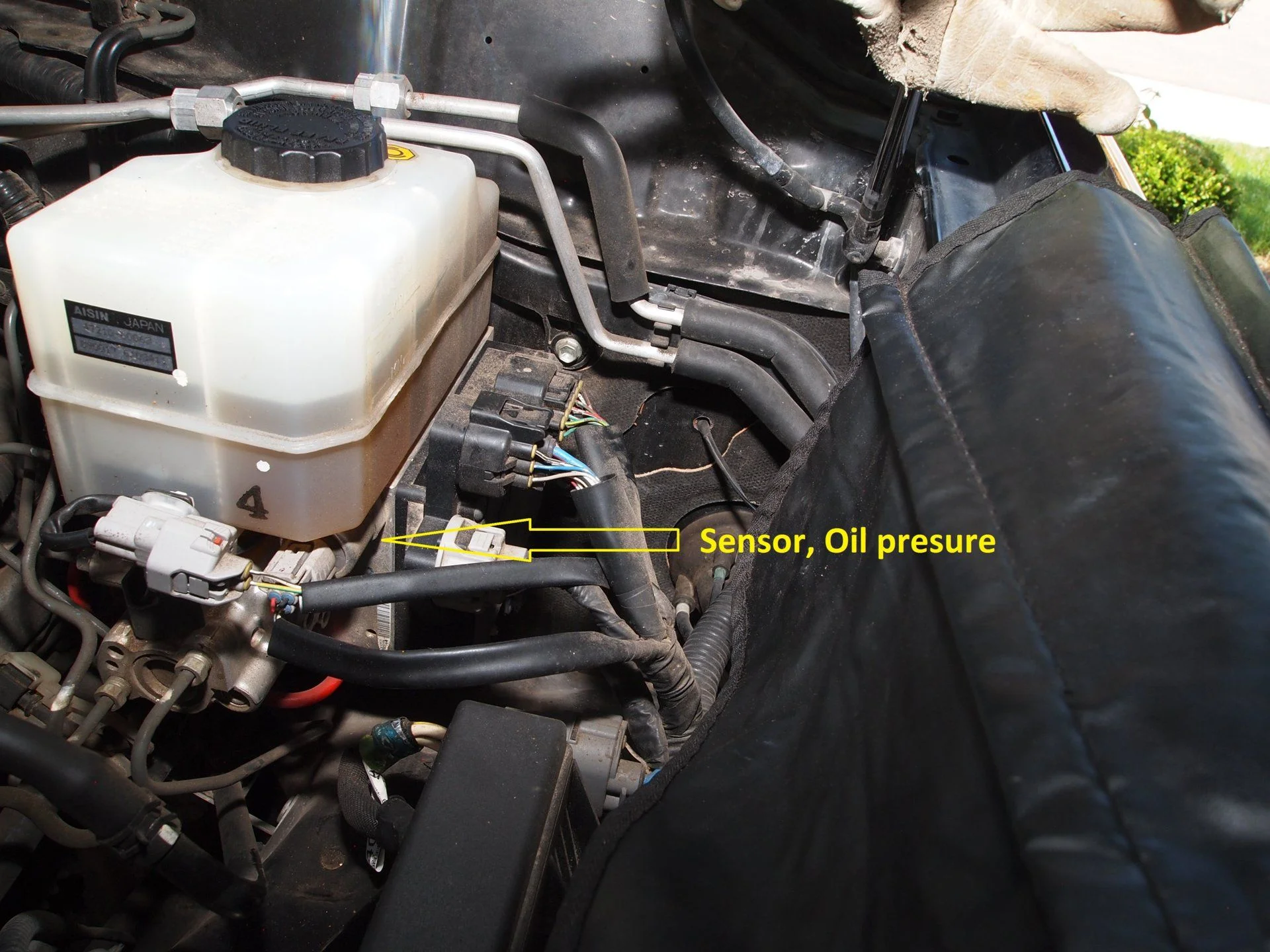

@2001LC
The grey connector right behind and above the yellow arrow are the circuits I pm’ed you about. I believe theres a pressure switch built inside if the unit. Pictures between the plastic housing and the aluminum block would be great.

@2001LC
Look in the link I provided, it may be there. But that is off a 98.

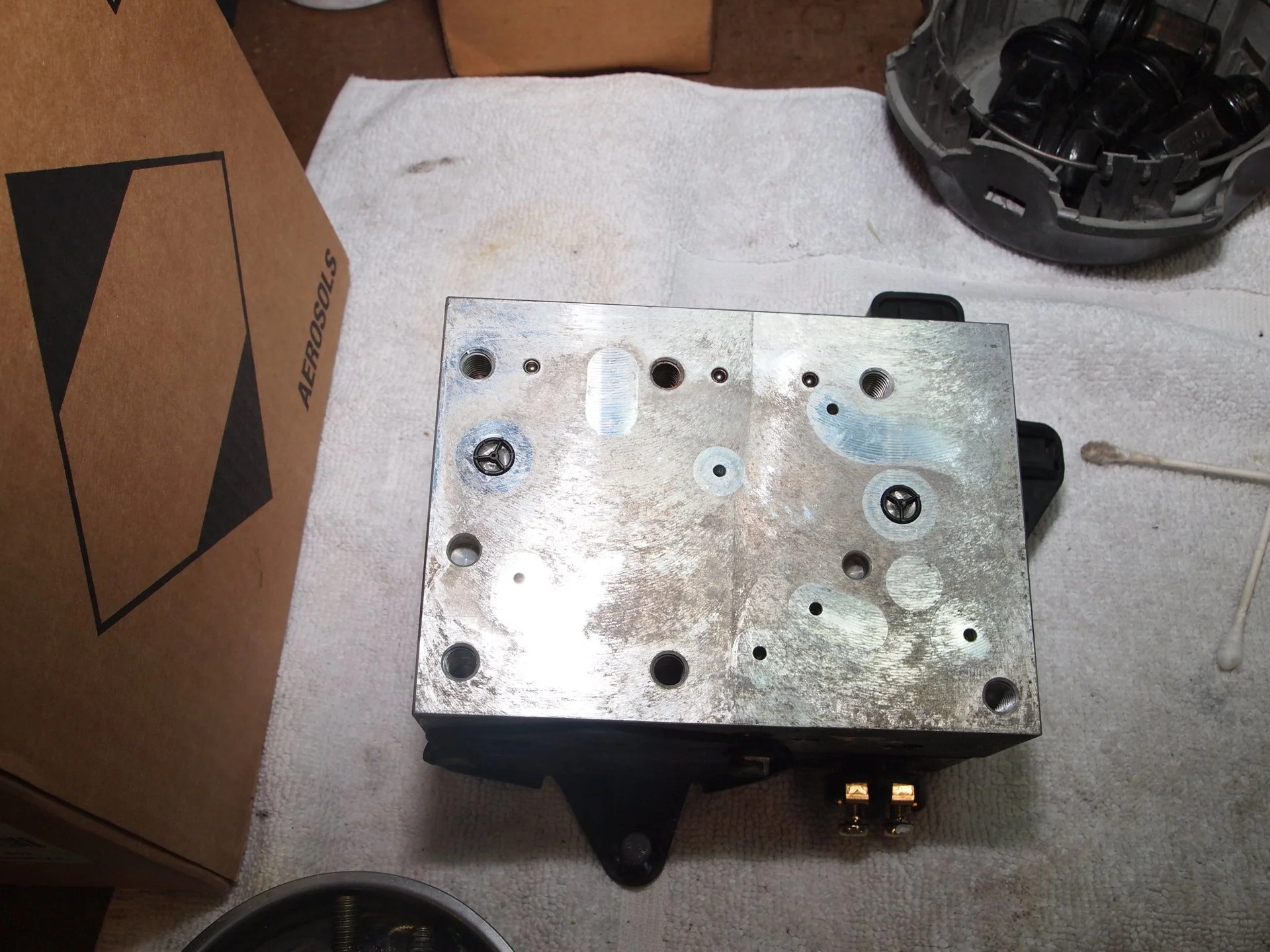

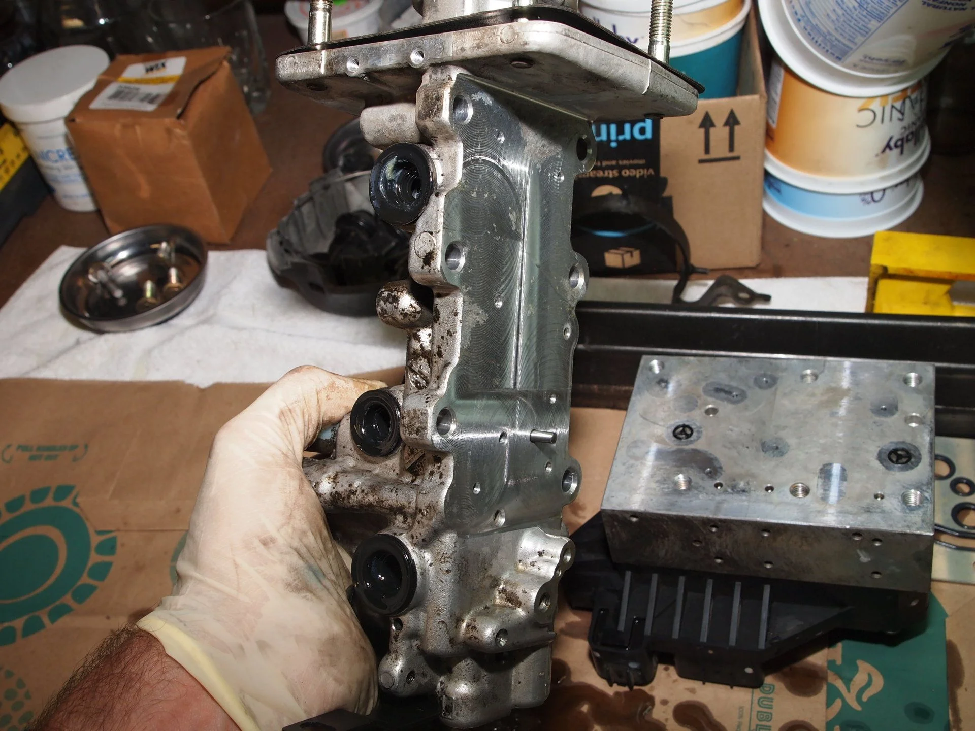

@2001LC , I borrowed your photo below. I was wondering what was on the other side of the plastic housing which the electronics were in but I realized it's probably just ports.
Do you still have this one available for some testing? Or anyone else with a faulty ABS unit that is willing to separate the plastic portion and send it to me for some testing? I'll pay for shipping both ways. To be clear, I just need the plastic portion with the electronics or the "brain" of the ABS unit.
002-jpg.1731756
I was interested in following the leads (two screws at bottom) for the booster pump power, back up into plastic. I was looking for possible leak from inside plastic to leads into bottom of wire boot. What I found was the plastic is molded around leads and to coils protruding from aluminium block. I smashed plastic to bits, to separate from aluminum block. My conclusion was it was near, if not totally impossible for a leak to occur at this point.

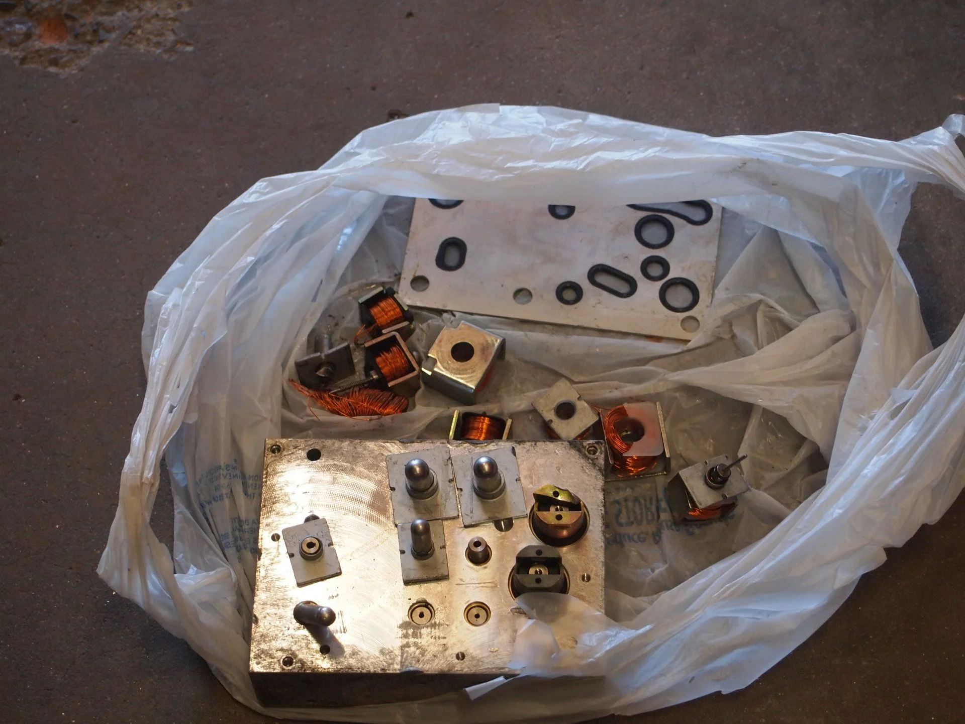

@2001LC Thanks again for the pictures. Now I need to get my hands on one so I can check out the pressure switches thats next to the solenoids.
I believe the high pressure switch is causing the squealing and squawking noise some of us hear on cold starts. My theory is that when the booster motor spins the pump, it doesn't get feedback from the high pressure switch to stop the motor/pump and typically happens when its cold out. The noise is from some sort of pressure relief valve thats built into the pump itself since the fluid can be seen dumping back into the master cylinder reservoir via the rubber feed hose.
For the members who experienced the squealing or squawking noise and kept the old unit after replacement, I would love to check it out. I only need the side with the molded plastic and can be removed by the 6 bolts.
