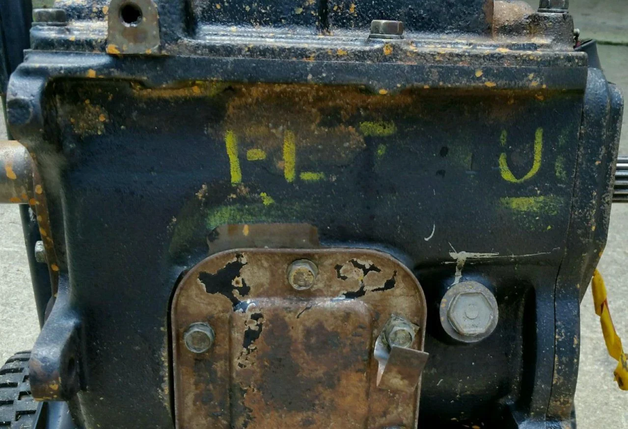

I had the same exact question in 2016. @JohnnyC posted this 1966 3sp
My 71 3sp has a factory PTO and a P in the code
@Jdc1’s early 4sp he posted

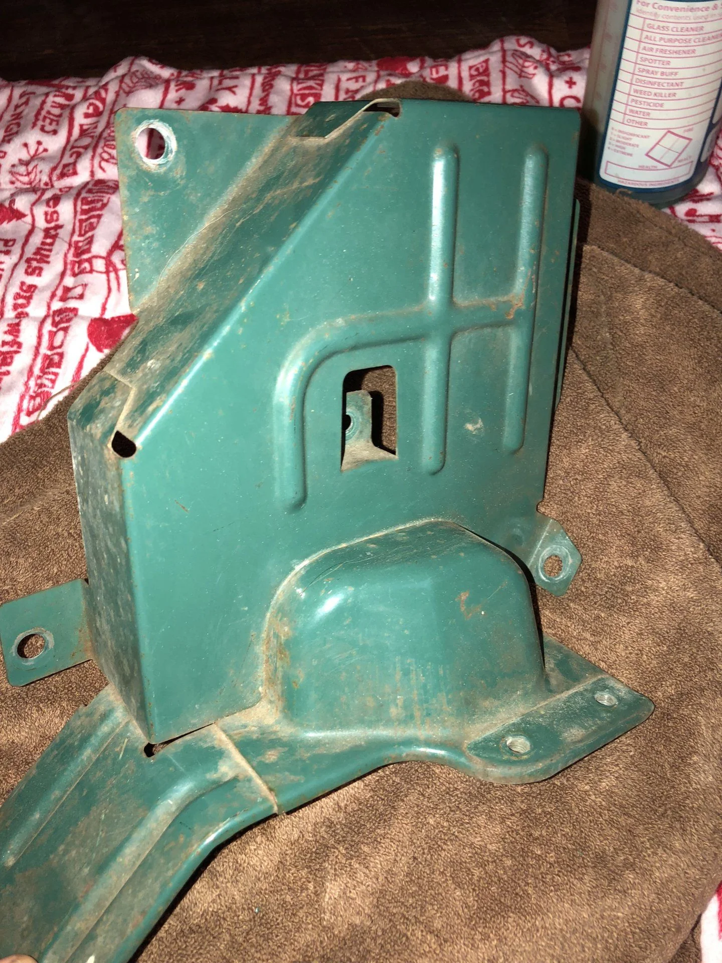

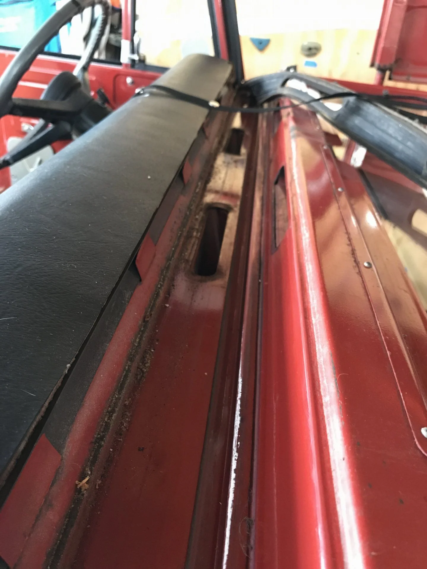

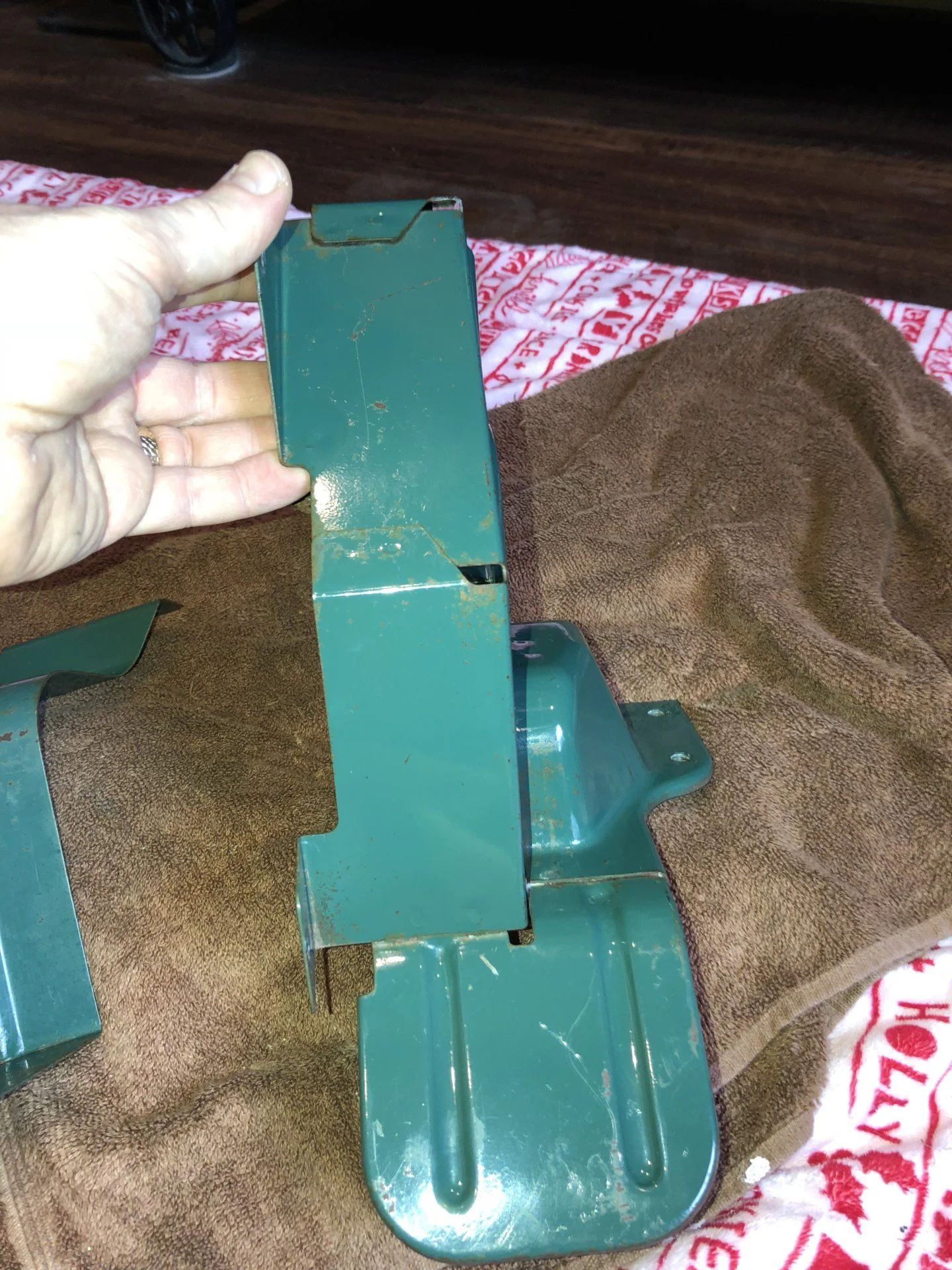

Heads up on the now exposed dash pad support frame. If it gets inadvertanly leaned on or grabbed too often, the spot welds will give out.

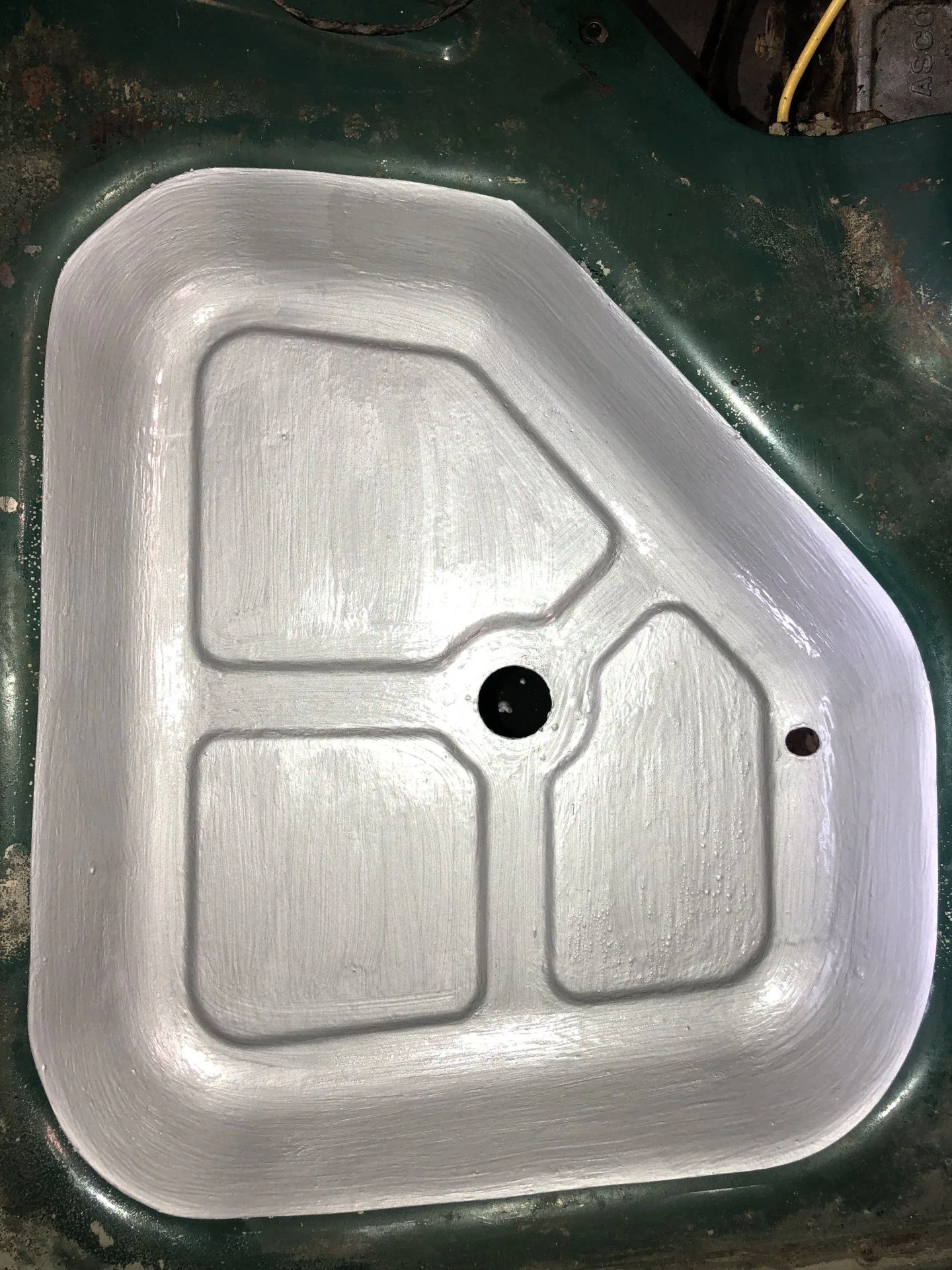

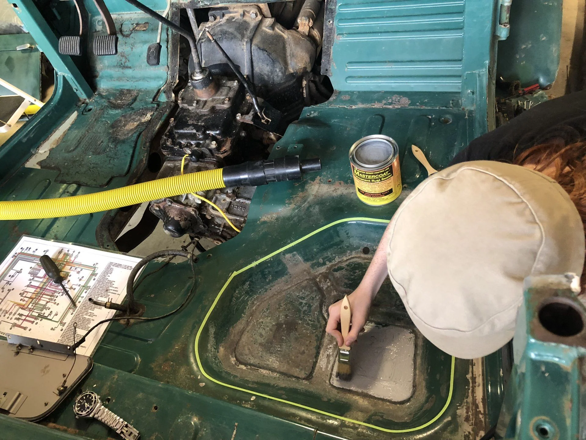

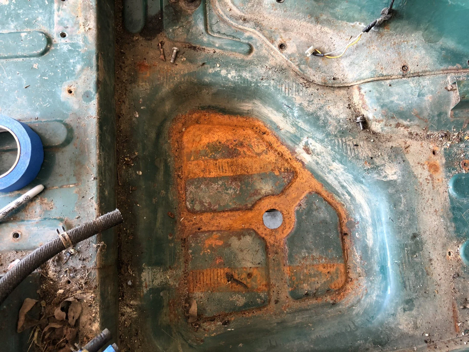

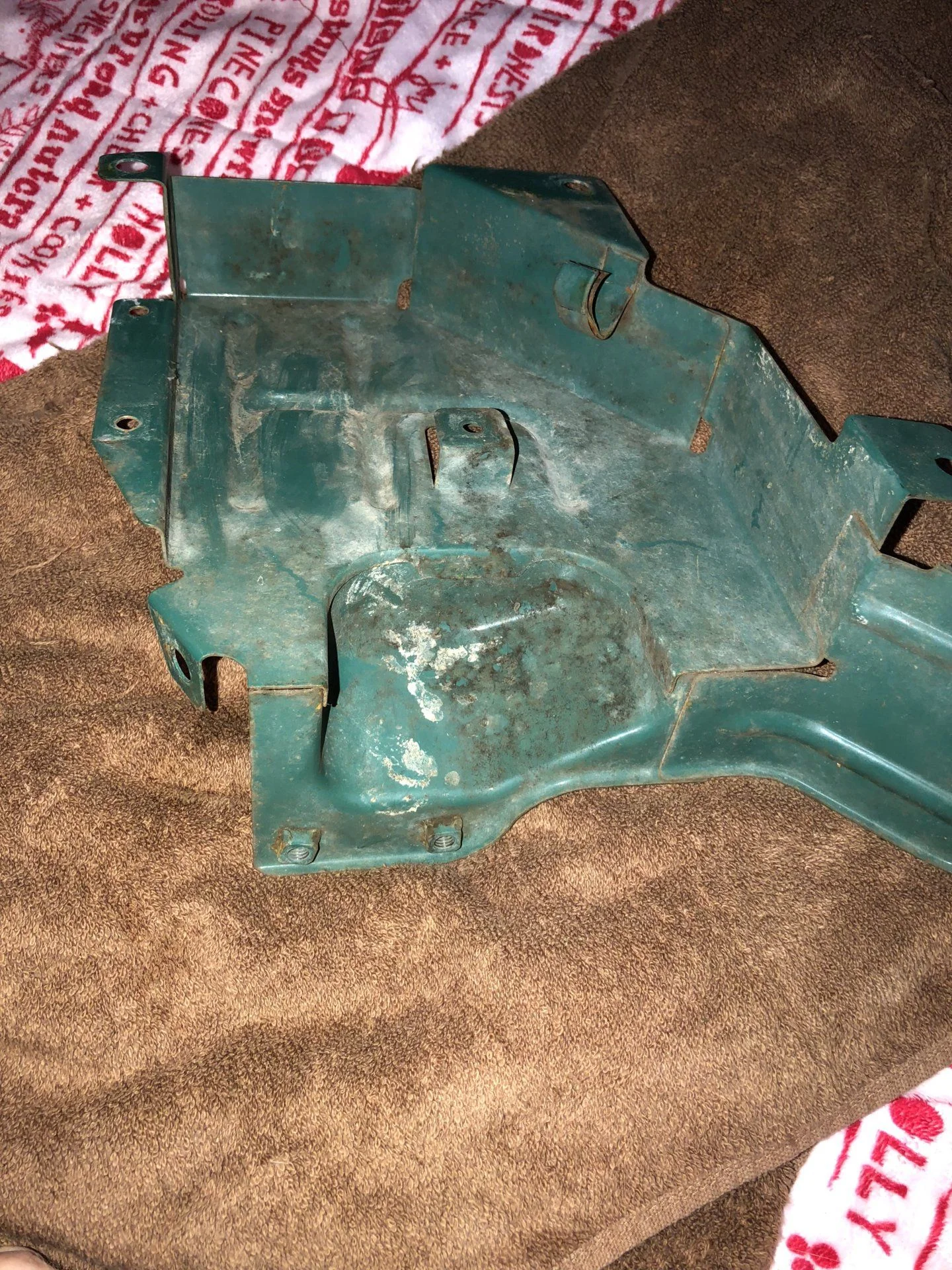

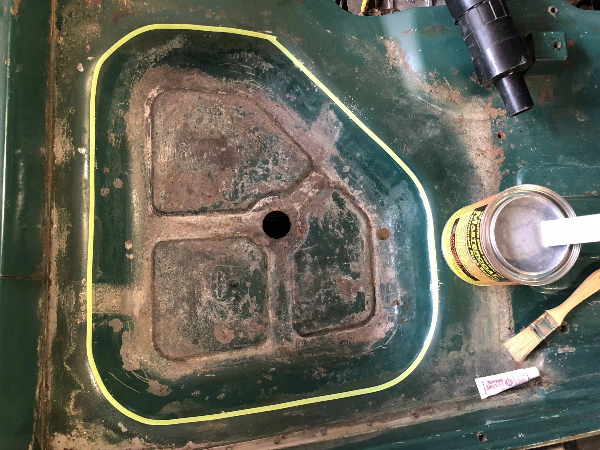

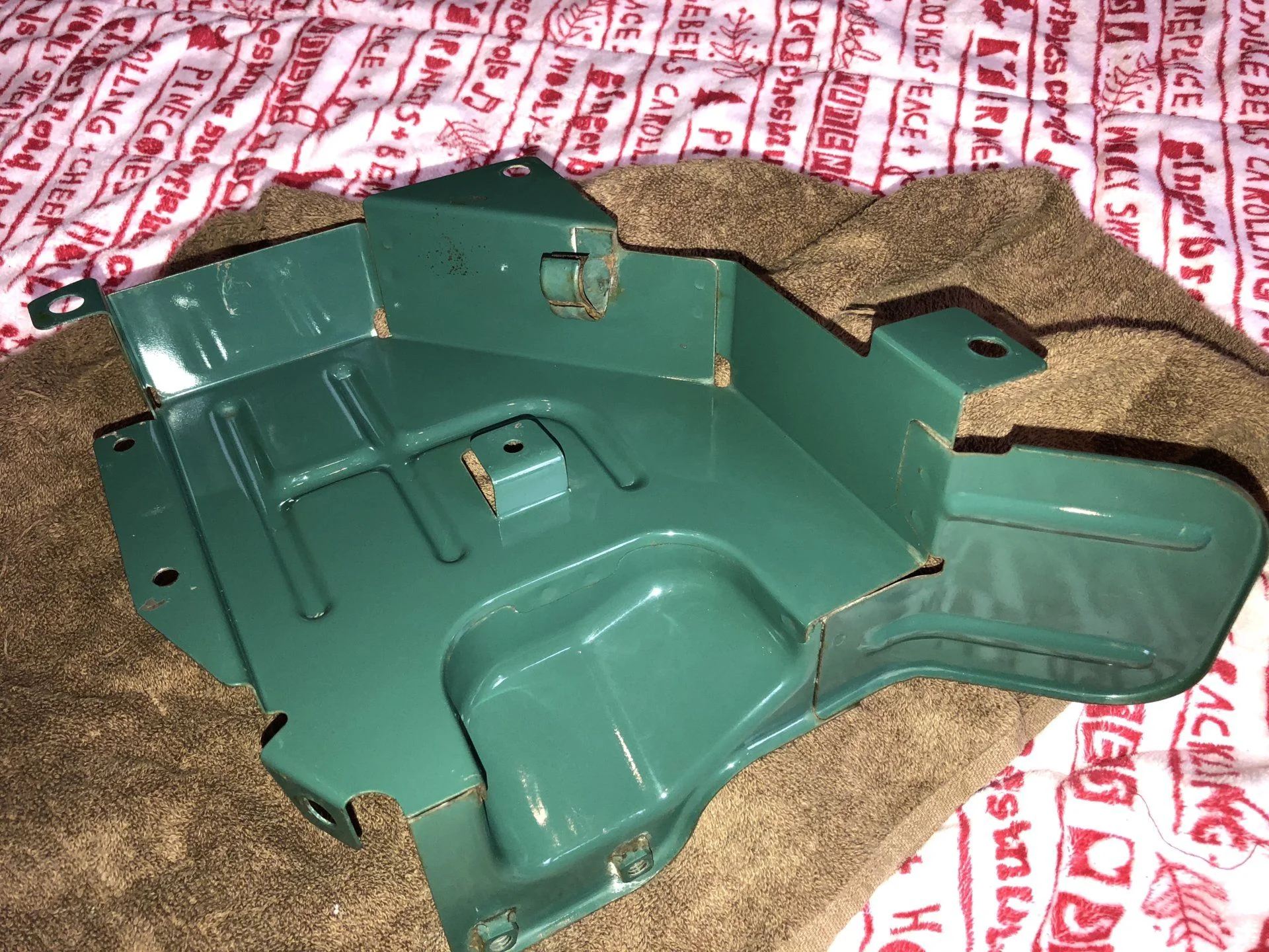

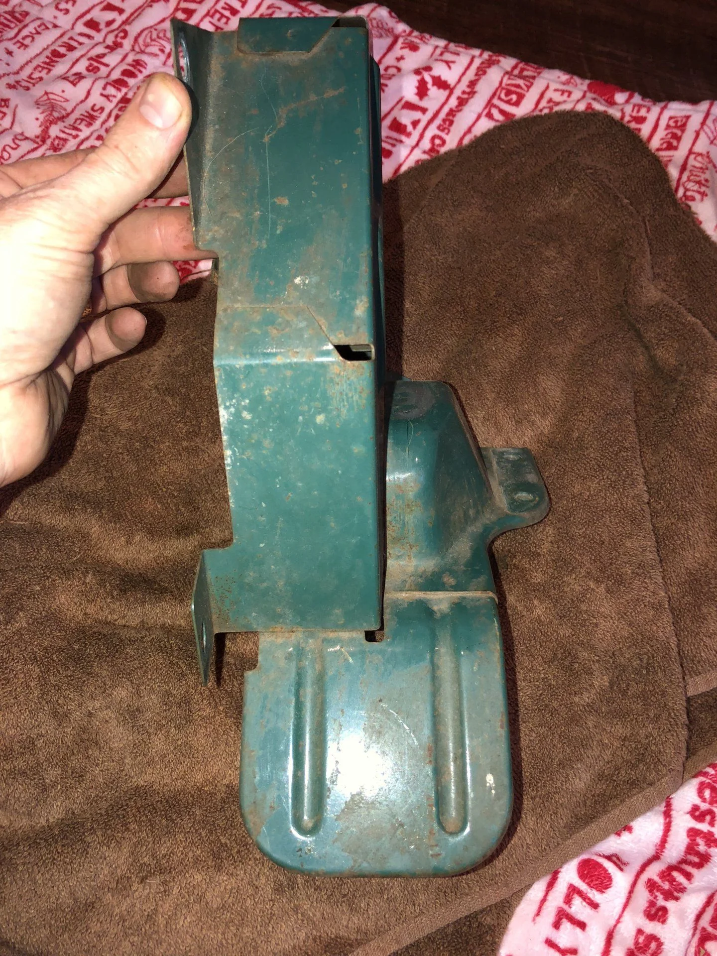

Been working to get the the gas tank back in, so then I can get the seats back in and start driving her again. When we pulled the gas tank out, saw quite a bit of surface rust.
Started with this
Got it to this with some CLR, elbow grease, and Ospho
Taped off, ready to paint. Yes, I have OCD and I like clean lines, hence the pinstripe tape.

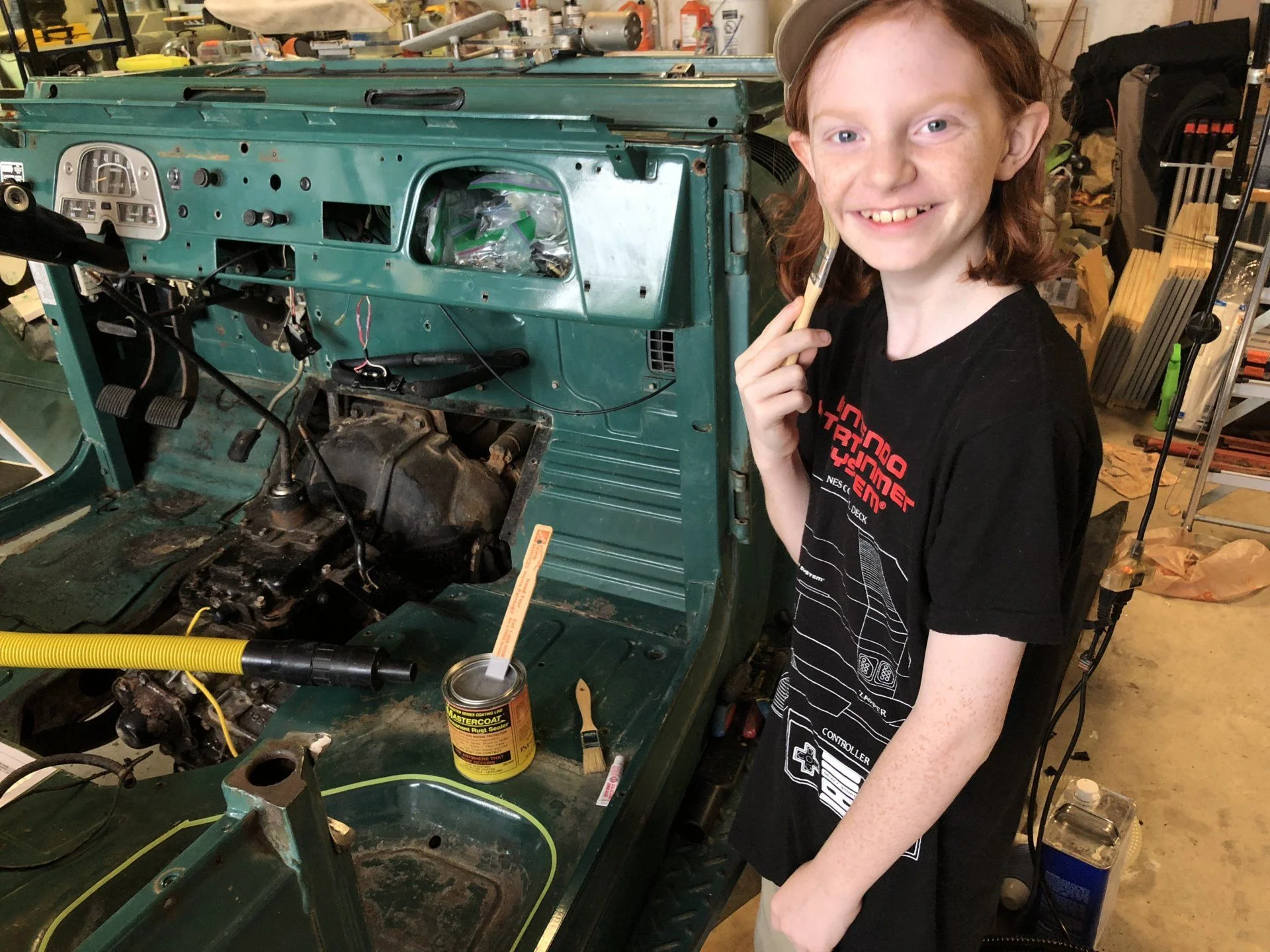

Have this awesome helper. I swear he has the most contagious smile and laugh. He makes this project super fun.
As I watched him paint, he was so meticulous, painting in each raised area before going to the next.

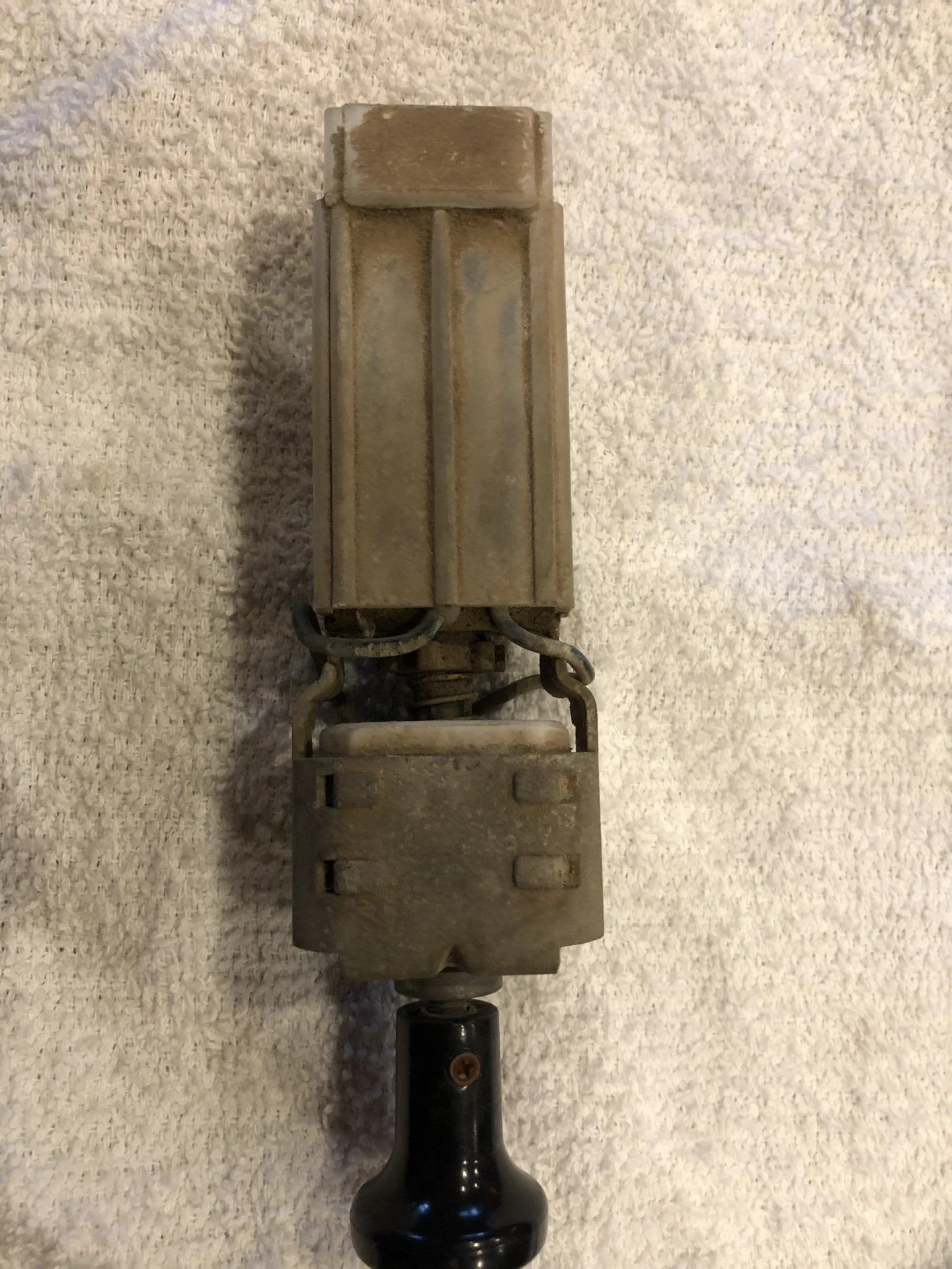

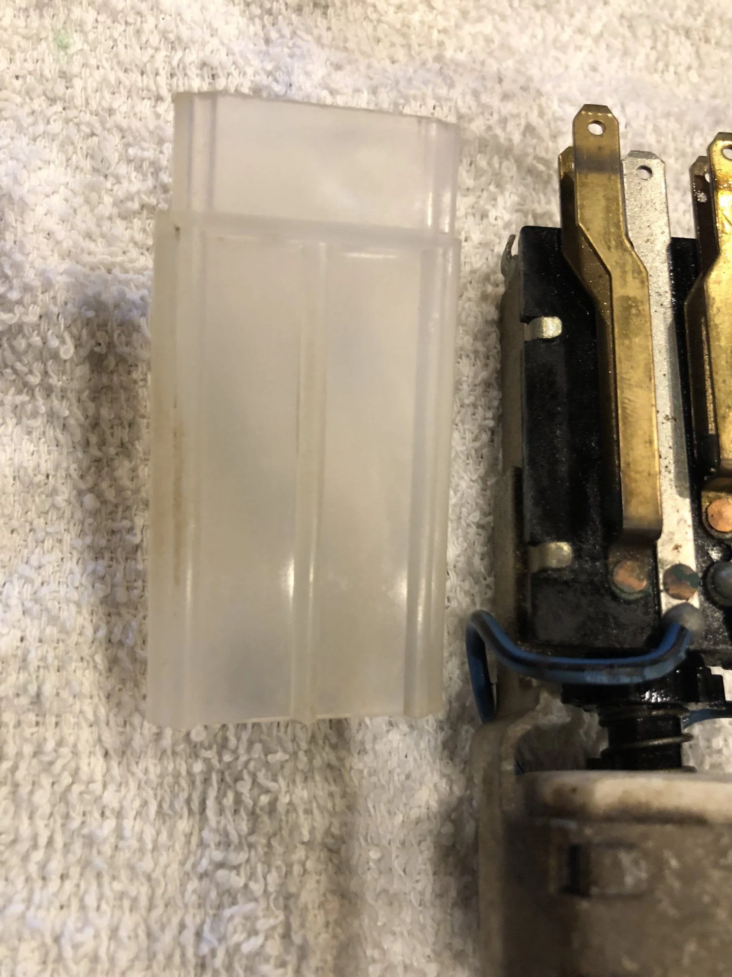

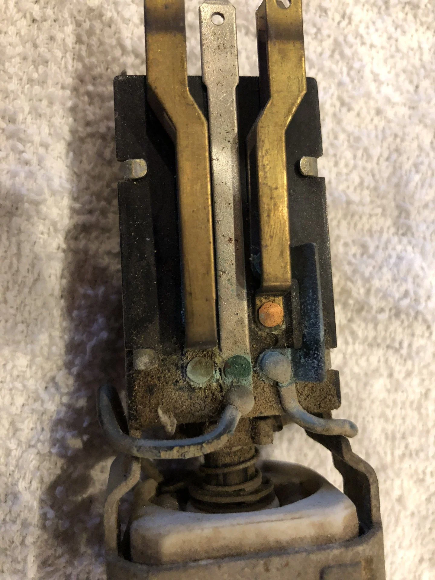

We have also been working on the switches. Had good success with the E-Brake switch so figured we'd get after the other switches as well. Of particular interest was the "lights" switch. It was functioning pretty well but sometimes the side marker lights would go off when the headlights were switched on. A little "shimmy" would get them to come back on. The light bulb that illuminates the "lights" knob was not functioning.
Pretty dirty--fresh out from under the dash.
Quite a bit of dirt and corrosion.

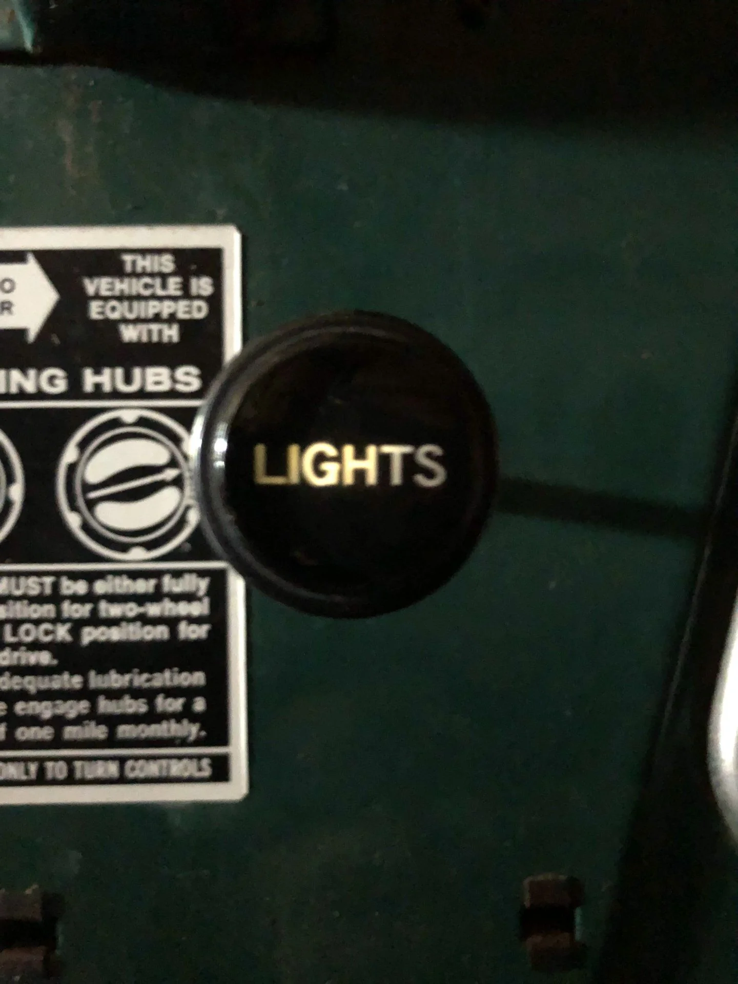

There dirt was so built up that the knob could not be "twisted" to adjust the illumination.

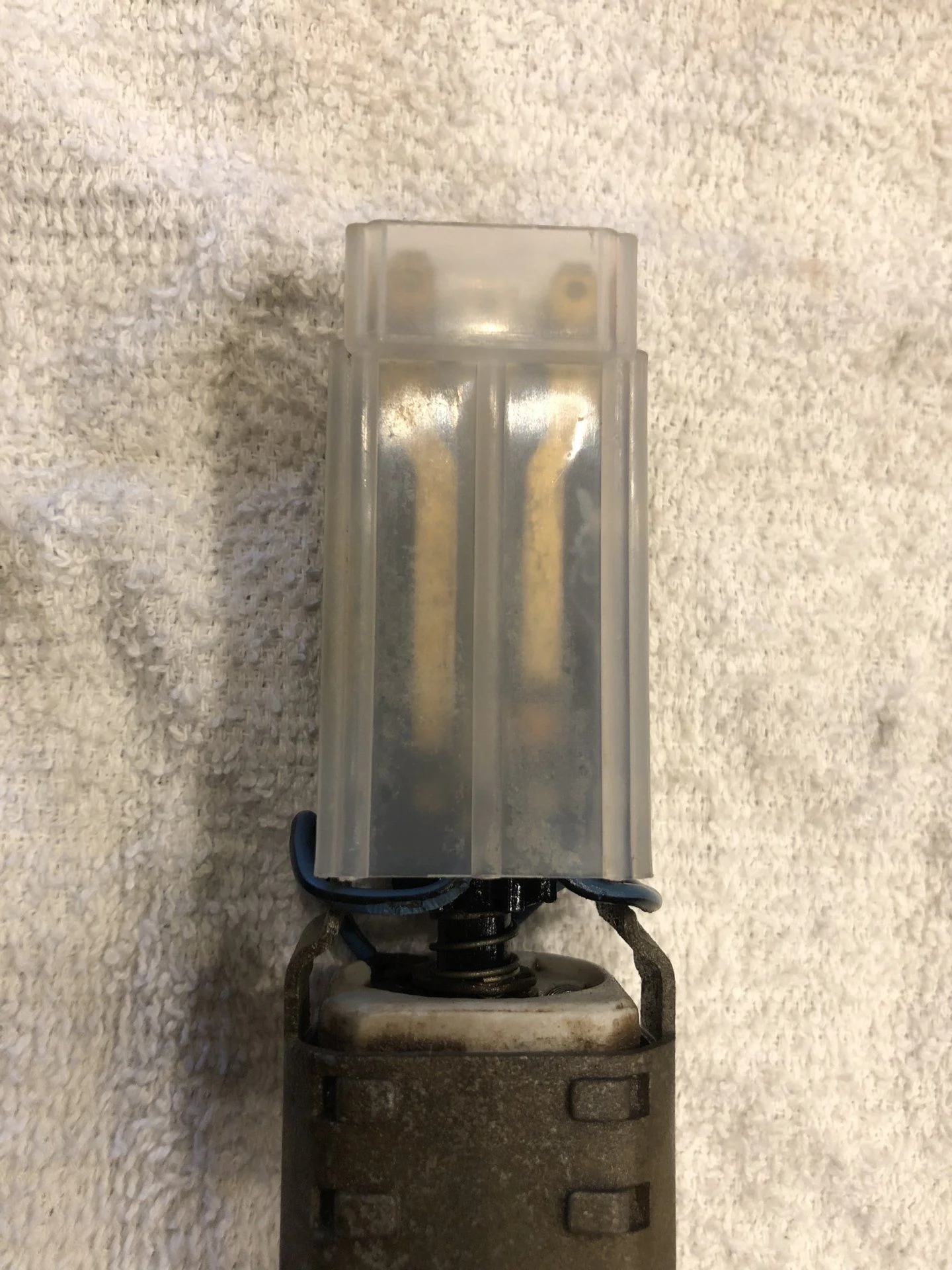

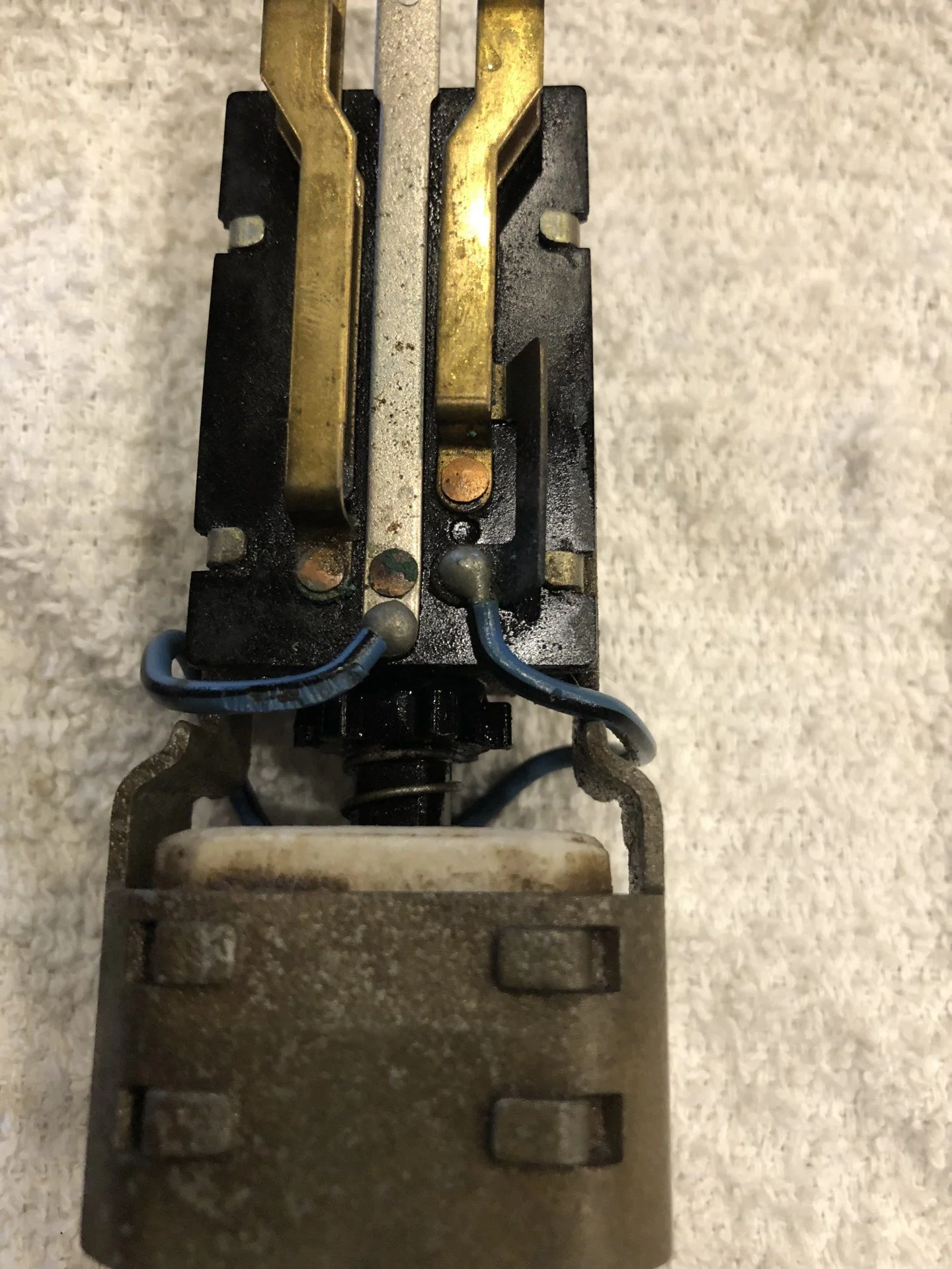

After DeOxit D5--man I love that stuff. Knob now free turning, smooth as when new.
Clean off the plastic with the steam cleaner.
Switch back together.

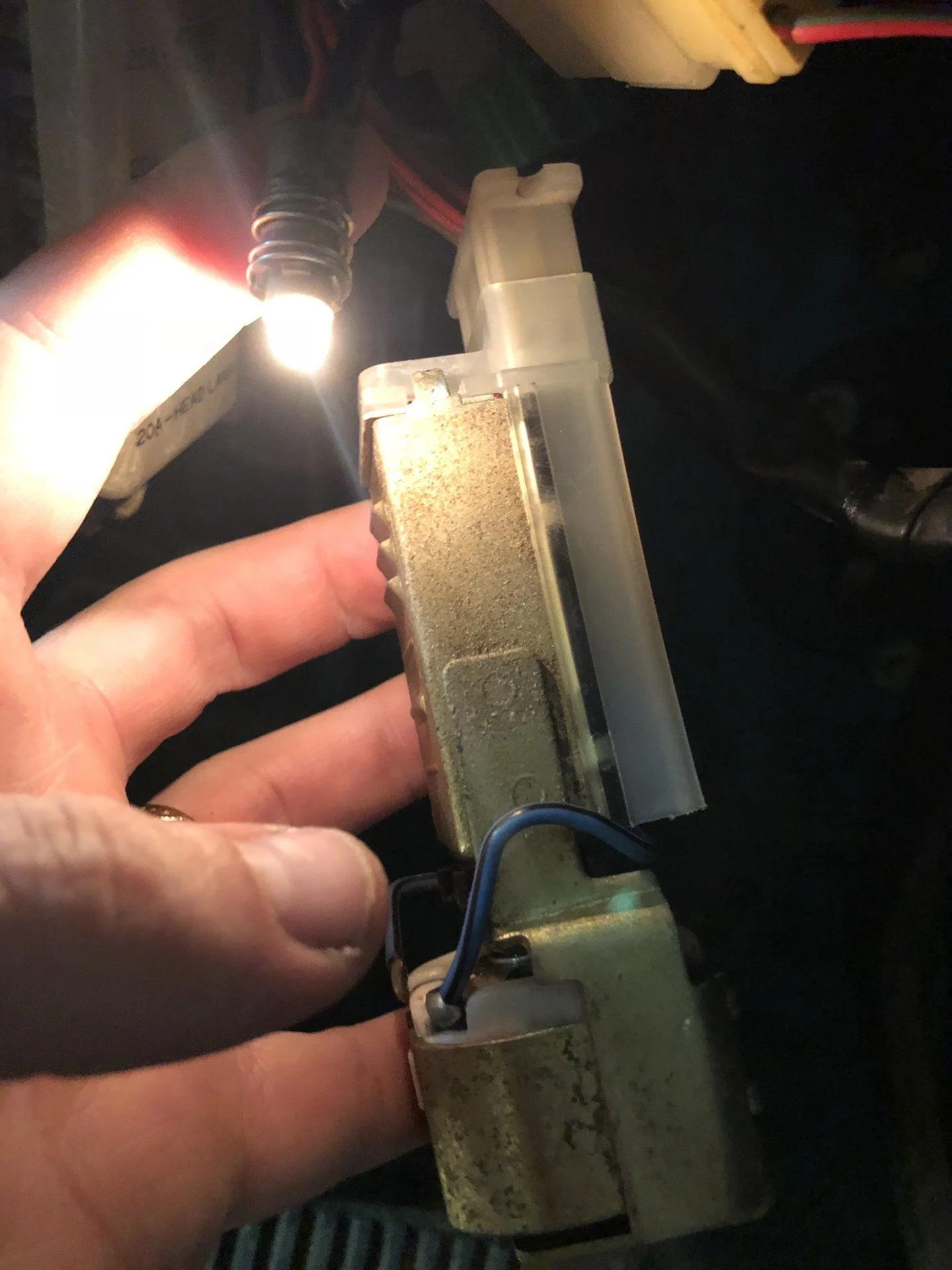

Bulb that illuminates the "Lights" knob working! This was the bulb that was in there when we got Marion, not a new one so quite possibly the original. I used DeOxit D5 on the bulb base and the bayonet socket--got rid of a lot of oxidation.
Success. I now know how Ralphie felt when he saw his dad light up the leg lamp in "A Christmas Story".

ginmtb for the lead on the MasterSeries MasterCoat Rust Sealer. It has worked great. Unlike anything I have every worked with before. Super stuff.

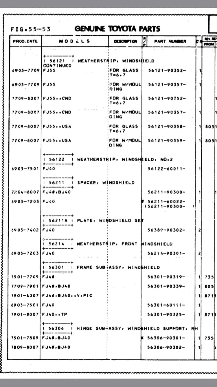

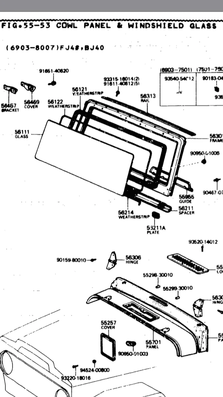

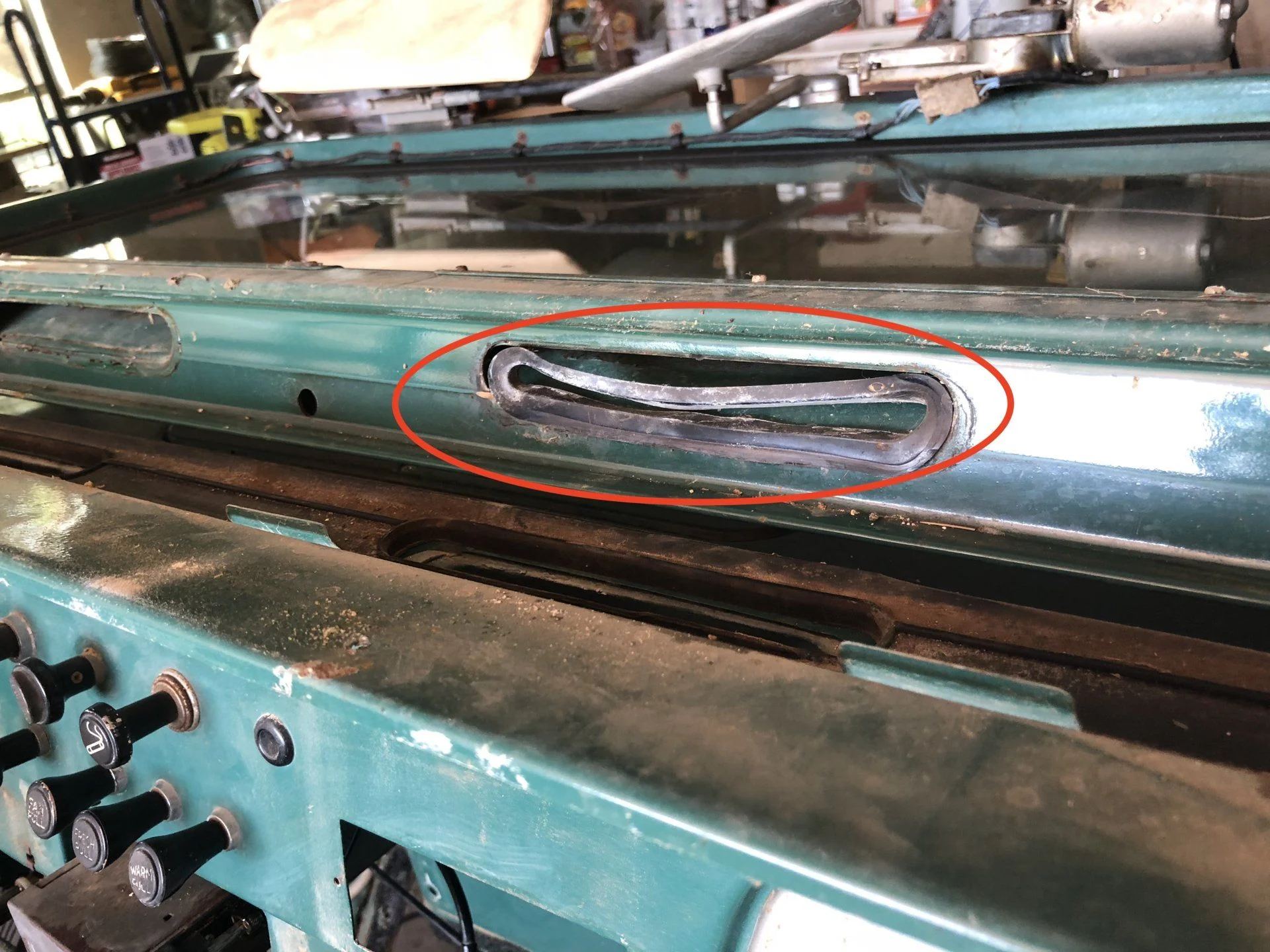

Can somebody please point in the right direction for replacement pieces for these. I am not even sure what they are called.
Thanks in advance.
I think that is 56214. Front windshield weather strip. Believe the thick rubber piece is called a spacer. Now you’ve got me wondering if I installed those on my old girl, don’t think I did:slap: I do remember them being crusty when removed.

Marion is about to be fit with her gas tank again. Starting to get a little exciting. My son and I have missed driving her.

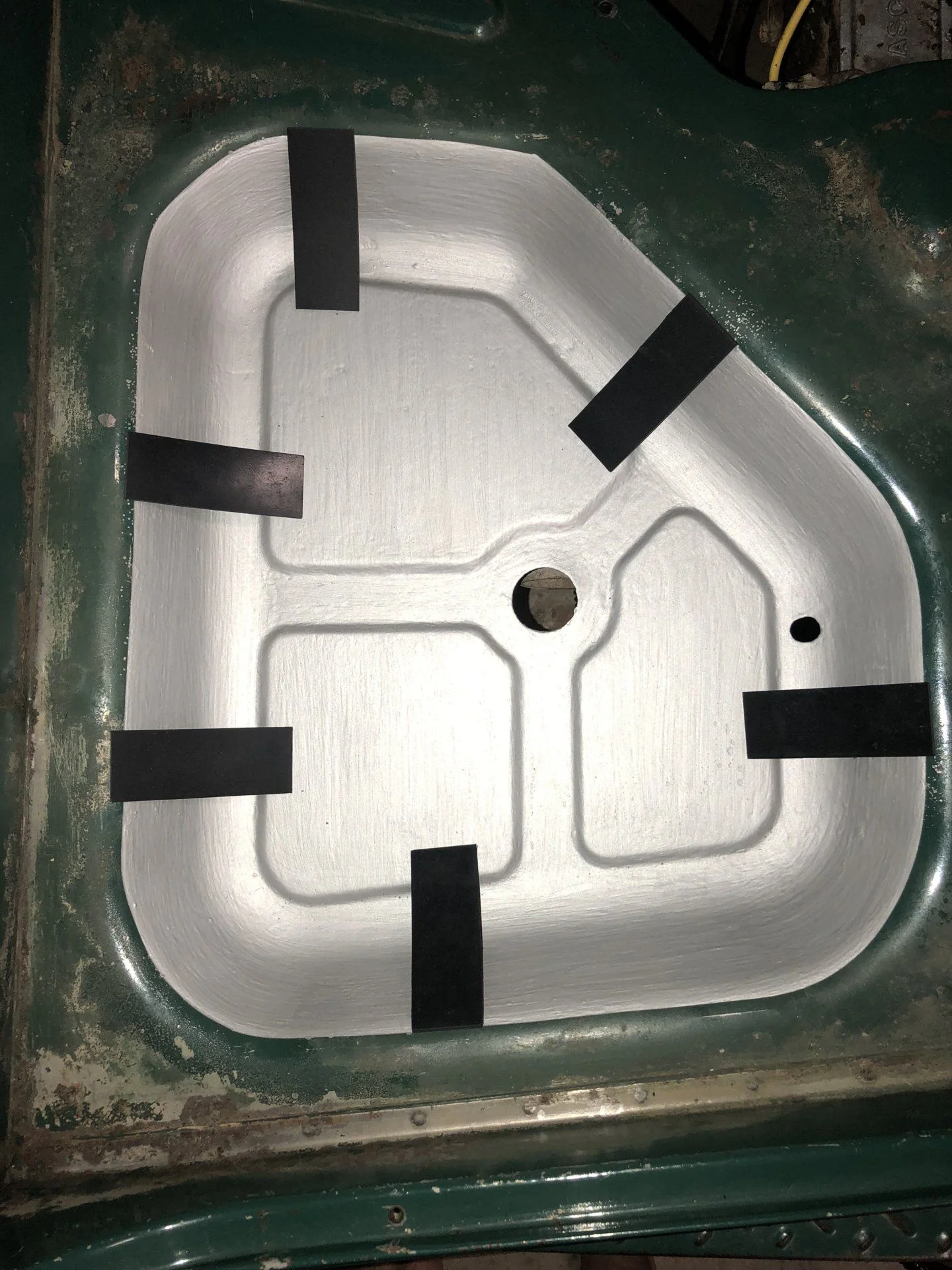

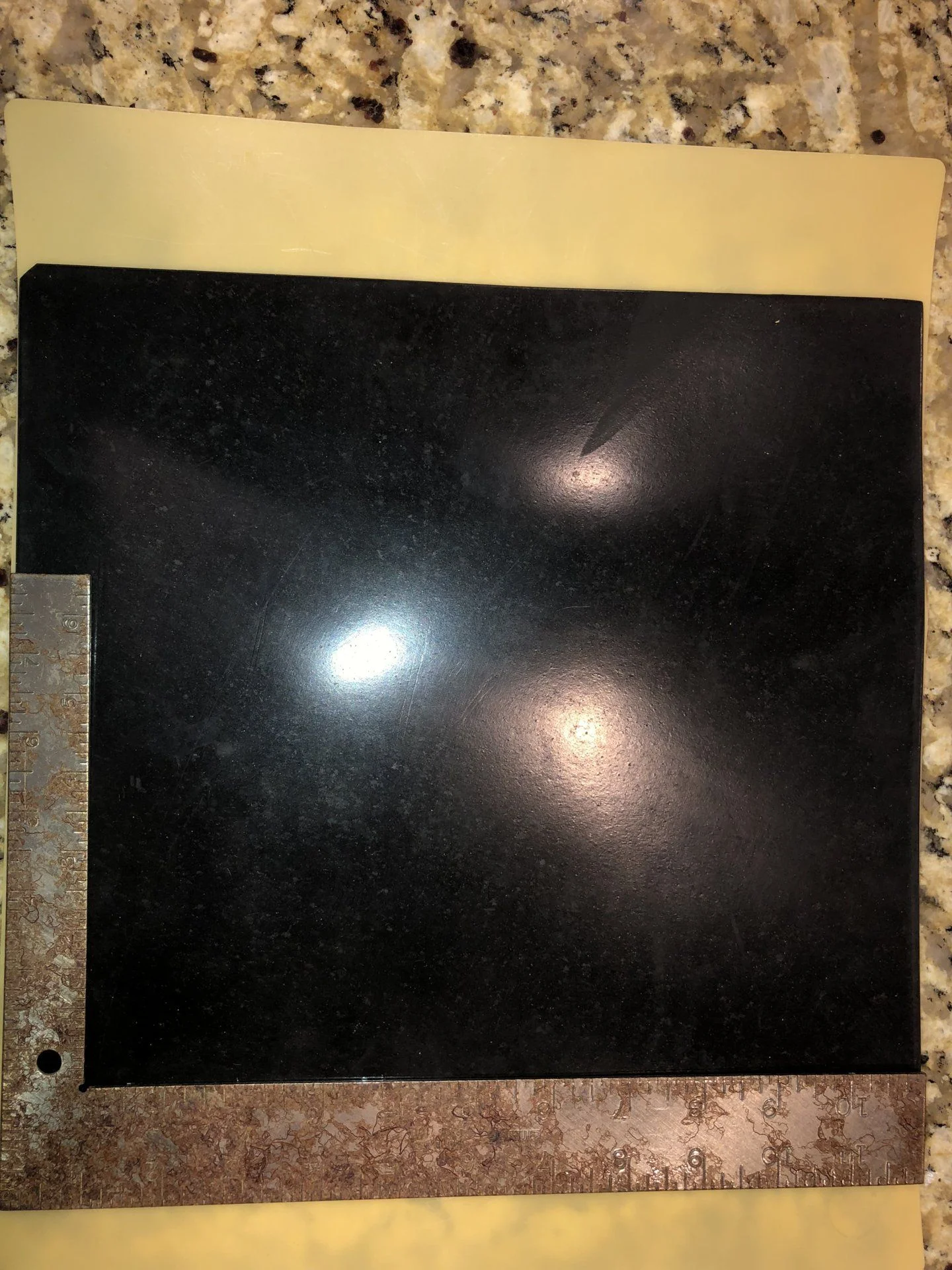

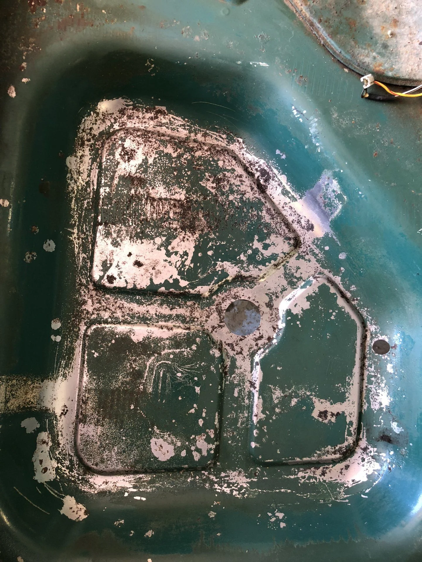

After searching, reading, and looking at many different rusted gas tank pan pictures to find the ideal placement for the pads, the picture below seems to be a common placement for them. We made our own pads out of Buna-N gasket material, 1/8" thick.
Please correct me if this placement is not right.
Sheet of the gasket material. Cut each strip the width of the wider of the two sides of the carpenters square.

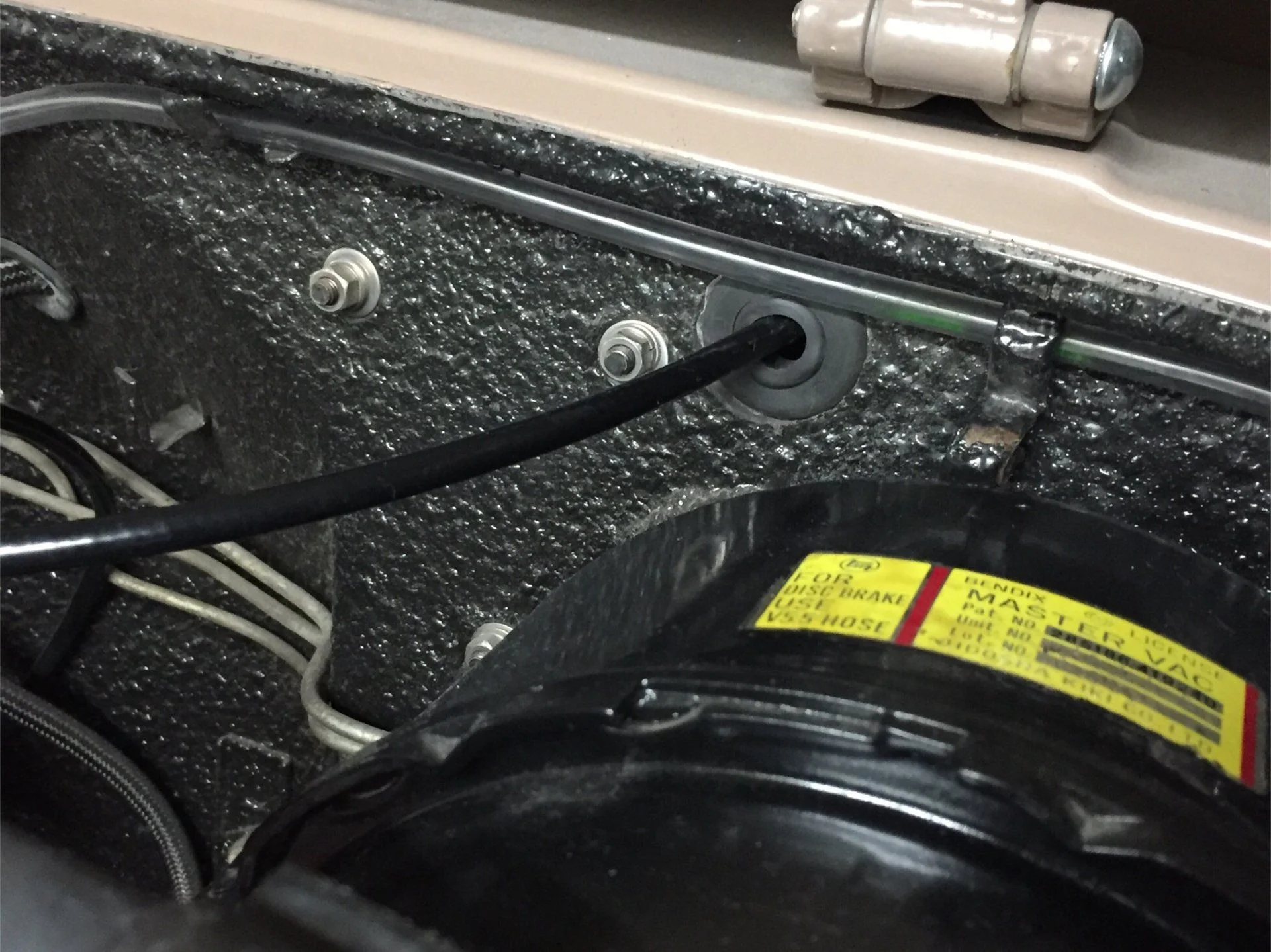

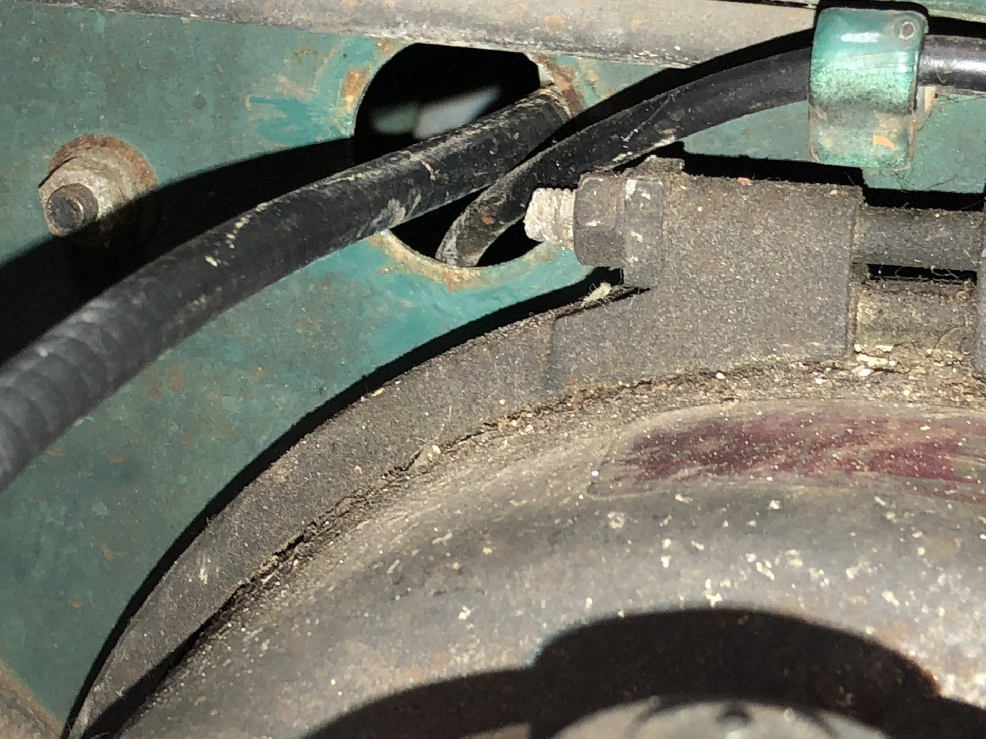

Quick question that I hope somebody with a 1974 40, or similar year, can help me with. I took out my instrument cluster to give it a good cleaning. In looking at where the speedometer cable passes through the firewall, there is a badly deteriorated grommet. Also, the antenna cable is passing through the same hole. In my research, I do not see any instances where the antenna cable and speedometer cable are passing through the same hole. Is this correct for 1974? If not, where does the antenna cable go through? Also, where can I find a grommet for the speedometer cable opening? When I search for speedometer cable grommets none are for a 1974.
I have included a picture of said opening.
Thanks in advance for the help.
ive recently looked at a thread here somewhere that suggested that the antennas were either dealer installed or added after purchase i dont know if this is truth or not if it is the cable would probably be brought through the easiest spot thats why you see them in so many different locations just a thought
Almost certain the antenna cable had a different route.
The Teq cables came with a grommet installed. I haven’t hooked it up yet.
When I first got started I bought an aftermarket cable that didn’t come with a grommet. I found a big grommet that slipped over, then a small but stretchy grommet that fit inside the big grommet. If I didn’t have the Teq cable waiting install, I would used some black liquid tape to seal my current setup. Recently saw a post where a putty was used to seal firewall holes. Amazing how engine smell get sucked through unused bolt holes and grommet gaps. Sealing all that up is on my list:D
