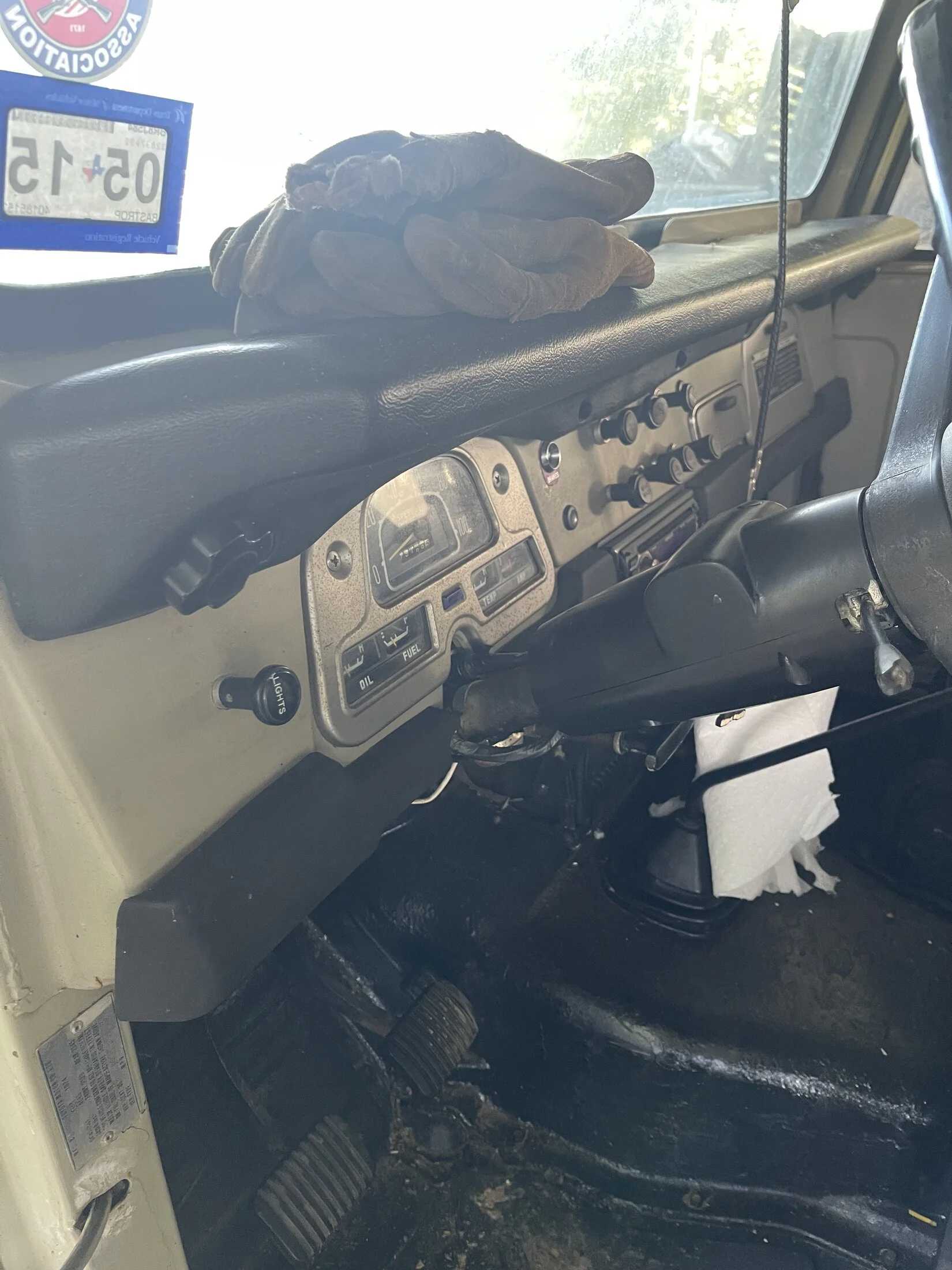

My ‘74 ignition switch is on the column. I visited a modified ‘74 that had the ignition switch on the face of the dash.
What might explain the difference?
The early ones had the ignition switch on the dash. The later columns (~1972) had the the switch in the column. Possibly some kind of re-body or column swap situation.

9/72 Toyota changed the steering box and column. The new column has the more modern ignition switch in the column. These had a locking option in some markets but not the US. To my knowledge the 40 series never had any type of starter lock out that needed either the shifter in neutral or clutch pedal pushed in.
