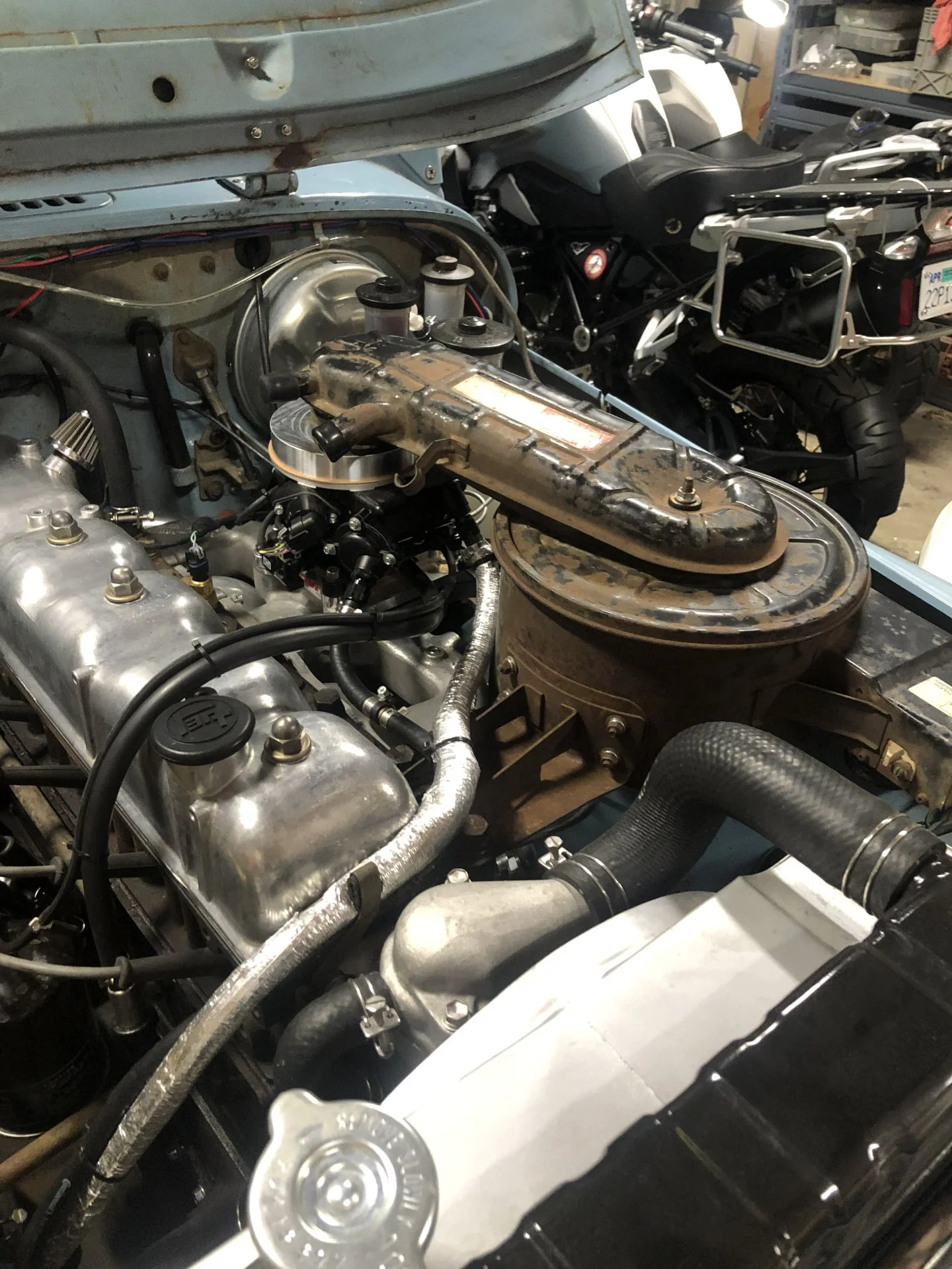

@Steamer I placed the pump as close to the tank for that reason (reduce pulling), but I think/hope I can move the pump a bit further down the line to move it to the frame. The filters were the 2 included in the Sniper kit. I tried to wrap the inlet fuel line in the engine bay with cooltech heat wrap, but it is a hot area right over the headers and past the thermostat housing. I plan to convert to 3/8 hardlines in the engine bay with AN6 fittings, a pressure gauge, a better path and with heat protective wrap (again), but am knee deep in door rebuilds currently. Planned to swap that over sometime soon (bank account permitting).
I have 5/16 hose from the tank to the first filter, but run 3/8 hose everywhere else. I think I am OK with cavitation, but any feedback on my setup would be appreciated. Doing all this fuel line and EFI conversion for the first time. The guidance on this forum is helping me greatly.
