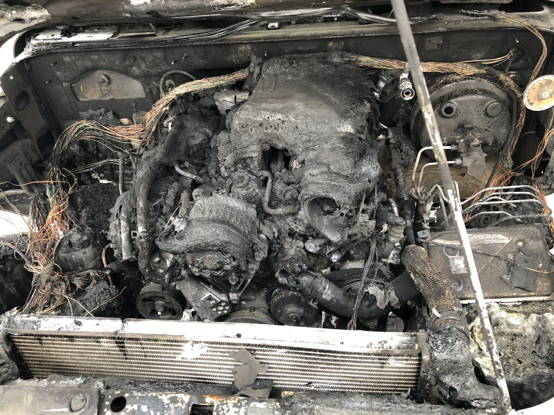

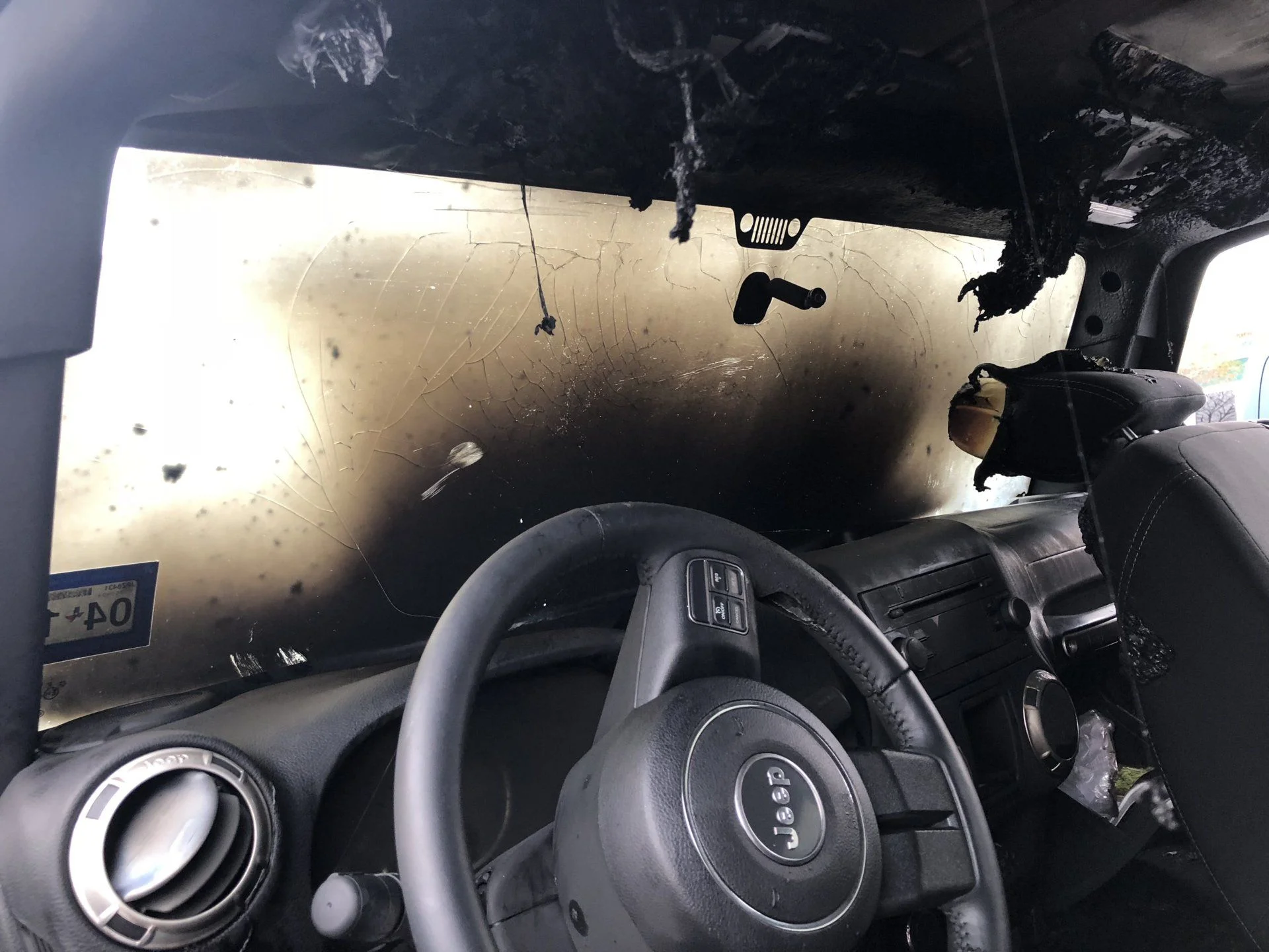

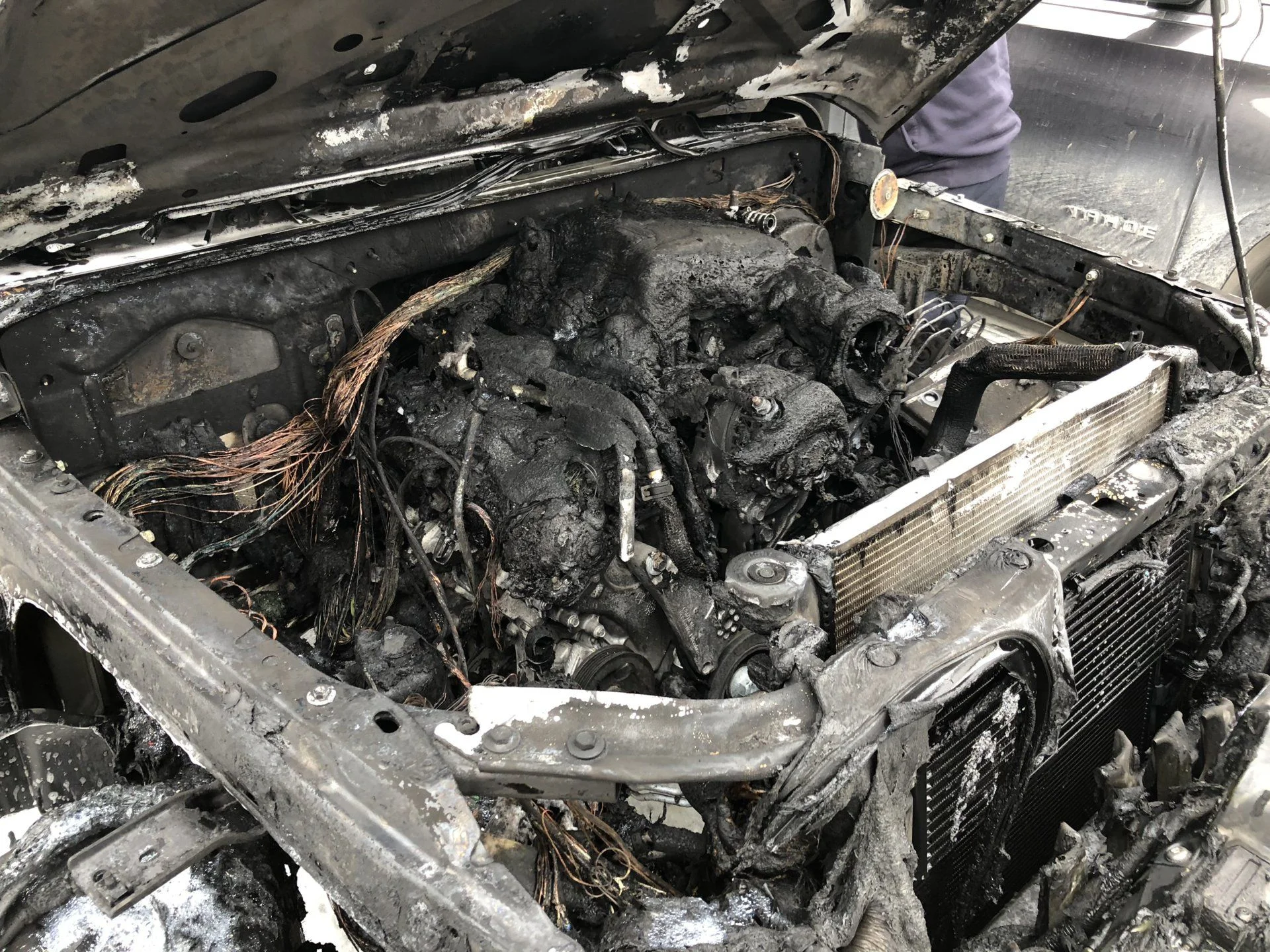

All was great until the eve of New Year's Eve when said tank colored Jeep Wrangler Rubicon caught on fire. As is obvious from the pictures, it was a total loss. It really sucked...not for the reason you are thinking...of course your car catching on fire sucks, but that's not what really sucked. What really sucked is the form of the Jeep Wrangler is what I loved. Nothing else has that form is what I remember thinking at the time...and nobody in my family will ever be in another Jeep. My son was devastated. He loved that truck--to him it was what that electric blue Toyota was to me at that age. Main difference is that the Toyota didn't go down in a blaze of failure. But then those memories of that electric blue Toyota stated to percolate. A little research here and there in my free time and this "ih8mud.com" hit kept coming up as I was researching FJ40s. A half a day one Saturday on this forum and I got the sickness...the obsession...to own an FJ40.

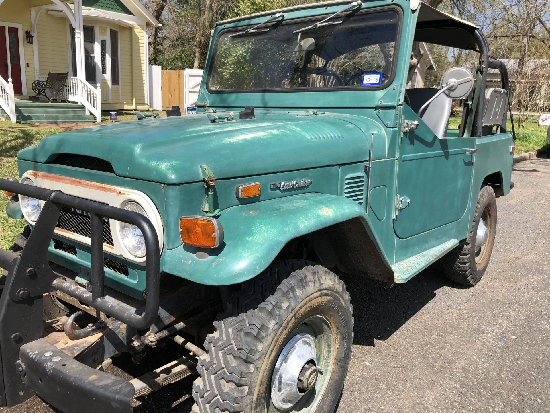

Let me introduce you to Marion...I'll explain more about the name as we go.
She's photogenic. That being said, pictures do this 'ol girl no justice. She's even more beautiful in person.

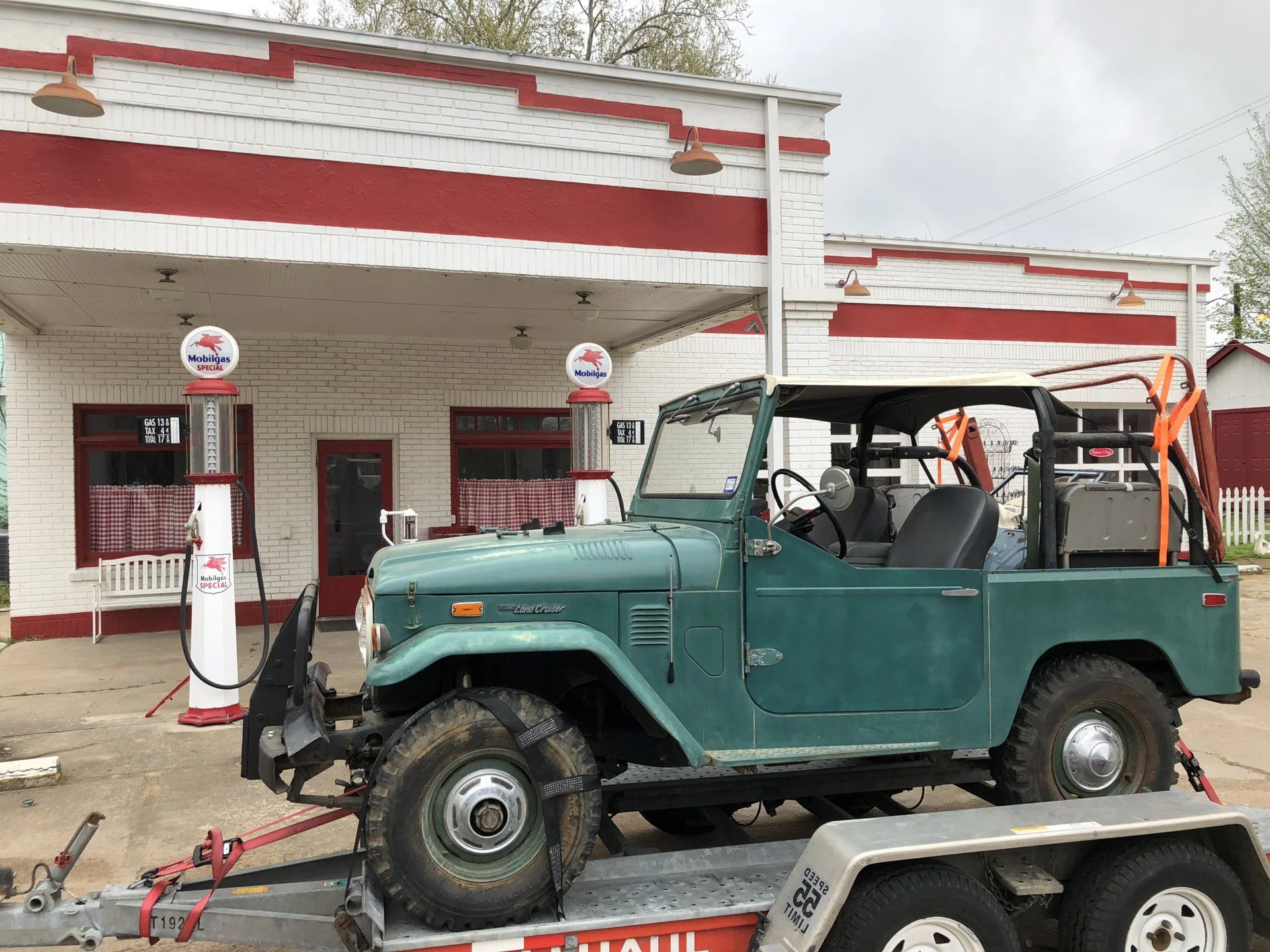

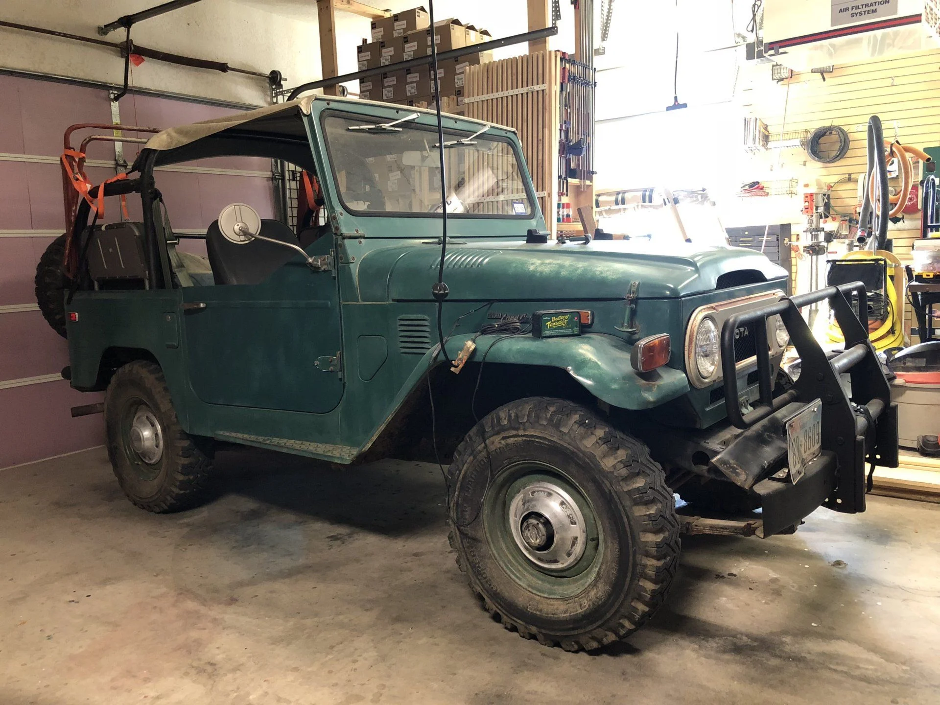

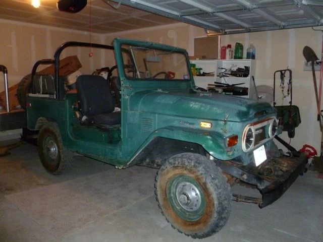

Picture by Jtk72 when he brought her home in 8/2012

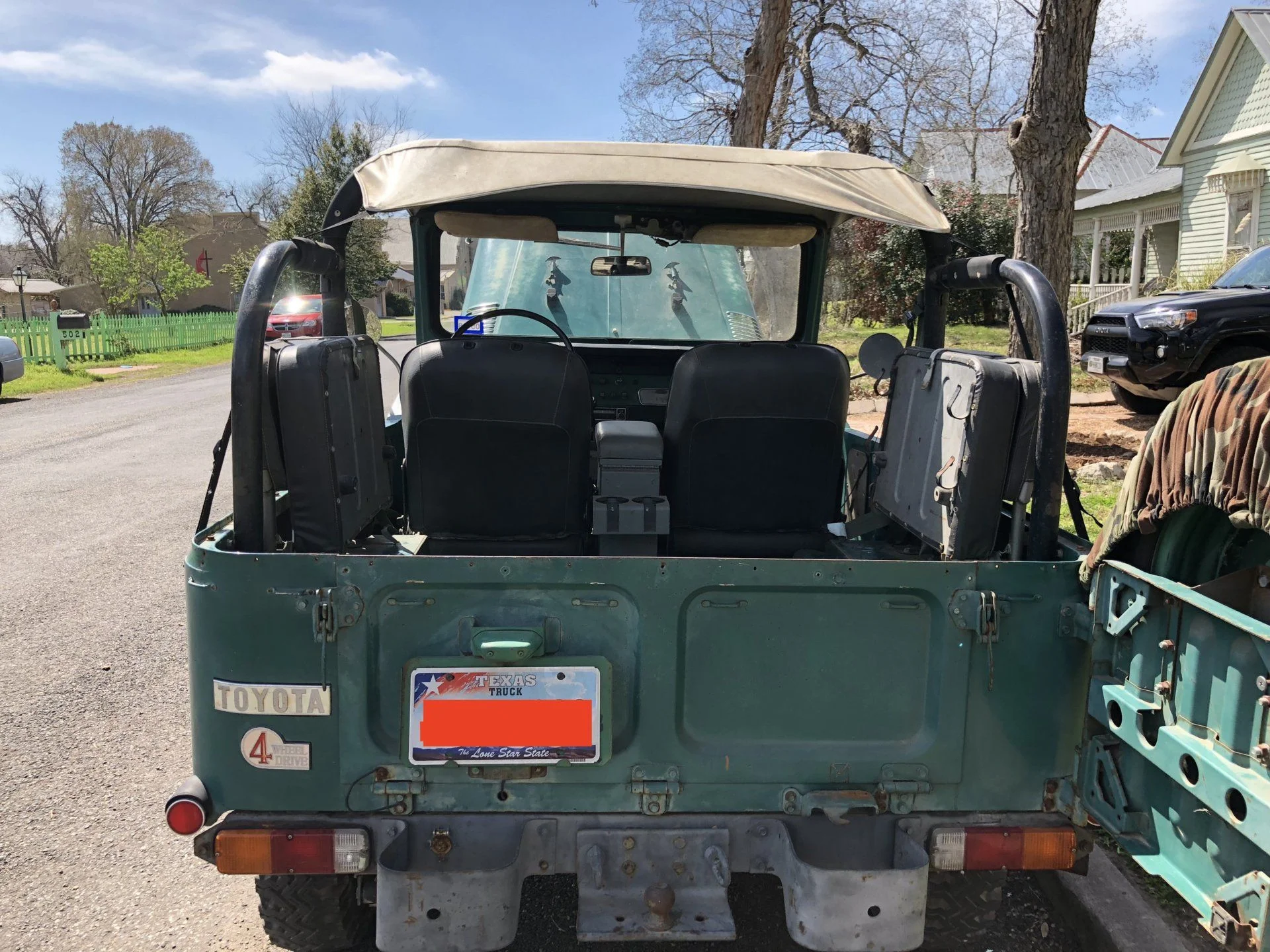

Picture from Sunday March 18, 2018 in my garage. I didn't realize it until I was putting this post together that Jtk72 and I took almost the exact same picture 6 years apart.

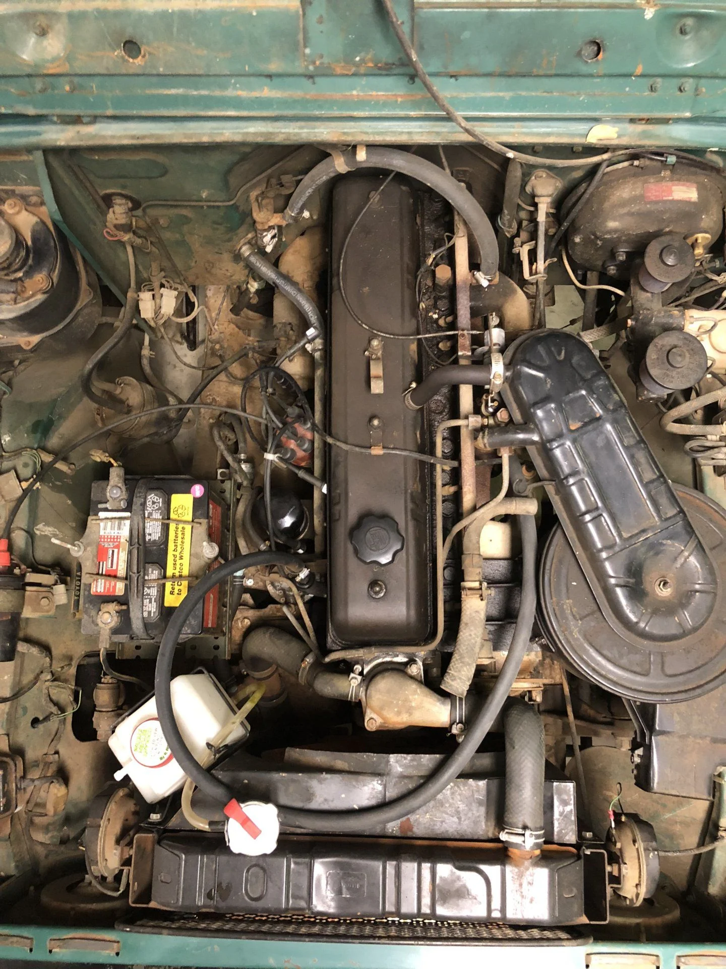

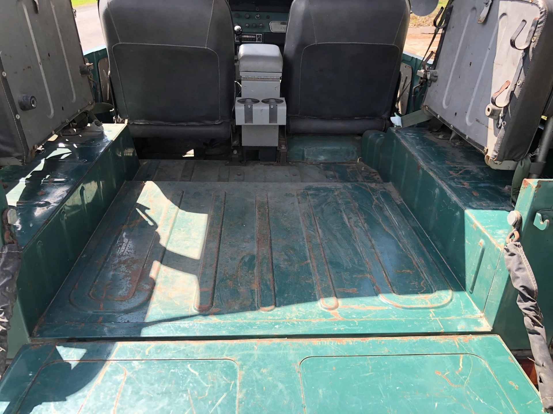

Her heart and her muscle
Notice the kick-ass shotgun rack on the fold down seat on the right. Those will be cleaned up and put back on.

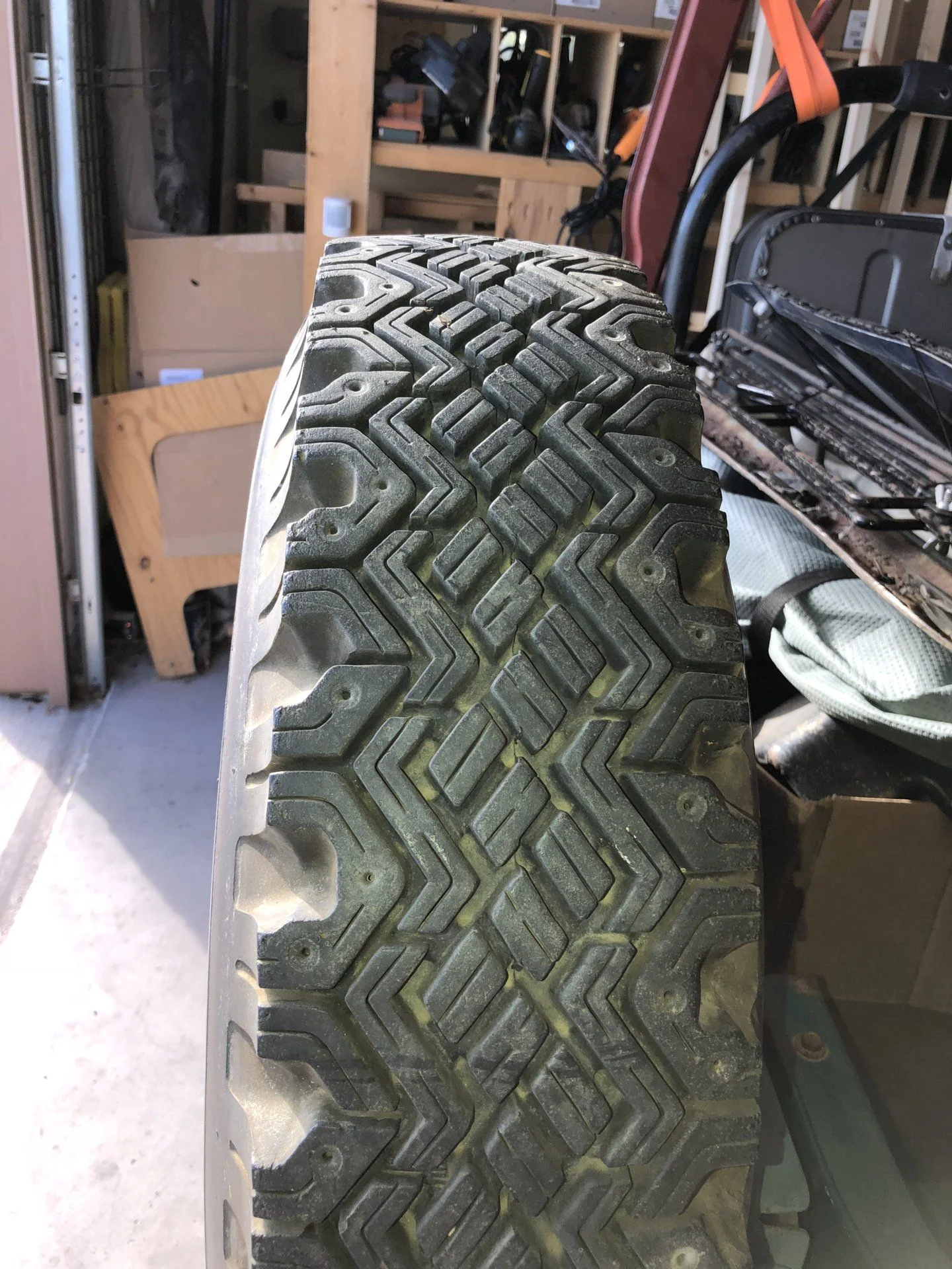

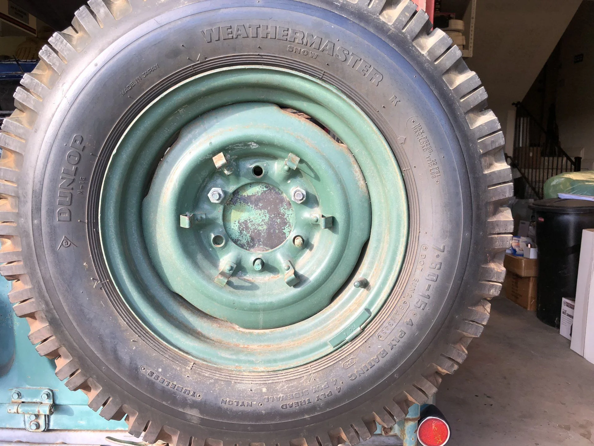

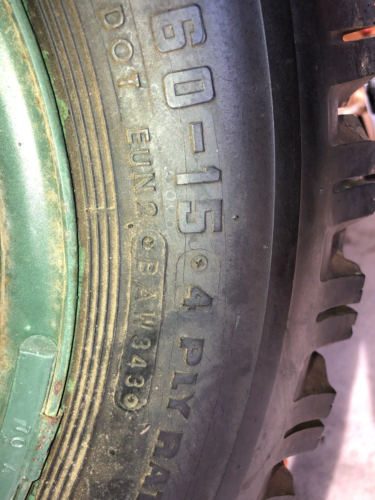

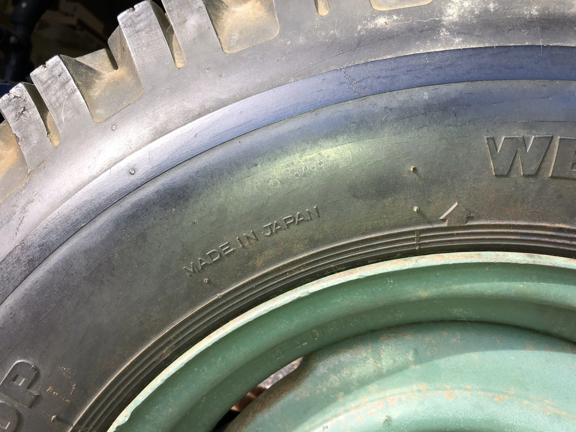

So here are the pictures of what I think is the original spare tire. Of course, the wheel is not the original color. The reason I think it is the original is the date code on the tire is "343" and is labeled as made in Japan. This means that this tire was manufactured in Japan in the 34th week of some year that ended in "3"...i.e 1973, 1983, 1993, and so on. The 34th week of 1973 was August 20th to August 26th. Being that the truck was built in October, 1973 and close to the manufacture date for the tire if made in 1973 is likely not a coincidence. Also, Dunlop tires were what the FJ40s left the factory with.

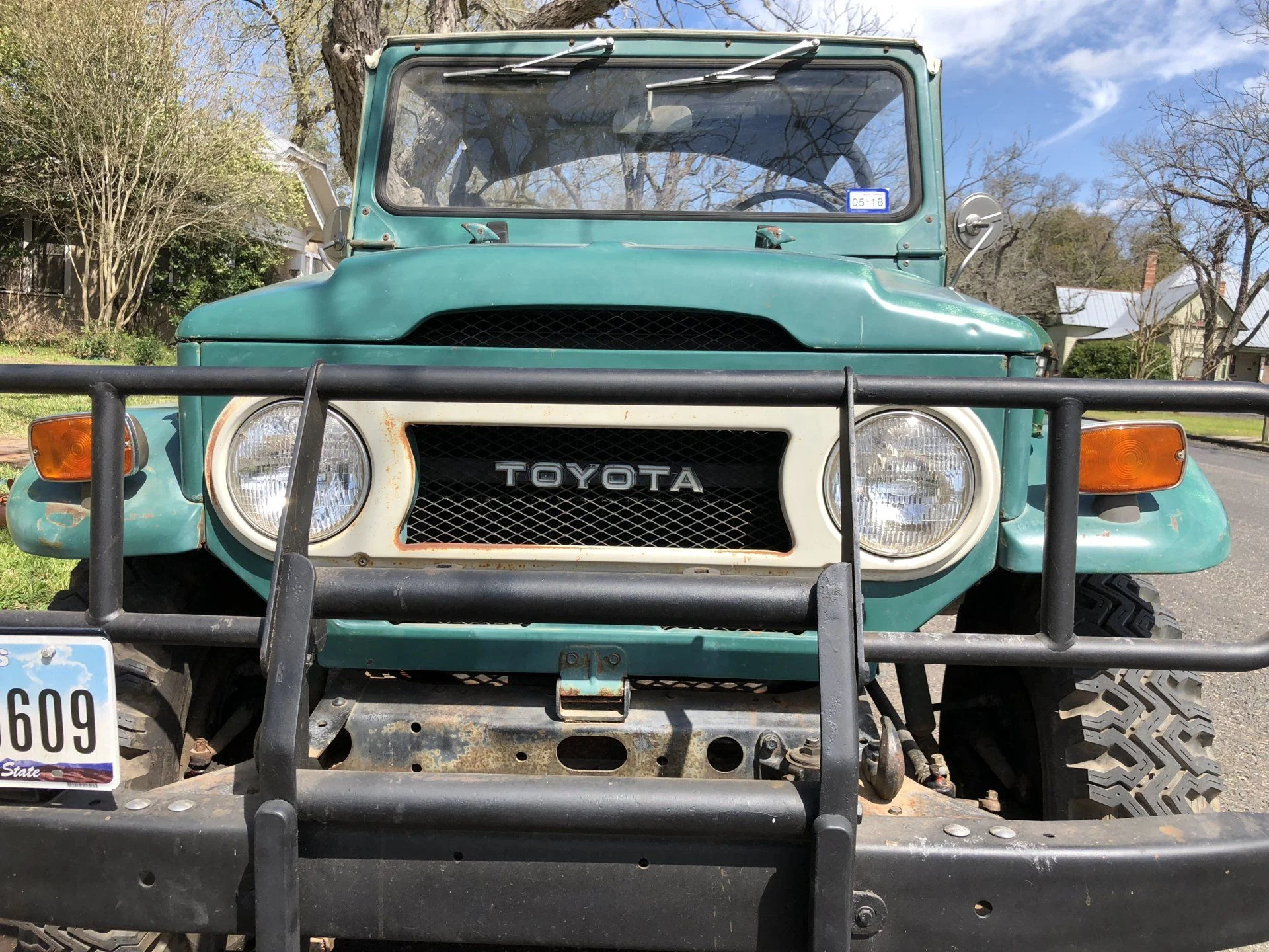

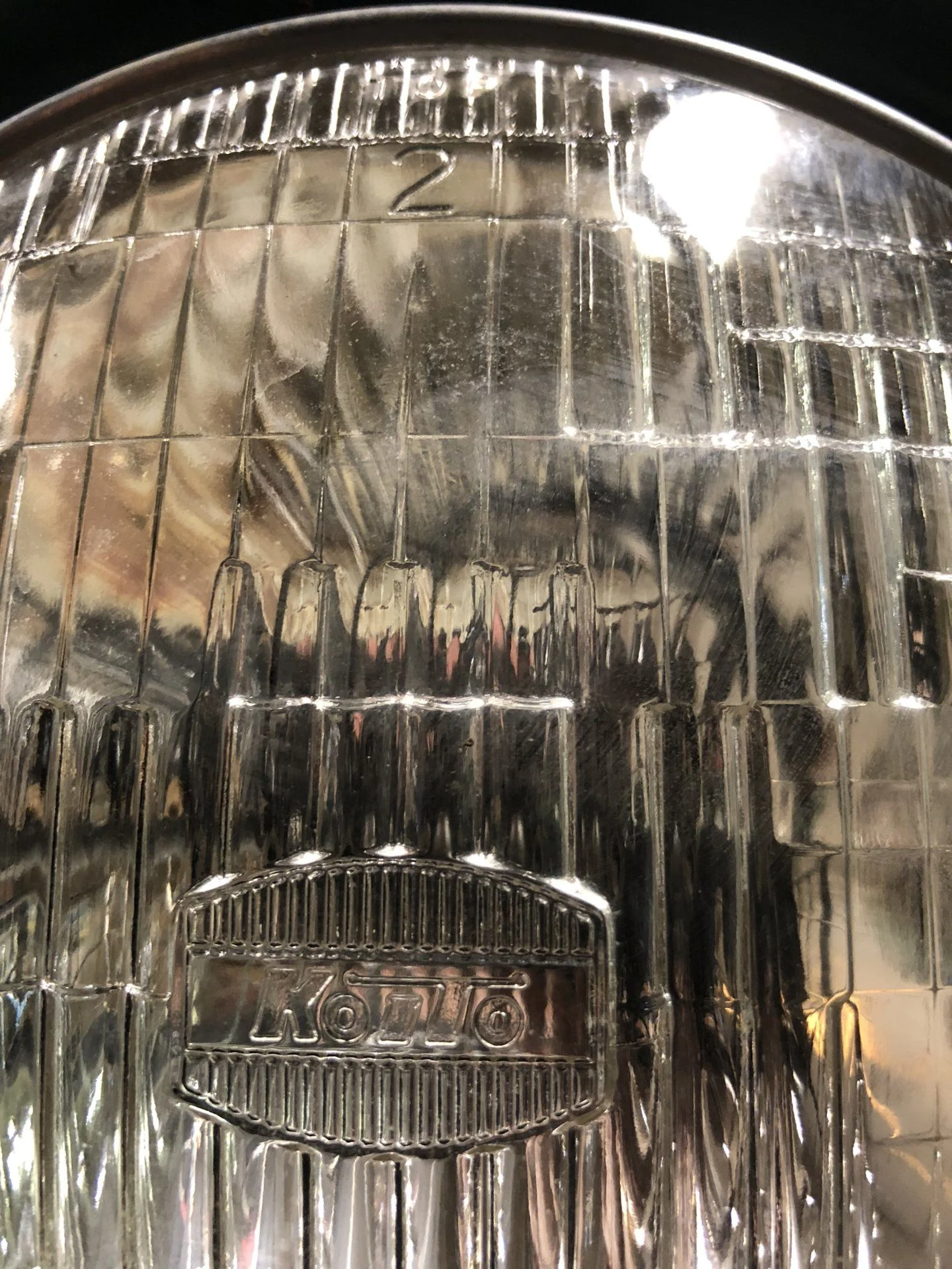

Also a picture of what quite possibly are the original headlights, at a minimum they are OEM. It was actually my daughter that noticed the headlights...I was amazed that she recognized the name on the headlights as what was used on FJ40s. I guess I am teaching her well.

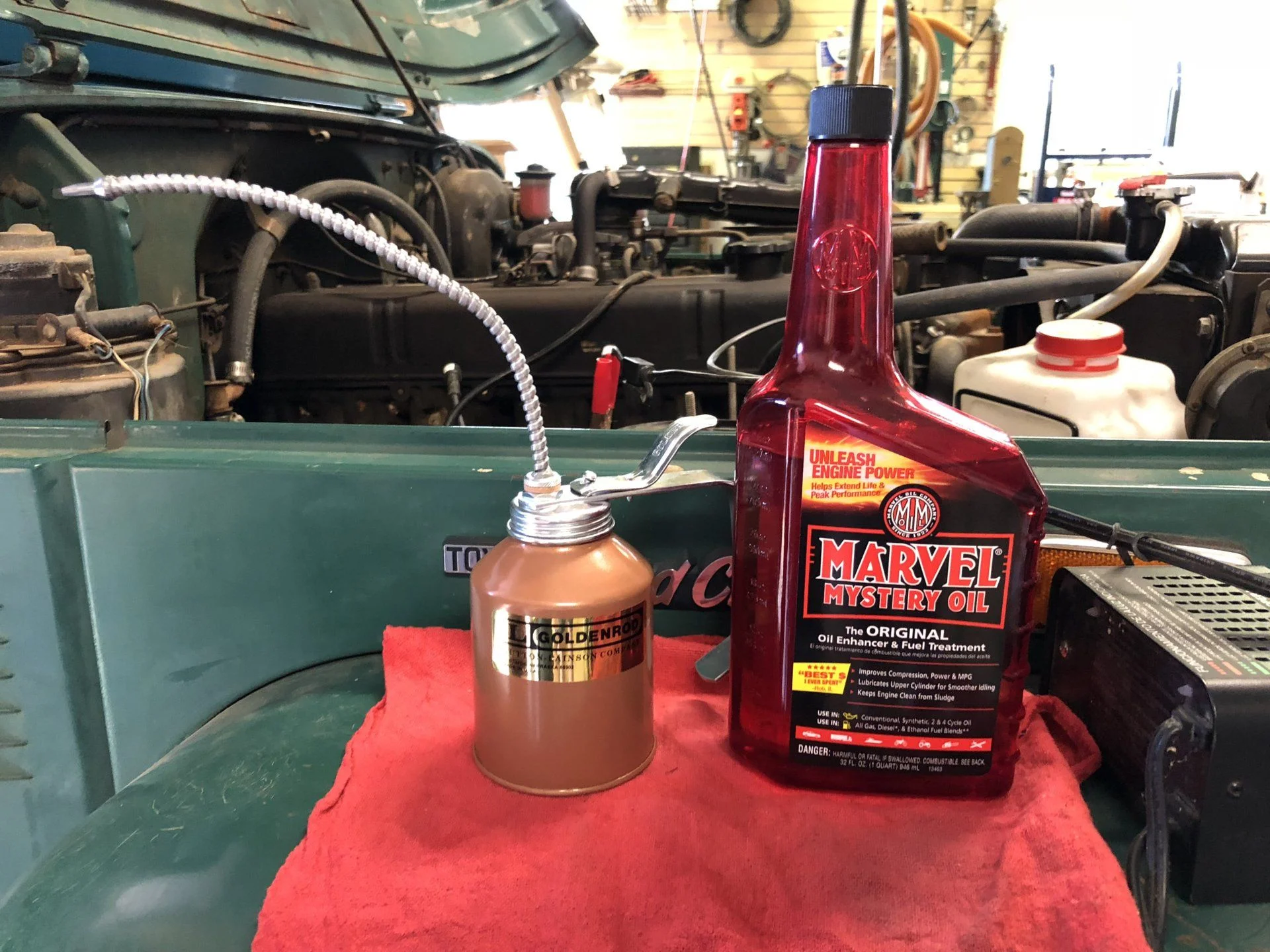

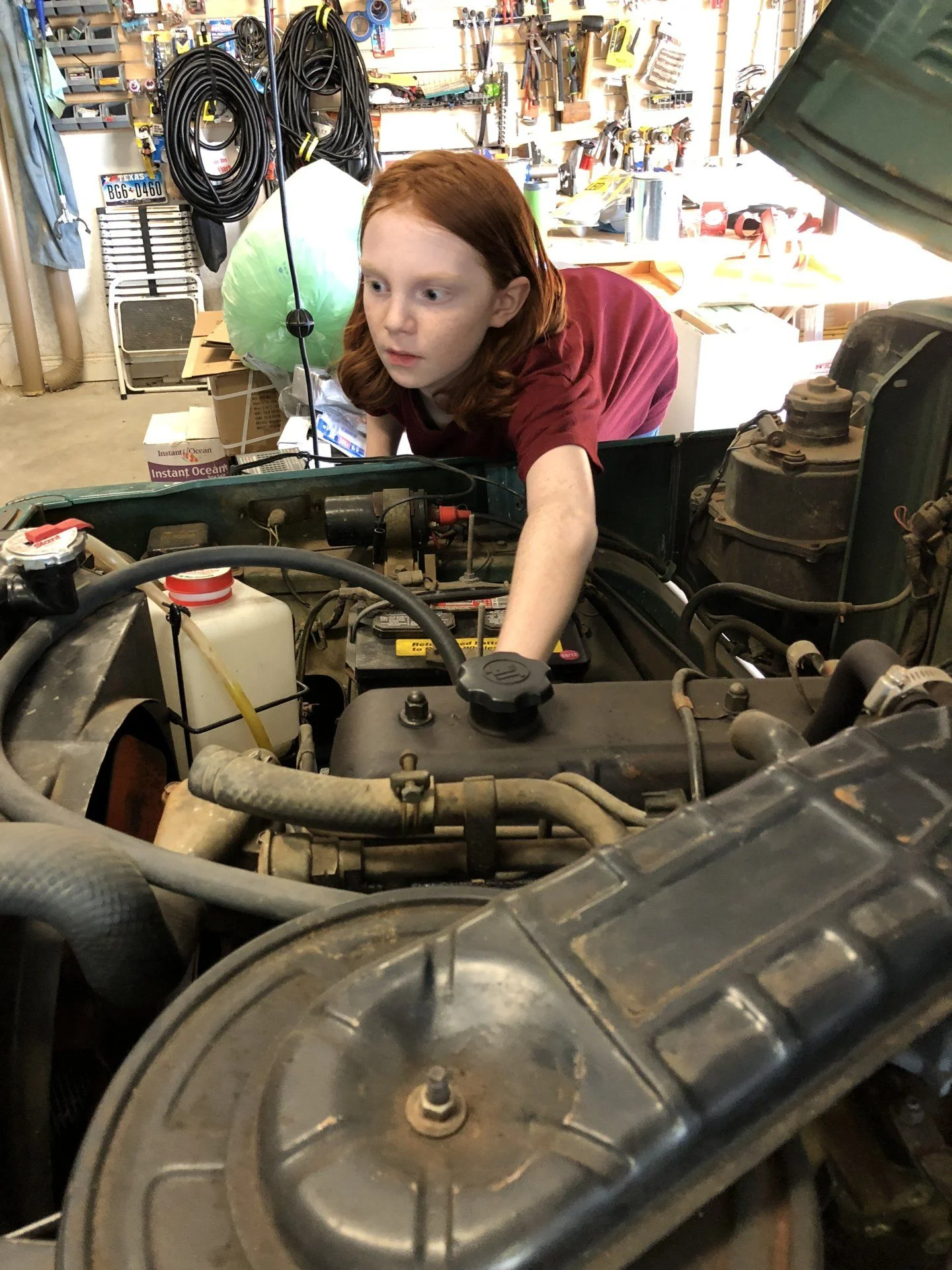

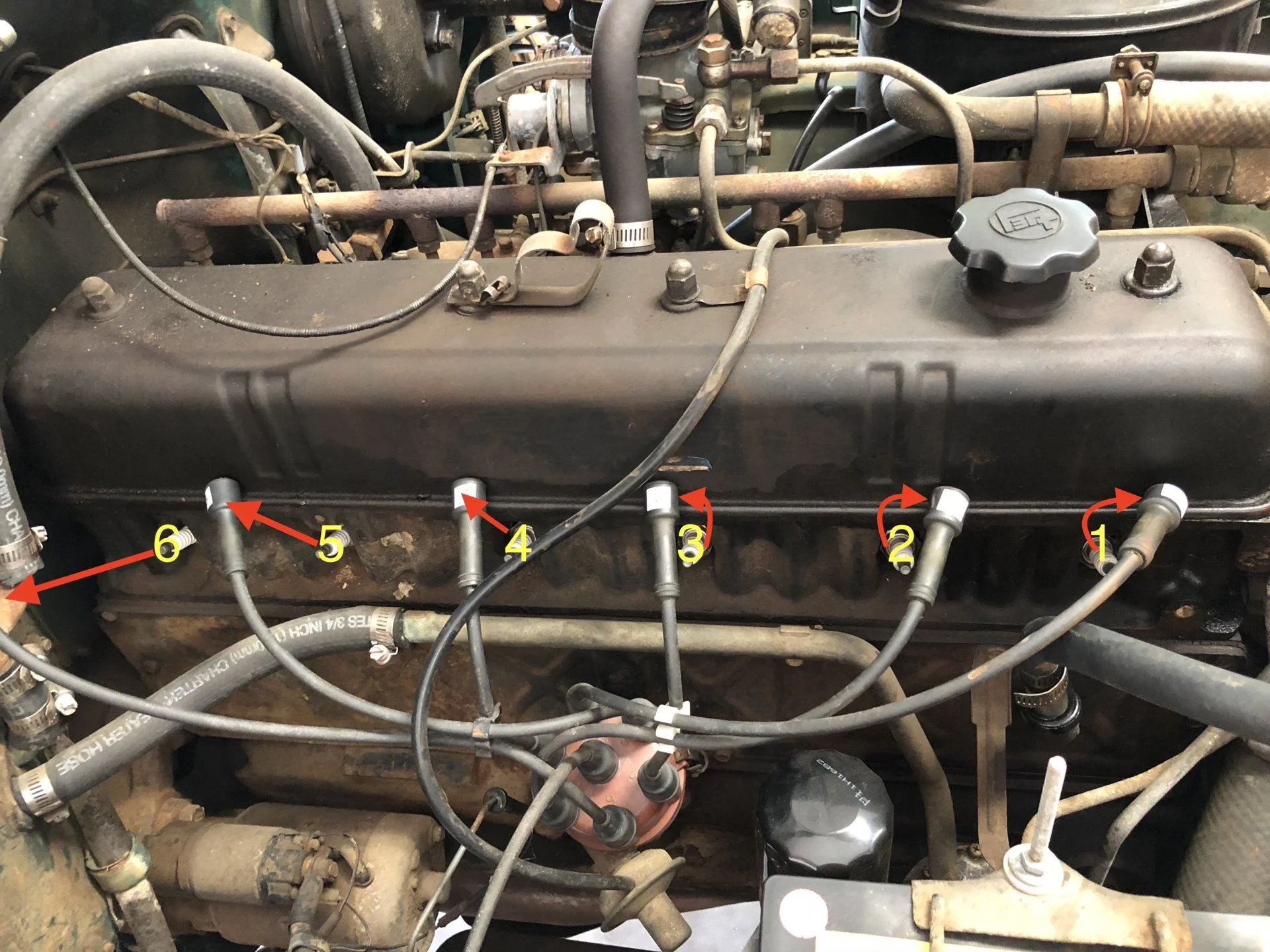

Because Marion has not been driven much over the last several years I wanted to make sure the piston rings were well oiled and forming a good seal in each cylinder. We chose Marvel Mystery Oil because it is a light oil and figured it could get down around the rings better...and my son loves Marvel, especially Captain America...he thought the name was pretty cool.

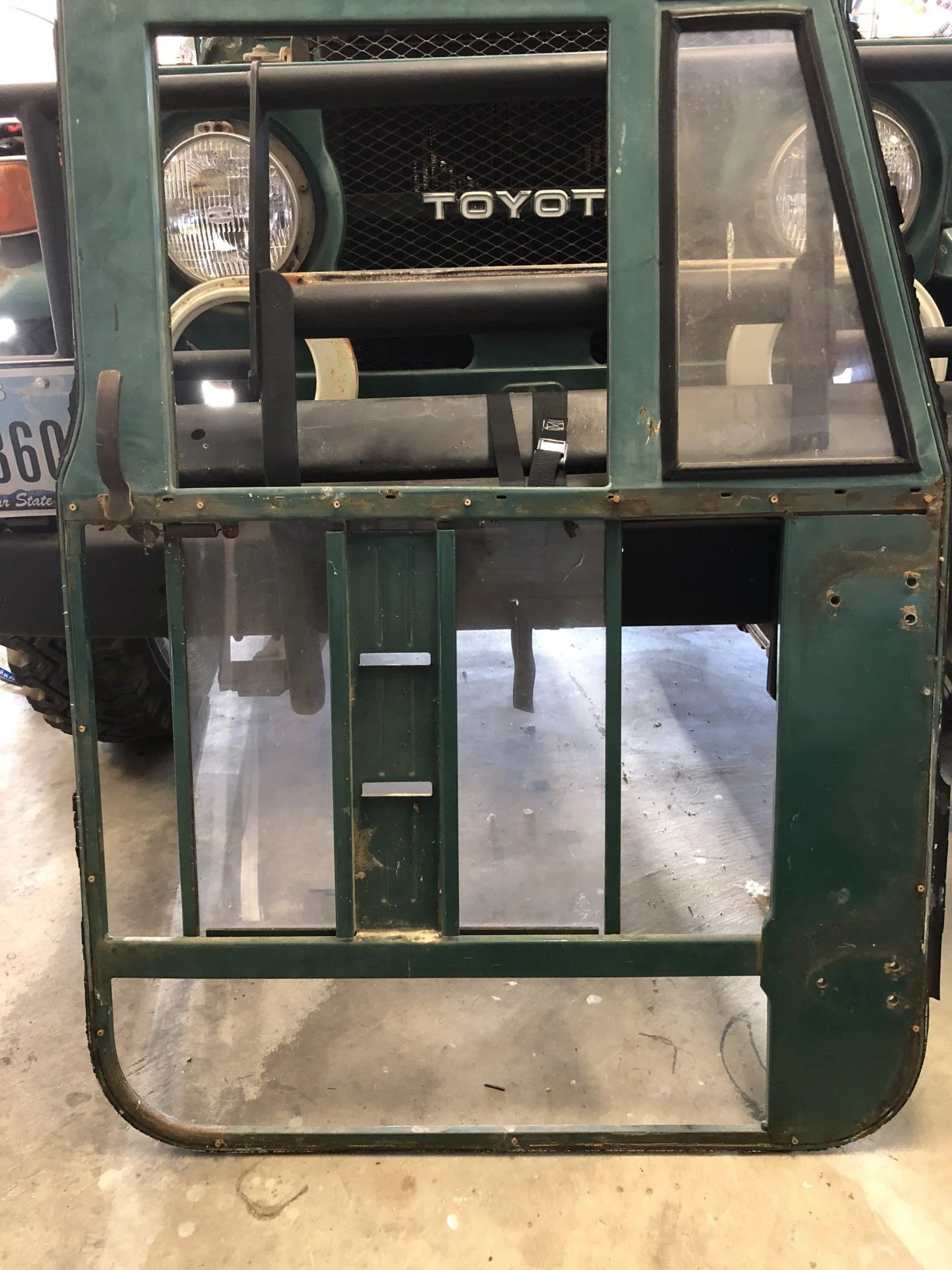

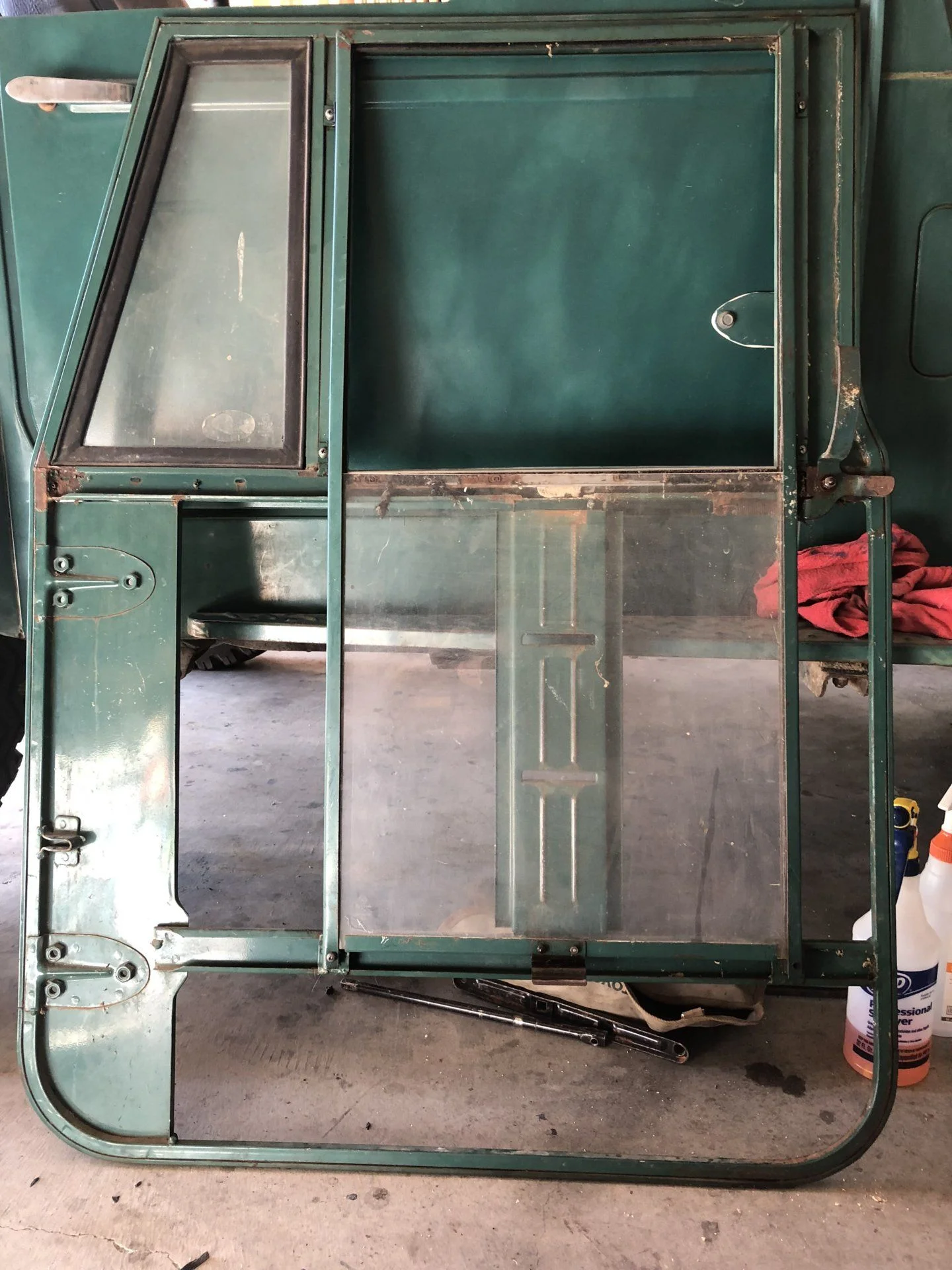

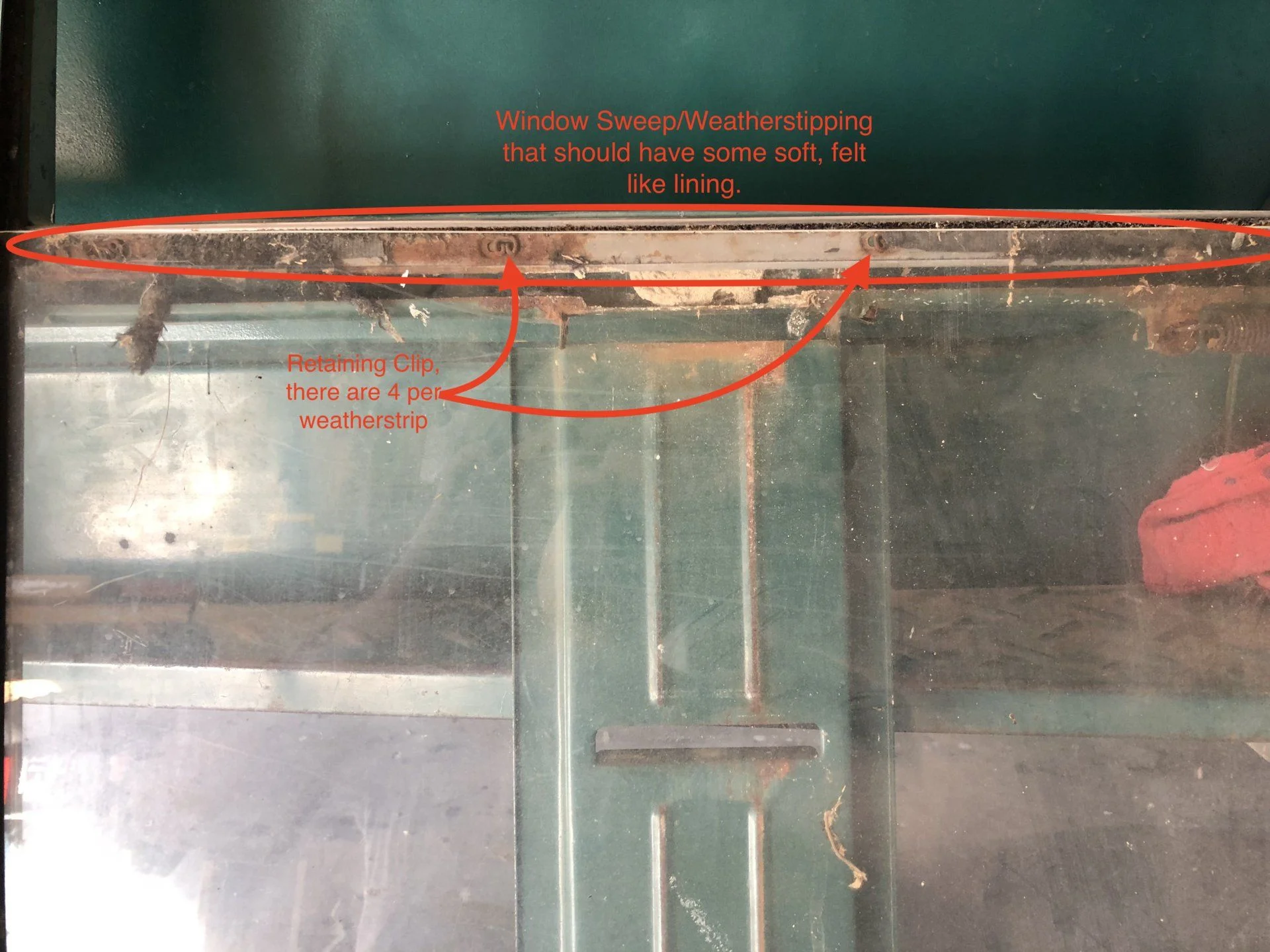

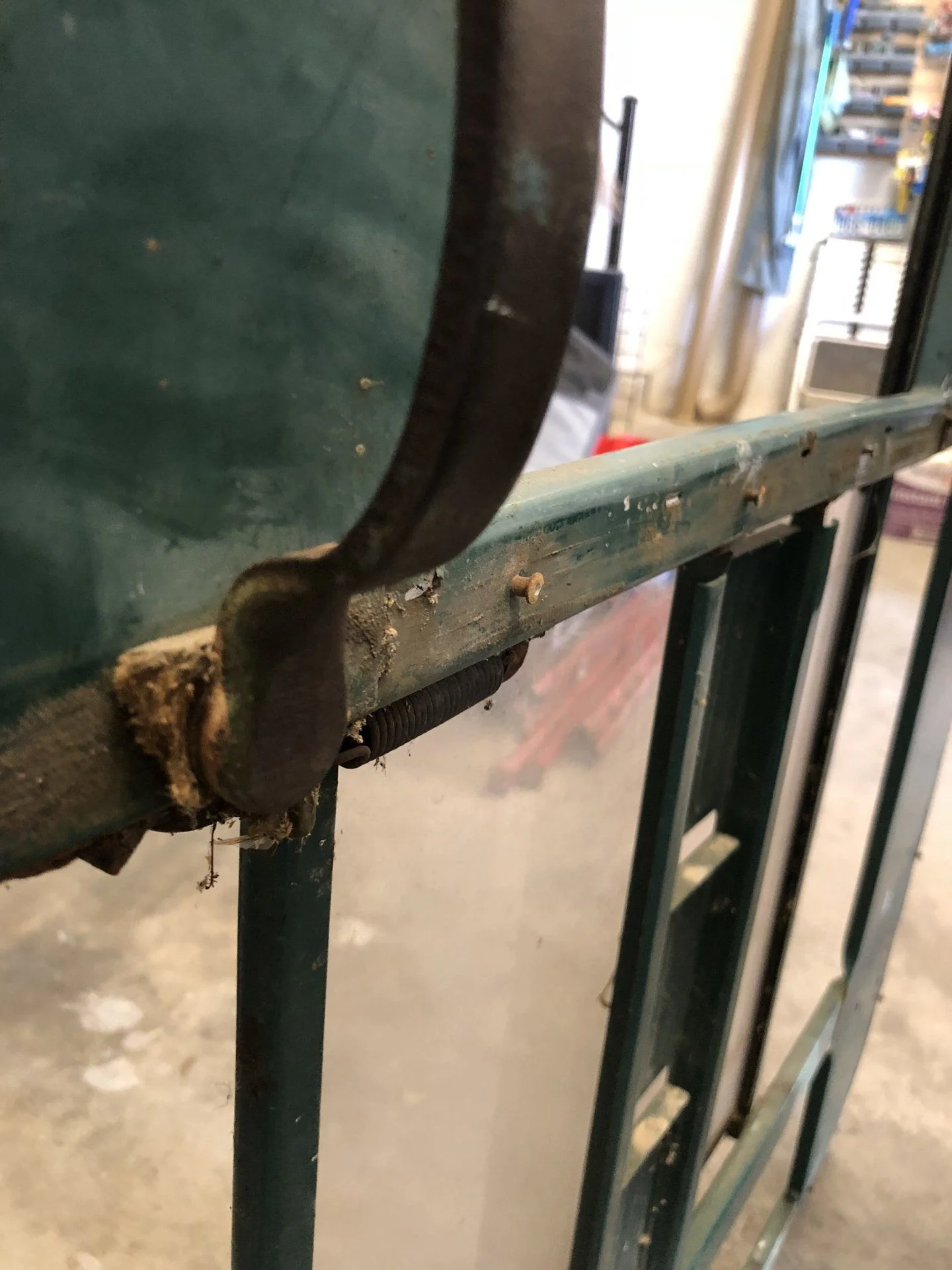

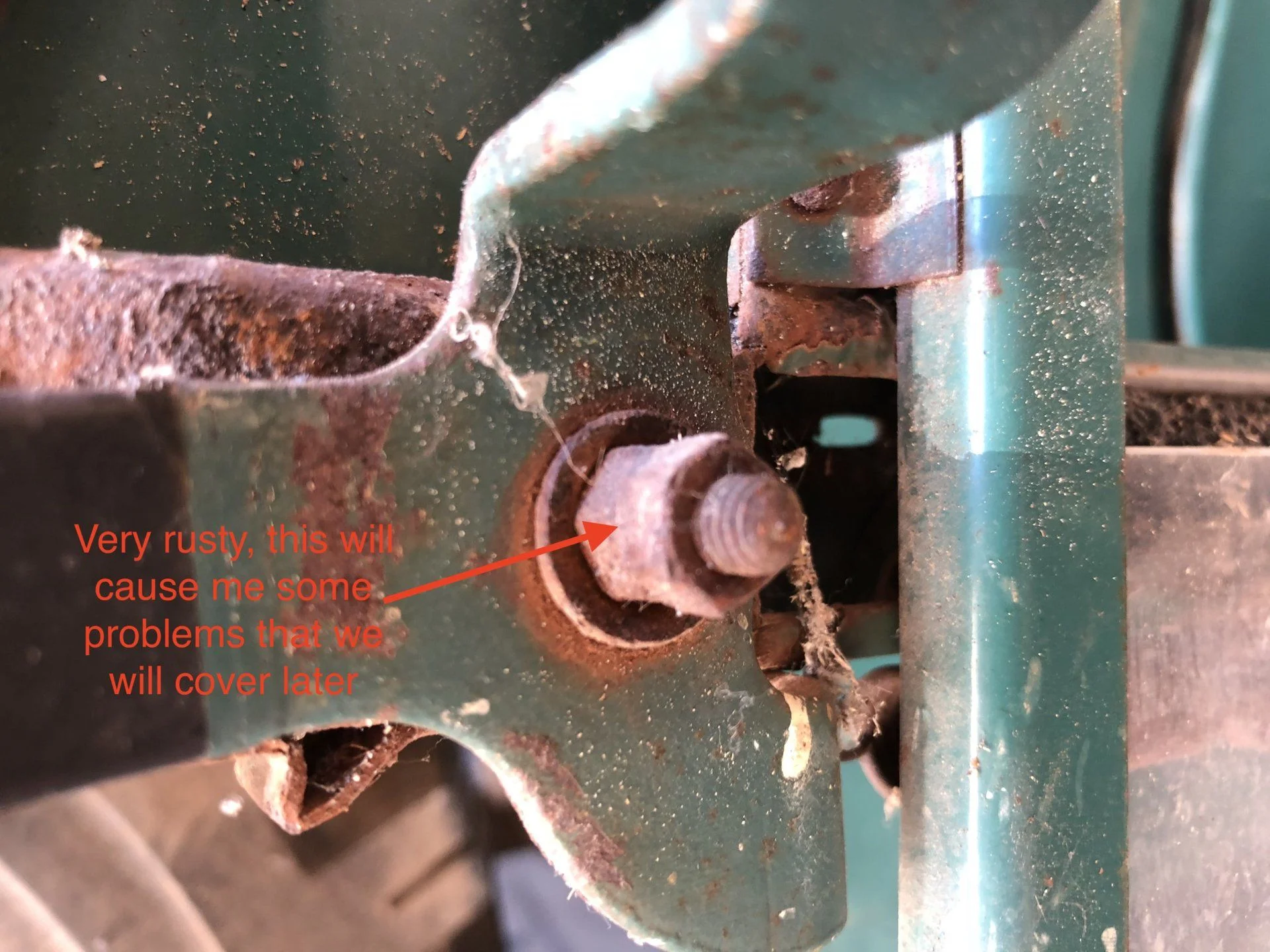

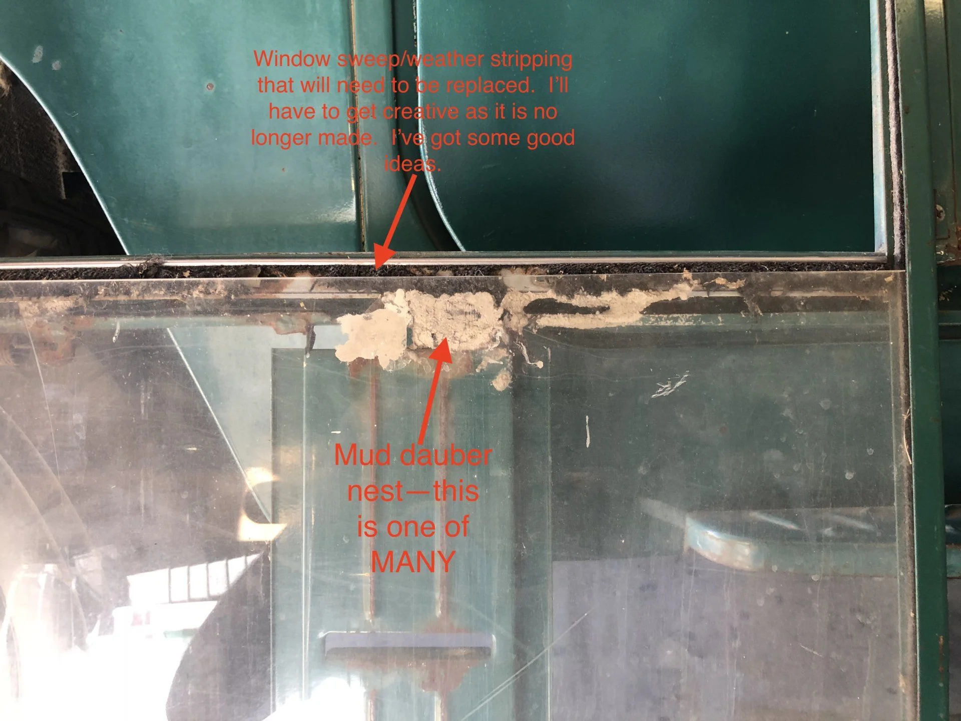

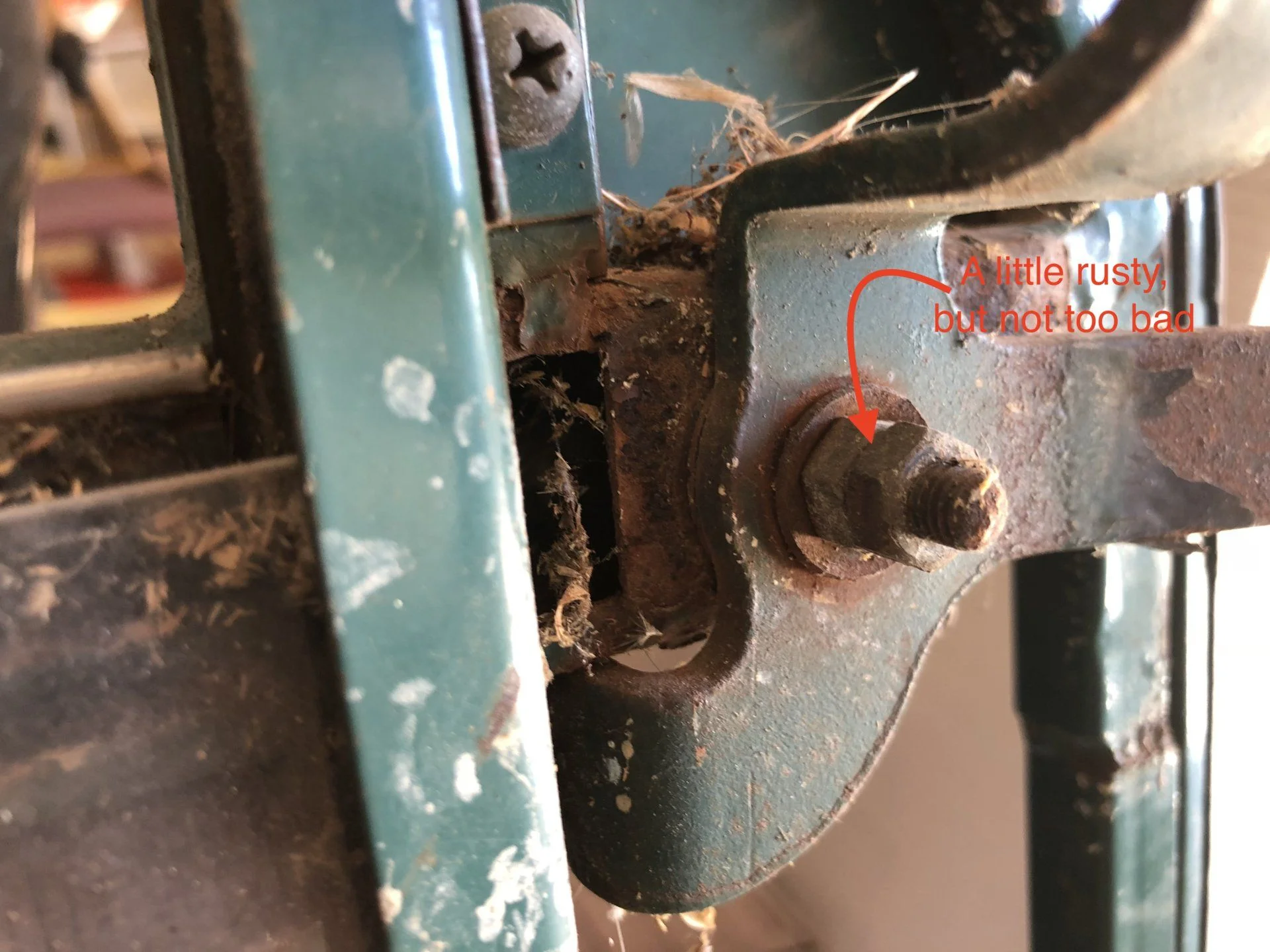

The next several posts are going to be refreshing Marion's original FST/soft doors. I found some decent threads here on Mud regarding this, but none that I found comprehensive so I'm going to try to be as detailed as possible.
Here are the doors as they stood when we acquired them with Marion.

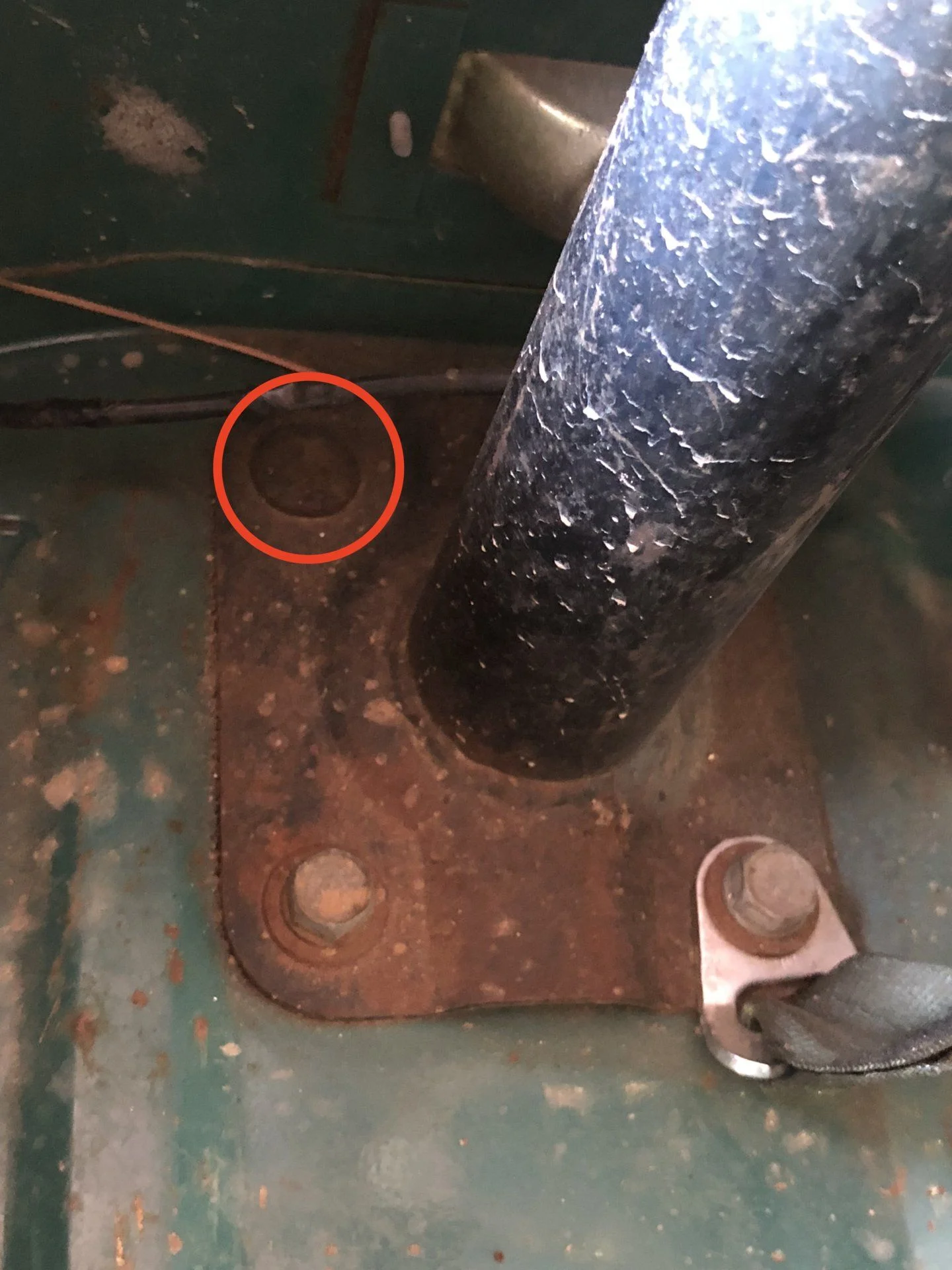

I have started to remove seats to clean out the inside. Also, getting some parts off to get to the powder coater which brings me to a question. The roll cage/bars need to be blasted and powder coated but I cannot seem to get some of the bolts out. I have circled said bolts in the picture below. Each attachment plate has 2 of these and 2 regular bolts. I tried to remove the nuts from the bottom as they look like they come off but my 1/2 inch impacts wrench cannot budge them. Can somebody please tell me how to get these out so I can get this off and to the powder coater.
