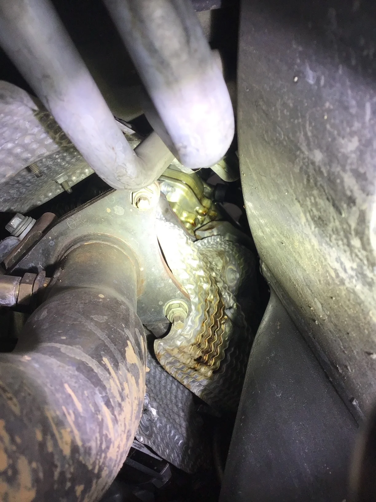

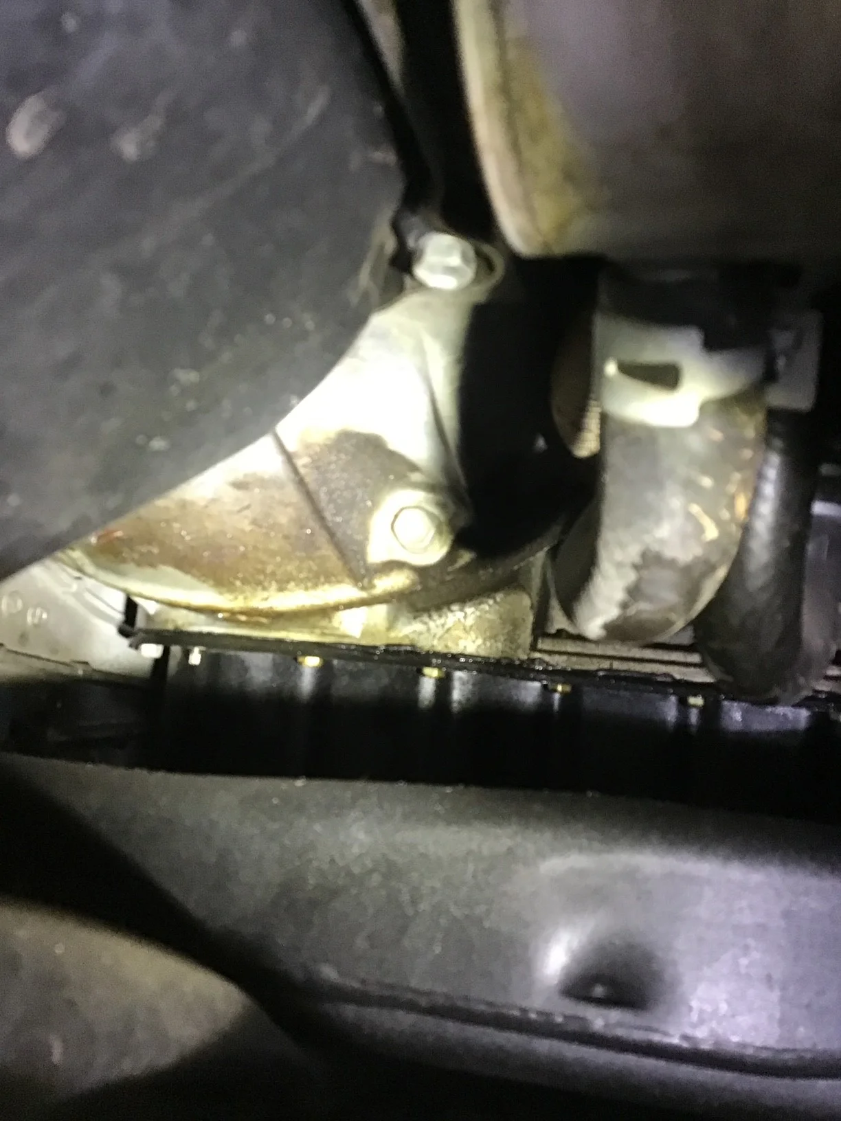

Here is what mine looked like. Super slow and small leak from the bellhousing

I am fairly certain that my 2008 has a rear main seal weeping at 272k miles. It is down less than a quart at 5000 miles, and doesn't even make a drip on the driveway, so I haven't worried about it. A weepy rear main seal will not hurt anything as long as you don't let it run low on oil. And with 8 Quarts, you have a good bit of margin...
Mine looks just like @TLC2013 's picture above
So I had similar leak and had valve cover gaskets replaced and turns out it was cam tower leak. I have yet to address it as it's extremely slow leak. Could this be your issue? Oil running down the block and toward the back?
This is why I come here. Great suggestions, fellas. I'm having the valve cover gaskets replaced and the PCV valve checked. Will get the area cleaned up and then monitor for any additional leaks that might lead to the Rear main seal or Cam tower. I too haven't seen any signs of oil on the garage floor where the LC is parked daily. Also, during the oil service there was the normal volume of oil that came out when drained, so whatever is leaking seems to be very slow.
