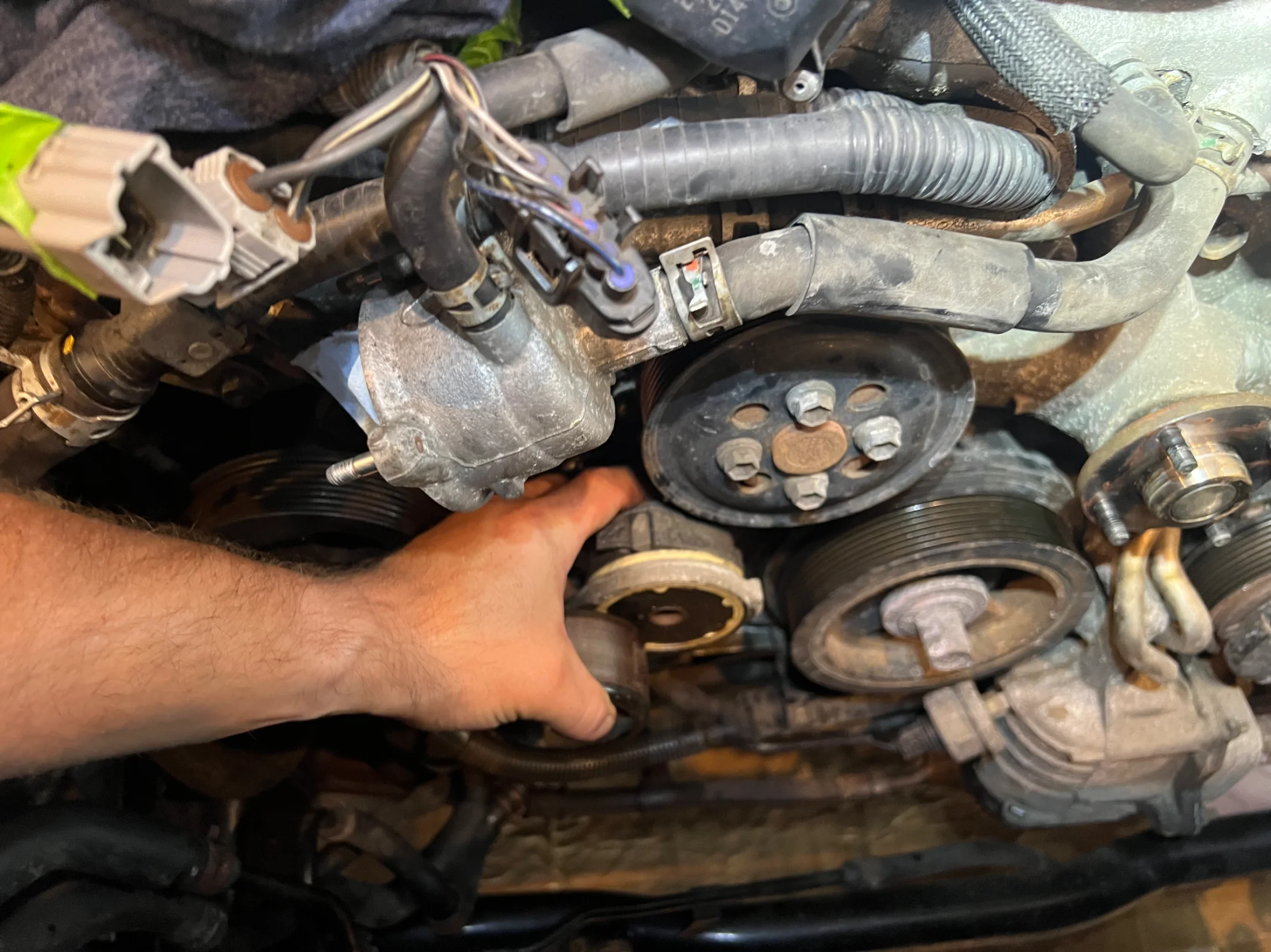

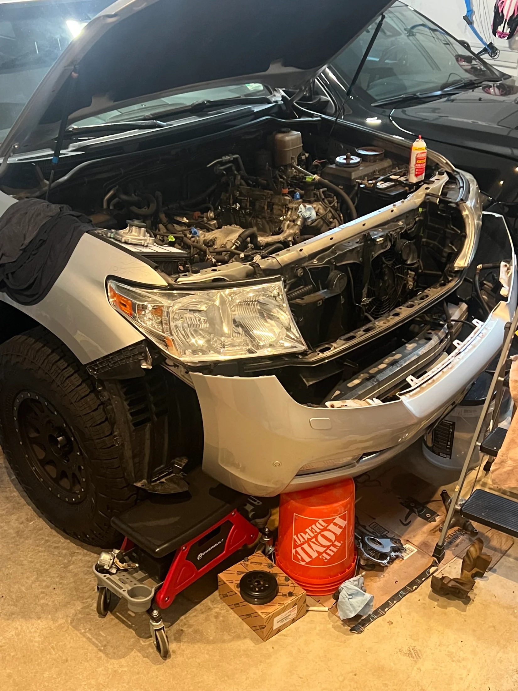

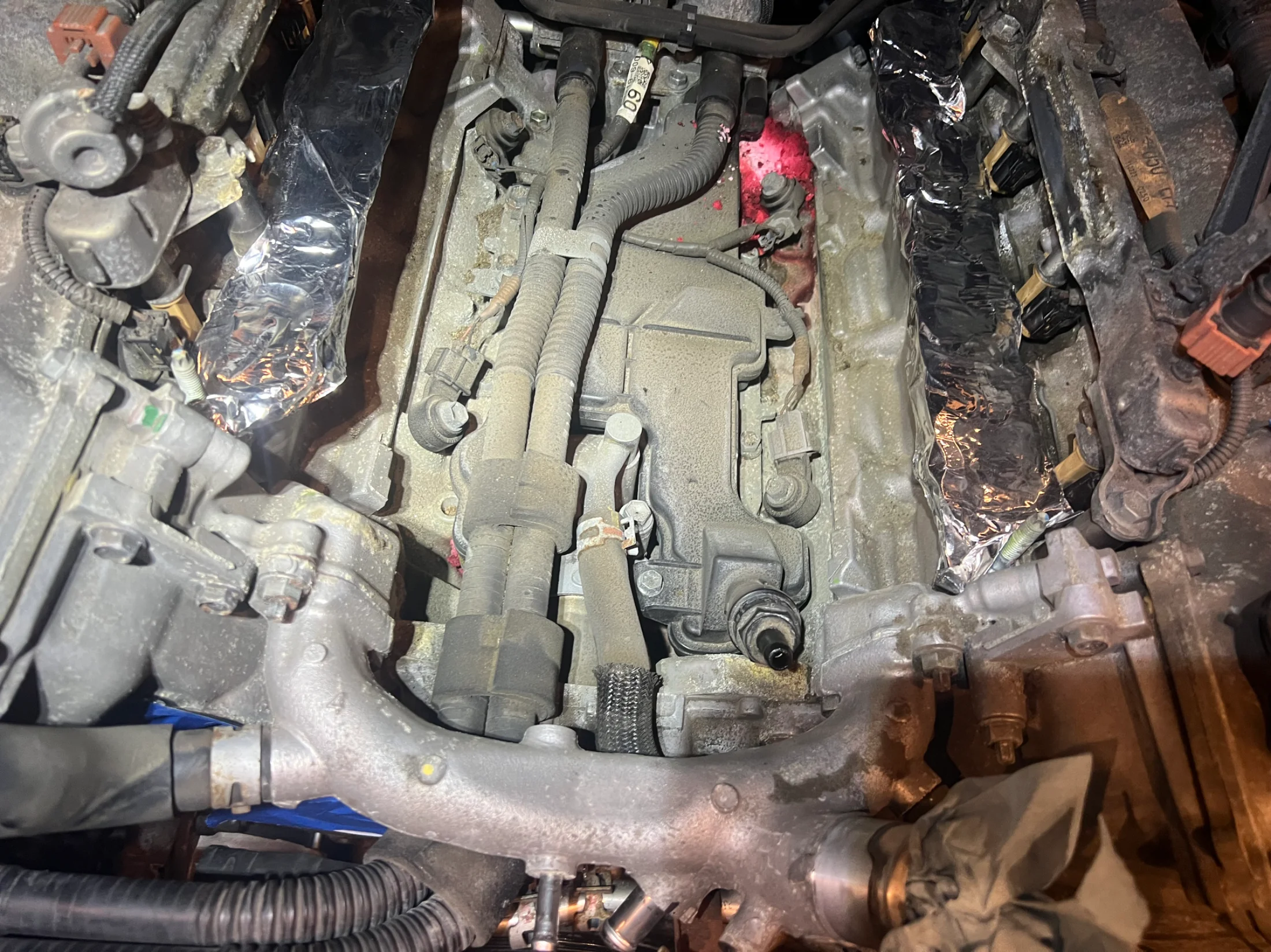

I wouldn’t be here without a lot of your alls valuable input on these threads. TBF I am 1 banana mechanic and a bean counter by trade, so will see how this goes. Day three and I have radiator out along with the dreaded fan bracket, AC compressor pulley (couldn’t figure out bolt and it was locked on) tensioner/idler/thermo/water pump/ Passenger side wiring harness, Heater Ts, Manifold, PVC, Secondary Air and Fuel injectors.
On fan bracket and the 2 metal coolant tubes that are bracketed over; I didnt see this in any of the YT videos or posts, but what worked best for me was to remove the thermostats housing, which allows the coolant pipe with the small hose to come off easily. You can then move those pipes out of the way no problem.

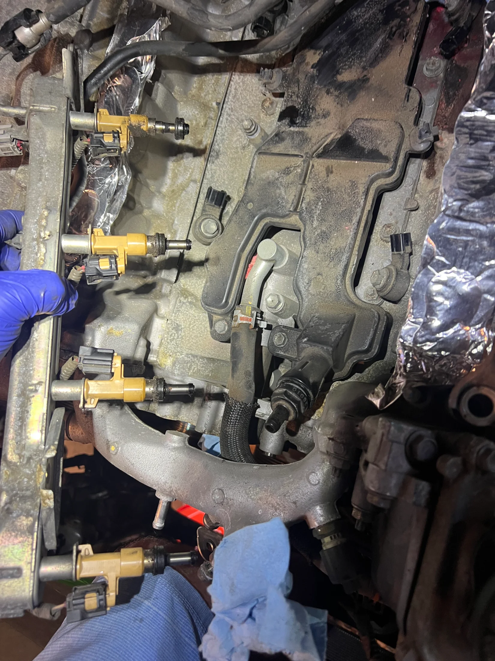

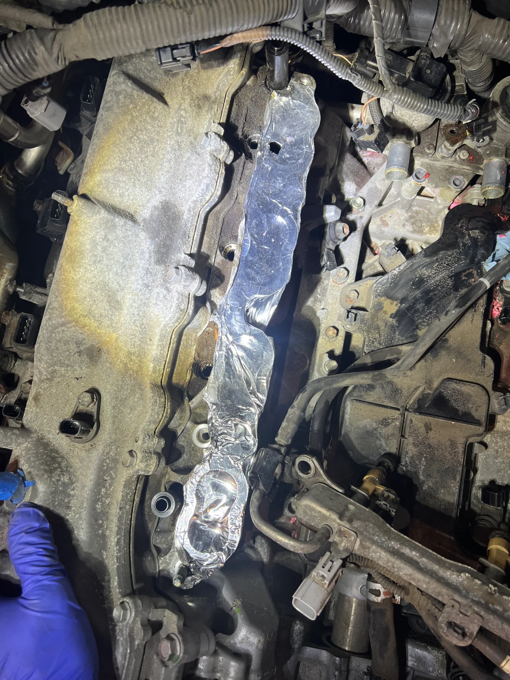

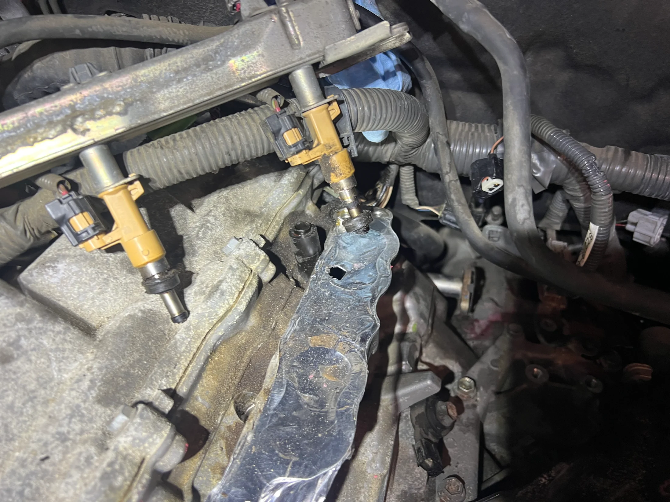

1. First being best way to clean fuel injector ports into block. Also carb cleaner on the fuel injectors them selves to clean gunk? I am going to try and plug and clean around but a ton of gunk (infestation and grim) and trying to not allow stuff to fall into the top of the heads. Anyone had to do this in the past and any suggestions?
2. Should I really replace heat exchanger as Carcarenut suggests, as seen in pics I had very sizeable leak? I saw a lot of folks elect not to do that in the threads.

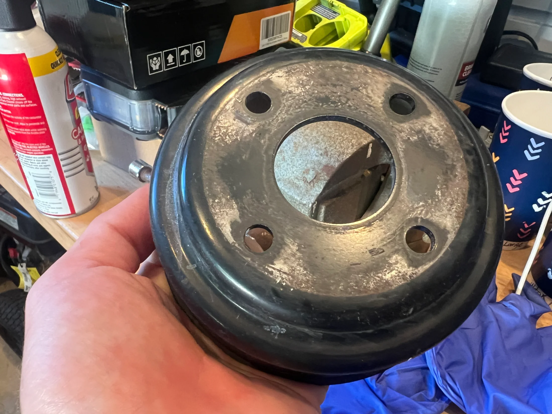

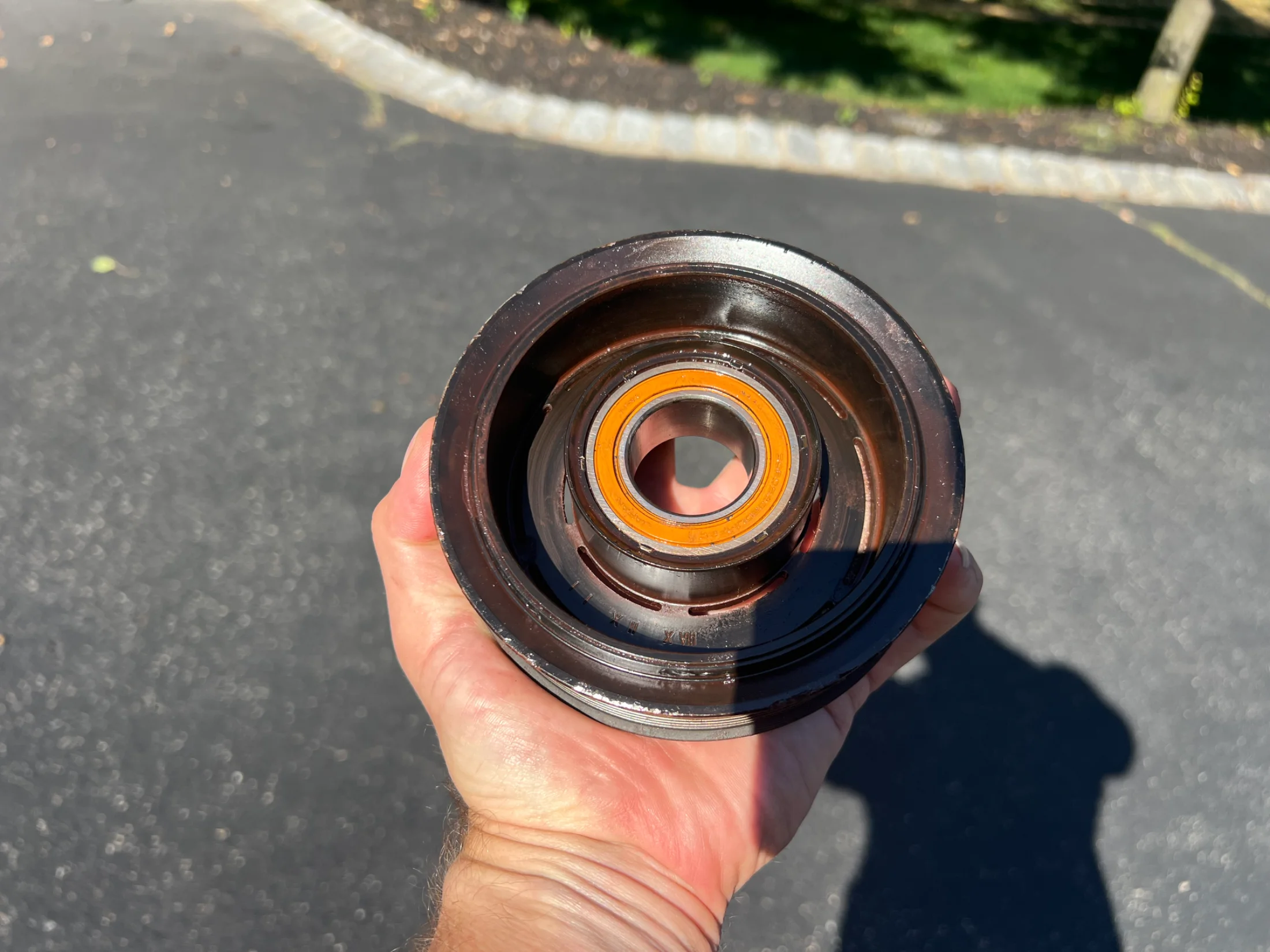

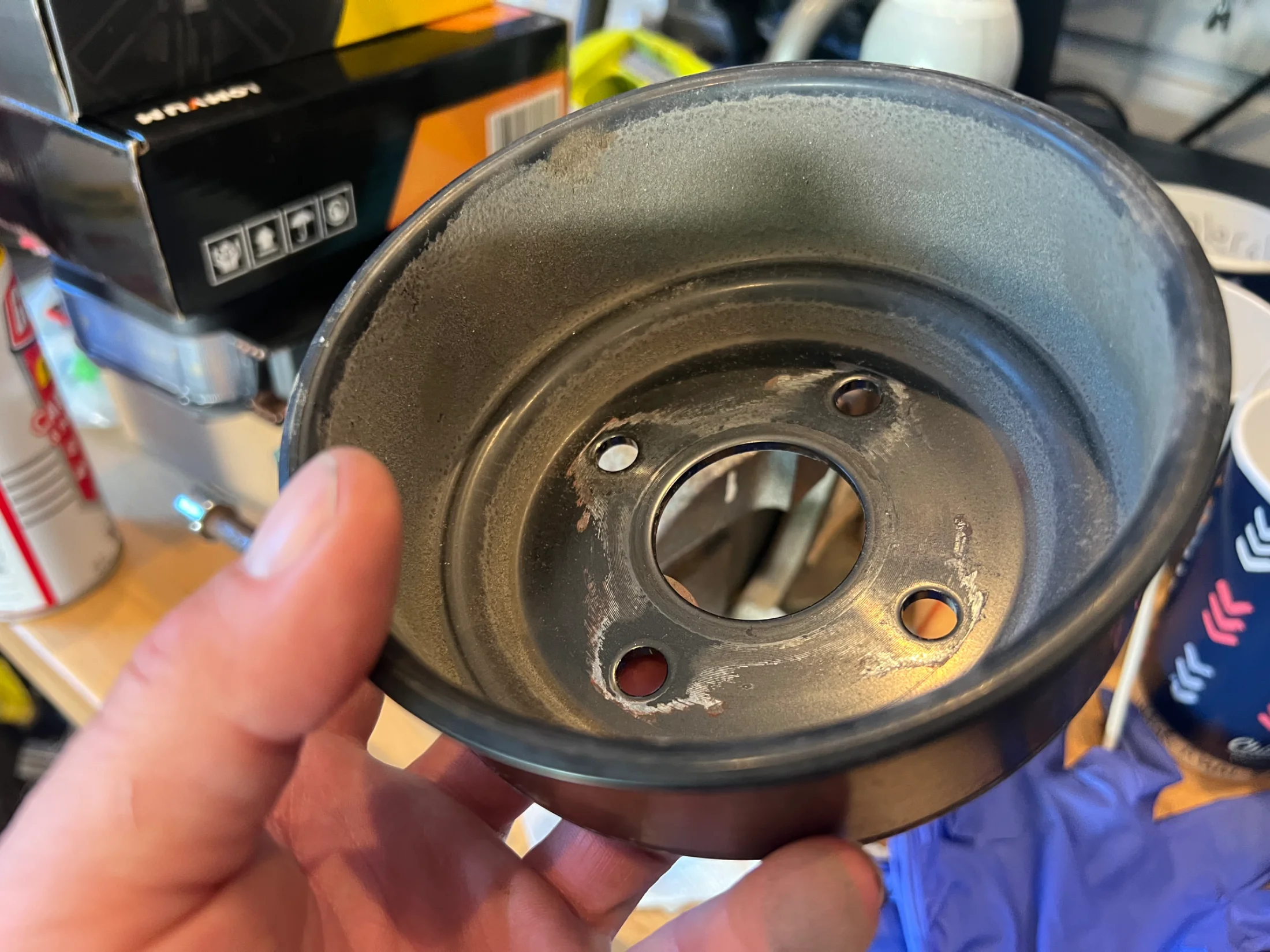

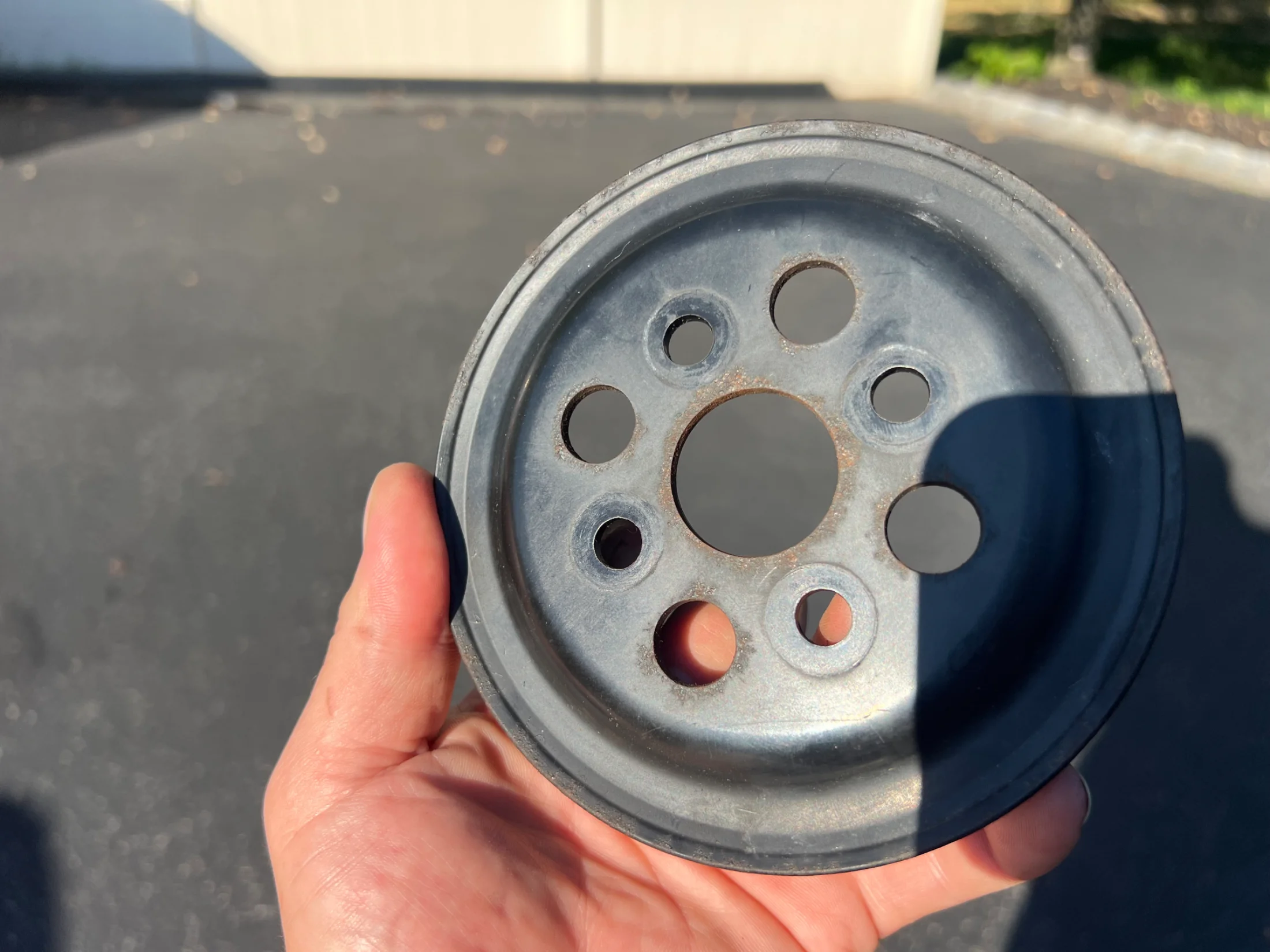

3. Pulleys for water pump and AC are bit rough some minimal rusts, just clean up. Maybe treat rusted area or replace?
