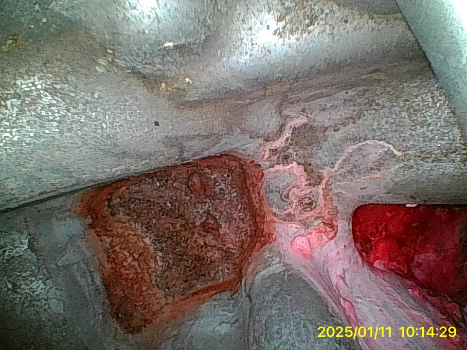

FWIW: I use a borescope to inspect for Valley plate leak. I've only inspected about 1/2 dozen so far. Ranging from 2008-2016. All leak!
Borescope inspection, 2016 two weeks ago:
Any chance you can share the best place to put the borescope when looking for the valley plate leak? Pictures would be super helpful for us vocabulary challenged folks.
