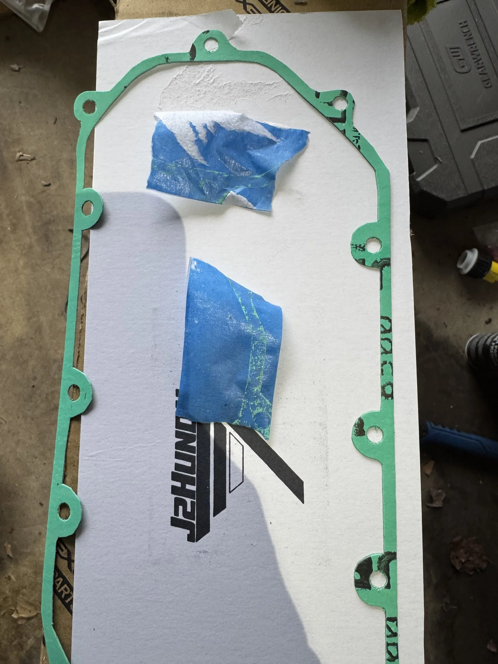

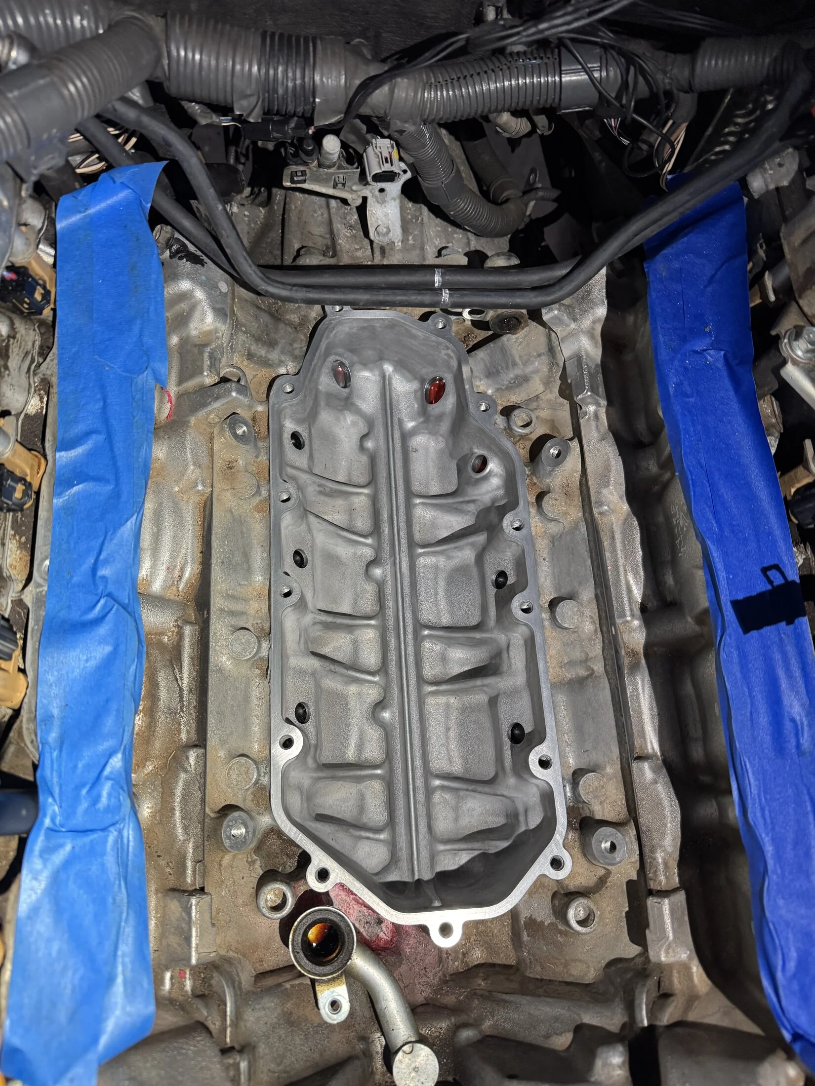

Here was my prep for the install.
View attachment 3862504View attachment 3862505

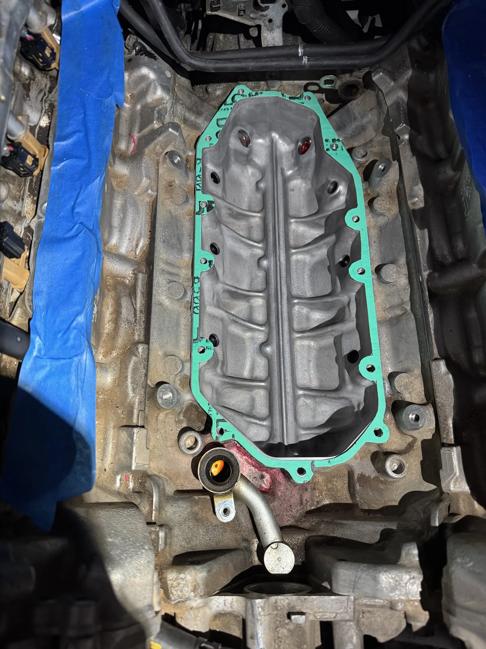

And then the gasket install:
Once I put the cover on I used a centering punch to make sure the holes in the gasket lined up with the bolt holes as closely as possible.
And then the aftermath.
