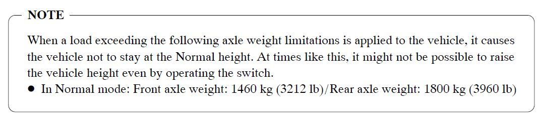

You may be over weight. Do you have armor? According the the AHC doc the front axle weight can't exceed 3200 lbs and the rear axle can't exceed 3900 lbs. I don't recall the exact weights...I'll have to look it up. The doc does mention the AHC may not work if those weights are exceeded.
Just a thought. I'll dig up the details....
This is the note I was referring to. Looks like it only mentions raising not lowing.

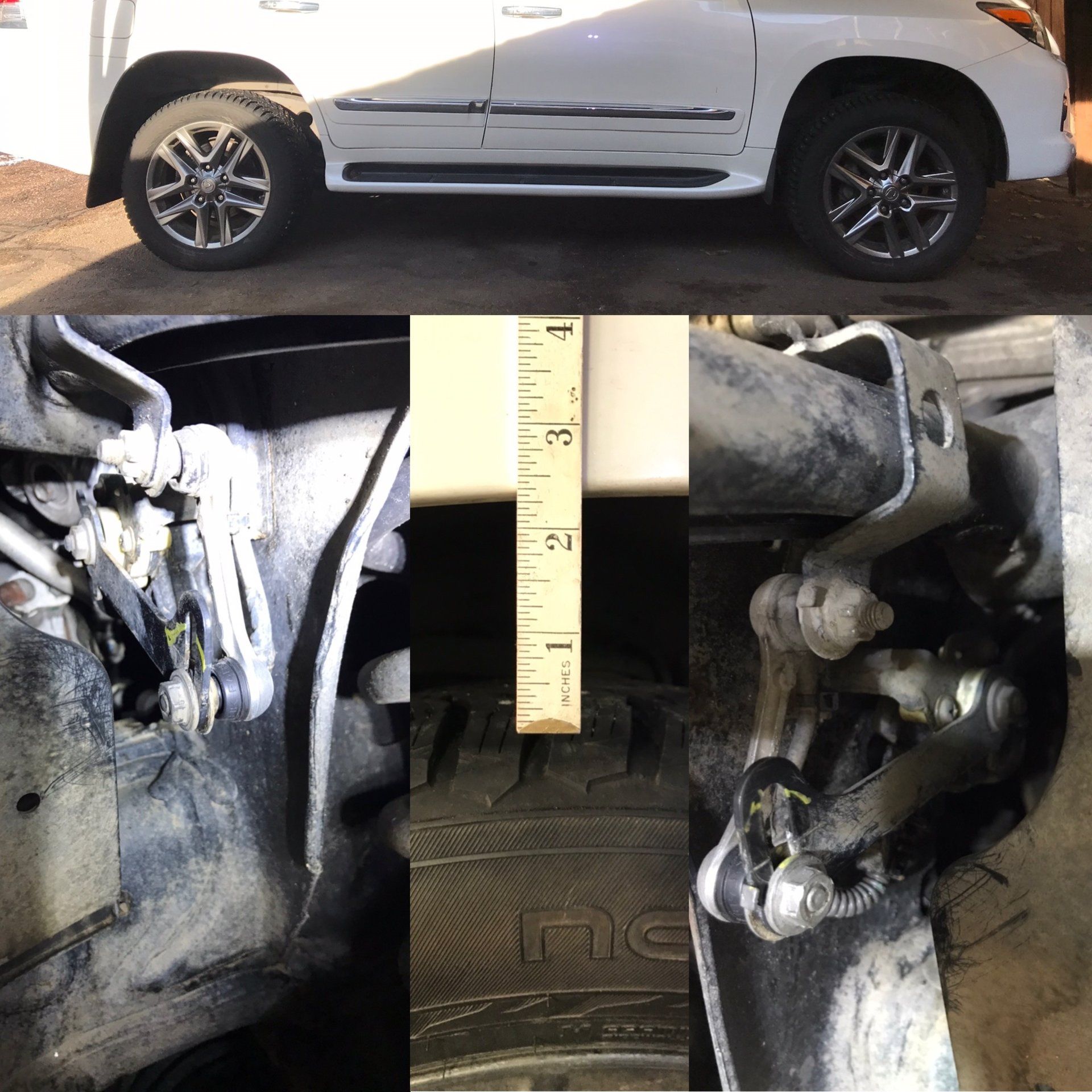

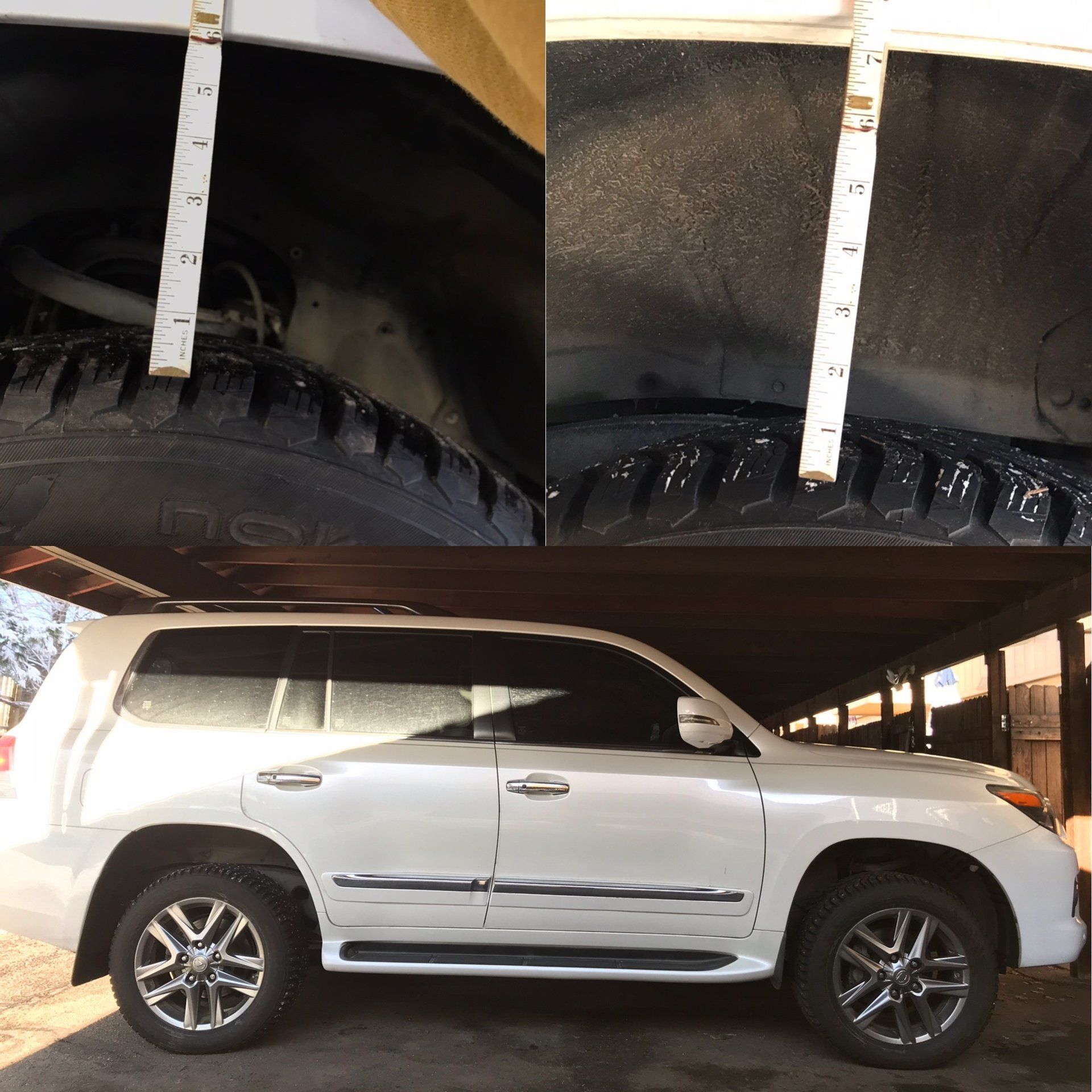

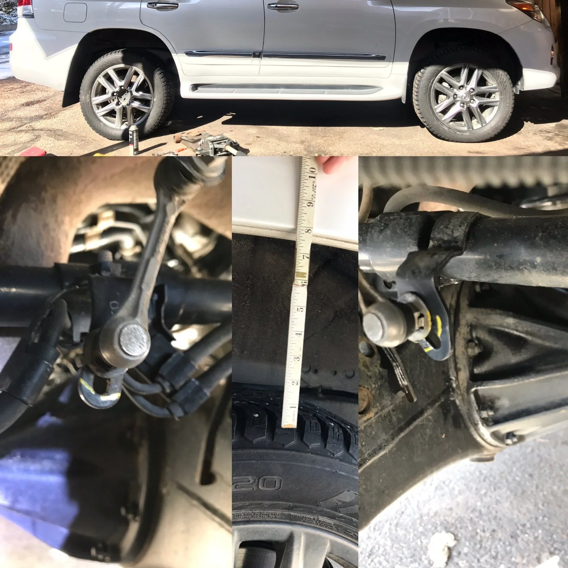

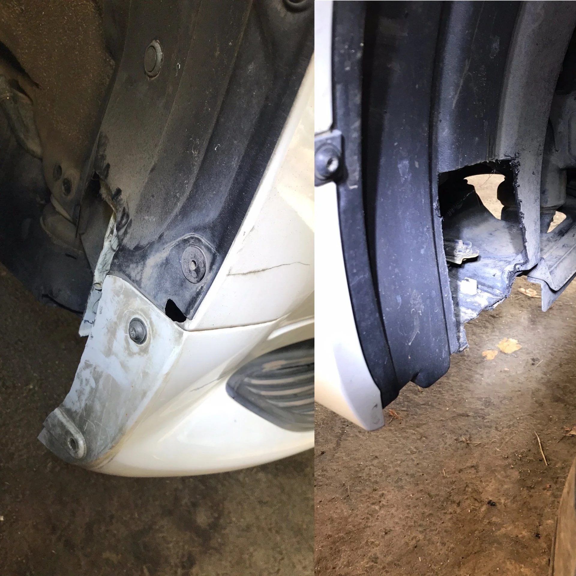

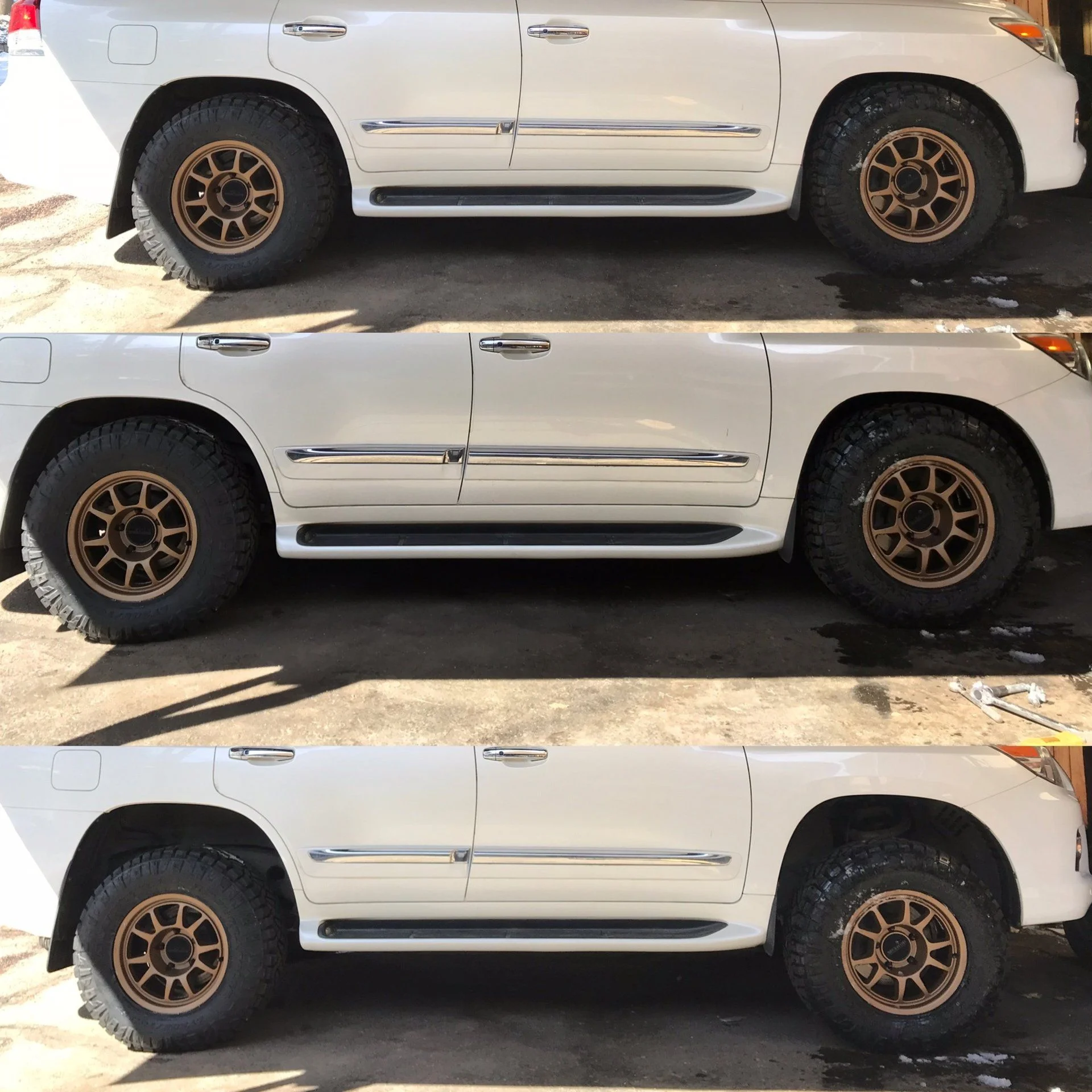

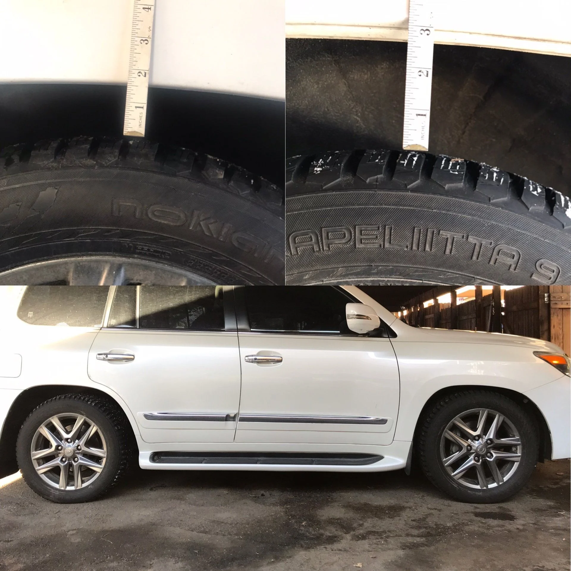

First, thanks for all the info and help from these forums. I finally got my wheels and tires. I had some time to take some pictures. The measurements are not accurate by any means. 1st picture is stock with LO setting. 2nd is stock with HI setting. 3rd is front AHC mod on HI setting. 4th is rear AHC mod on Hi setting. 5th picture is trimming I had to do for front without rubbing on LO-N-HI. And Last picture is with the wheels on LO-N-HI settings. Im running 285/70/17 Ridge Grappler. Tires sticks out about 3/4" inch from fender. As for AHC mod, I painted what the OEM spot was. The rear is easy as well, you just gotta take the wheel off.
Looks great! Not that it matters now, but you could have moved your front liner forward without having to cut them. Also, you can get another 3/4" with the height offset utility.
