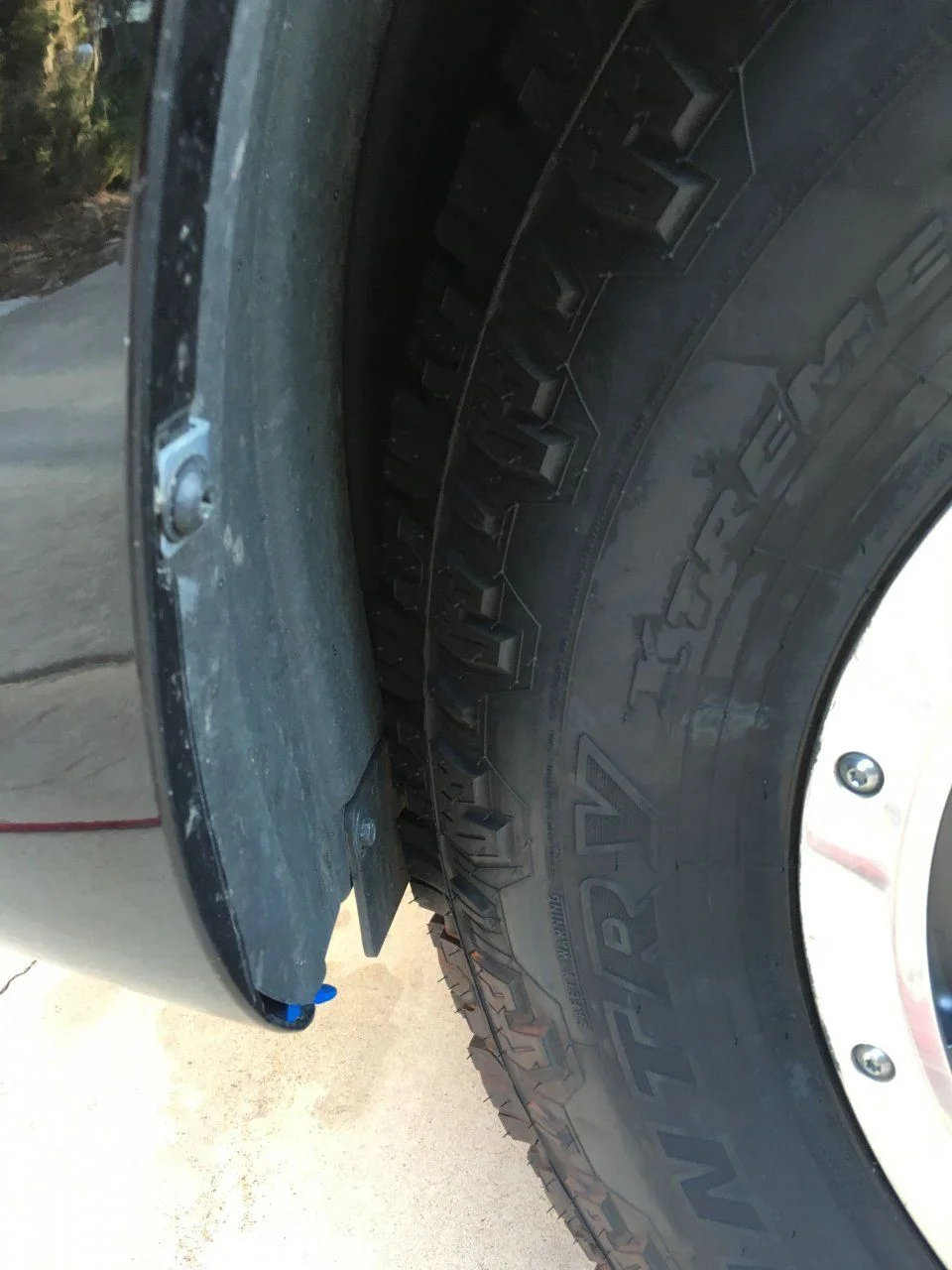

Lifting IFS doesn’t allow for bigger tires. You’ll want to make sure that you clear your tires in low mode.
You can easily fit 33’s with simply moving the liners and removing mud flaps.

Yes, I would say your conclusions here are accurate. One thing to note is that there are a variety of widths you’ll find in those diameters you mentioned but in general you are correct.
Going from 33-34” would mean removing the mud flap in addition to the modification of the front of the inner liner in my experience. Again, depending on width of tire and offset of wheel. Going to 35” means following TeCK’s advice.

None of that is true. Ride quality is basically unchanged with adjustment. You didn’t need that or a strut spacer to run a 34” 11-ish wide tire. You will need a wheel offset between 25-40mm and to remove the front mud flap. The fender liner mod really depends on tire. I didn’t need it for mild AT like falken but did when I went to a mud terrain.

I managed a 275/65R20 before any sensor lift, if I am remembering the order of everything I did correctly. I had to move the front liner forward and remove the front mud flap and I also have a 3/4" Bora wheel adapter, although I don't recall if it is necessary.
