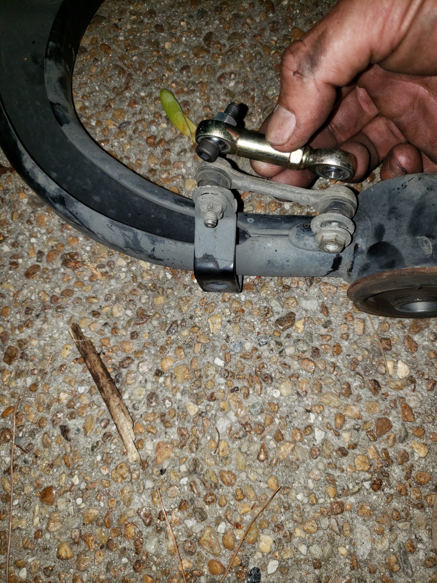

I'm toying around with mine a bit. Actually relocating the connection rod up 1in tapped into my billet uca. I used a 1/4 in hiem hoint. Essentially by lifting connection point (or with stock arms simply adjust the hiem that much shorter than stock connection rod) you move the range of motion in the AHC. Thus ride hight can be moved above allowable parameters. Of course at this point uca and diff drop should be necessities. Down side of this is that ride hight is now that much closer to full droop (what we call pogoing). The solution is moving the shock mounts up and or add strut spacers. This moves the shocks range of motion to be centered with ride hight which in turn corrects excessive AHC pressure. Now to do the same in the rear!!!!

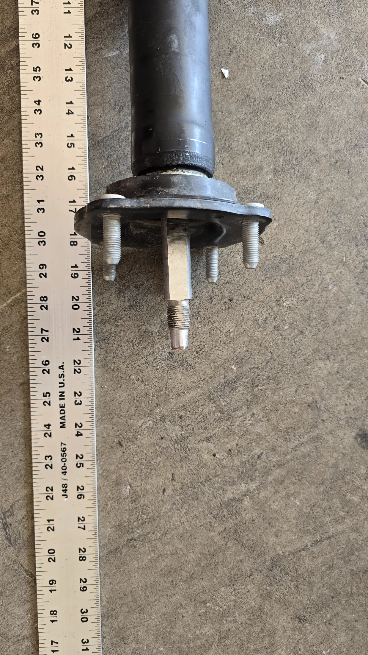

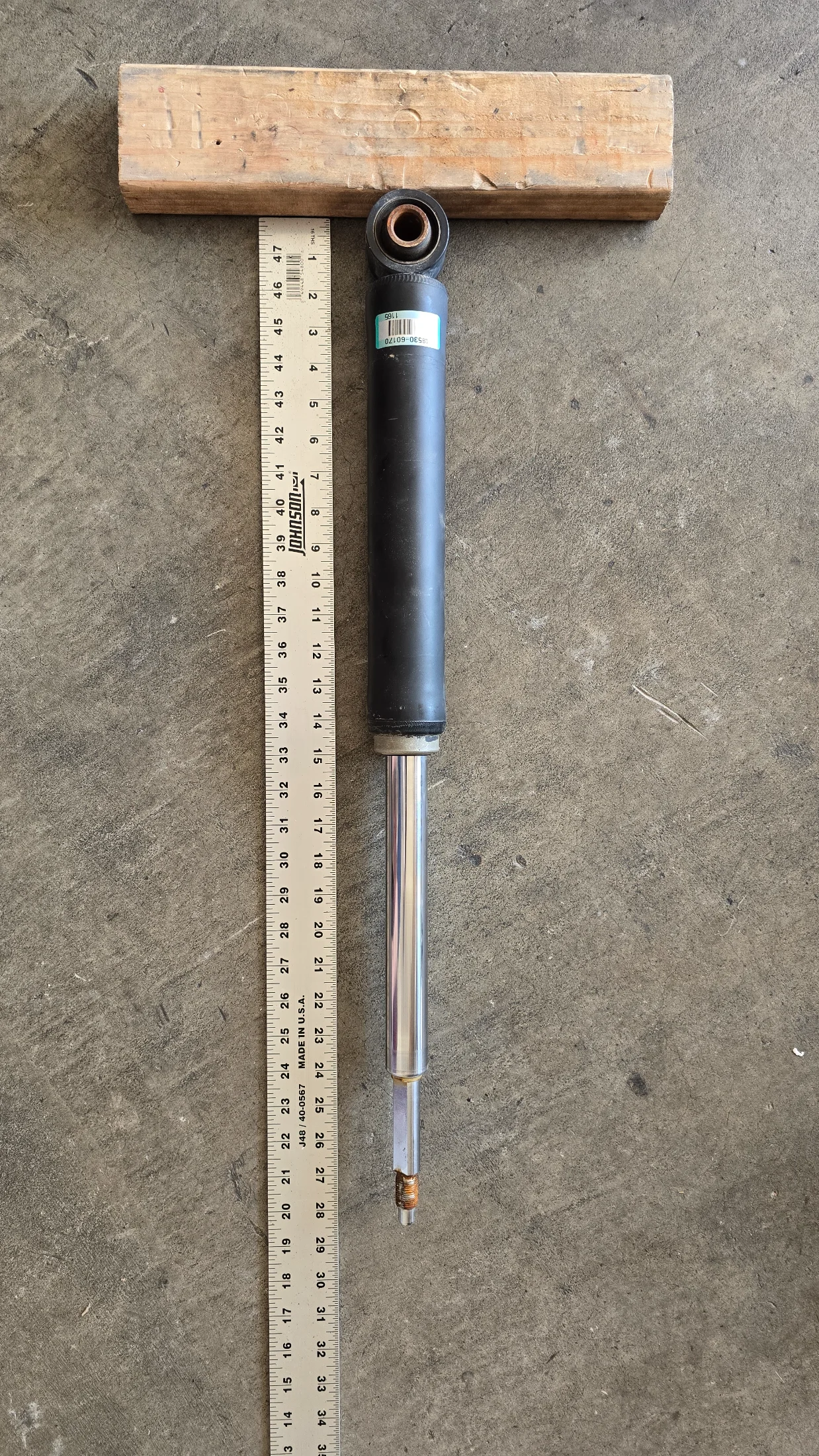

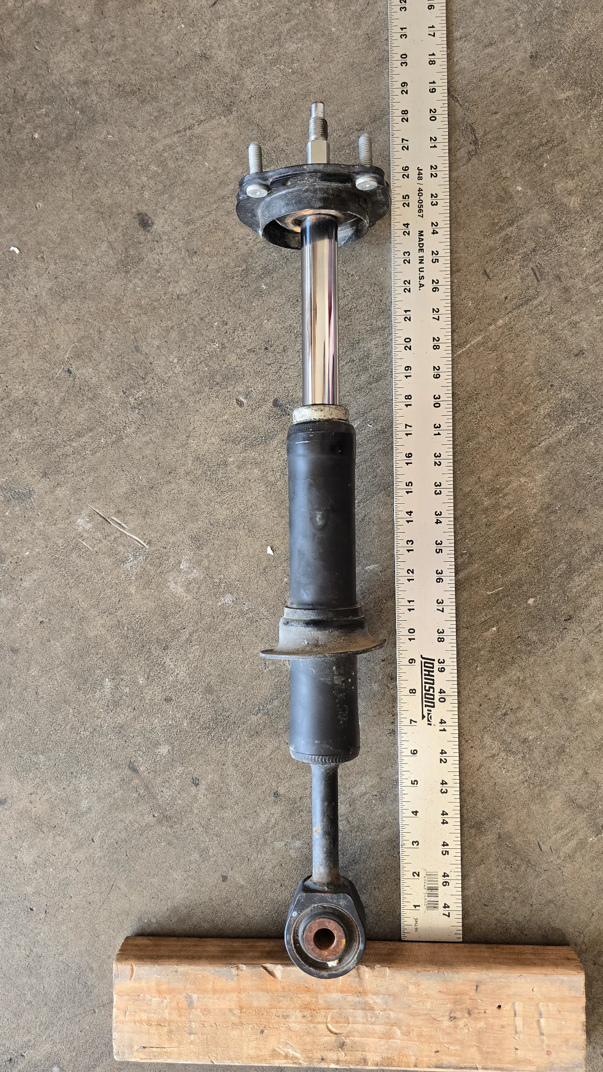

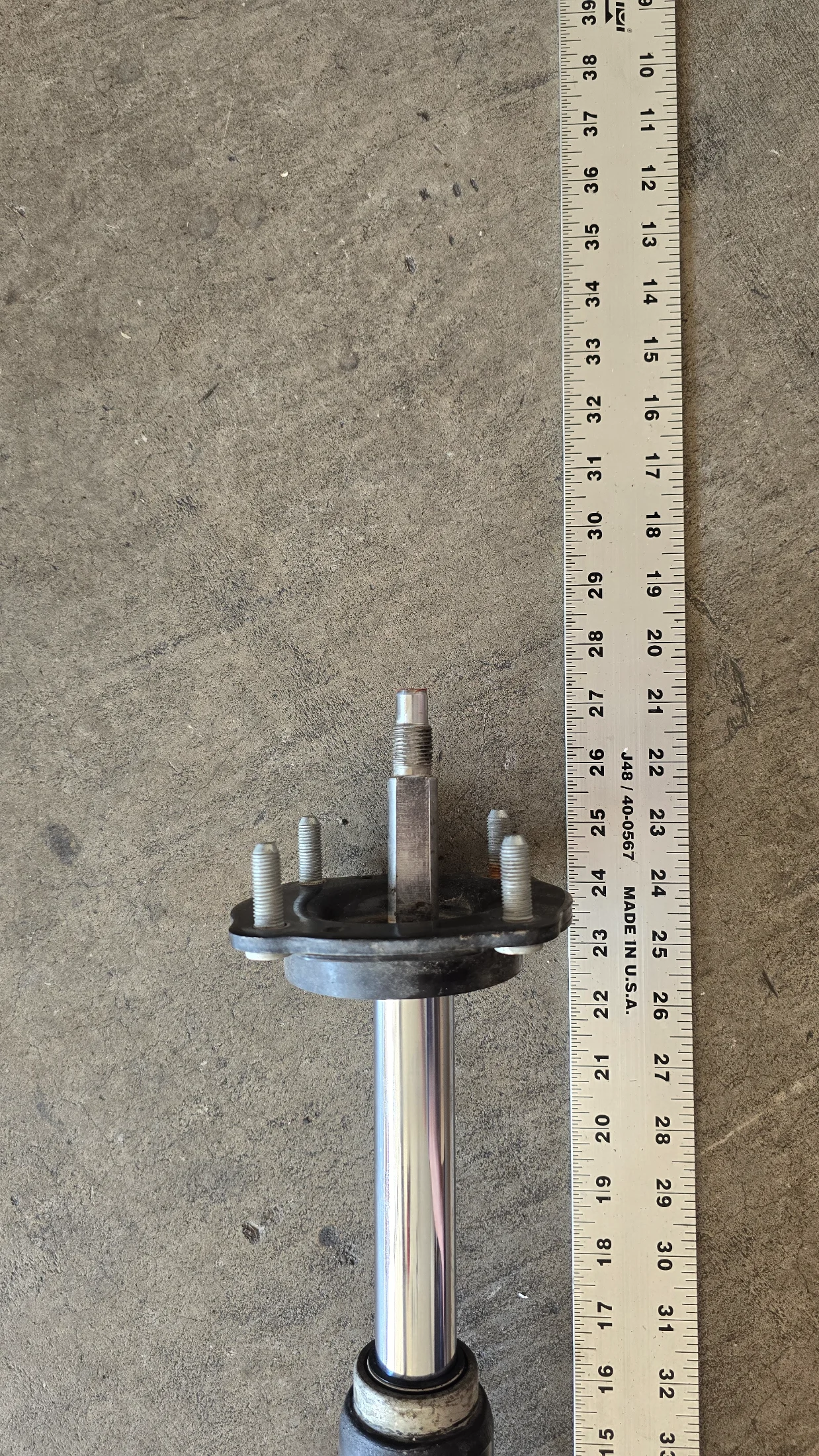

Does anybody know the stock Lexus AHC shock compressed and extended lengths for the front and rear?
Chris
I can get you that info tomorrow, if no one else has it written down.
Chris
I believe it's posted by @TN LX570 somewhere in the AHC long travel thread. IIRC it's a spreadsheet screenshot he posted.
Front 20.5" collapsed 27.25" extended 6.75" travel
