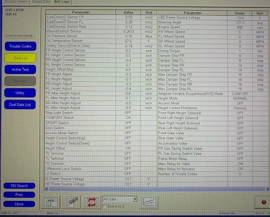

I only moved the front sensors up to even out the rake, and ever since I've noticed the rig abruptly drops when the system decides to auto-level. I skimmed all 14 pages of this thread, and didn't come across anyone having this issue.
Should I go ahead and lift the rears to see if that evens things out?
Also, has anyone played with the "height offset utility"? is this a way to perform a sensor lift without actually moving the sensors?
Here are the relevant readouts in techstream (lo, hi, normal)...
Mine is like this too. Always has been. Perhaps you are more sensitive to it post adjusting?
Did you ever figured out reason why it drops abruptly? Im asking because mine is doing that but only when I am in High. I have not done sensor lift yet.
