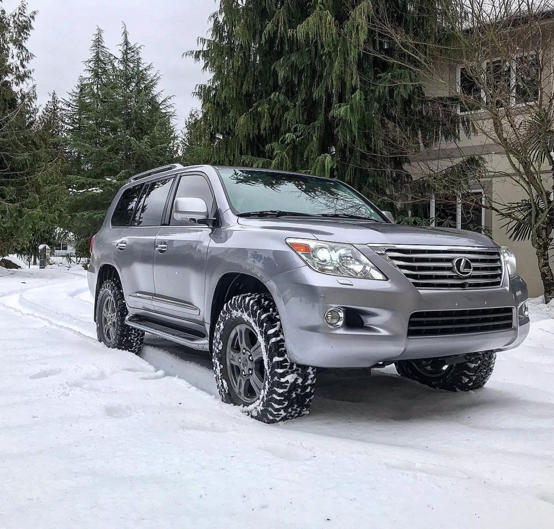

Here are 285/75R18 Nitto RGs on Tundra wheels with 1.25" spacers. I want to change the Toyota bean logo to the Lexus logo which can be done with some cheap Lexus center caps. I too would like sliders but they are not in my budget anytime soon. I don't think I'd do a low profile winch bumper since I haven't seen one I like. I was thinking even more sleeperish and going with a Trail Tailor hidden winch mount. That with some front recover points and I'm happy. Maybe a roof rack :rolleyes:.

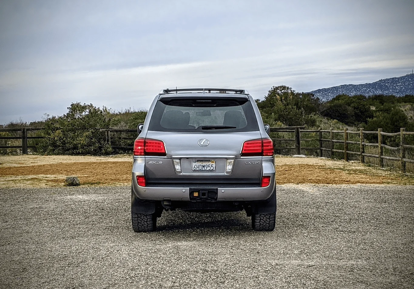

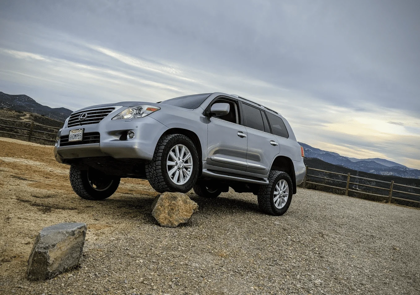

Succumbed to the voices in my head telling me to lift. Or was it all y'all?
Did a mild sensor lift. Paired with install of an OEM front leveling spacer to make sure I can maintain payload capacity to tow heavy. Along with existing 20mm spring spacers at the rear.
EDIT: spacer part number - 43136-60020
I opted for a mild lift so I didn't max my adjusters. Increase of .75" front and .5" rear was the target. To remove a tad of rake. Balance to maintain as good of suspension geometry as possible as I do enjoy driving hard on tarmac, while getting a bit more obstacle clearing lift.
Measurements from center of hub to fender (net lift from stock):
Front (lift)Rear (lift)
Stock AHC "N"19"20.75"
Stock AHC "H"21.0" (2")23.125" (2.375")
Sensor Lifted AHC "N"19.75" (0.75")21.25" (0.5")
Sensor Lifted AHC "H"21.75" (2.75")23.625" (2.875")
Sensor Lifted AHC "Extra High" (projected)22.5" (3.5")24.375" (3.625")
Max droop (with OEM spacer)25.5"-

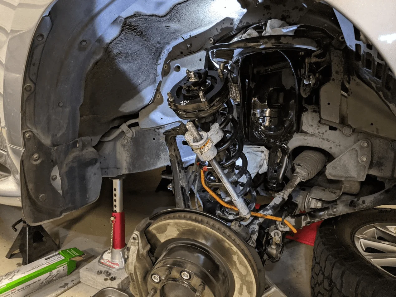

Hi, could you please share instructions on how you fitted those OEM front leveling spacer? I purchased a pair already but I am quite worried about AHC line disconnection. How to make sure no air is introduced? A simple AHC fluid flush afterwards would be enough? My concern is about air remaining in the shock absorbers. Maybe I am being over cautious... :)
You need to depressurize before disconnecting the shock or you’ll get a face full of fluid. A simple bleed after would ensure no air. You may need to top off your reservoir.
