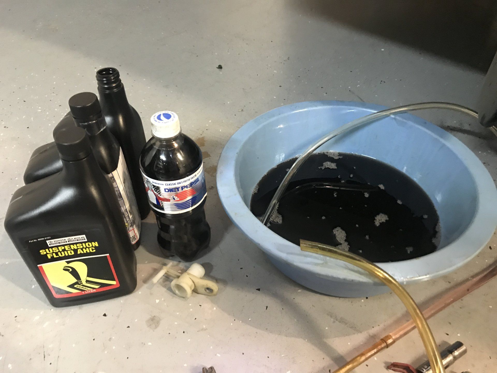

Using this very thread I just preformed the 60k maintenance on my 2008, flushed 5l of fresh fluid into the system. It's really easy. Rides great, actually just completed a 1500 mile trip over 5 days and couldn't be happier with the truck. Here's what my fluid looked like.

I do mine every 30k since I tow and do a lot of off road. When I did mine at 30k the “new” was red and the “old” looked like old black motor oil. Others on this thread have said the same. I don’t have any evidence behind it but would guess that not changing it would cause more pre mature failure than much of a noticeable difference in day to day function. I’m about to do mine again at 60k last time it took me 1-1.5 hrs and was easier than bleeding breaks.
I wonder what makes it blacken and break down. Moly in the assembly going into solution? Oxygen or water absorption? Heat? It's essentially hydraulic fluid under pressure, so just curious.
My theory was dirt working it’s way in through the seals. Here in Alaska we have the super fine glacial dust everywhere (even in my house). I avoid driving through glacial plains at all cost. The guys I know that do in their off road rigs change fluids yearly and rebuild diffs regularly.
I did my AHC fluid at 57K and did not get black fluid, though it was discolored, like old brake fluid.

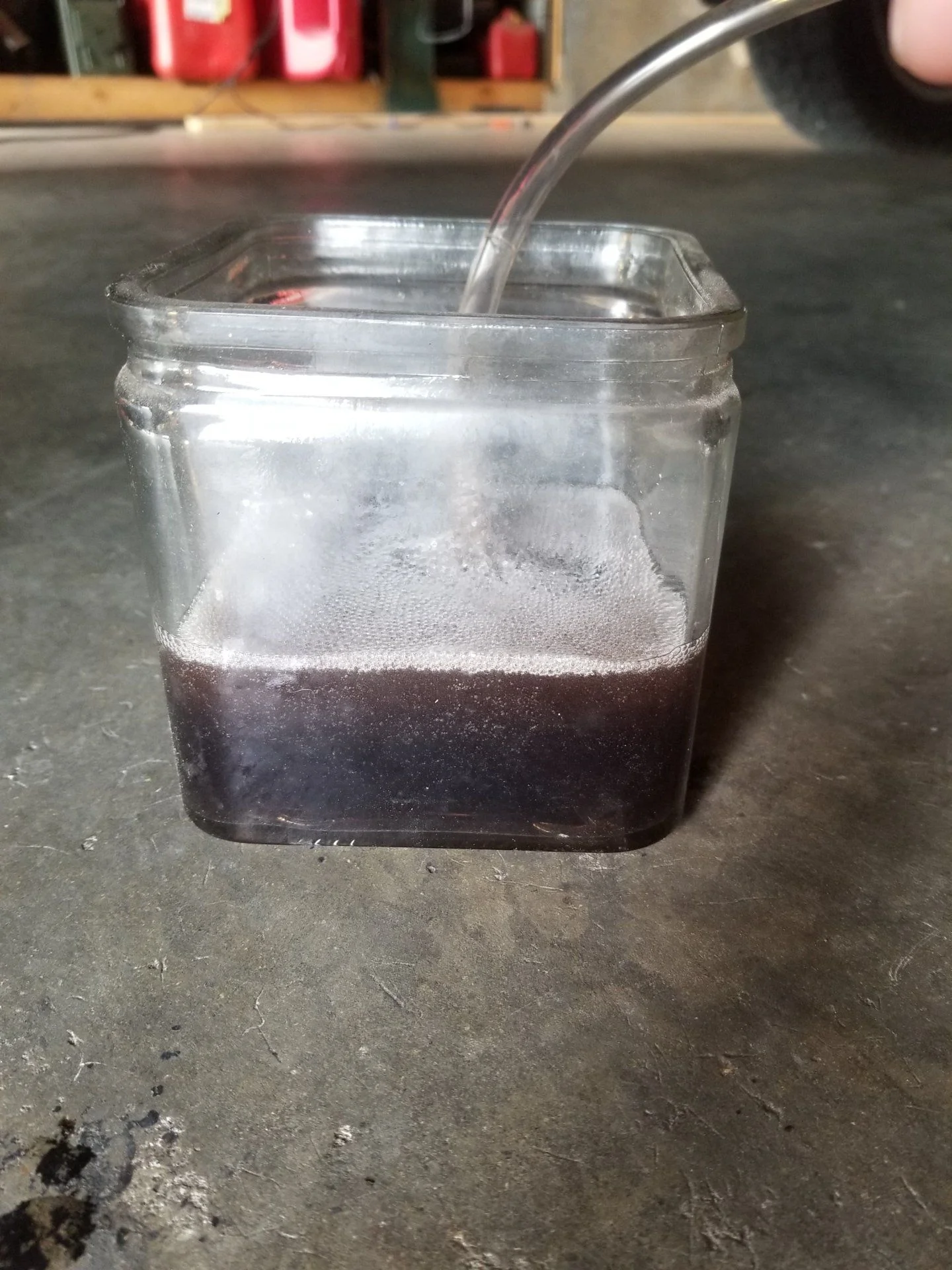

EDIT: Vacuum almost all of the old fluid out of the reservoir and replace with new before bleeding.
I used the bleed procedure; however, at each corner and with truck off I bled the body down until it stopped, tightened the bleed screw, ensured there was plenty of fluid in the reservoir, turned the truck on, gave the AHC time to get everything back up to Normal, and repeated until I saw fresh fluid bleeding out. Then I stopped and moved to the next corner.
Additional note: I was surprised to actually see air bubbles bleeding out with old fluid. Didn't expect that.

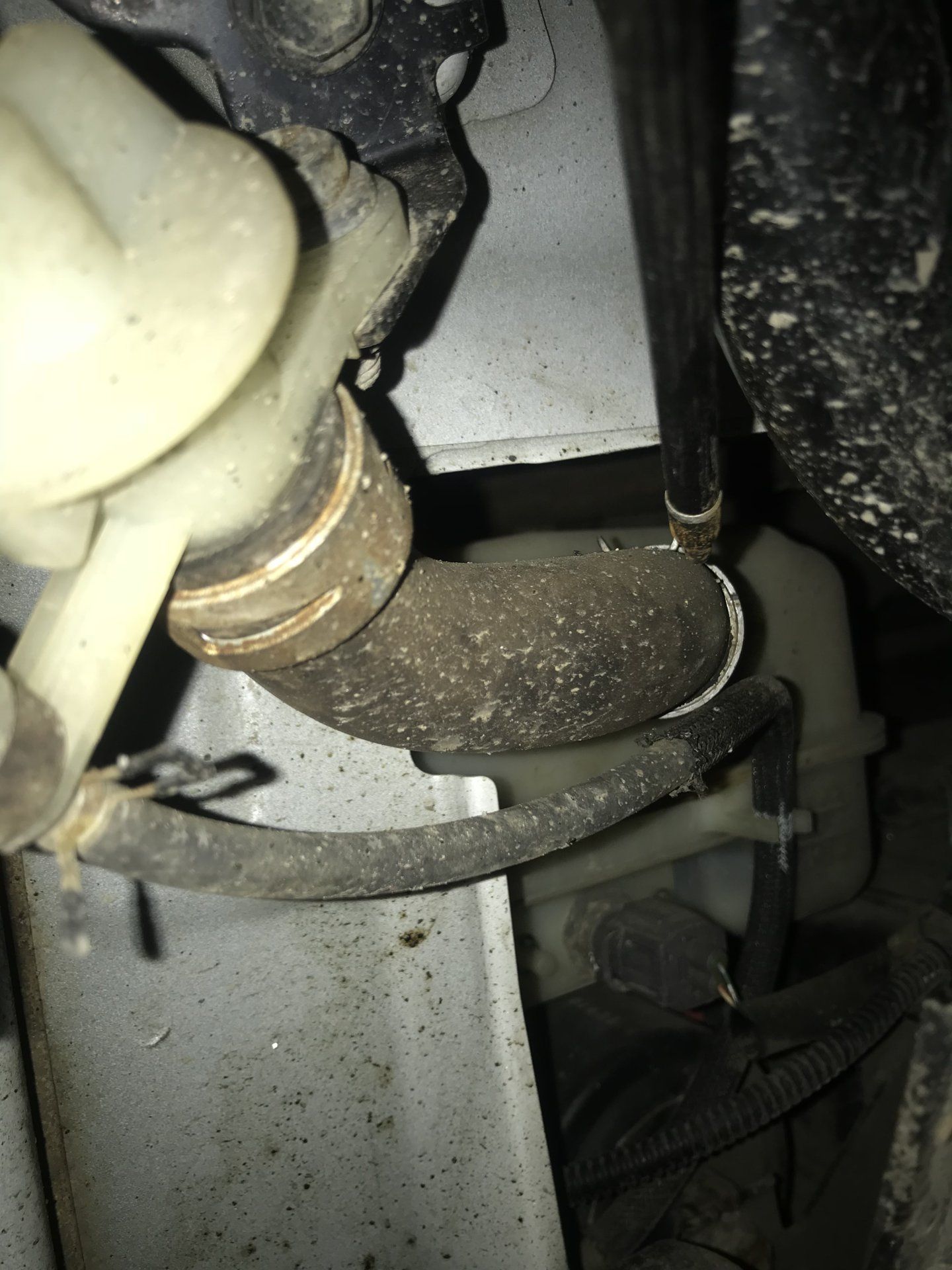

Are you able to vacuum the old fluid out after removing the cap with the wings? Or do you have to remove the filter assembly too?
What size tubing fit on your vacuum pump?
No there is a screen under that white cap. I removed the black hose at the hose clamp pointed to with the arrow (yes field point, it was near by) and vacuumed and filled from there. Each time I filled I just slipped the hose back on over the nipple before I started the car to let it re level without re setting the hose clamp. Then slid it back off to add more fluid as needed.
