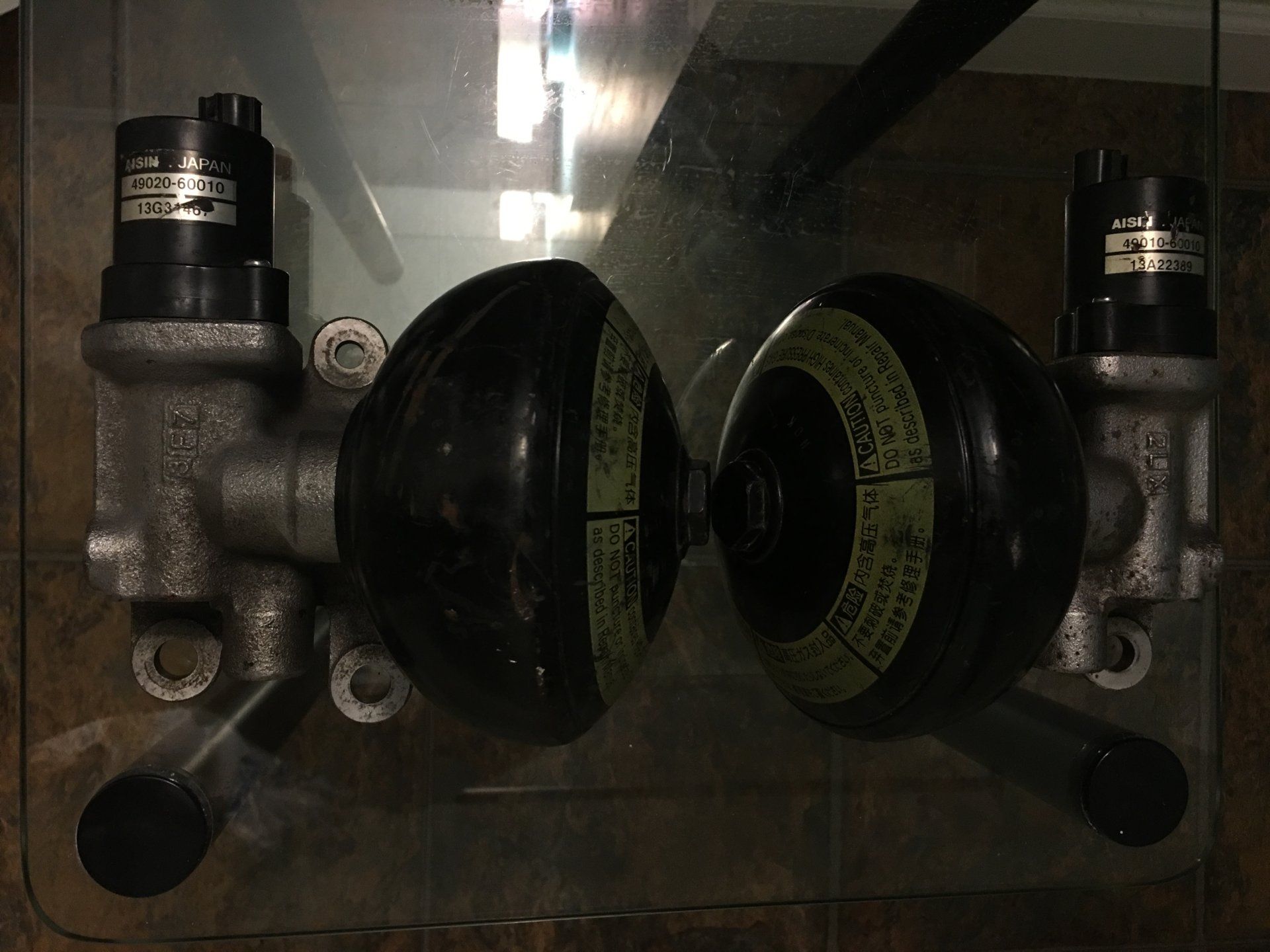

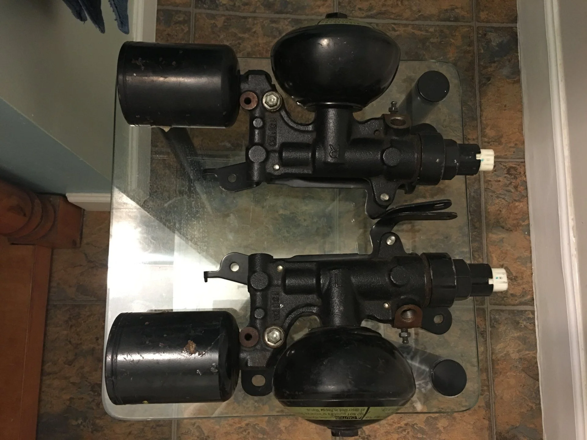

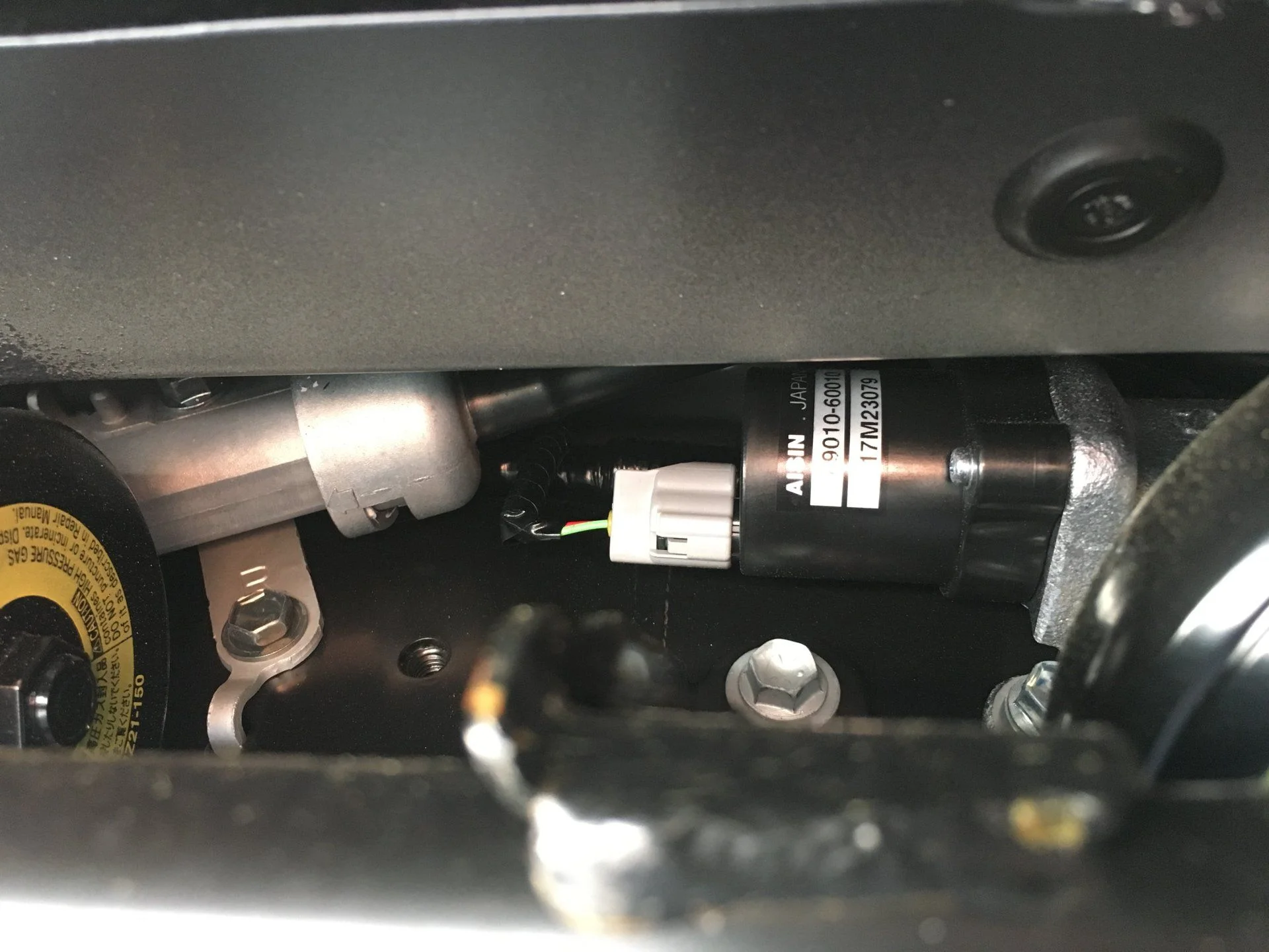

Top two photos are dealer-lot photos of accumulators on a 2018 LX570. Bottom three are of the accumulators I bought on EBay, which were supposedly from a 2017 LX570.
This was another reassuring point in my learning curve, because it showed that Toyota has apparently kept the AHC system unchanged

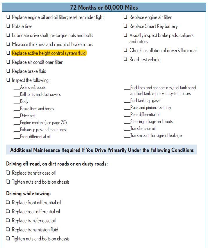

This is a really great long-term use case and data point. Could you please share the “maintenance schedule” you’re referring to (I might have missed it in the owner’s manual — many folks mention 60K, but I’m curious if others do it more often, and if so, why?). Also, if you have time, could you share your personal to-do list for doing a 200-series fluid flush?

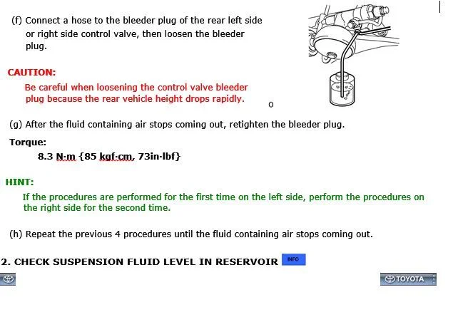

There are a few videos on YouTube that show the flush in a 200-series ( ), but I wanted to gather more info on this prior to attempting this myself.
