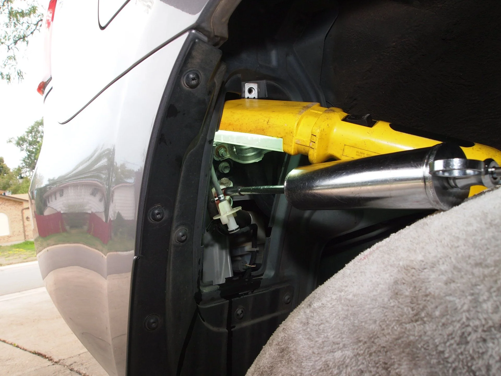

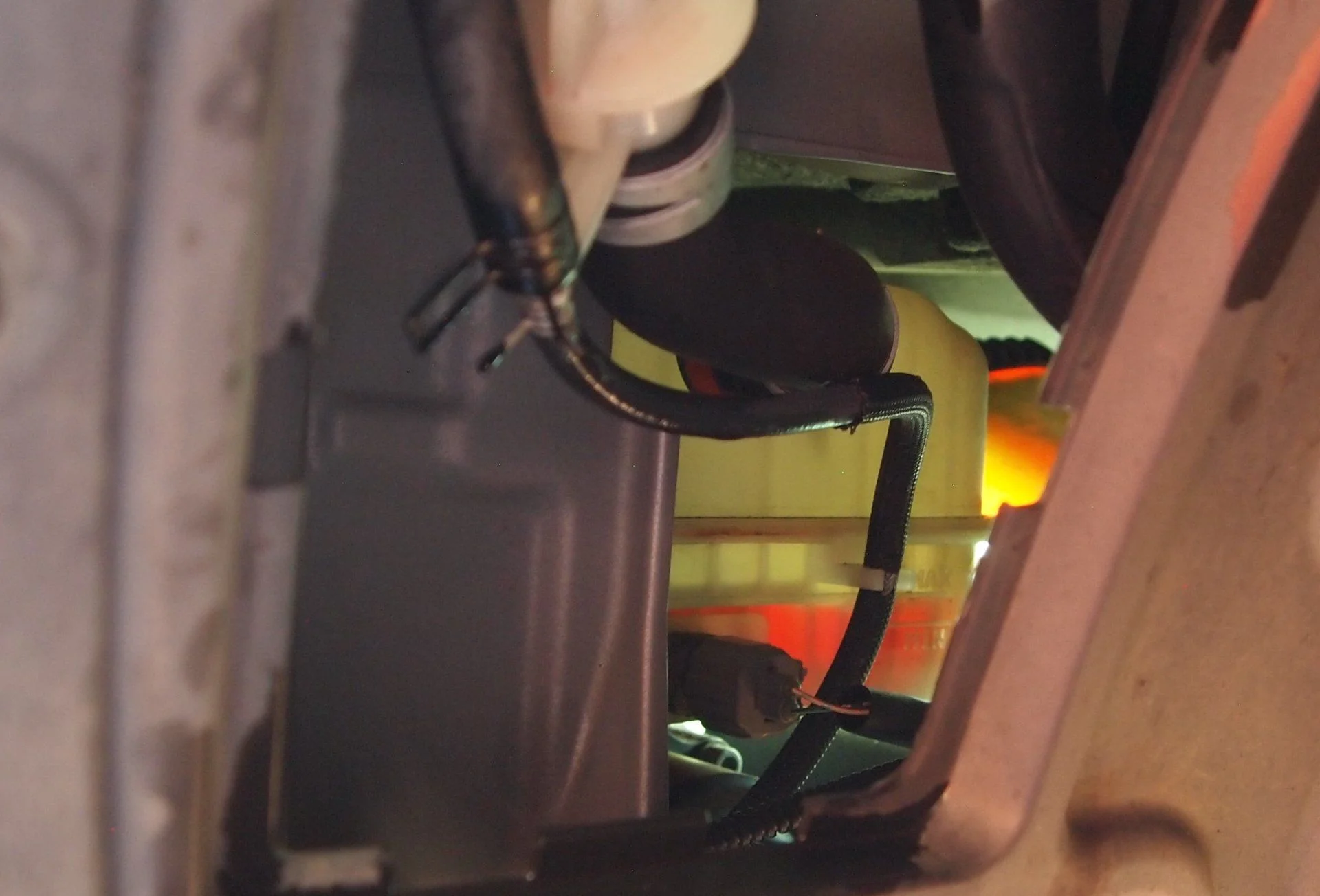

No there is a screen under that white cap. I removed the black hose at the hose clamp pointed to with the arrow (yes field point, it was near by) and vacuumed and filled from there. Each time I filled I just slipped the hose back on over the nipple before I started the car to let it re level without re setting the hose clamp. Then slid it back off to add more fluid as needed.
The tubing from my break evacuator is similar in diameter to aquarium tubing.
You’re the man! Thank you! Ordered another 2 bottles for a total of 6 since you mentioned cutting it close with 4.
Seems to me there was a screen under the quick release cap for breather tube in reservoir hose fitting. I pulled something out (without remove retainer bolt) to get a rather thin tube into reservoir hose and just siphon out the fluid and too fill. Either way screen or no screen I avoid removing clamped hoses when every possible to reduce chance of future leaks.
Going through reservoir hose at quick release is slower, as very thin hose just can't siphon or fill as fast as a larger. I got lucky first time in, as my siphoning hose settled in the bottom of reservoir sucking it dry first try.
I started siphoning with a very handy large syringe, then ran hose to catch can let siphon on it's own as I did other stuff.

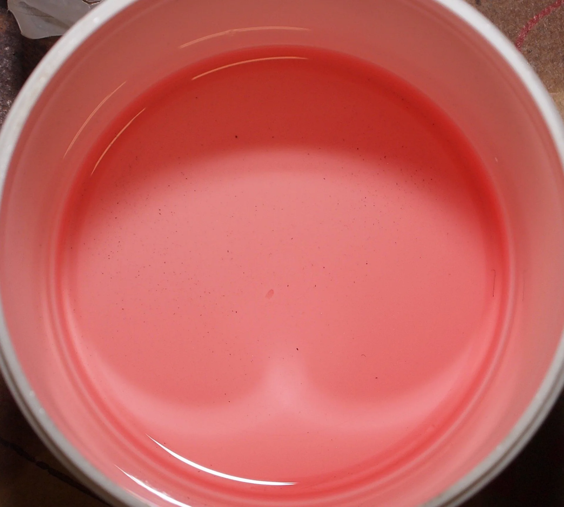

@PADDO suggested I flush new OEM shock before installing. Sure enough I found particles in brand new shock. One shock I had to flush once and was clear afterwards. But the other new OEM shock sourced at same time same Dealer needed flush seven times. This got me into inspecting fluid old and new from the ACH system

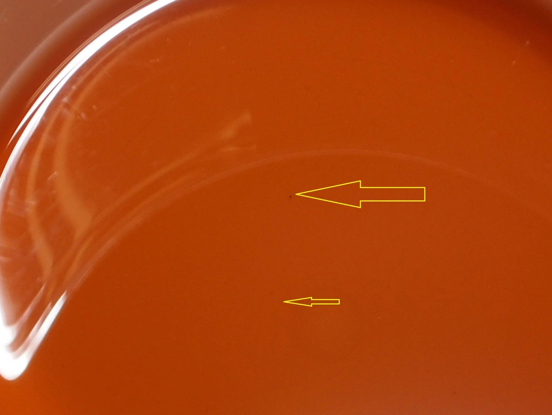

Here's a little trick for Inspected fluid before or and or after your done with flushing an driven for awhile:
Draw off a little from any bleeder. I like sample from accumulator it seem the dirtiest, but that's a pain to get-to on the 200 series. Fluid will be dark, so small sample is best for this test. Place the sample of fluid in a white plastic container. Then look through fluid to bottom of container, particles over 30 microns can be see with naked eye. Some use glass jaw with white paper under it, but that's to hard for me to see particles in. If you see practicals either flush or filter.

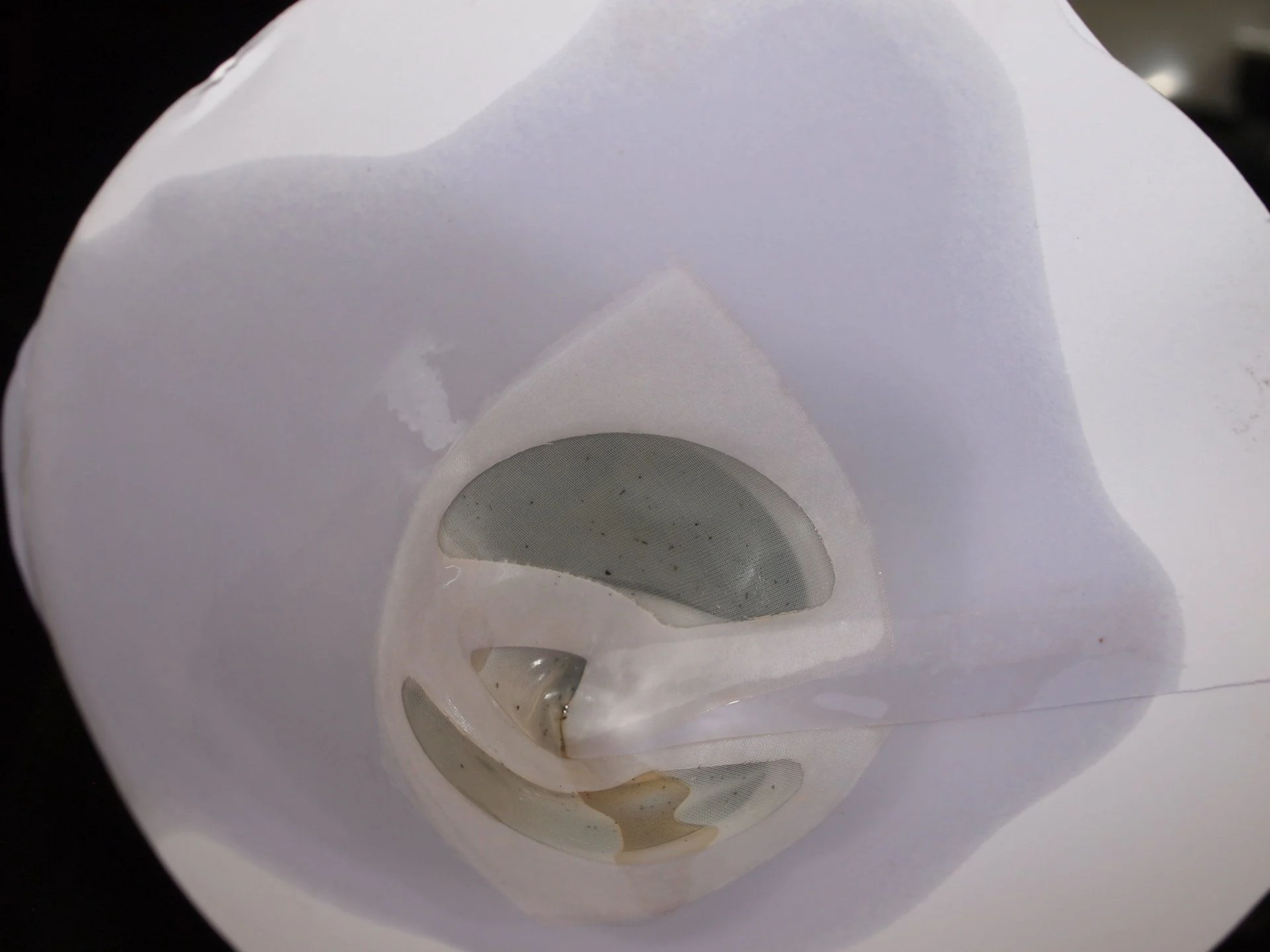

After first flush (not yet driven) raised and lowered a few times. Look at at what I found. No wonder I had to replace a shock, like sand in seal.
After three consecutive flushing. $$$$
First attempt to build a filter, a simple automotive painters filter.

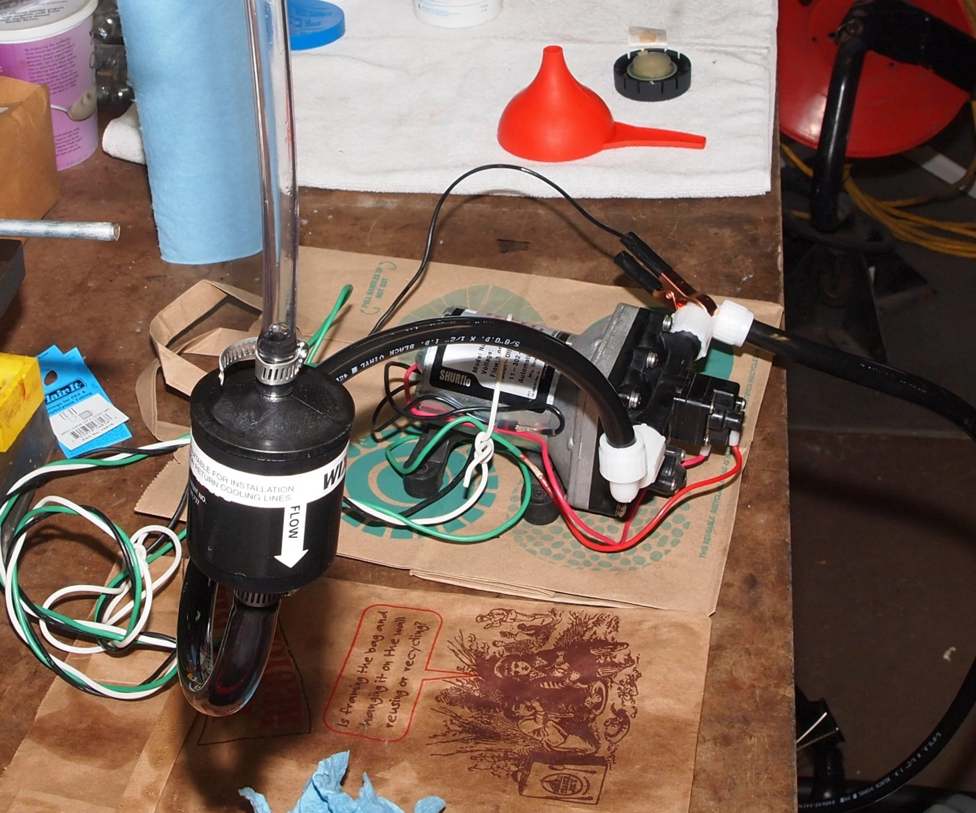

I use a transmission filter adapted to a 12V pump to filter fluid, others use a cotton T shirt to filter fresh fluid in system. After doing one system with 9 qts of new fluid and still had particles, I built this filter to save $$ just for fresh fluids.
