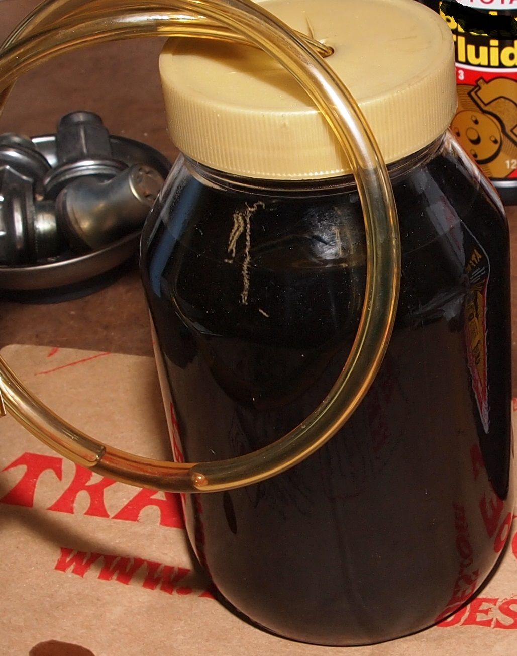

I started the job by removing the access panel then power washing the reservoir area to make sure nothing would fall in the port. Power washed all bleeder areas as well, to make sure nothing would fall in my eyes (hate that).
I did bleed/flush the 5th, same dark color as the rest.
Set myself up an IV type drip line, worked pretty good.
Placed an LED drop light on spare tire to make reading level in reservoir much easier.
Once done I torque each bleeder to 73in-lbf then blew-out each with compressed air and installed new bleeder rubber cap. I think 7 to 10 years is about all one can expect of the caps.
