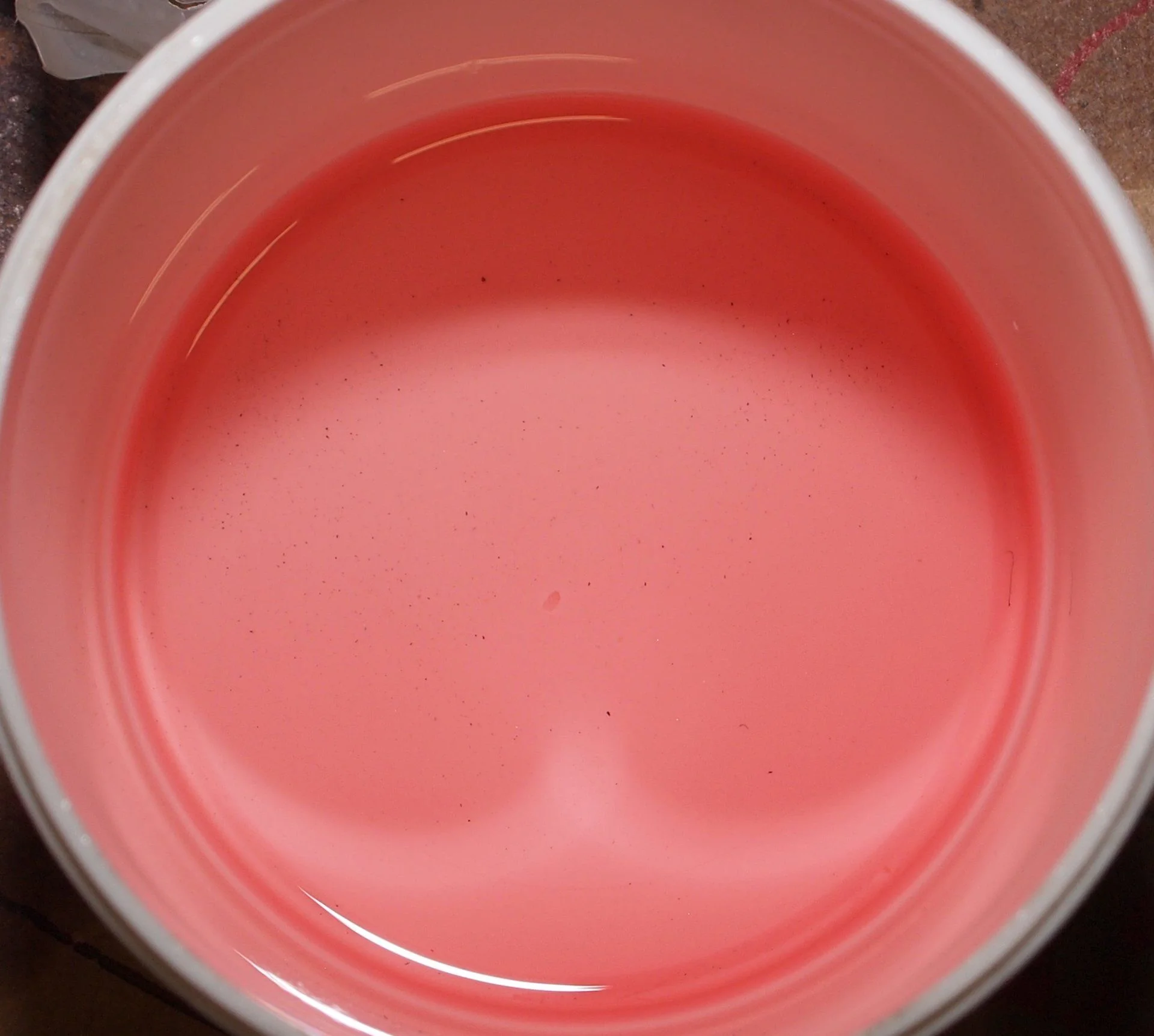

I've a test. Once clear running after a flush. I drain a little into a white plastic jar. If I see specs in bottom of fluid in the jar, they are 30 micro or large to be seen by naked eye. I keep flushing until none seen. I've a filter system I use once fluid clear. That way I don't waste 5 or 10 good new qts. Lexus just quoted me $36 retail per/qt.

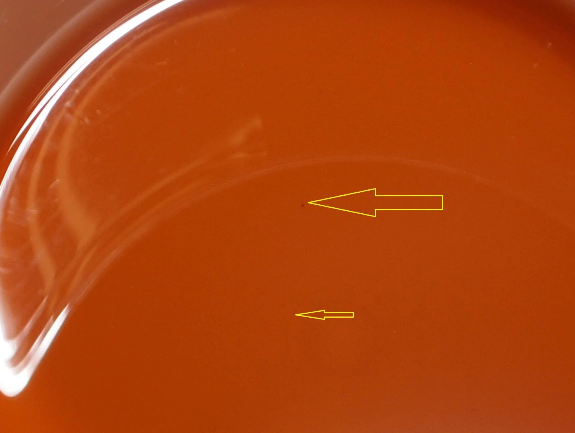

@PADDO thought me to pre flush a new OEM AHC shock out of the box. Amassing how dirty brand new shock are internally.
This was a AHC brand new OEM shock out of the box on 2nd or 3rd flushed. I flushed 7 times to get clear.
Here is almost clean for comparison.
IDNY shop likely did not pre fill the shocks, much less pre flush them. So why would they not add some DUUUUUH. The shock they pulled while on a lift (shock fully extended) would have fluid in them that needs replacing. I'll bet they did not replace the seals either.
