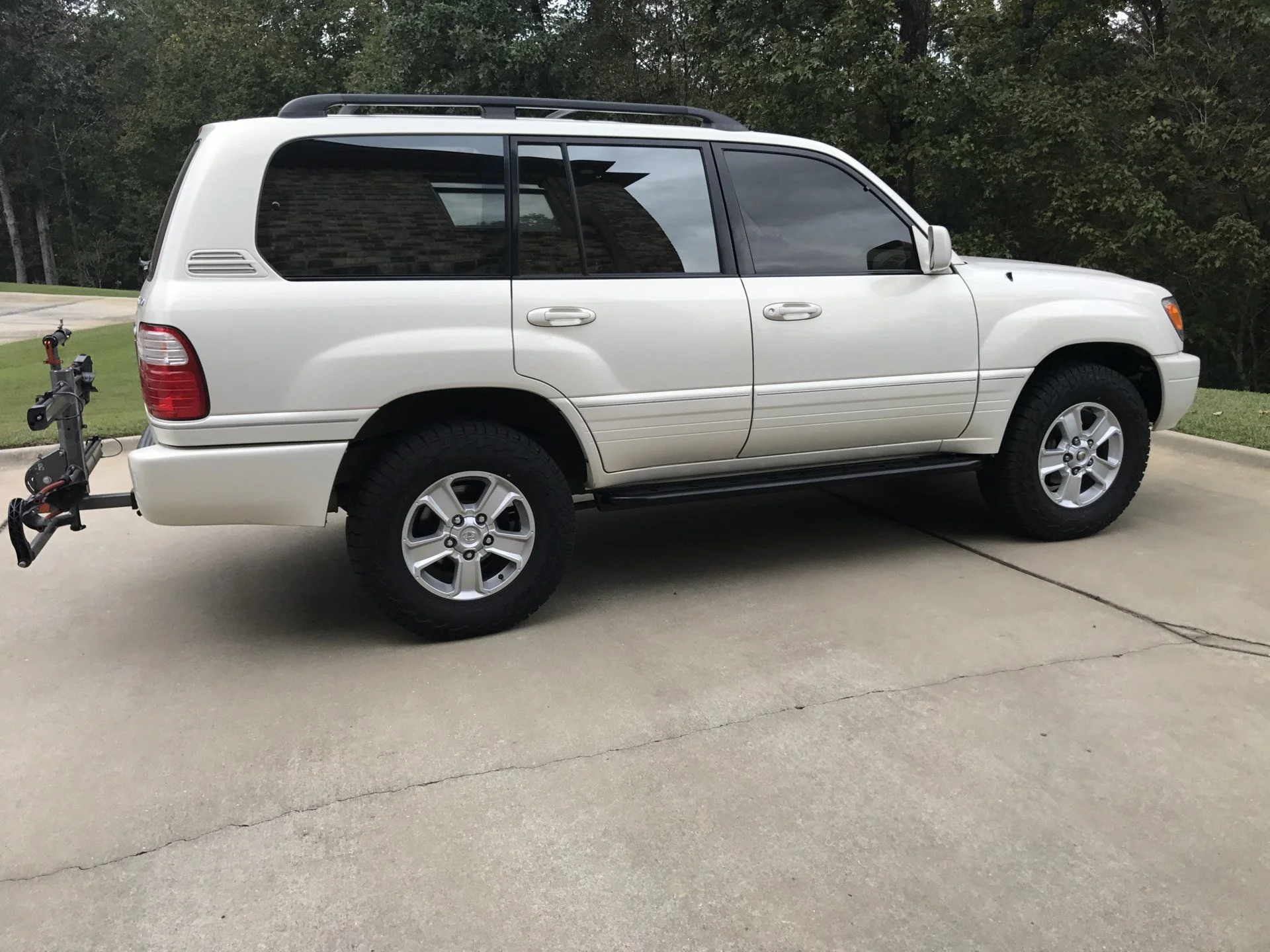

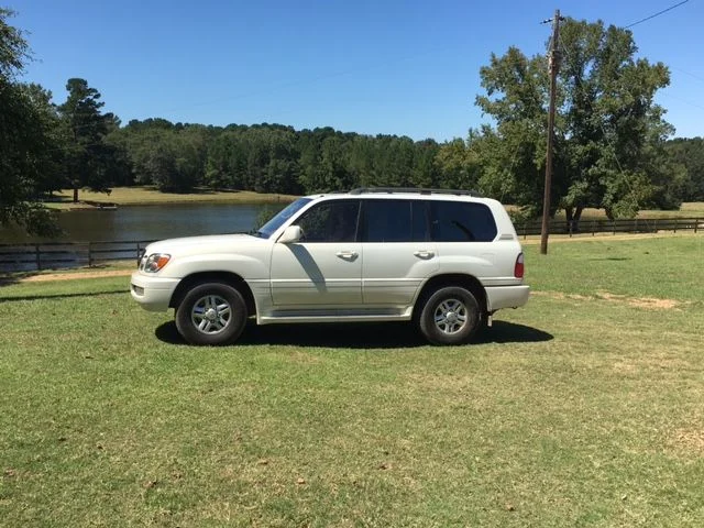

So I got a lead on a 100 series in good condition only a few hours away. I got some pics and info from the owner and decided to take a look. Owner had it for 10 years and had done all the major maintenance items and was pretty anal about maintenance and repairs. In the last year the vehicle had all the front end components replaced (shafts, rack, ball joints), new brake master cylinder, and the timing belt was done at 90k. The LX has 165k miles and was in great condition inside and out, hard to believe it was 19 years old. There was 10 years of service history and it was pretty impressive. It was a non-nav vehicle, but the PO swapped in a nice head unit and speakers, so one less thing I had to do. I pulled the trigger on it and drove it home
Initial mods were basic:
  1. Proper Cleaning
  2. Bigger Wheels & Tires
  3. AHC Lift
  4. Floor Liners
  5. Interior LED's from Pfran
  6. External Light Bulbs
  7. Full Maintenance
  8. Slee Sliders

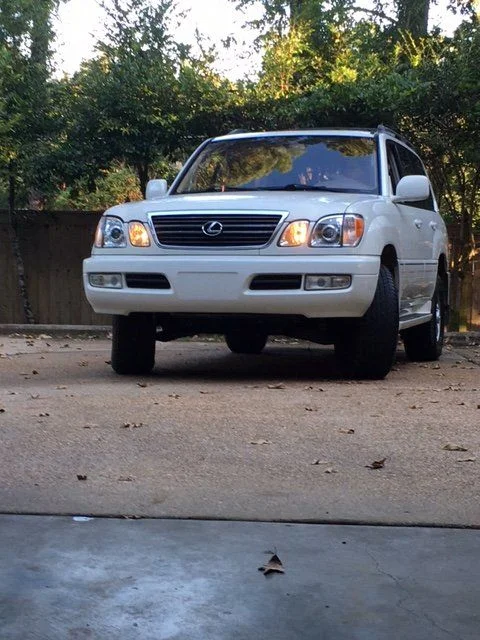

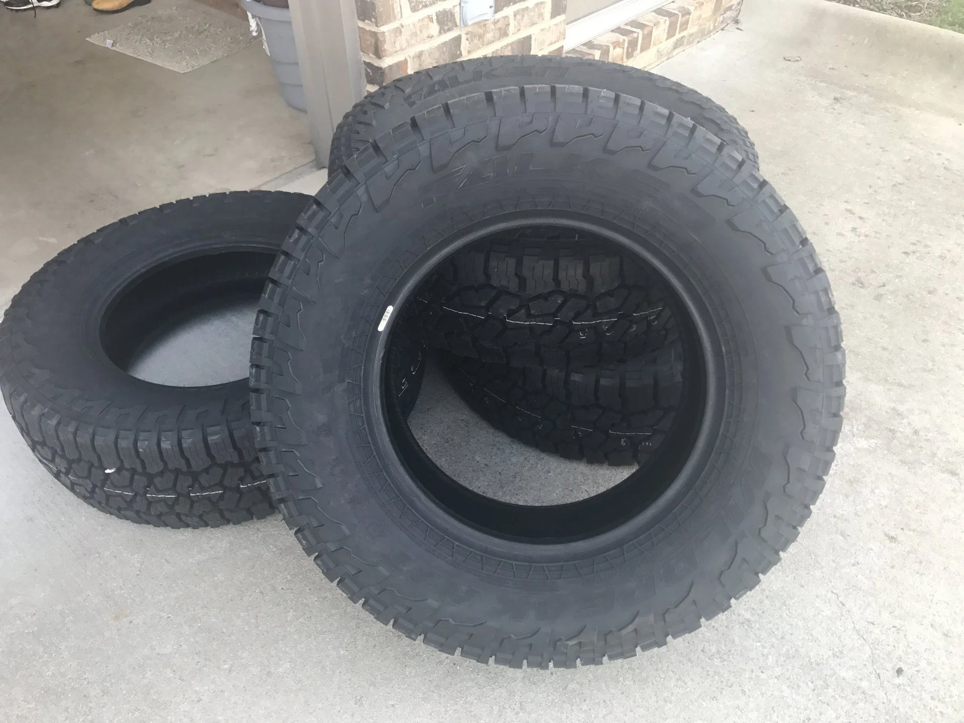

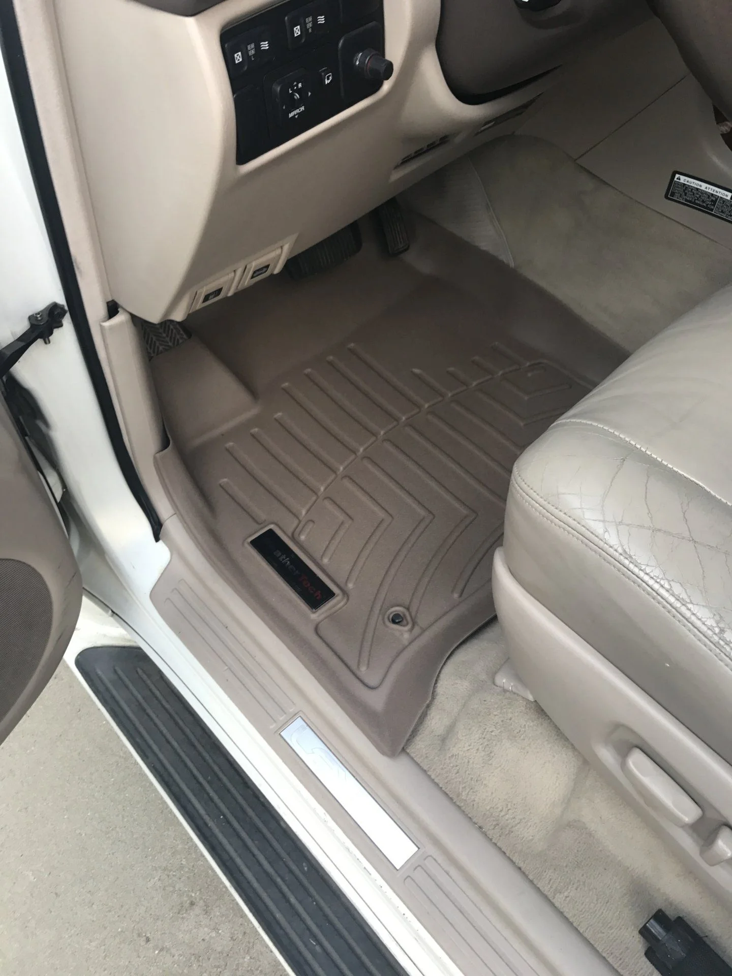

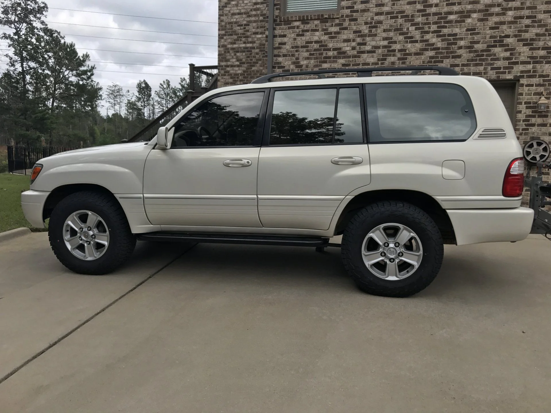

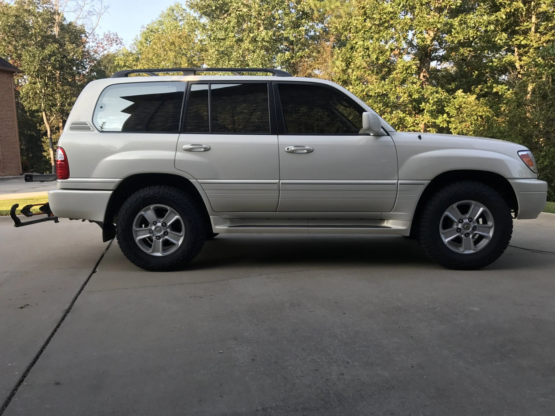

LX was super clean, but the interior needed a once over, so I spent several hours cleaning the carpet and leather. It helped. I found some brand new 18" Tundra take offs for $250 and got some Falken Wildpeak 275/70/18 tires. Did some research and decided to do the AHC sensor lift for now. It got me about 2" of lift. For floor liners I got some WeatherTech mats all around. The interior lights were bad, so the Pfran kit was a non brainer. I will eventually get much better headlights, but for now I replaced all the exterior bulbs with OSRAM bulbs. I have some Slee sliders on order, and I will ditch the factory steps when they get here.

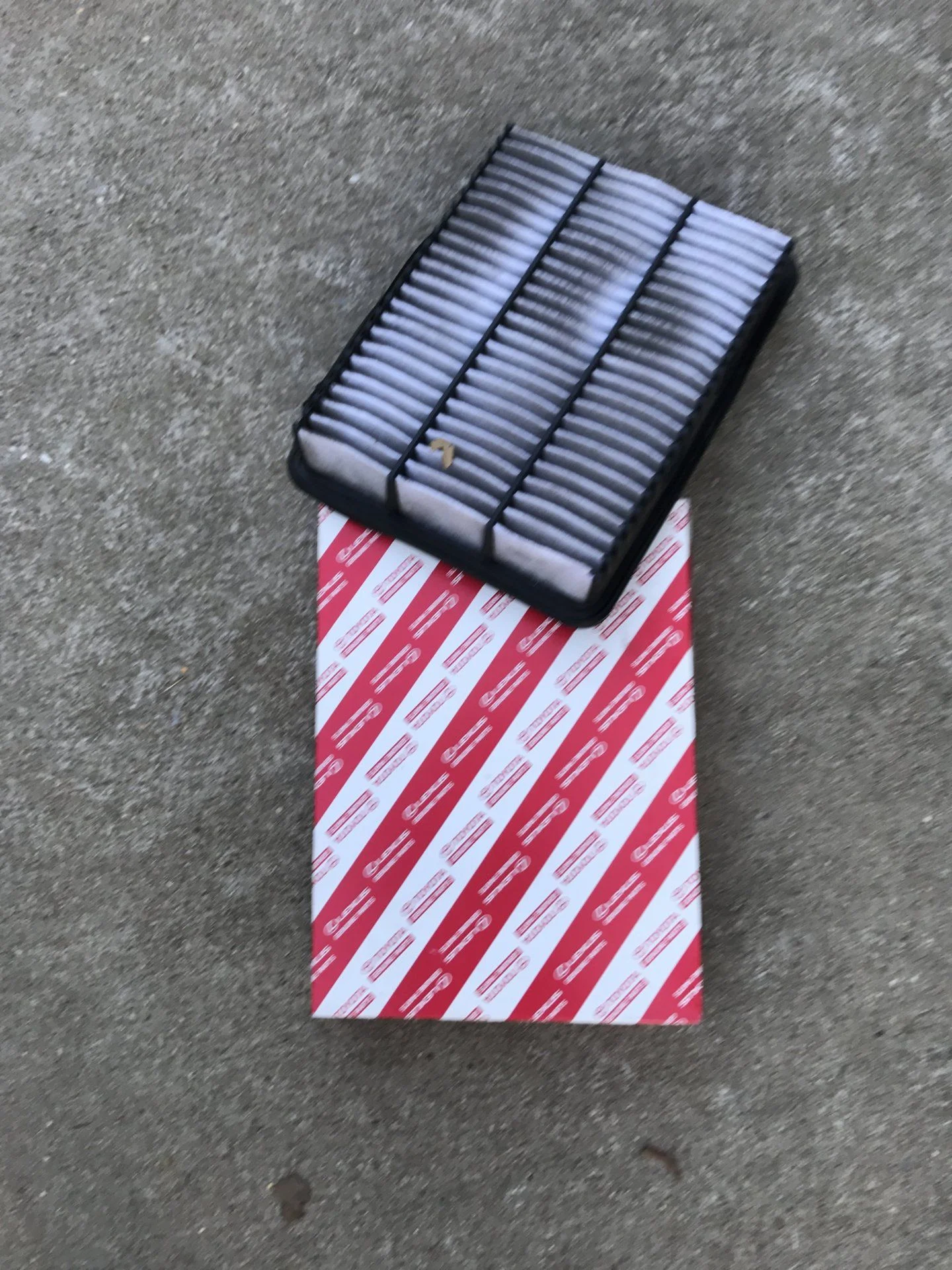

  2. Air Filter

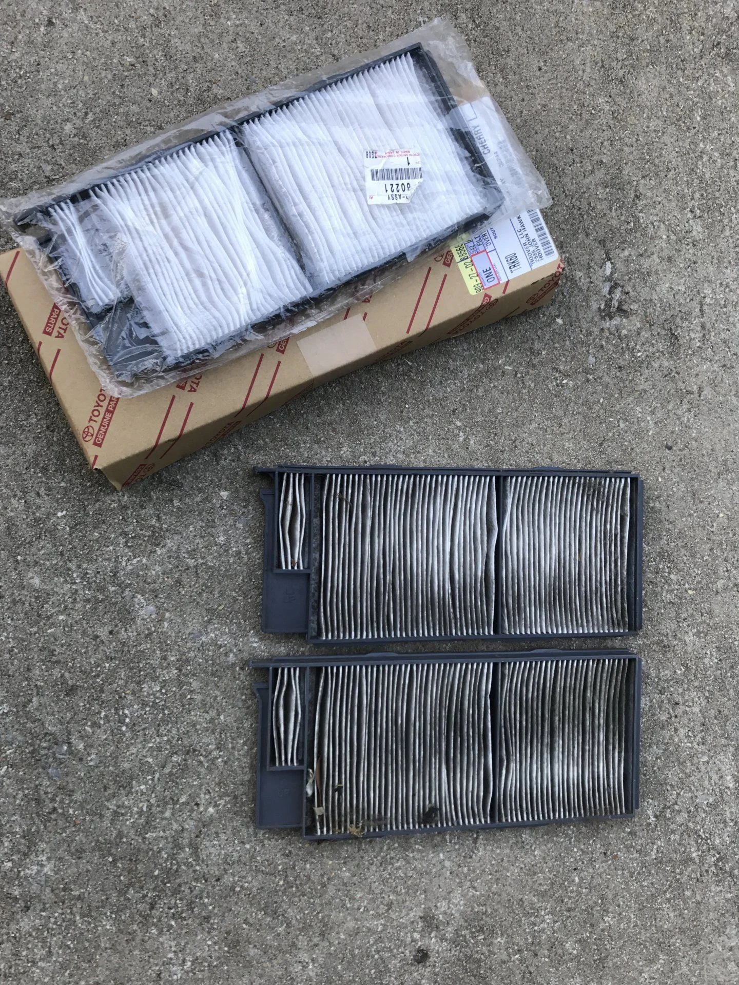

  3. Cabin Air Filters

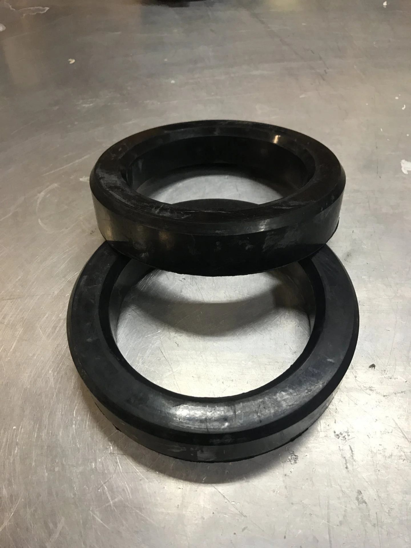

I have the following items on the way:

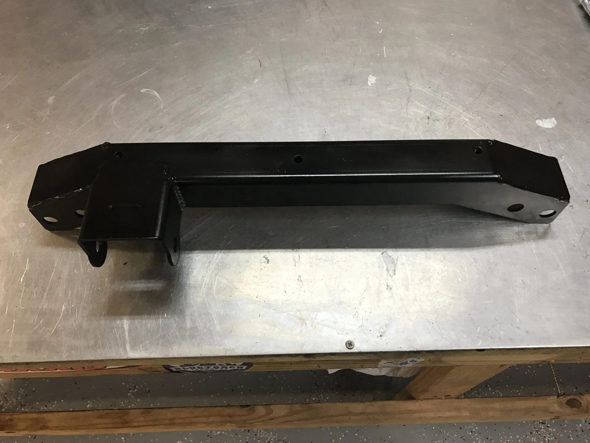

  1. Diff Drop
  2. Rear 30mm spring packers
  3. Slee Sliders

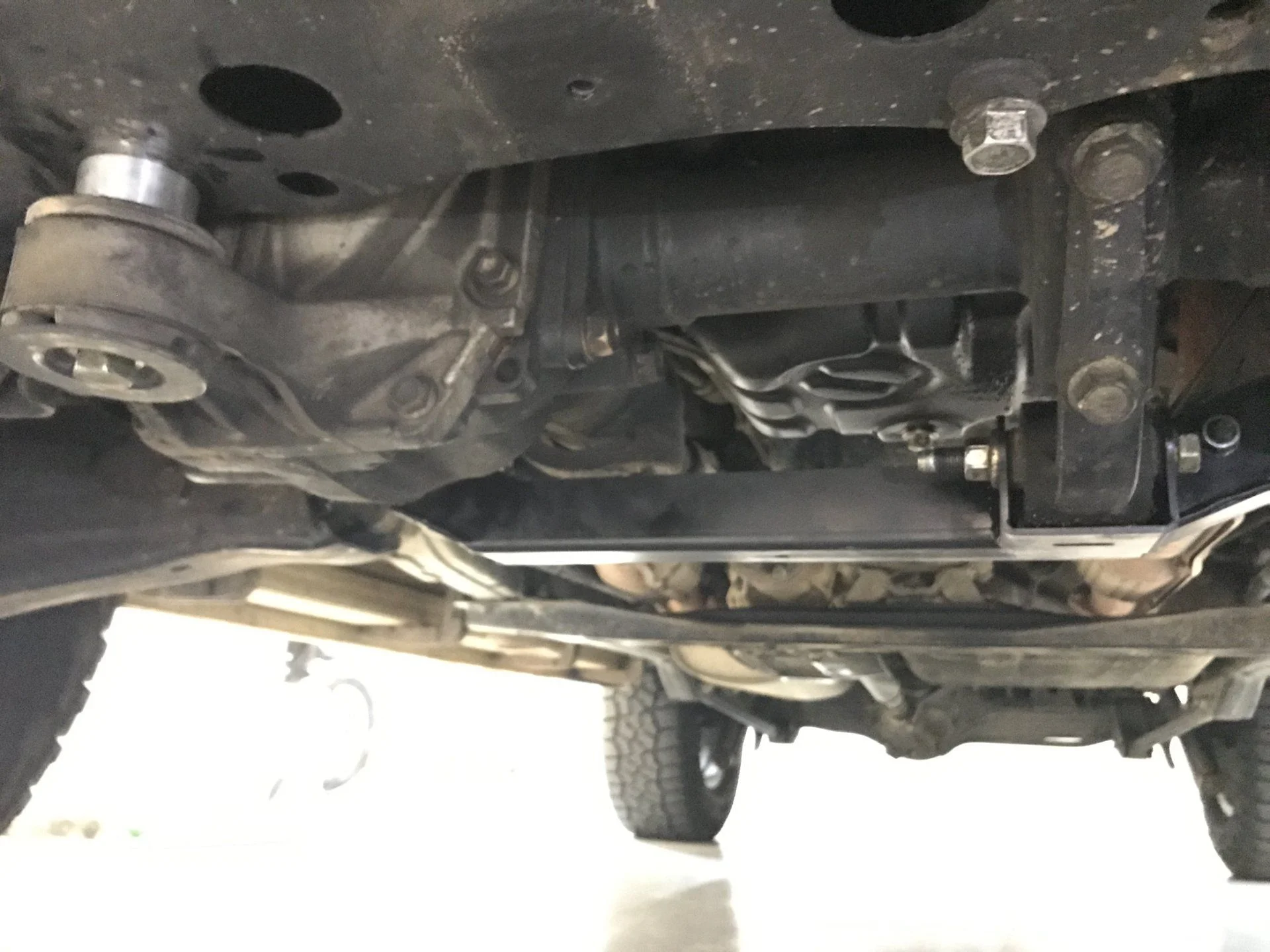

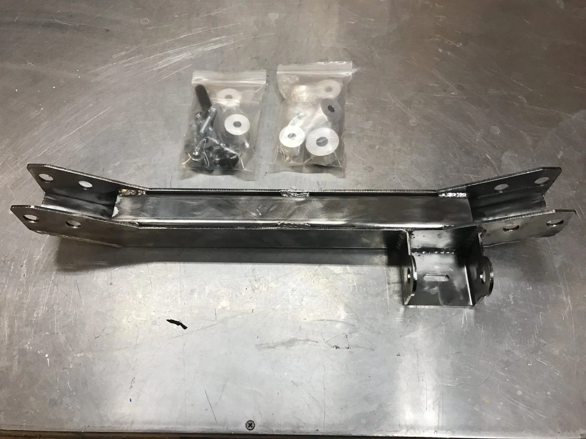

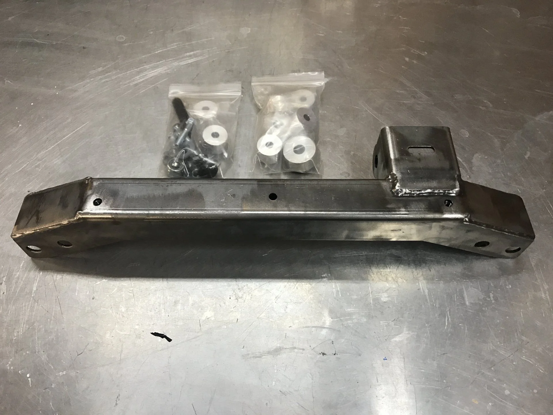

Shout out to @reevesci for a few items. Needed rear spring packers to get my AHC pressures back to normal and decided to go ahead and get a diff drop. I felt the pros of a diff drop outweigh the cons, which was just basically the cost. The Trail Tailor diff drop came bare, which saved me about $65 over the competition. I plan to hit it with etching primer and a few coats of paint.

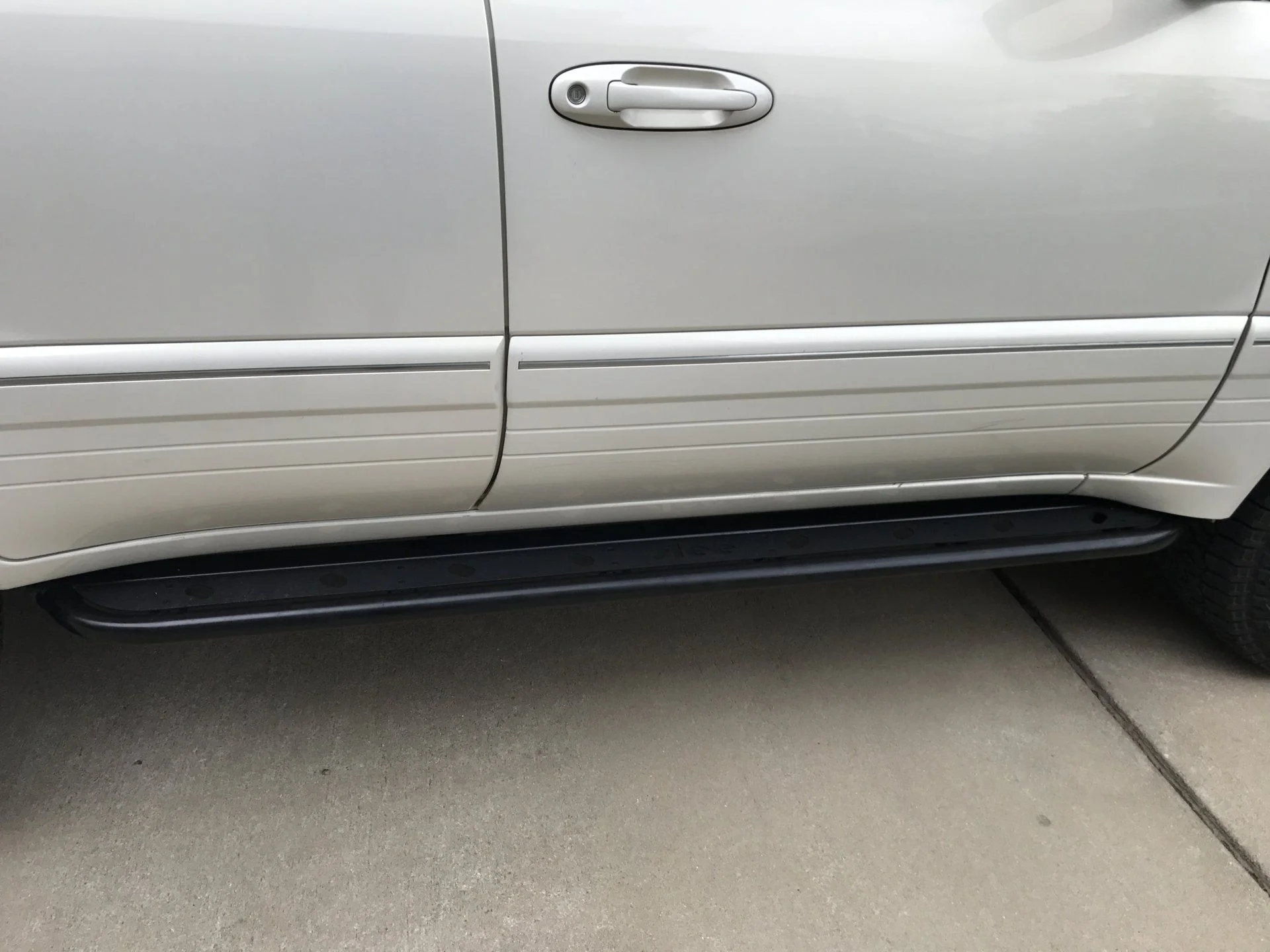

My Slee steps are on the way. Ran into some shipping issues because it appears their freight company is no more, which left them scrambling for a way to get my sliders here. They arrive tomorrow, so I hope to throw them on this weekend.
Where in Birmingham are you? And how old are your kids? I'll be anxious to hear if the AHC lift and sliders suffice in lieu of the running boards.
I live in Gardendale, but work in Hoover. Kids are 8, 6, 2 and 2 days old, lol. I should have the sliders on tomorrow, so I will report back then. I really like the AHC lift, it still moves into all three positions.
