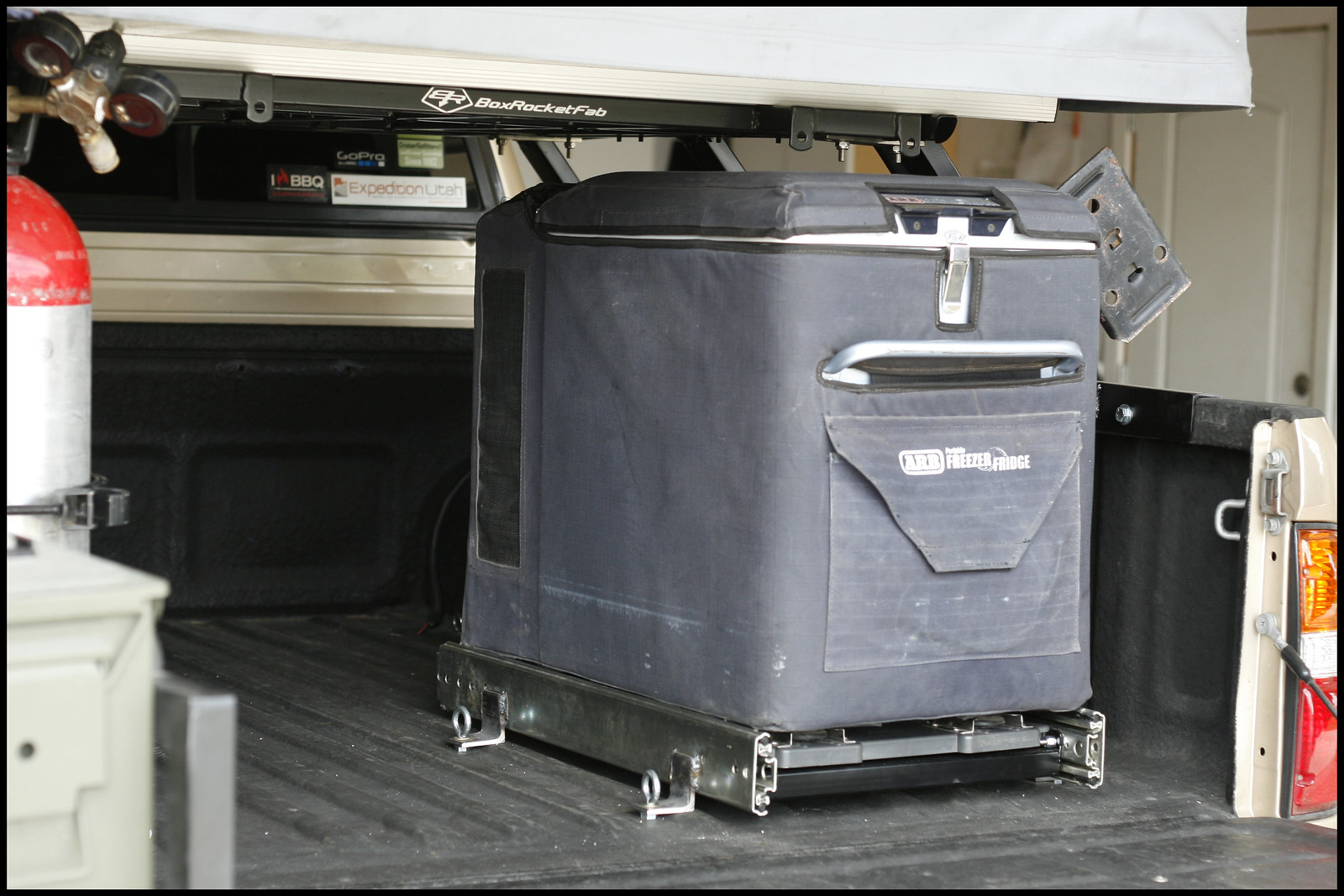

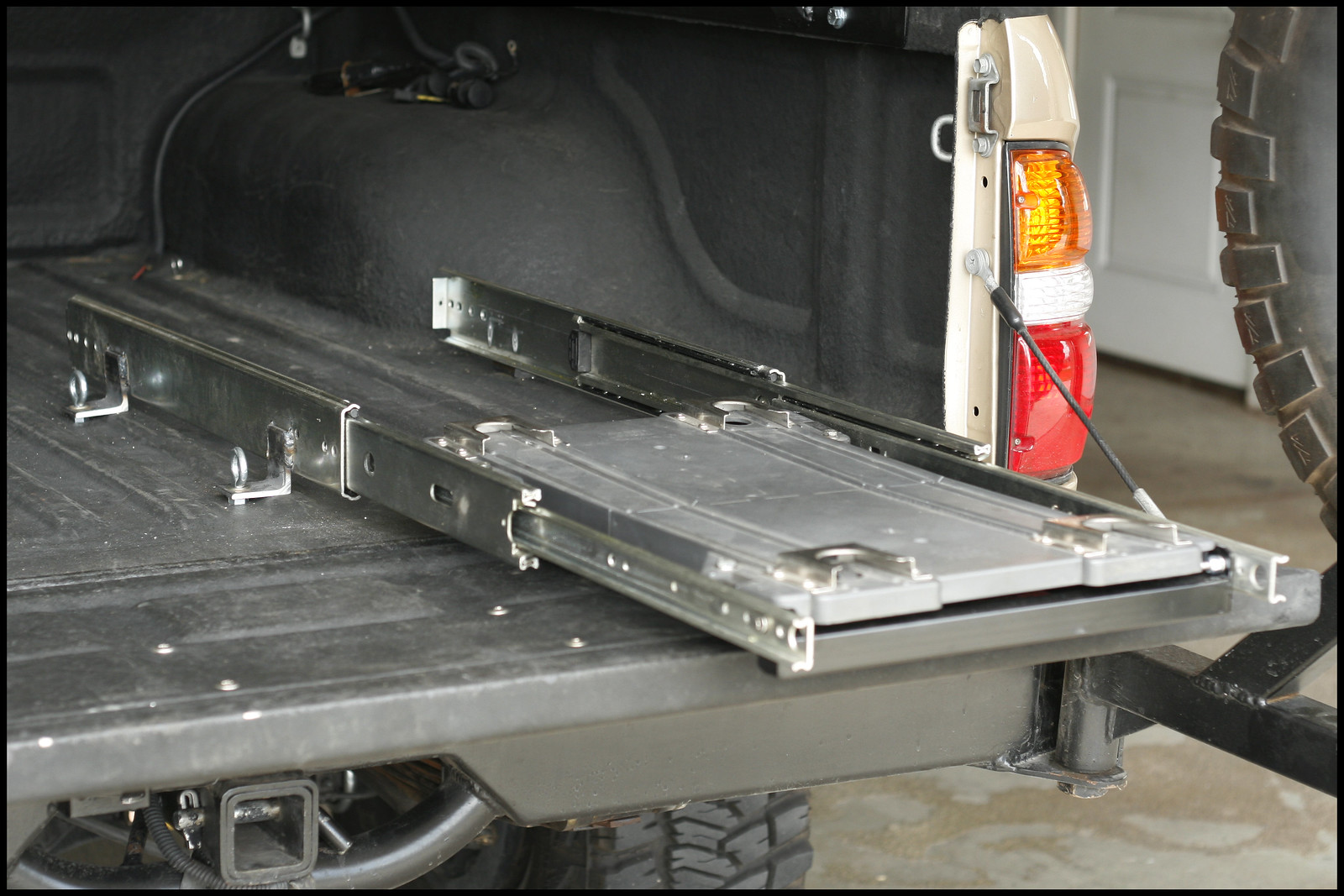

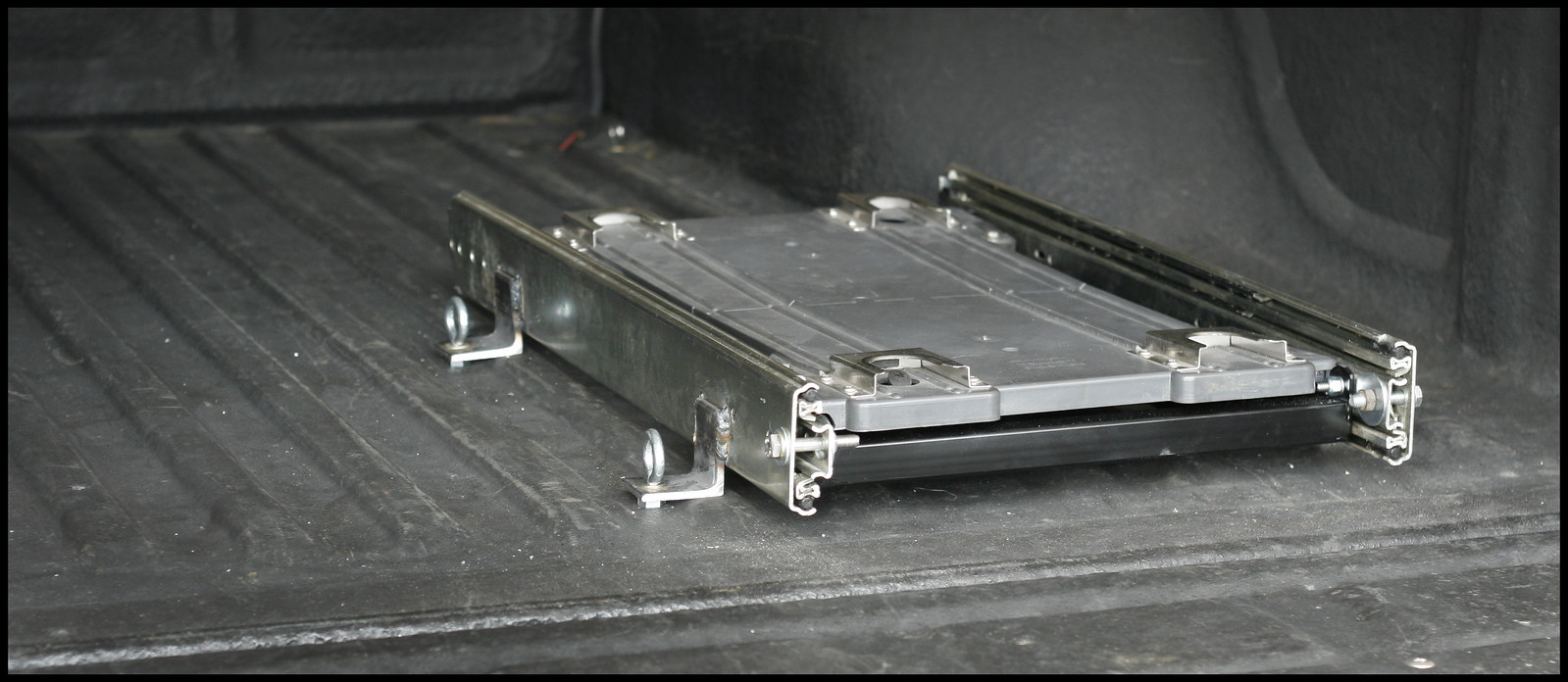

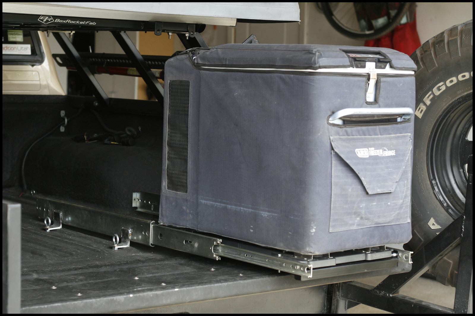

This may or may not be helpful but maybe will give an idea or two. I built a simple fridge slide 6-7 years ago for my old ARB fridge that was first used in my Tacoma but I also used it in my 80 after selling the Tacoma. It won't work for me now since I've added Goose-Gear drawers and need the drop slide but this was a simple build. I used some 1" sq tube to build a small frame that would hold the Engel Transit-Lok (gray plastic base that would lock the ARB fridge in place). That frame was bolted to the HD slides I had. Since you wouldn't be using an Engel/ARB fridge there's no need for the complexity of attaching a Transit-Lok and you could just fabricate a small tray from some angle iron to hold the fridge and add some kind of provision to strap the fridge to the tray. That would be a $30-$40 project at most and very simple.
Here's the slide in my Tacoma.
_MG_3566 by Adam Tolman, on Flickr
_MG_3569 by Adam Tolman, on Flickr
_MG_3575 by Adam Tolman, on Flickr
_MG_3574 by Adam Tolman, on Flickr

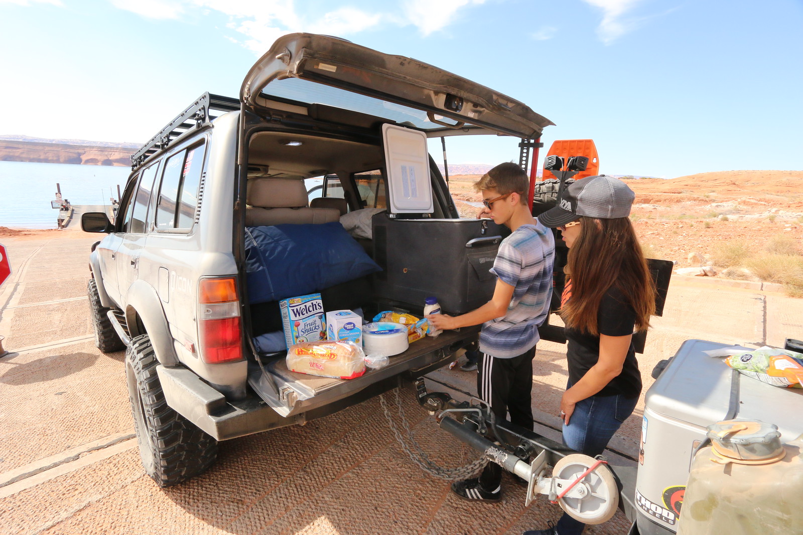

Same slide in my 80. This was about as high as my wife could handle so now that I have drawers back there a drop slide is the best solution.
IMG_8584 by Adam Tolman, on Flickr
