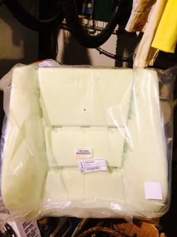

Those are the part numbers for the upper and lower Lexus cushions.
Take a pic of the seat cushion it will be easy to tell if it is the LC version and not the LX version. What else makes you say that it is the LC version?
lx450seatback.webp I was confused by the Toyota Part numbers. This is the back pad
