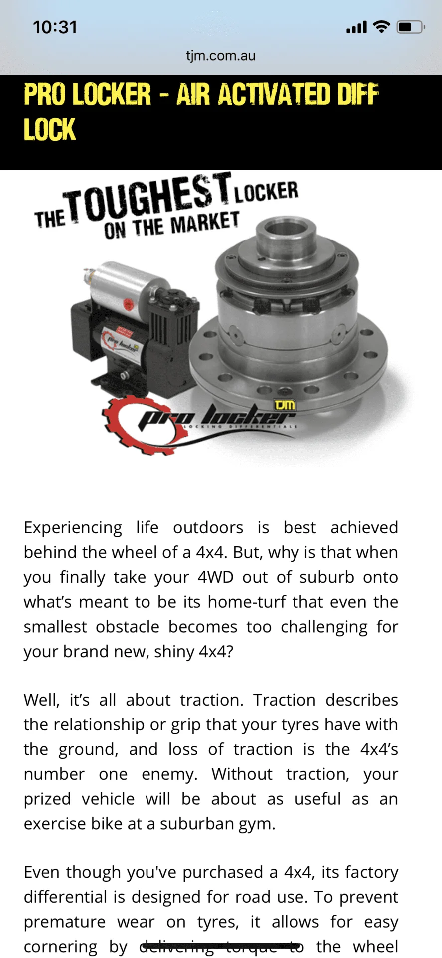

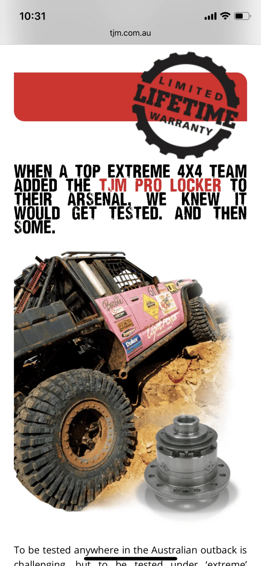

I haven’t heard any mention of this air locker. Anybody heard or running the JTM pro locker? I’ve watched YouTube videos of the pros and cons of different lockers. The ARB look amazing and I’m sure they are but the seals go bad and the locker must be removed to replace the seals. Seems like a PITA. The JTM pro locker is a different design with no interior seals to go bad. It also has a limited lifetime warranty.
4WD Accessories - TJM Rear Bar - 4x4 Accessories | TJM Australia

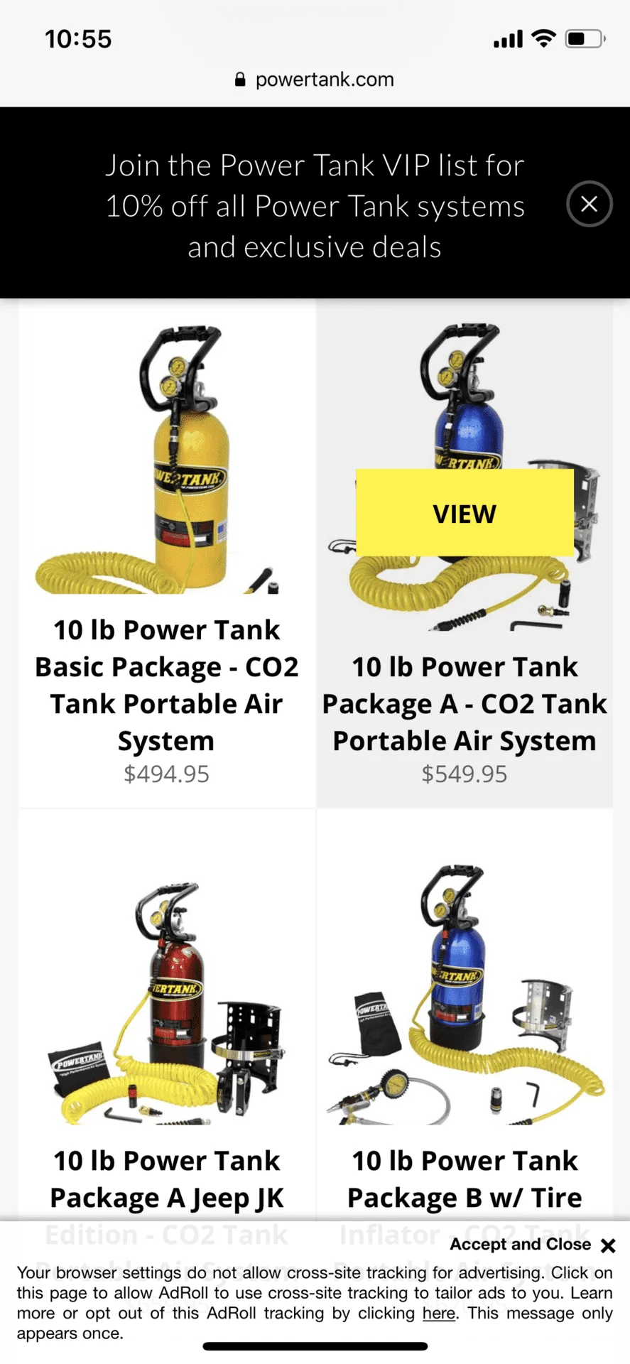

As far as the ARB compressor goes, has anybody had issues with them? Read about a lot failing in a year or less. Alternative, Power Tank. No compressor to deal with maintenance issues. Just a tank of compressed CO2 gas. Pressurize your lockers or inflate your tires in a fraction of the time it takes your ARB compressor.

TJM has to go into a FF axle. If I was going FF then I'd want an elocker, that is until I read this thread. Now I'm not so sure. Thats all I know.
