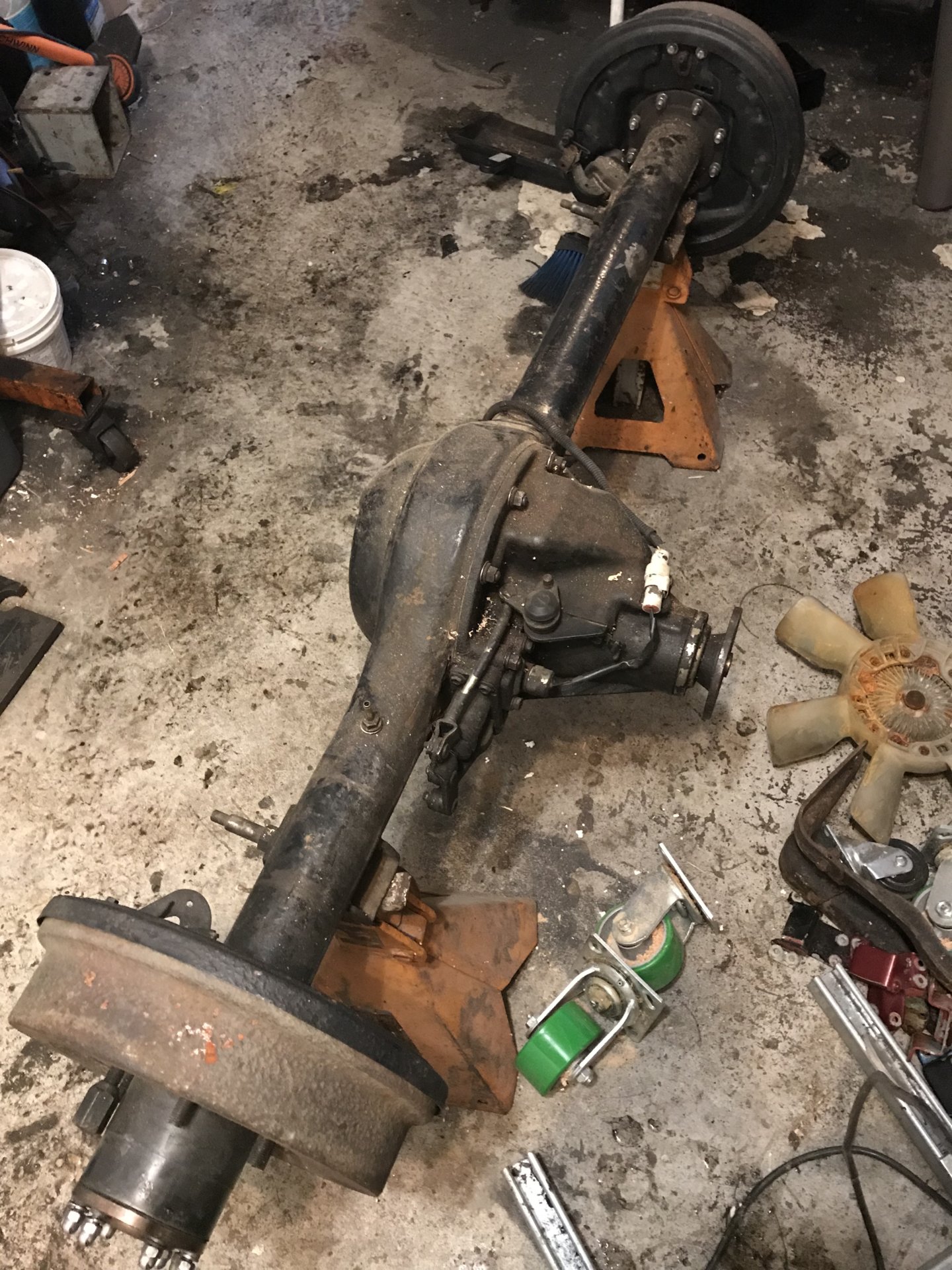

I've pulled the diffs on the 60. Got a pair of ARB's here. Since I've had complicated shoulder issues all building and working on trucks has
ground to a halt. It's been too long, but it is what it is. My question is a result me my buying the ARB lockers at a really good price and already
having extra bits from my old 40 switches and wires etc. I also had tremendous luck with mine in the many years of use with no o ring or air
line failures.
Fast forward a decade and a bit. The new fittings thru the diff are a pain in the ass. Far more parts and not user friendly certainly not something
I'd want to take apart at the edge of a mud hole should need arise. Also I'm hearing from many who are not fans of new o rings failing at higher
rates than they should.

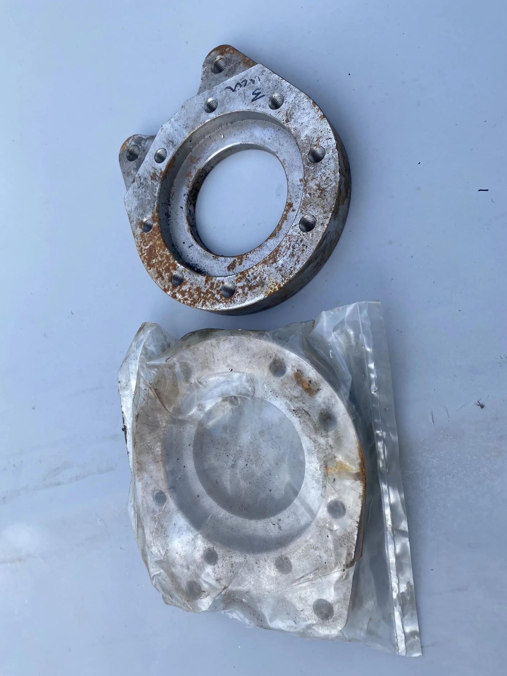

cruiserpilot because you live near me I have this, would be a bit of a project but! I have weld on flanges to turn a 60 or 40 series axle into a full floater that would then accept factory Toyota lockers. I never used these and they been sitting for years because I found the cable locked axles. These utilize front spindles and bearings which is a big bonus because the 40,60 and 80 full float spindles are part of the axle, unchangeable if you spin a bearing. You would also need and 80 series electric pumpkin, nitro custom length axle shafts.
Plus the other bonus not yet mentioned, with a cut down 80 series electric locker axle you get the sexy full floater axle.
Thanks Steve, I've already got a FF out back. I'd look at rear discs but I'm concentrating on locker issues right now.

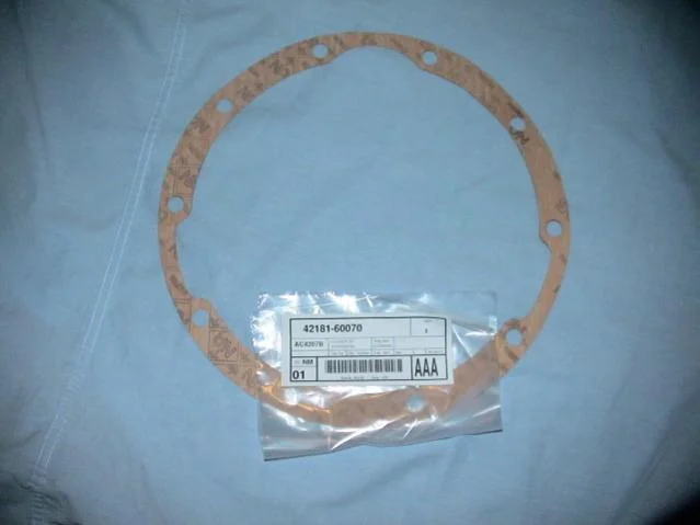

Only reason people go arb air is because factory Toyota Elocked differentials don’t work with basic semi float axles. You are already set up to go for an 80 series ELocker.
You might need to get your splines cut longer on your short side axle. And add an extra notch in your housing flange to accept the factory Toyota ELocker, that’s it..
Gasket shows the extra notch.
