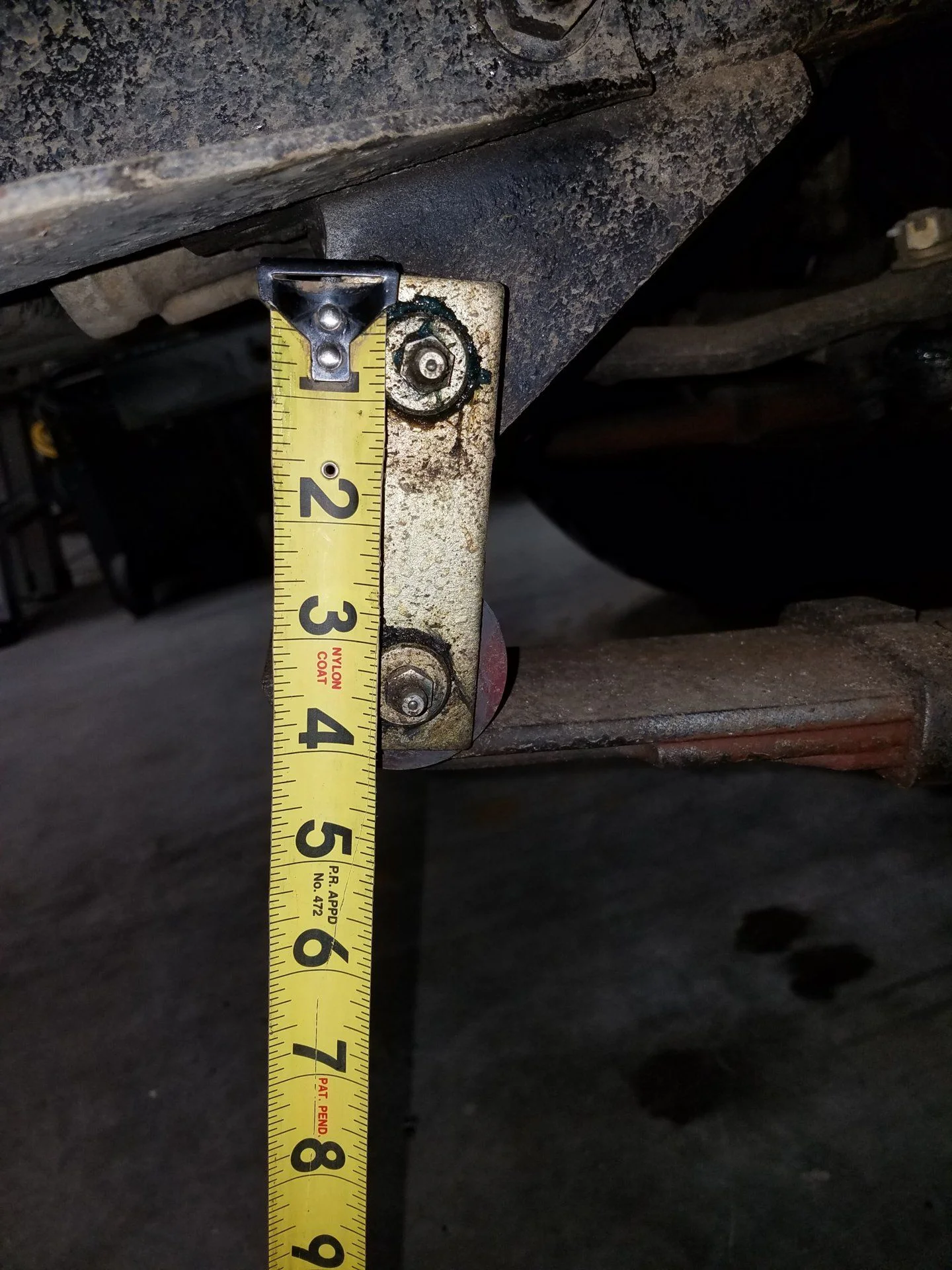

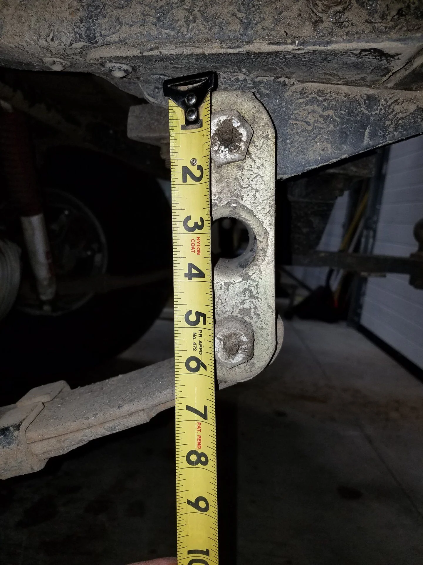

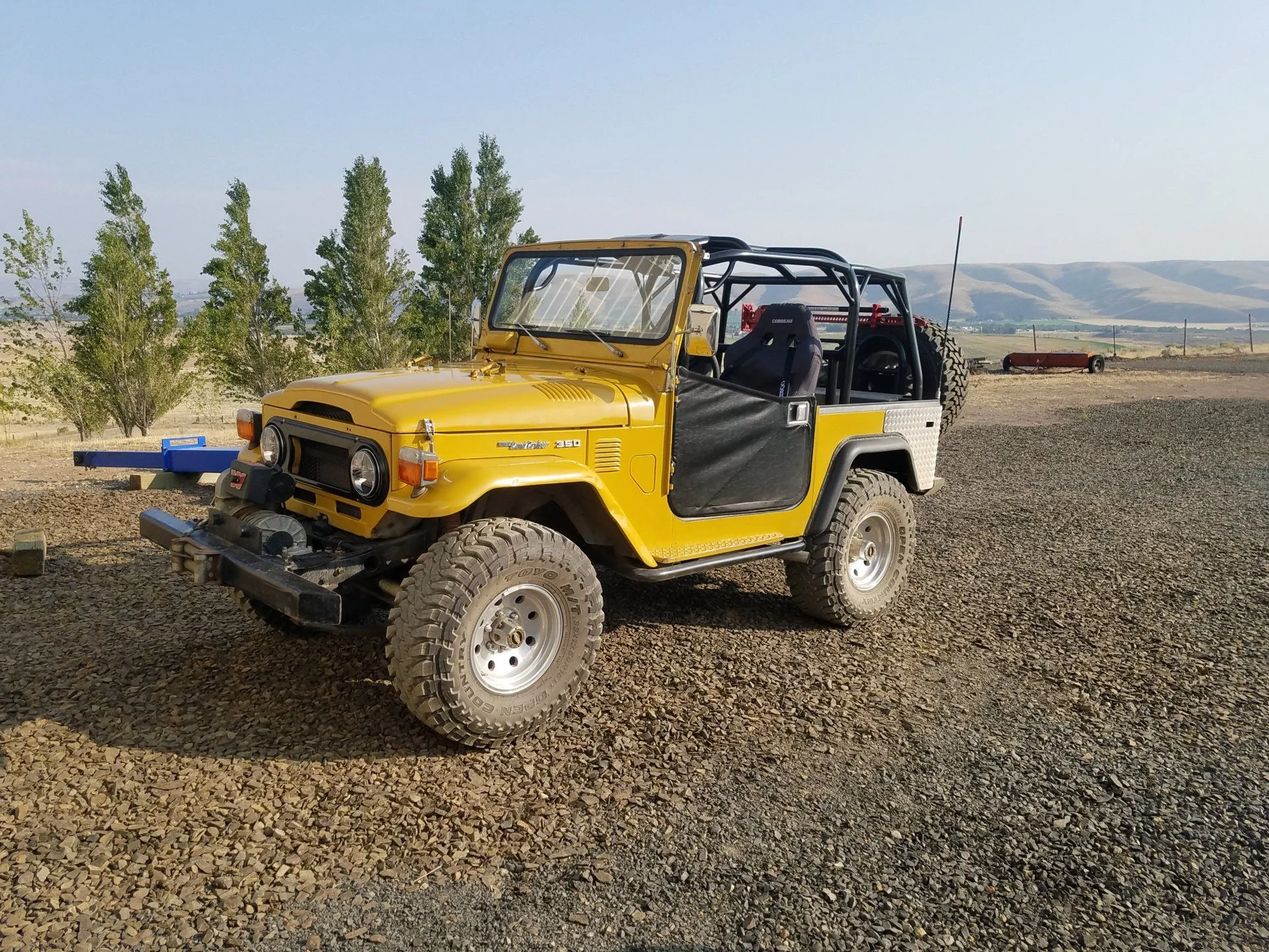

So after having spent the last two weeks using the search button on this forum, I have still come up empty handed (or maybe it's just more confused from so much info). Here's the deal: I have a 75 FJ40 350 SBC, front winch, heavy full roll cage, heavy rear bumper/swing out tire rack/3 Jerry cans, rear aux fuel tank, Rancho 43033 front springs w/ 2-3/4" eye-eye shackles, Rancho 43133 rear springs w/ 4-1/4" eye-eye shackles and 33-12.50-15 Toyo Mud's. Rear fenders are trimmed with Bushwacker flares.
The lift was installed by PO and was not driven much at all. The rig handles excellent (for a TLC) on the road as a daily driver but seems kinda harsh off road. I haven't had the chance to try flexing yet because I have a loud banging noise from underneath somewhere that I am still trying to find (possibly suspecting that the military wrap may be hitting the spring perch up front because of such short shackles in the front....still investigating).
My issue is that I think the rig sits to low for what I would like it to and I would love to clear 35's. I don't want to do a SOA. I called Cool Cruisers today and they said that their 4" lift would not clear 35's. I believe the Rancho lift is 2.5" but not sure since it's no longer available.
So what would be a good lift to get those 35's under there and to give the machine the beast look (but not the monster truck look). It will be used as a daily but I will wheel it on the weekends and still want some good flex, but it's not a rock crawler.

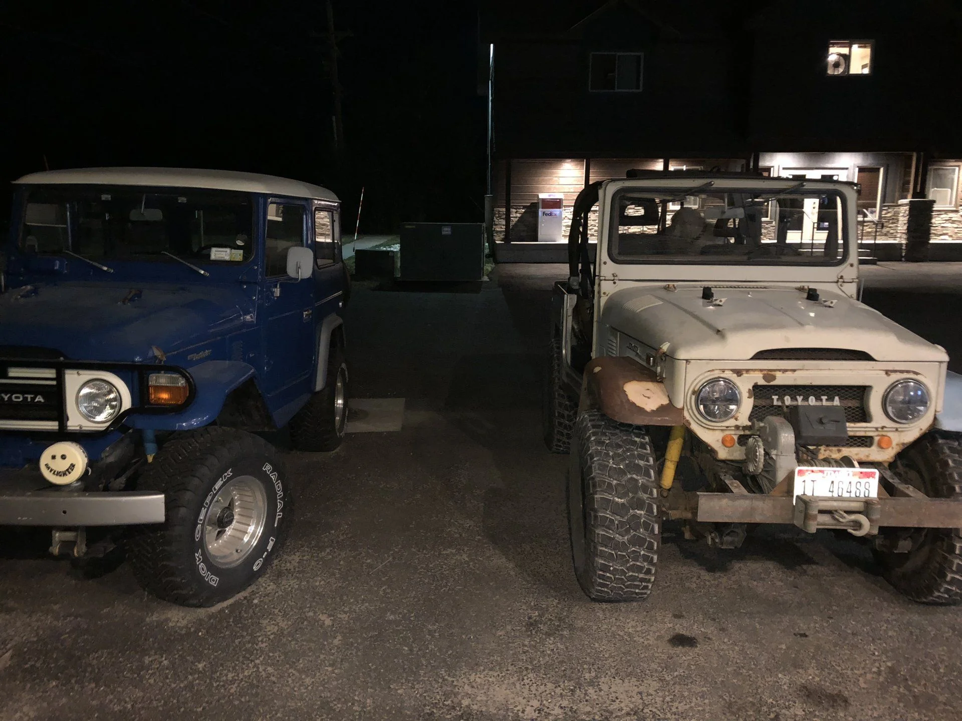

I'm running 4inch HFS Springs and slightly longer than stock shackles. Clears my 35s well and allows plenty of flex.

Do you have any pics (preferably before and after)?

Here's a couple of driveway pics. Sorry I didn't take any before I did the lift.

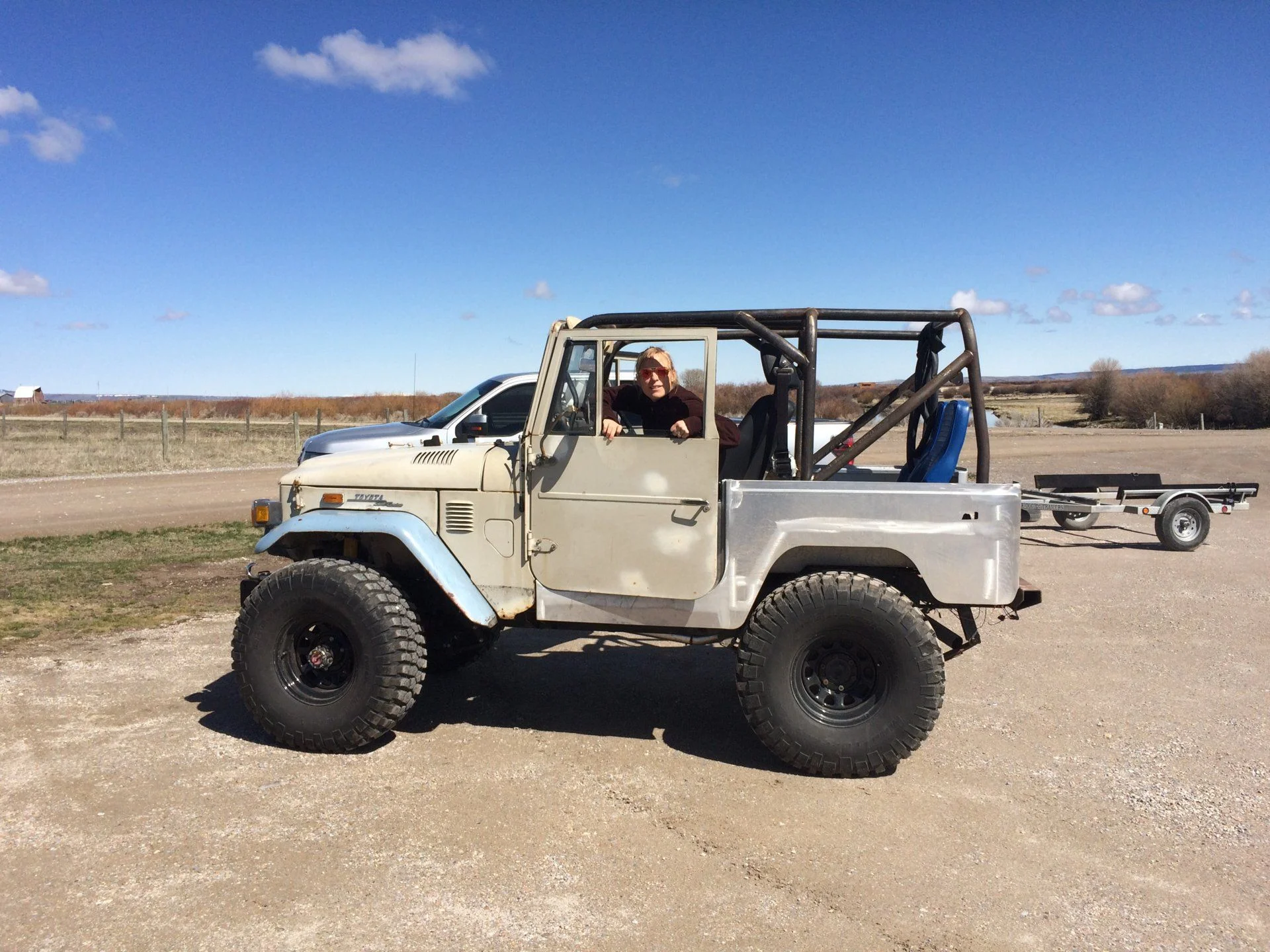

I have 4” of lift- 2.5 OME and shackle reversal(front) and 1.5” shackles in front
I like the ride, not overly stiff and good road manners. The whole front end is new, so no slop. Cruises 65-70mph no problem and crawls pretty well. I’m probably going to move the rear axle back an inch, as I’m a bit close in the wheel well. It honestly has only kissed the fender 1 or 2 times.
Not to start a war, but I like the SR in front. It handles well on the street and I don’t have the negatives of springs with a ton of lift. I can drive with one hand on the wheel and it doesn’t wonder. SR definitely has some drawbacks, but properly installed, it has advantages too.

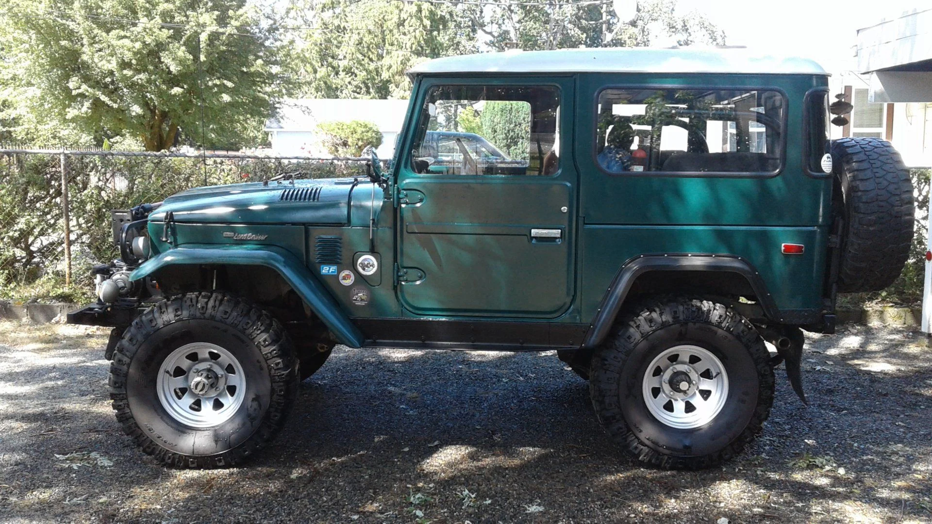

I'm sitting on a 4" Skyjacker, SUA, extended shackles in the rear 4 3/4" eye to eye, and I am sure I can fit 35"s under my 40. I was staring at it this weekend while in the mountains, thinking, man, I need bigger tires.
I currently am packing 33"s under the 40.
