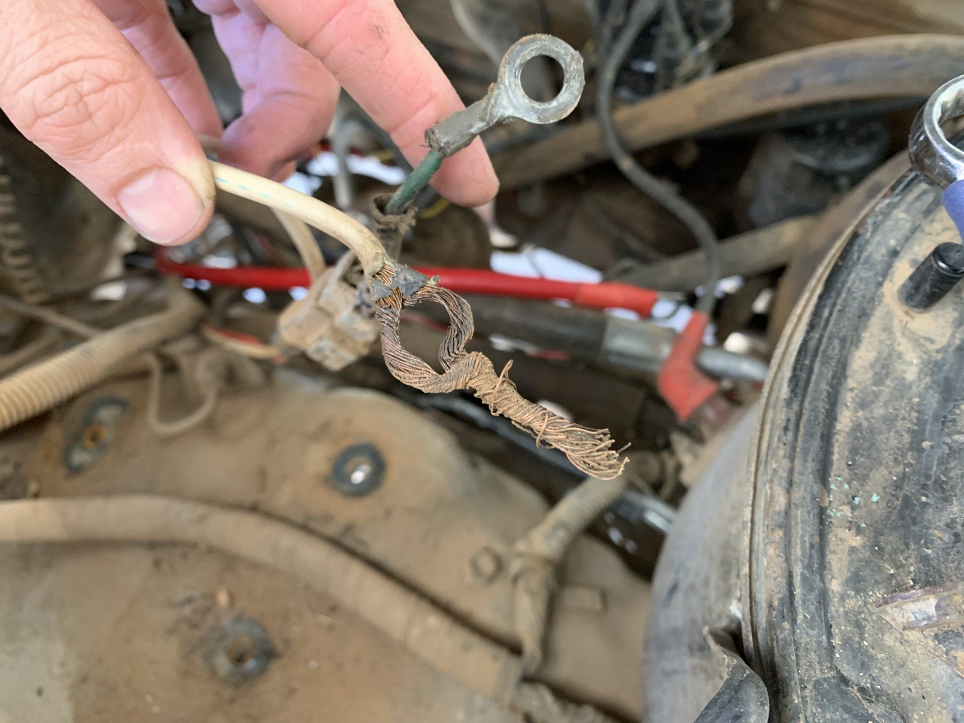

Today we are sorting out wiring.....this is our alternator wiring. Lol.
This was the bypass to the fusible link (long ago blown I’m sure) that powered my whole harness until a week ago... par for the Omani import course.

Ha...that wiring....just like ours. I'm scared of what else we will find. I do not want to put a harness in it.....we're up to our eyeballs in harnesses right now!
