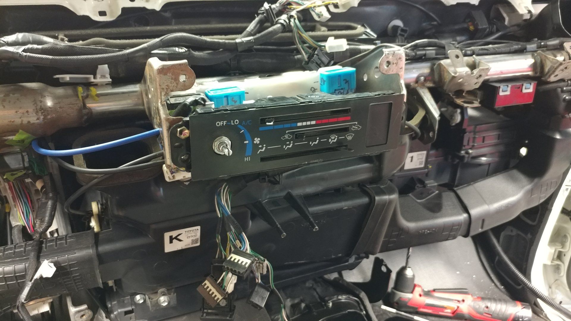

AC controls went in too.....way easier to deal with the AC control in the new dash vs. the old dash.
